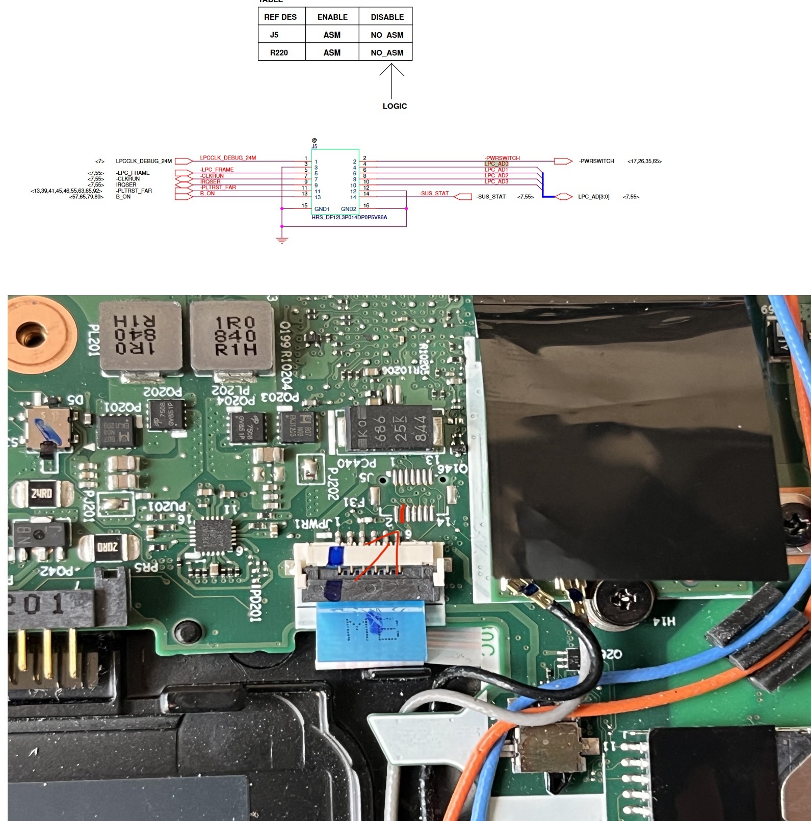

    Hey!
    Just to inform/confirm it works on X1 Yoga 4th (board FX490, NM-B861, same as X1 Carbon 7th): shorted J5 (which is located o the side of the battery connector), pin 4-6-8-10 (all connected together).
    Took some attempts, lost the serial number trying (not big deal) and, as user 64xgeo reported, a weird message where I had to press Z...
    All fine and clean now: thanks MaxPower!!!

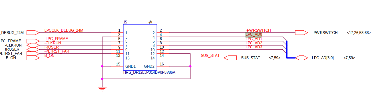

          #704
          Originally posted by Andromedus_81
          Hello
          Has anyone unlocked the Lenovo T470 model? If so, could they suggest which pin they used?
          Lenovo ThinkPad T470
          Type 20jn
          S/N pf-0y25az
          NM-A931 MEC1653
          J5 too 4/6/8 or 10
          Click image for larger version  Name:	image.png Views:	0 Size:	36.9 KB ID:	3666465

              #706
              Originally posted by kapiras
              Hi all, i am trying to unlock BIOS, protected by password of my Lenovo t480, I’ve tried flashing bios chip using CH341A tool with no success, then i came across this post and please correct me if I’m wrong, i am not good at reading schemes , is the pin that i marked in red is the right one?
              Yes it's good.
              you can use the 4 or 6/8/or 10 with a short shunt with a ground during startup
              watch my different videos as an example
