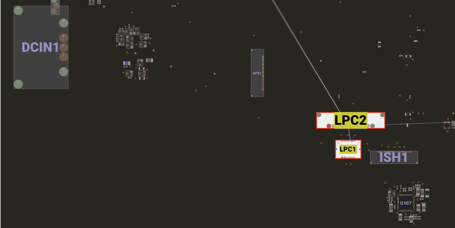

    So I found a boardview- apparently it has a MEC1653, can it be bypassed without replacing it?
    bypass work too on 1653
    Look LPC port if mainboard is ThinkPad Carbon X1 LRV-1 14282-2M 14282-3
    Please follow the instructions on all these pages carefully.
    !!!! Risk of bricks !!!!!
    LPC_AD0 or 1/ 2/3 with GND

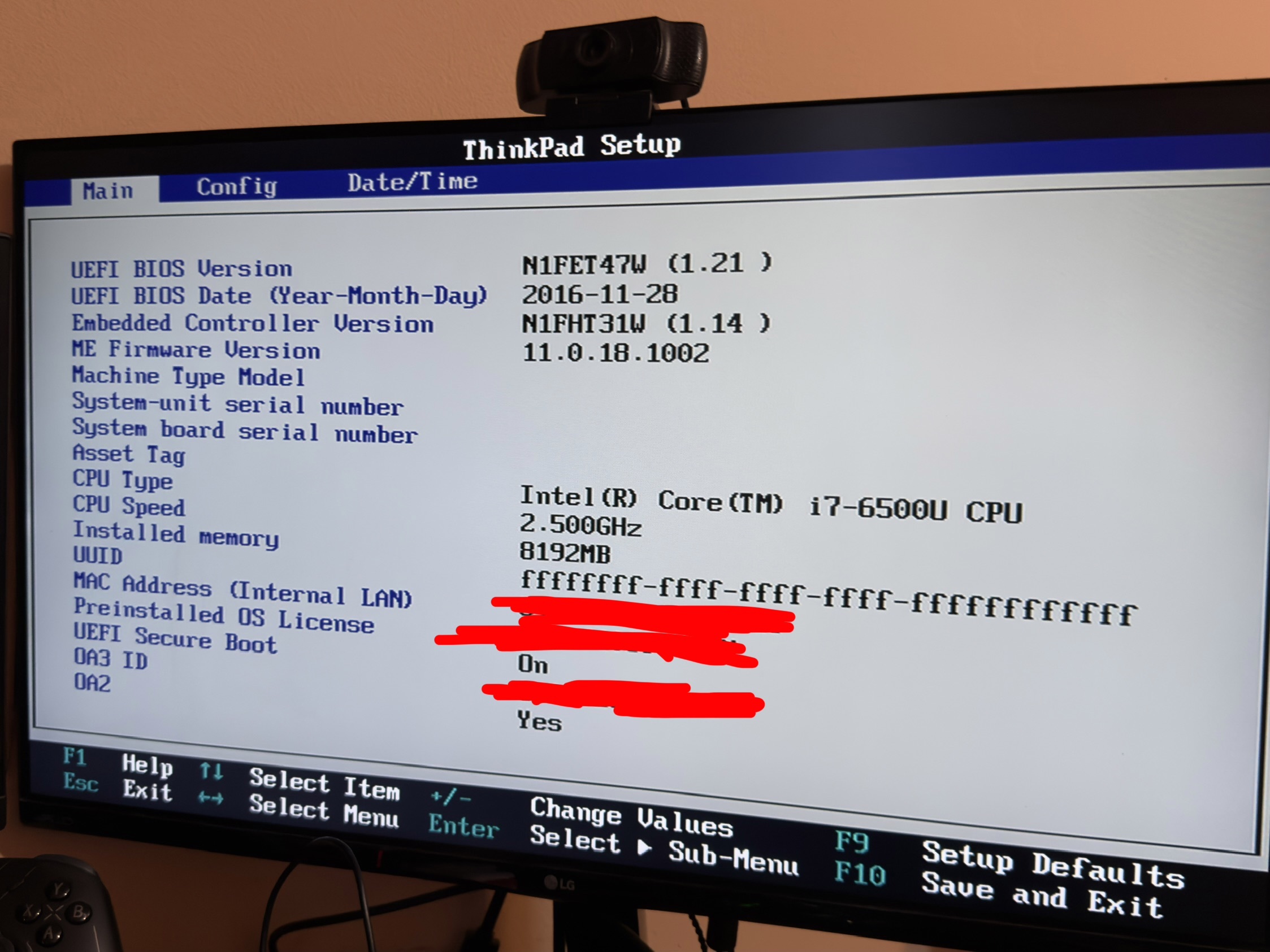

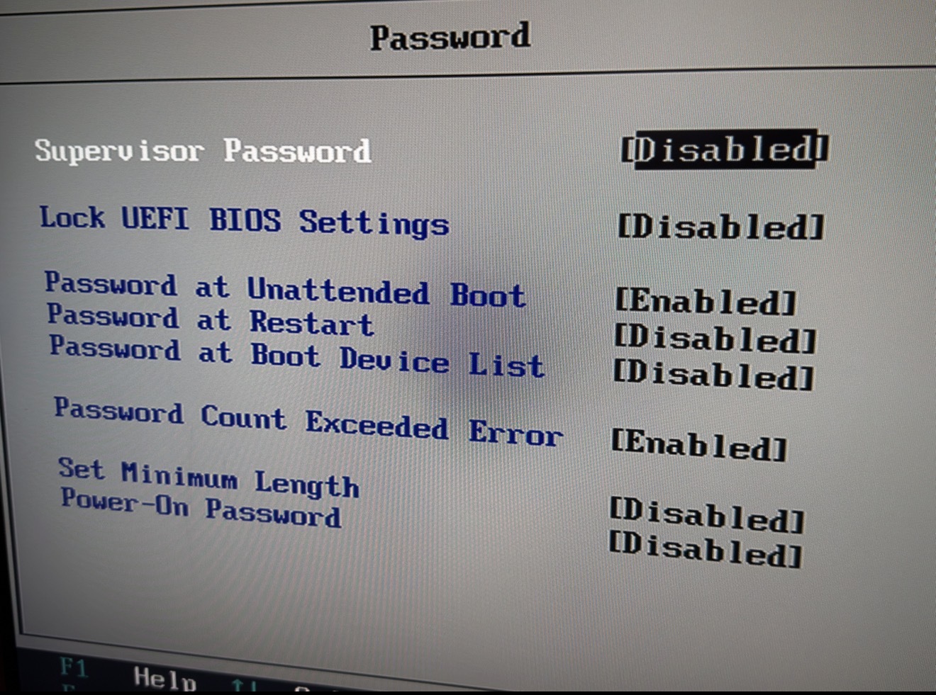

                    I'm having a bit of trouble, when I got it, it allowed me to enter the read only BIOS mode, kept trying to get the timing right and got into the bios but the security tab was missing and the UUID was ffffff- etc, i didn't save any changes but the lock icon changed and now I can't even enter the read only mode, is bricked? Or should I keep trying to unlock it and if so can you tell me what timing should I use? (I'm doing 1s of waiting after power on 2 seconds of holding and then on the Lenovo logo another 2 seconds, I also tried 1s short hold and 2s hold but nothing)
                    • sackslmao
                      • Sep 2025
                      • 8
                      • Romania
                      #770
                      I read some other guy had "bricked" his and his BIOS screen looked very similar, is the only solution now CH341A or can that not even save it? Also do I really need to desolder the chip or can I just put some crimps on it
                      • sackslmao
                        • Sep 2025
                        • 8
                        • Romania
                        #771
                        Well this is a pleasant surprise, I spoke too soon, just spammed F1 and ESC at the same time and it got me past the fan errors or anything else and it worked! I'm so glad thanks for the awesome method I'm gonna go enjoy my laptop now :p
