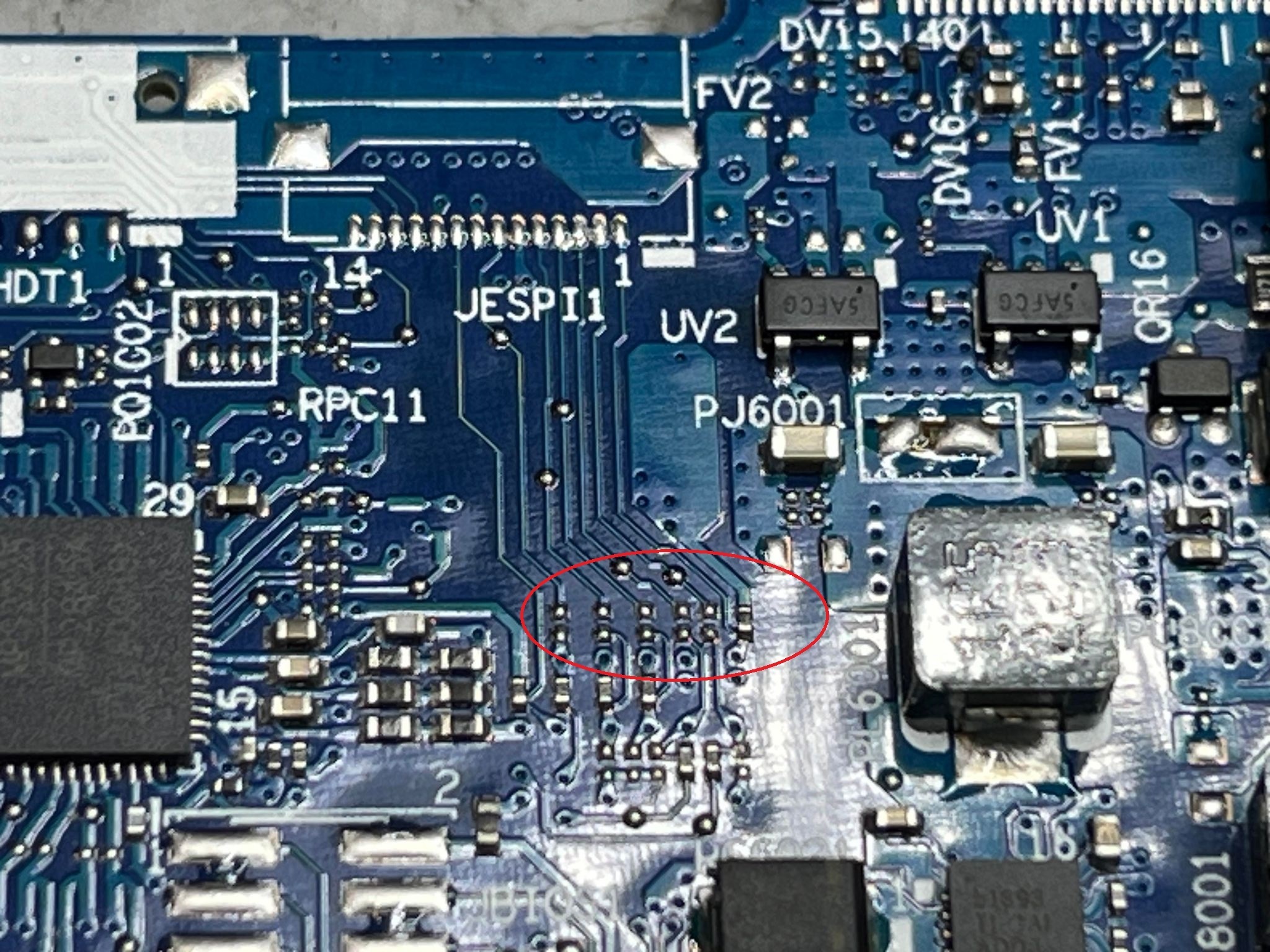

    Originally posted by spacez
    about T14 gen 3 AMD NM-E441 rev1.0..locked with svp password ... I managed to remove this SVP password with test point in ESPI-IO3 and gnd . but instead of entering bios he asks for another password but not the SVP one . by clicking only on enter it can go into the bios. but password change is not accessible..
    Excuse me, at what point and what type of resistor should I use? I have the same model. I was thinking of using 510-ohm, 1/4-watt, 1% tolerance resistors, grounding them to the metal plate of the USB ports. Please excuse my ignorance; I'm quite new to this. I've only been researching this for a day. Maxpower3 posted this photo.
