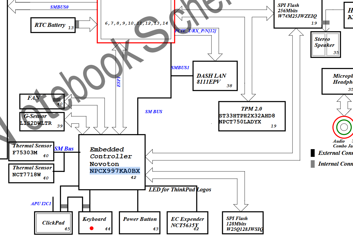

    GOOD NEWS FOR ALL FINALY I THINK TEAM OF SVOD CAN READ NPCX 997

    I have a guinea pig in t14 gen3, I will test

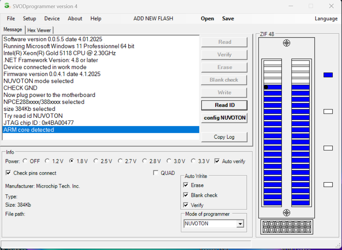

      I managed to get the identification, but I don't have the example card.
      I have T14 gen3 NM-E441 (AMD) NPCX997KA0BX
      No reading (greyed out).

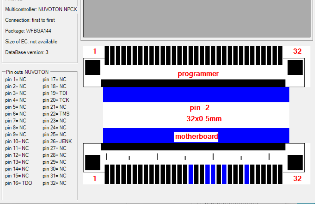

      I will check the pinout of example with my card​

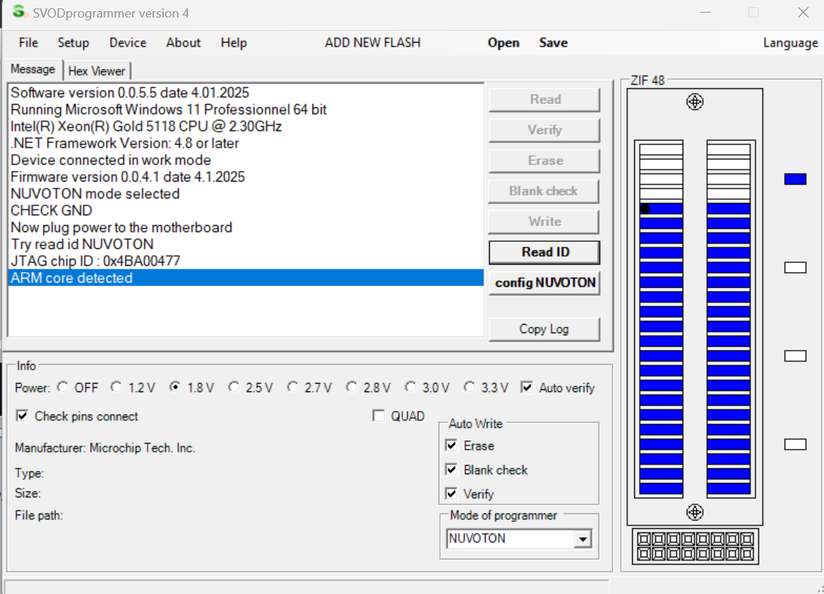

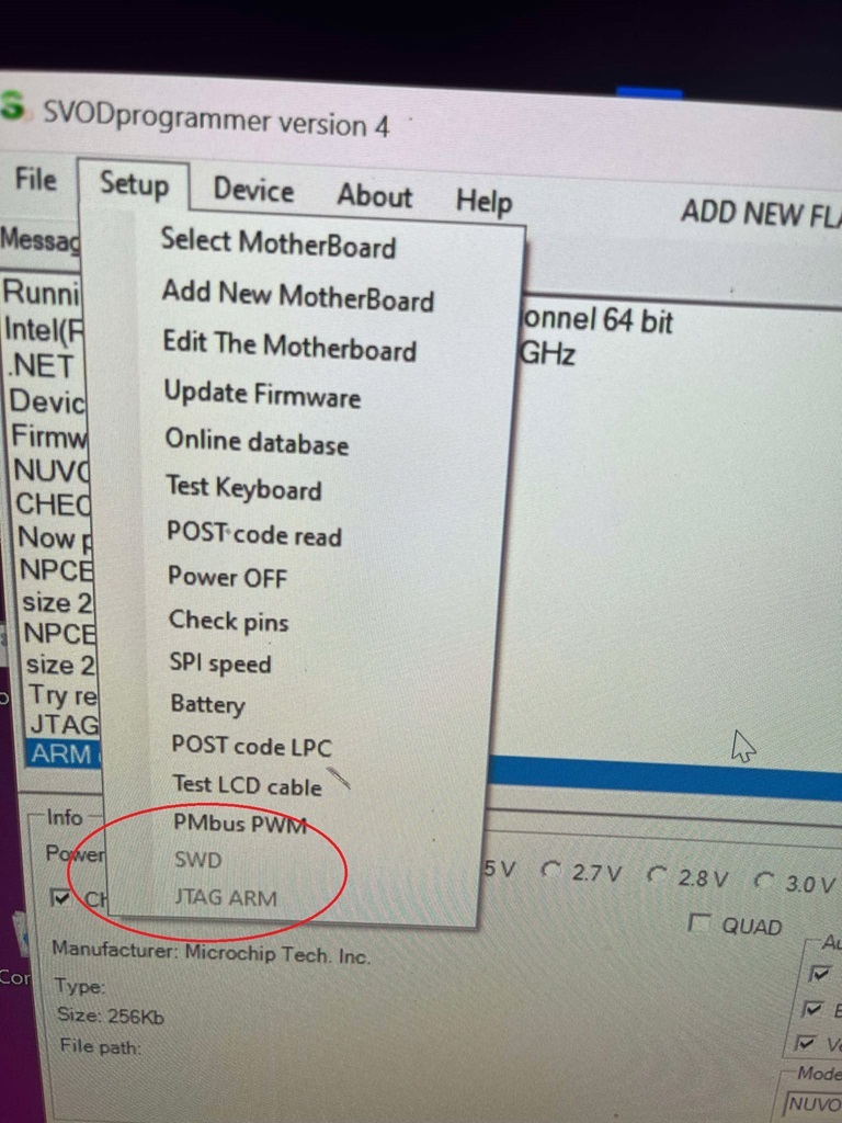

          grayed out for me ?
          stuck after arm core detected
          edit
          My svod is not activated, is that the problem?
          JTAG arm is grayed out so I didn't even know that it needed activation on it
          I never needed it, I'm an idiot.

            Click image for larger version Name:	image.png Views:	0 Size:	236.0 KB ID:	3549177
            grayed out for me ?
            Press configure or Select 256kb?

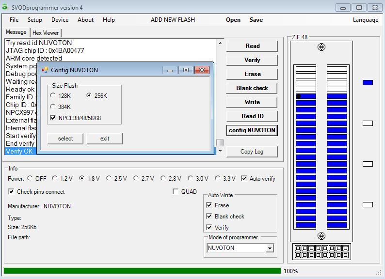

              grayed out for me ?
              I set it up like this and it reads every time​
                thanks no change

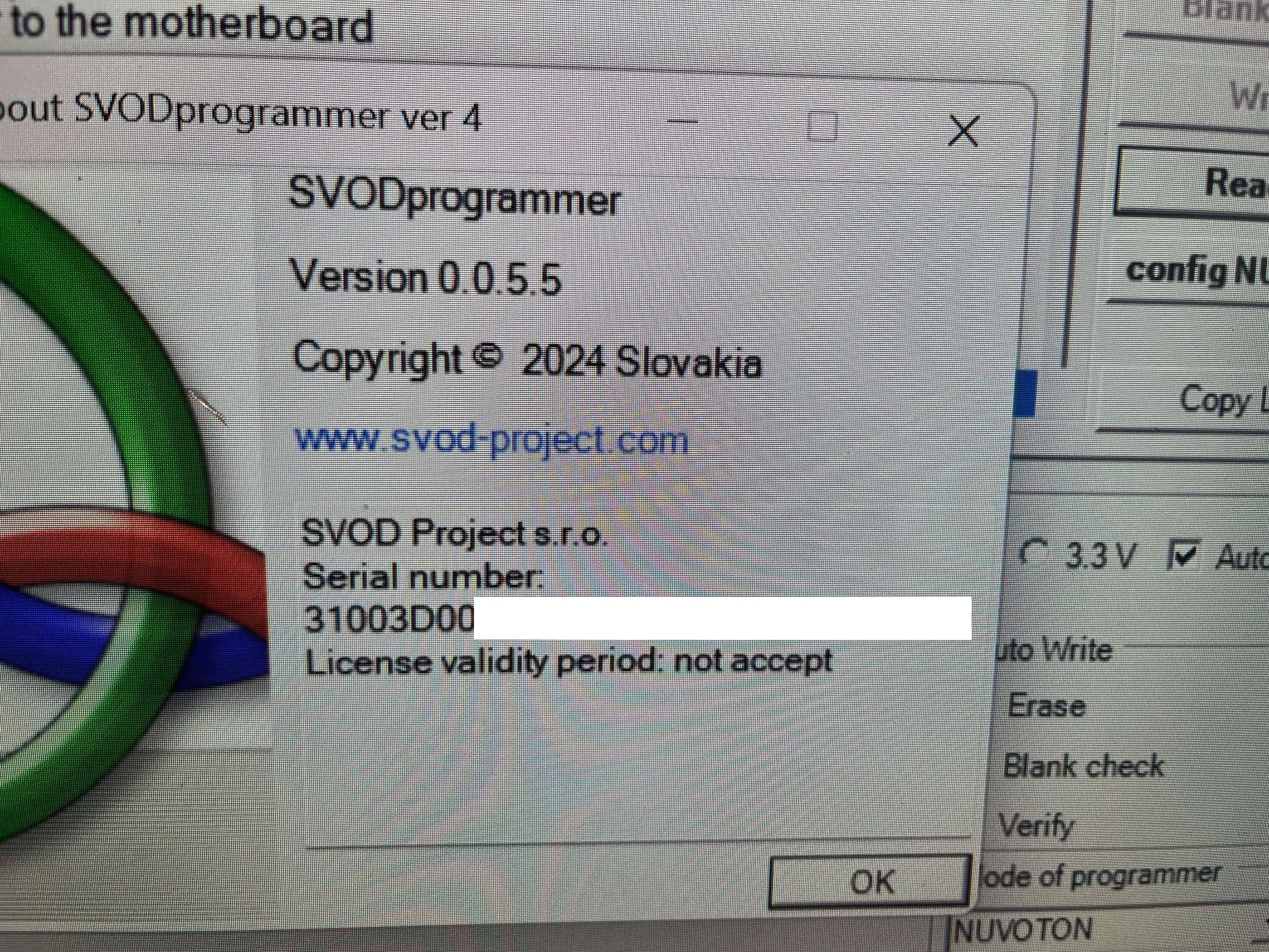

                      can you confirm that my problem is not due to the license validity period? and the jtag is grayed out for you too?
                      • Stefan Steff
                        • Mar 2024
                        • 357
                        • Romania
                        Mine is...

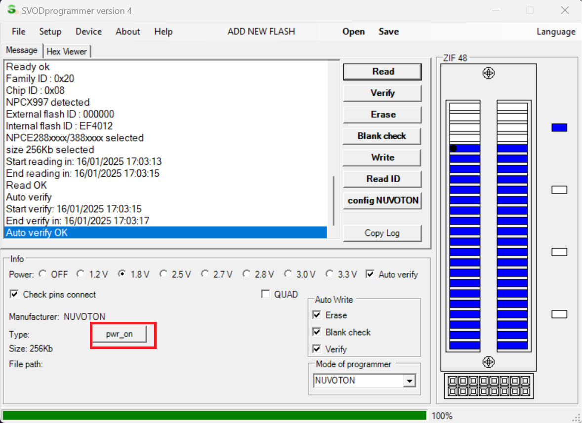

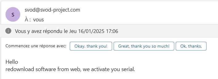

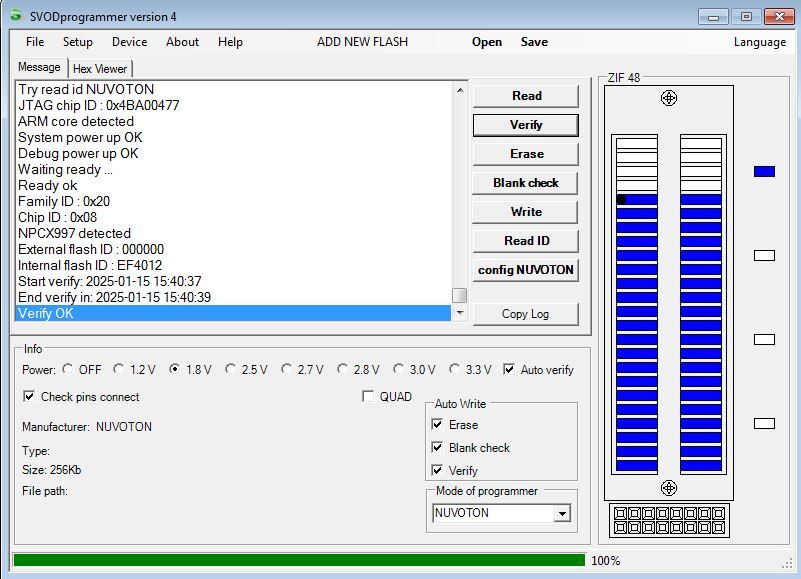

                              a BIG BIG Thanks to the SVOD team who activated my tool.
                              I now notice a new box in the software and now reading is done perfectly
Name:	Nouveau Image bitmap (2).png

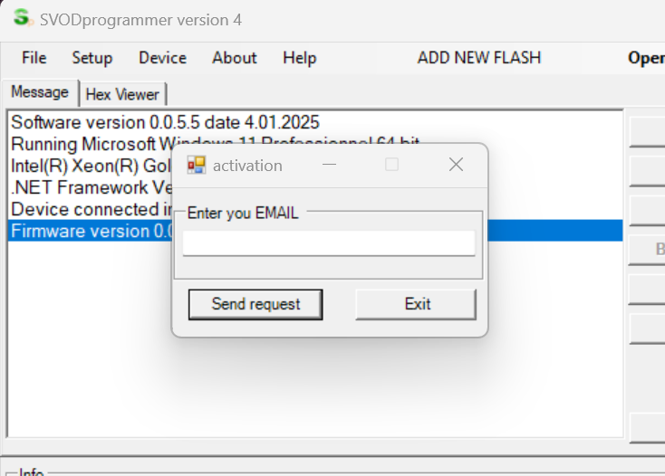

                                  I tried everything,
                                  I don't know the right procedure.
                                  already registered via the software
                                  Click image for larger version  Name:	image.png Views:	1 Size:	88.4 KB ID:	3550032
                                  wait for the return
                                  and redownload and reinstall svod 4
                                  Click image for larger version  Name:	image.png Views:	1 Size:	19.5 KB ID:	3550033
                                  otherwise contact them via their link.
                                  Click image for larger version  Name:	image.png Views:	1 Size:	38.5 KB ID:	3550035
                                  Maybe you won't need it.

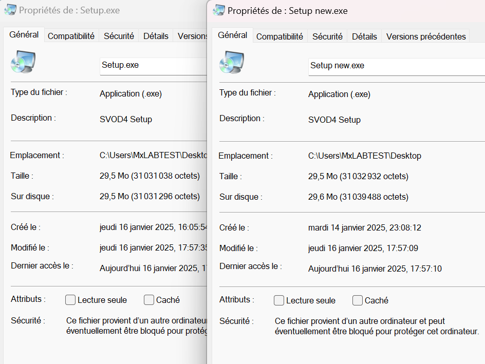

                                  I've already polluted enough as it is,
                                  I searched all night why this thing didn't work
                                  there is a variation of a few bytes on the setup between yesterday and today​

                                      always greyed too, just new button pwr_on

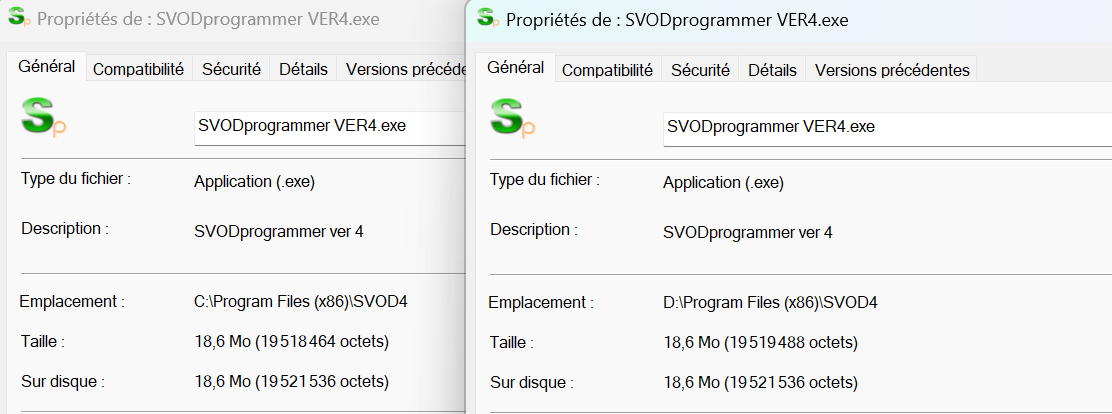

                                      try downloading it again today and reinstalling. and see if you have the button
                                      Click image for larger version  Name:	image.png Views:	0 Size:	45.0 KB ID:	3550057
                                      0.0.5.5 both,
                                      the content is not the same
