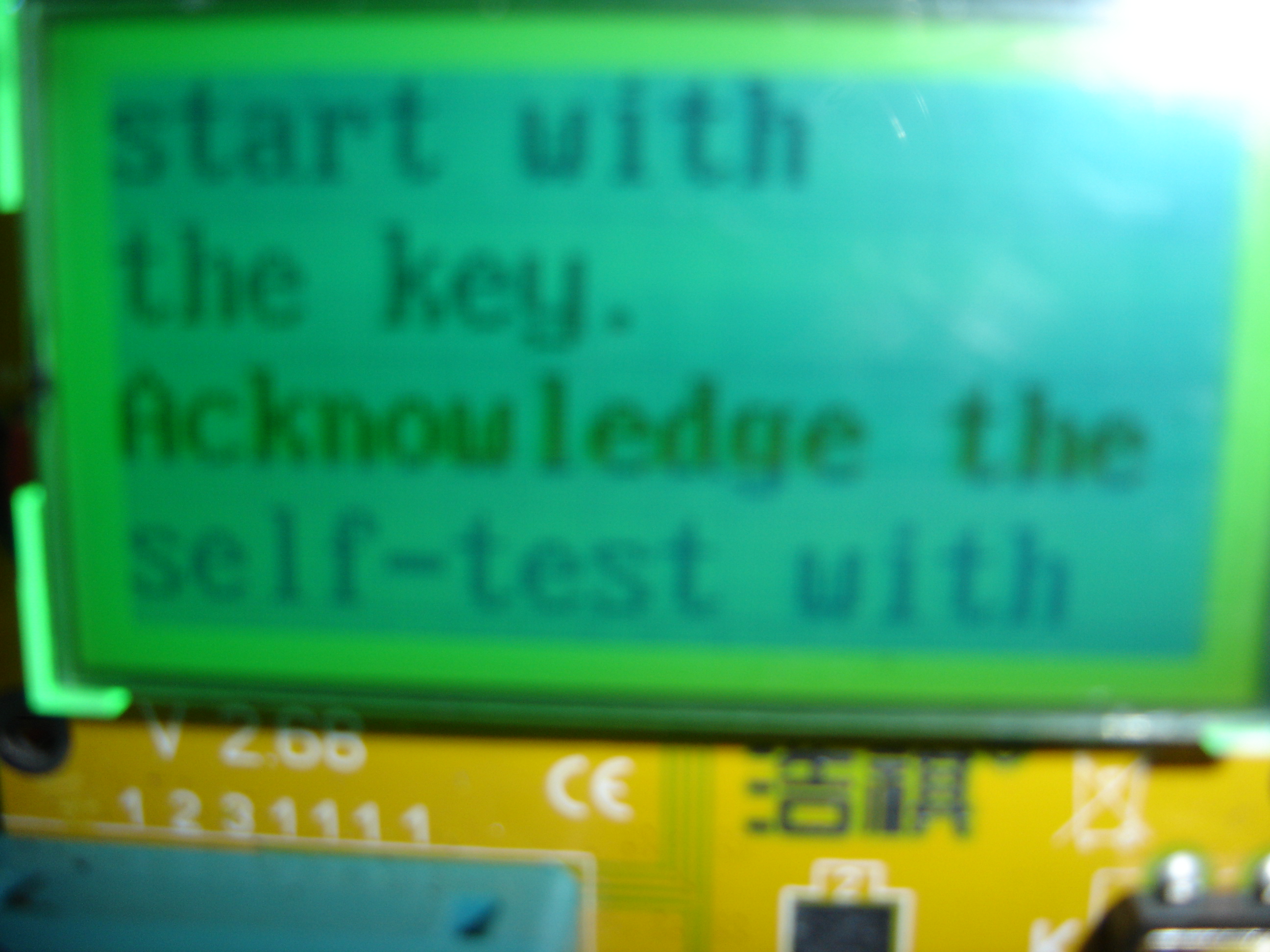

      I have just received a couple of 16mhz crystals and fitted one to my T4 tester
      with the old program which is v1.12 all the capactors read double there value where as resistors and transistors seem to read within tolerence, I have tried several 16mhz firmware upgrades with no luck just a blank screen, any suggestions ? if all else fails I can always revert to the 8mhz crystal. the original firmware was V2.68 which I lost due to corruption and damage to the original chip, (my fault) did not discharge capacitor.
      John
        • 31246
        #883
        Re: ESR meter upgrades
        post foto's of the board

              • TEDDIBEAR
                • Oct 2014
                • 45
                • england
                #887
                Picture of the board is shown in #825.
                John

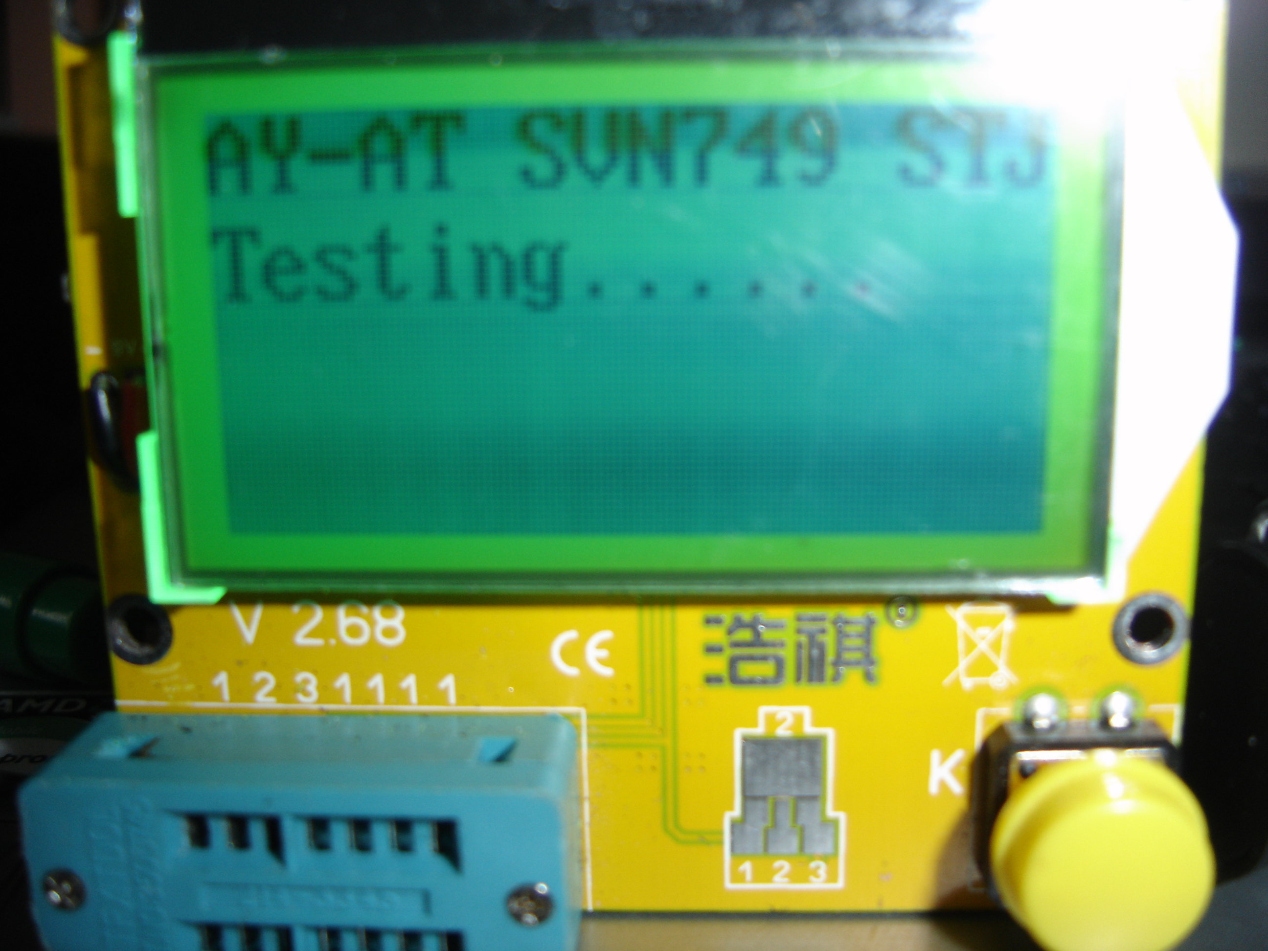

                  • 31246
                  #888
                  test these - let me know which gives you a display.
                  that's all its for btw, determining how the display is wired.
                  • TEDDIBEAR
                    • Oct 2014
                    • 45
                    • england
                    #889
                    Hi stj;Have downloaded your firmware the strip grid16 is the one that gives a display see thumbnails the other (16mz) is blank.
                    John

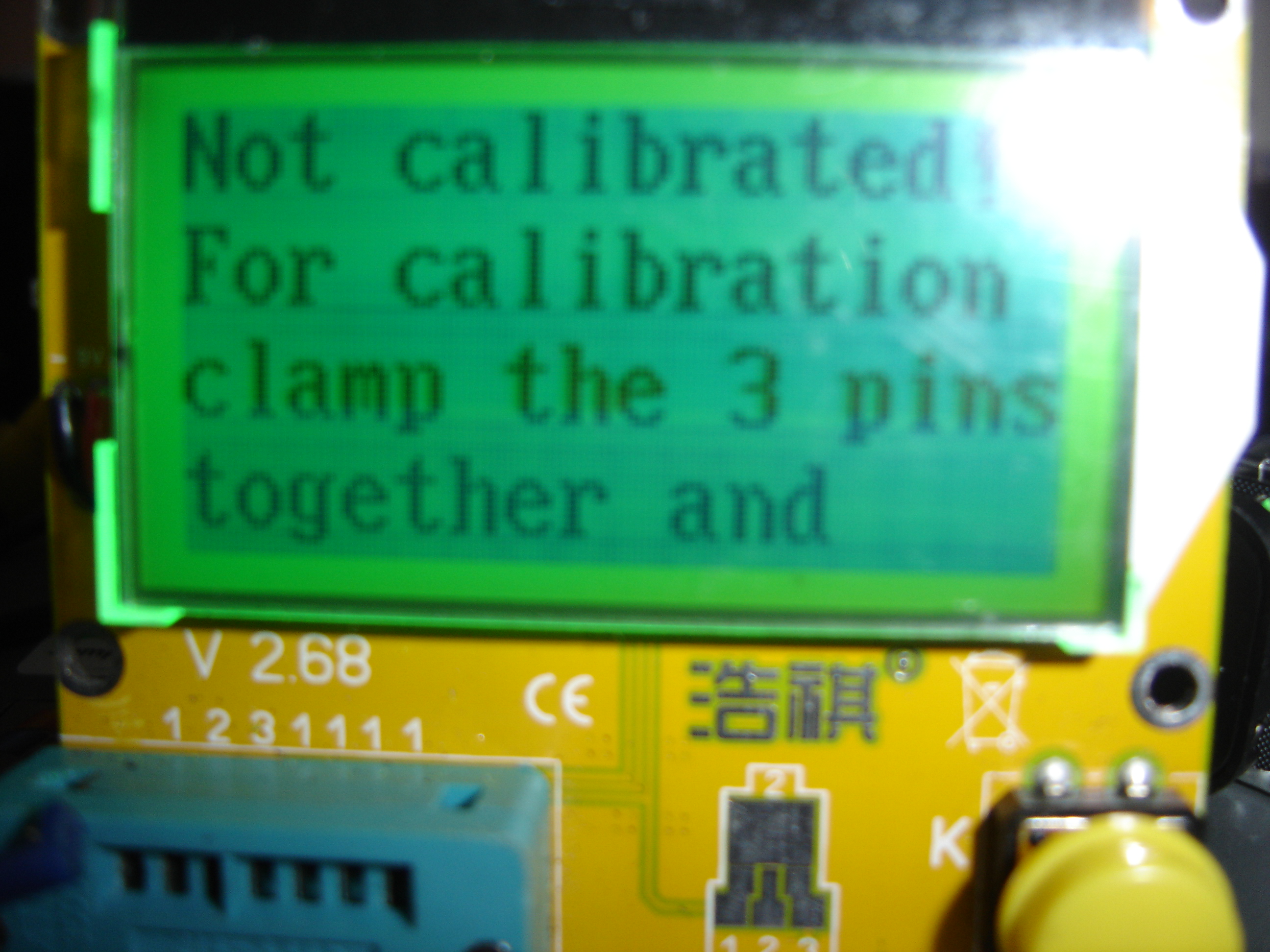

                            • TEDDIBEAR
                              • Oct 2014
                              • 45
                              • england
                              #894
                              If I press the button once it goes into test and then this screen with no component connected and stays like this until battery is disconnected.
                              John
                                • 31246
                                #895
                                when it's off, hold the button down.
                                you will get a menu, or it's not enabled - i didnt check.

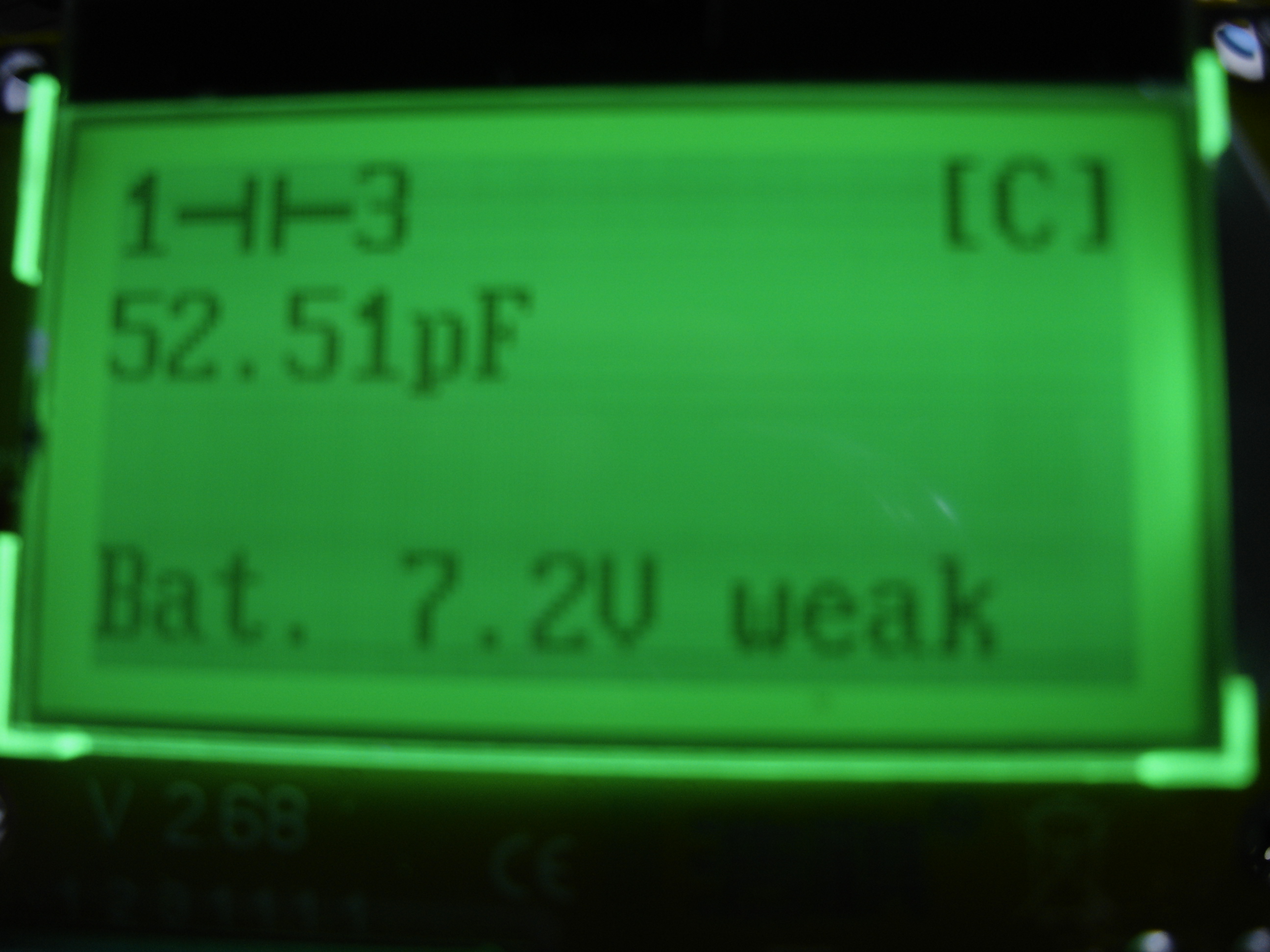

                                • gabiz_ro
                                  • Mar 2011
                                  • 169
                                  • Romania
                                  #896
                                  Same board as TEDDIBEAR have.Except crystal at 16MHz.
                                  Replaced push button with encoder.
                                  Tested few versions,some no display,some display OK but only push button works no encoder.
                                  Finally found this one
                                  https://www.mikrocontroller.net/svnb..._T3_T4_st7565/
                                  But crystal on board was already 16MHz so display double value.
                                  Change value in makefile and works fine.
                                  • TEDDIBEAR
                                    • Oct 2014
                                    • 45
                                    • england
                                    #897
                                    No unable to get any menu by holding button down. only test which if you do not insert component reads 54.62pf then if you insert 3 pin link it will run through some information as pictured in previous thread this is the only way to get it to switch off automatically, if you do not insert link it just sits at 54.62pf.
                                    John
                                      • 31246
                                      #898
                                      the test i posted is 16MHz, it was to see how the display was wired.
                                        • 31246
                                        #899
                                        John
                                        ignore that firmware - it's done it's job.
                                        now i know how your display is wired, i can make a "real" firmware later.

                                          #900
                                          Hi have never worked on makefile so would not know how to change any values
                                          any help would be appreciated.
                                          John
