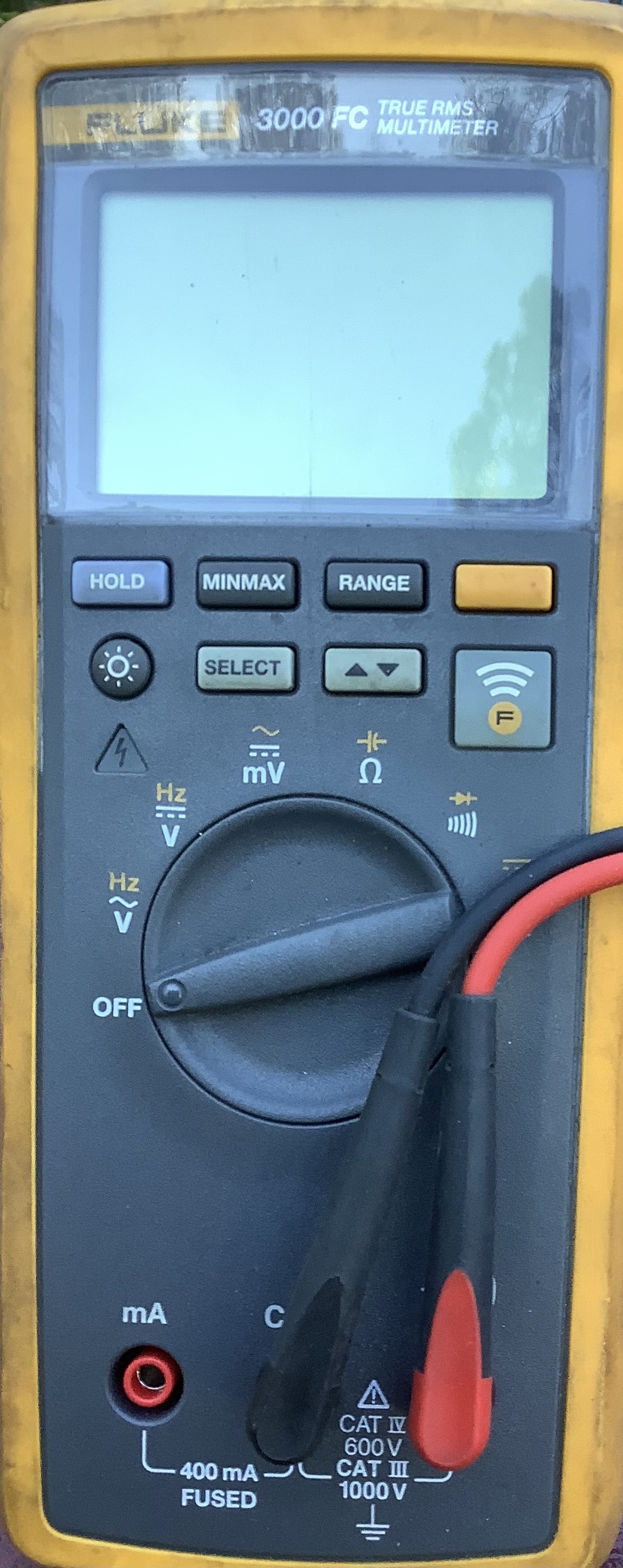

        What model is the Fluke multimeter?
          • Jul 2011
          • 6059
          I will have to get this information tomorrow morning if I have time before I go to work in the morning
          But it is the version that has the Bluetooth function on it and I have used it several times to troubleshoot intermittent power issues this is where this meter comes in very handy for this particular use

            I was trying to understand what the plan is.
            Old Fluke multimeter power is 3 of AA in series for 4.5V, and new plan is 3 of 14500 Li Ion 0.7Ah each in parallel for 3.7V?
              • Jul 2011
              • 6059
              I am aware that the battery icon will probably show that the battery is a little bit low I am not concerned about that when the battery pack goes low the BMS protection board will turn the power off or the meter will shut off either way this would be okay
              I also thought about putting on two batteries in series and using a small buck converter in battery case but the issue with this is turning on and off the buck converter because if left on all time the batteries would be low each time I would need to use it

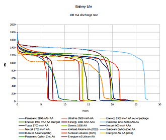

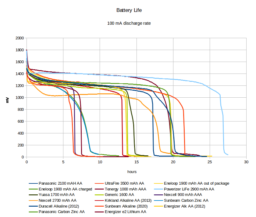

                                    It's about filling the battery bay up as much as possible is what you want. Pouch batteries are not so thick and room would be wasted I think.
                                    There must be something wrong with lithium 14500's to have lower capacity compared to other sizes? Maybe it's room needed for the BMS.
