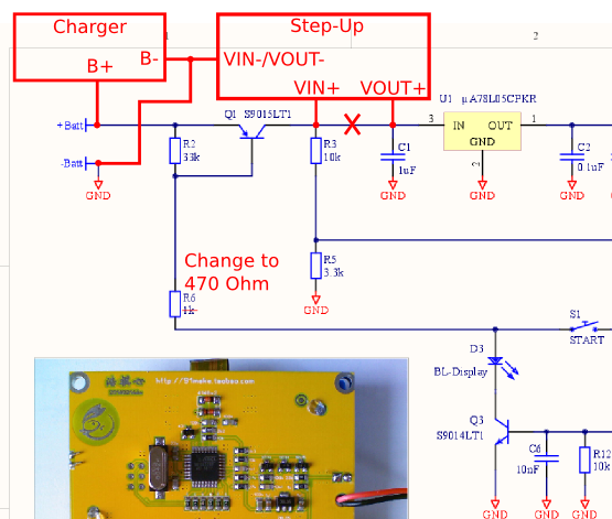

                            OK here it is with my li-po mod and ISP header mod. The lipo is 1500mah and has protection circuitry built in. The second picture is how i wired the charger and boost converter in to the tester, I found this diagram online at this site- https://www.thingiverse.com/thing:1797074 My charger/boost converter was one piece so I cut a trace and separated the 2 the same way as this person did about 1/2 way down in this thread- https://www.jyetech.com/forum/viewtopic.php?f=19&t=1153
                            I also changed the resistor on the boost converter part to 100k and it output 6.5 volts.
                            Now it's time to try out the firmware that stj cooked up for me! Is there a guide anywhere that shows how to use the makefile and compile custom code?
                              • 31190
                              #874
                              Re: ESR meter upgrades
                              throw the makefile into a text editor - it's full of notes
                              what's the output voltage of the boost convertor?
                              just asking because your passing it through a 5v regulator that probably needs atleast 6v to function.

                              • turbochris
                                • Sep 2017
                                • 9
                                #875
                                it was originally a 9 volt converter, i changed a resistor and made it 6.5 volts
