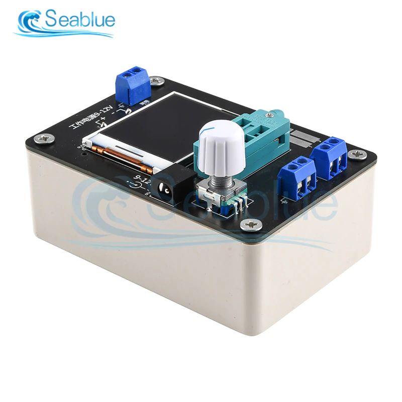

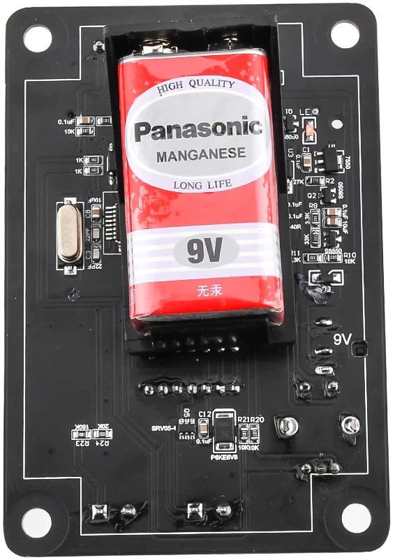

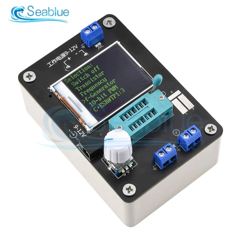

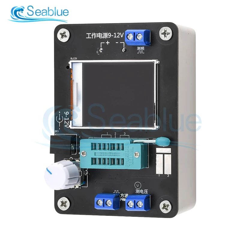

              STJ, does this unit look like it would work with your firmware?
              They don't show the bottom of the board but I'm assuming it's an 8MHz setup.
              2021 New GM328A Transistor Tester ... W/ Battery Case
              https://www.aliexpress.com/item/1005002426224712.html
              Last edited by bcstedt; 04-26-2021, 03:10 PM. Reason: Found and image of the backside.

                i have no idea - first time i'v seen that.
                it looks similar to the one we call "AY-AT"
                if your thinking of buying it - dont.
                it has a 32pin cpu - so limited to 32k flash.
                you want one with a 44pin cpu so you can use upto 128k for maximum features.

                  Thanks for the tip! I will hunt for 44pin units.
                  Wait, so what processor is it? Model #?
