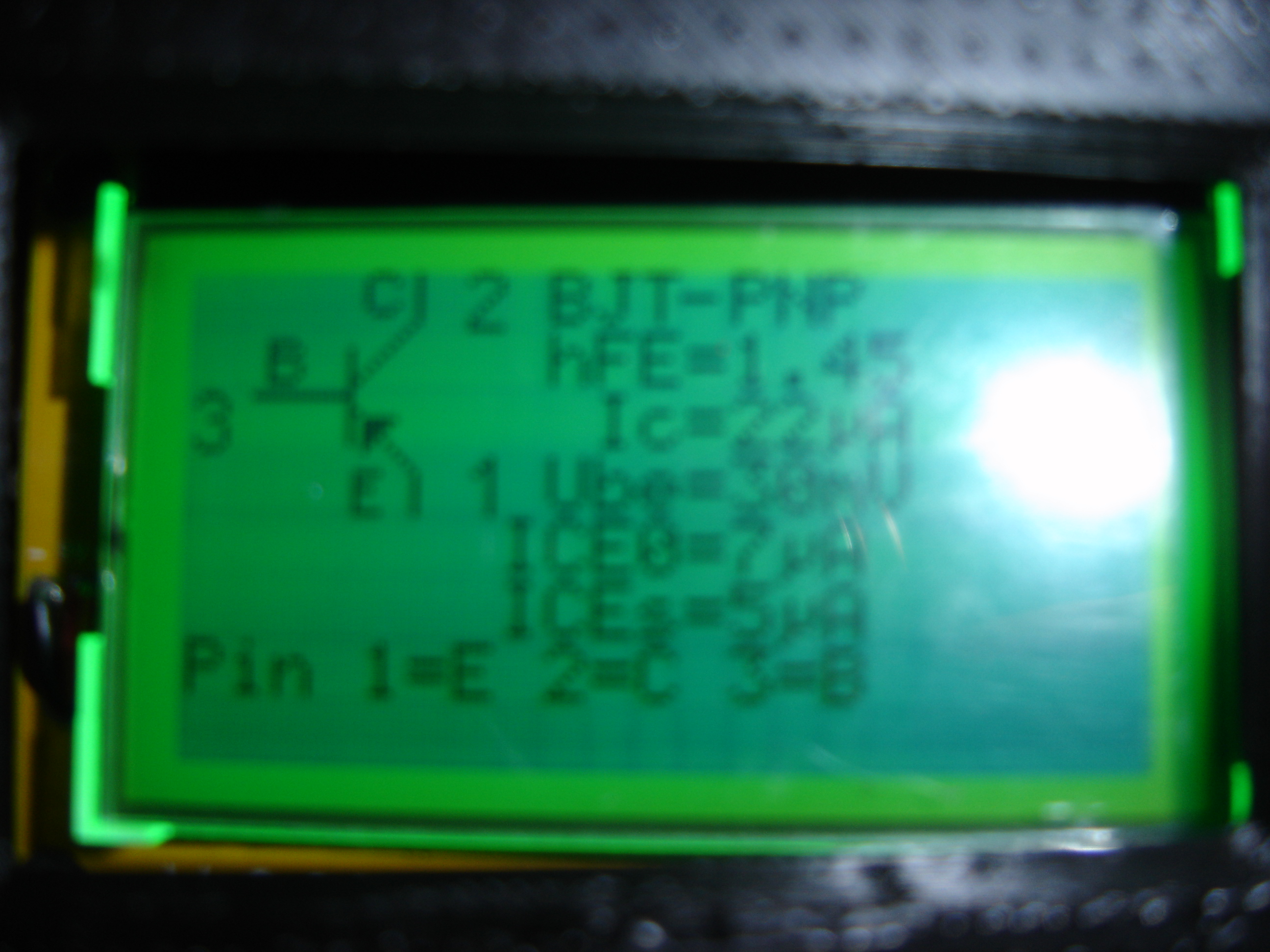

    There is only S1 start button on this device.apart from the addition of the encoder.
    could it be the 16mhz crystal causing the problem of selection.?
    I have checked the voltage on the start button which shows 9 volts collapsing to .7 volt on press on then returning to 2.7v on the live side powering the display, returning to .7volt every press, voltage on PD 7 drops from +5 volt to .7 and returns to 5+ on release of the button.The encoders center pin is to chassis
    each leg is supplied from 5+ rail via 10k resistor and PD1 & PD3 is fed via 1k resistors. The firmware I am using is your TEST 16mhz stripboard. which seems to tick all of the boxes except select from the menu.

      that firmware is totally unconfigured.
      i'll post something better later.

        some quick builds:
        GM328 and AY-AT for 16MHz
        both using compact font with more menu lines.
        and a T4(strip-grid) 16MHz testbuild for TEDDIBEAR.

                      Originally posted by stj
                      some quick builds:
                      Hi stj
                      thank you for your update I am afraid I am still unable to select from menu
                      here are the results. + when a test is made it stays on the screen for a split second too quick to read
                        • 31218
