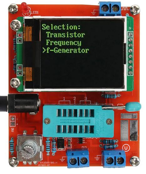

          Re: ESR meter upgrades
          Hello
          search (original) working HEX/EEP files and Fuse settings for the GM328 (AY-AT)
          Transistor Tester (from Banggood) because my Atmega is broken.
          The original seems to be protected against reading :-(
          TX7014DH is on the Display,
          thanks for a feedback
            why original?
            we have newer ones on this forum if you search - i know because i built and posted them!
            • snapper1234
              • Nov 2015
              • 2
              • germany
              #986
              which one is to be recommended that comes near to the original?
              where can i download it?
              • Per Hansson
                • Jul 2005
                • 5895
                • Sweden
                #987
                https://yadi.sk/d/yW8xa5NJgUo5z
                Inside folder: M328KIT+TFT
                You can there find Firmware in original.
                But also both Madires (M-Firmware) and Karl-Heinz Kübbeler (K-Firmware)
                Note that the "original" firmware is of course the K-firmware with some changes by the Chinese, but not releasing the source code
                If you prefer to build the firmware from source here is the SVN repo:
                The latest K-firmware: https://www.mikrocontroller.net/svnb...oftware/trunk/
                The latest M-firmware: https://www.mikrocontroller.net/svnb...ftware/Markus/
                EDIT: You also cross-posted here and got a reply already from Madires:
                https://www.eevblog.com/forum/testge...16/#msg3119216

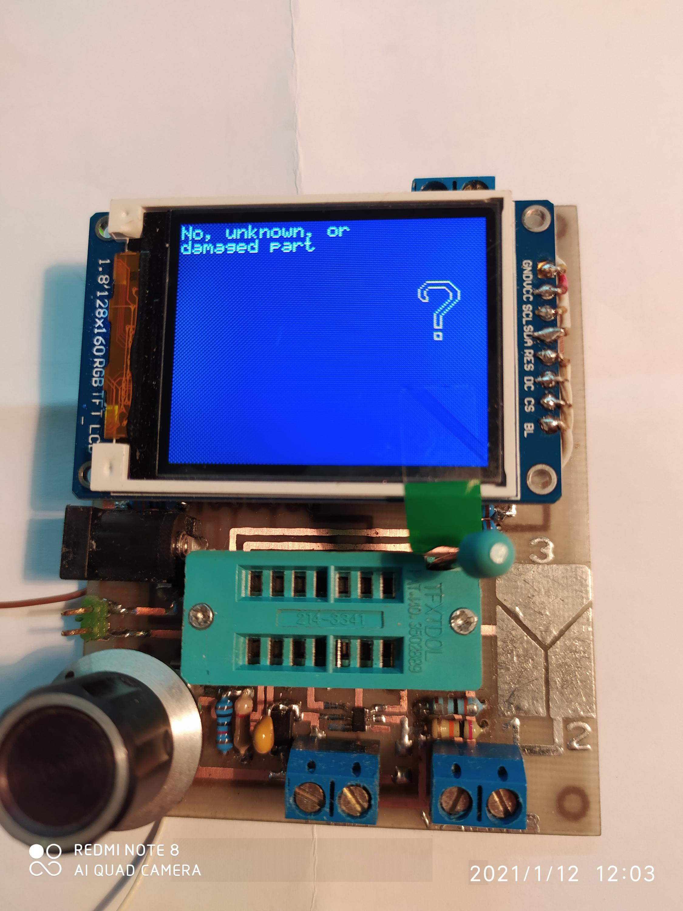

                        #991
                        I'm new to the forum and I managed to do my tester, but I have a problem with the version. The font is very small. Can anyone help with the .hex and .eep files ?
                        • lz4pa
                          • Nov 2020
                          • 7
                          • Bulgaria
                          #992

                              #994
                              I made the model M328kit + 1.8''TFT Full Color LCD Display Module 128X160 Serial SPI ST7735S. I just had one. It works great with your software, but unfortunately the font is small.

                                  #996
                                  Thanks for your attention stj. I don't understand anything about programming. That's why I asked for help in the forum. For now I am freezing the project or I will seek help again! Thanks again!
                                    • 31040
                                    #997
                                    yes,
                                    the problem with changing fonts is that you need to take into account the shorter number of characters you can fit onscreen so it doesnt wrap or make a mess.
                                    • lz4pa
                                      • Nov 2020
                                      • 7
                                      • Bulgaria
                                      #998
                                      I won't be able to do it.
                                      I stay like that. If anyone can help me , I will be very happy!

                                        #999
                                        This is something you etched yourself lz4pa by the looks of it? Nice work!
                                        What MCU did you use, Atmega328p?
                                        Maybe I will have some time in the weekend to see if something can be improved.
                                        I did not find a firmware for ST7735S display in the massive eevblog thread but I did not look very hard...
                                        • lz4pa
                                          • Nov 2020
                                          • 7
                                          • Bulgaria
                                          #1000
                                          Hello Per Hansson! Yes ,use atmega328p in this construction. I made the scheme of M328 kit + tft display based on st7735s. I guess it's all due to the difference in the resolution of the displays. Thanks in advance!
