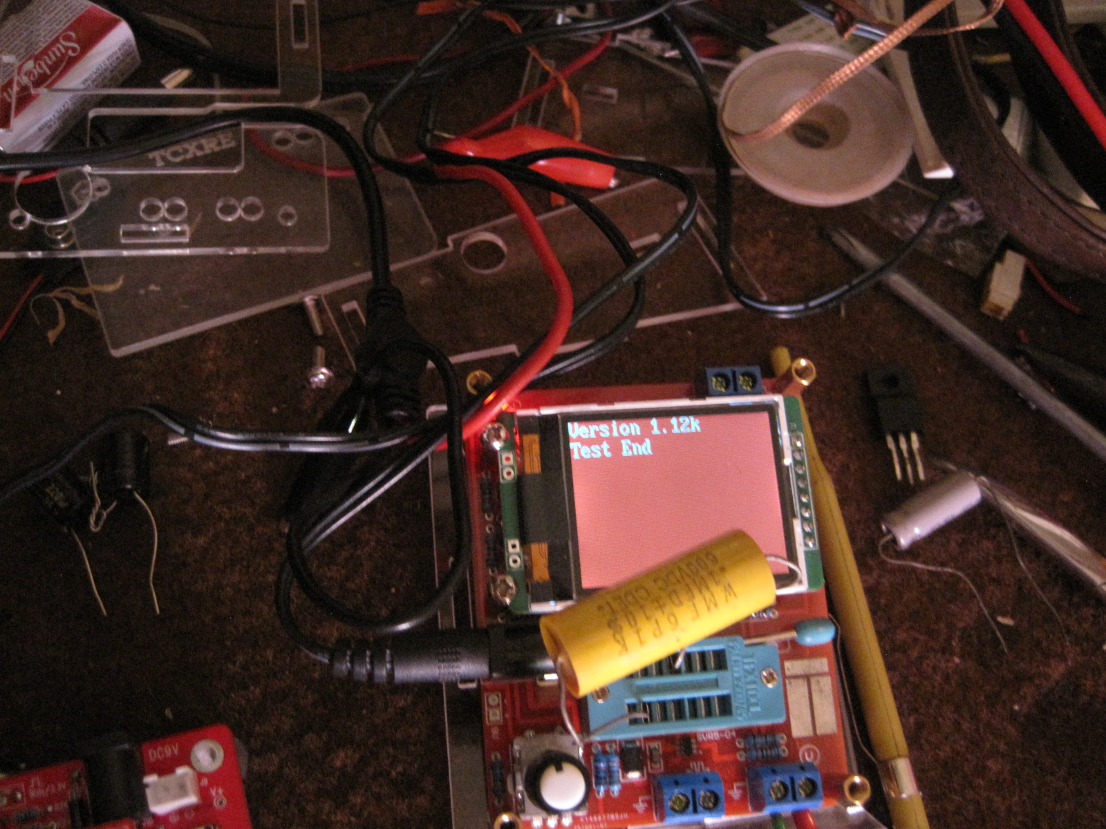

      Longtime lurker here checking in - I finally got cable internet a little while ago, never be able to go back now...
      Anyway, got tired of not having a working esr meter so tried another one, this time from aliexpress, a supposedly pre-assembled- and working one - but it doesn't work; the problem is it won't measure the capacitor during self-test, just keeps flashing the '>100nF' and 0pF
      till it times out and says 'end test' (or whatever). Over a period of 3 days I must have tried to
      complete the self-test 2 or 3 dozen times, and then this morning it finally completed the test once, by correctly reading the 100nF cap hooked up to it, but after the test it still couldn't read any component correctly, and was once again found unable to complete the self-test ( wouldn't read the .1 cap ).
      Also, the pins on the 'chip socket' don't ohm out with respect to the numbered pads (1,2,3)
      like they did on previous ones, can someone please tell me what the chip socket pin-out should be?

            that's an "AY-AT" loads of info on that.
            btw, to calibrate it you need a 220nF cap for best results.
            a 100nF cap can be read as 99nF and then not complete the test - it must see 100n or higher.

              Make sure the cap isn't in the device until it starts flashing/asking for it, then use a 220nF as mention above, I've found if you put it in early the calibration can fail.

                    Re: ESR meter upgrades
                    I recently got a new part test unit thingy... Here it is.
                    Not sure what the model is but i think it's the one stj has been calling 'AY-AT'.
                    The black box [the one you can't see in the photo :P] behind it is a 8 AA battery holder in place of the 9v battery, the reason for it is because the 9v battery holder for some reason just stopped working. [By that i mean the unit would not work at all even with a brand new cell.] One problem i had out-of-the-box was a broken copper track, But i fixed it.
                    This unit seems to be decent for the price and i'm happy with it.

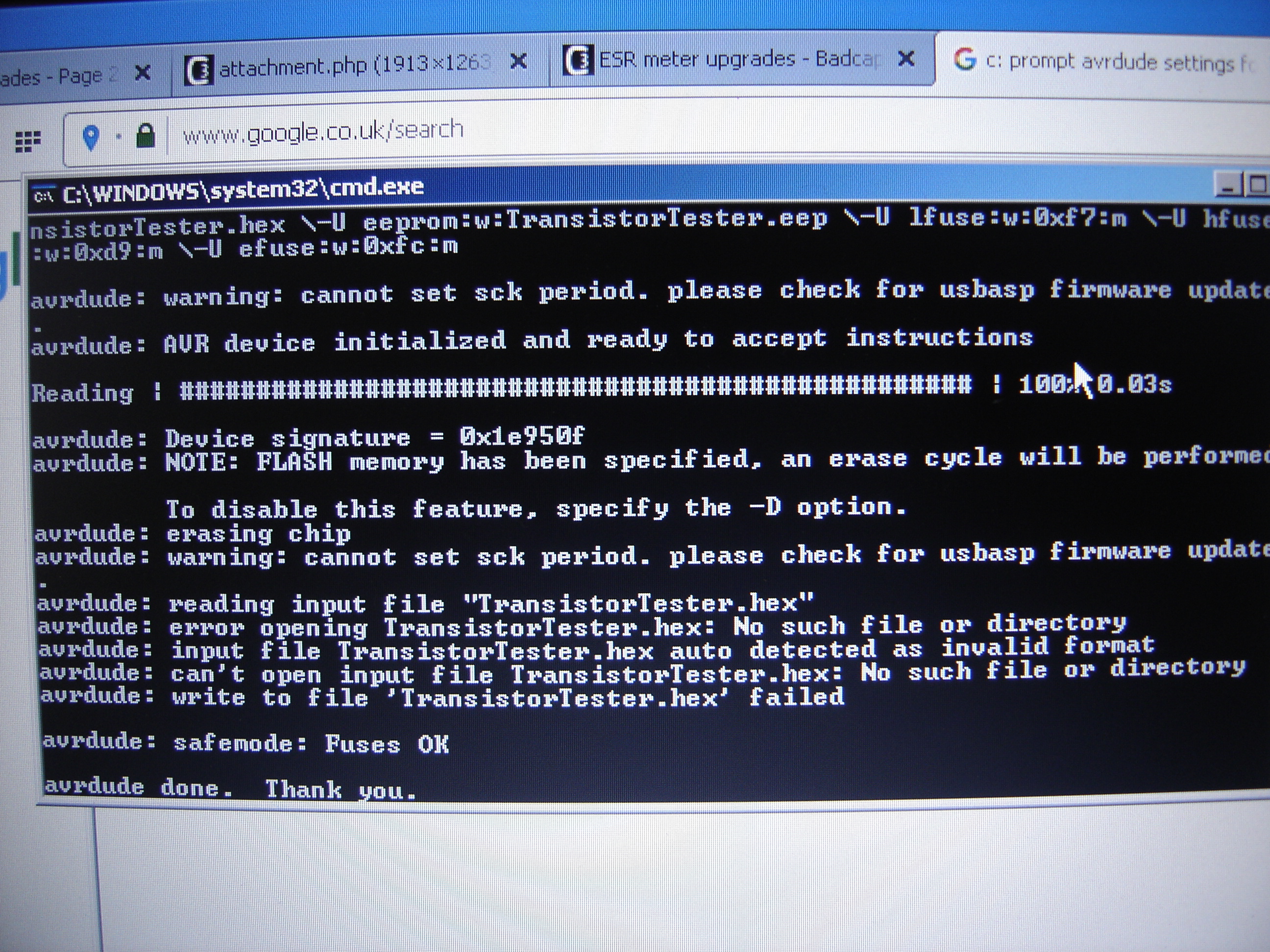

                            I know this is a long thread, I have a LCR-T4-H which I manage to corrupt in some way all it would allow me to do is adjust the contrast or in test mode every thing tested weather it was a capacitor resistor inductor showed 4.7 volt
                            on the display, reading all your posts, I decided to purchase a usbavr programmer. this arrived and drivers etc were loaded,not knowing much about programming I cut and pasted your avrdude file and finished up with this(see photos) and a LCR-T4 with a momentary blank screen on switch on.
                            All I would like to know have I bricked the atmega328, if so could I just replace the chip and reload your avrdude file.

                                Chances are you haven't broken it entirely, just uploaded a crappy firmware. Reflashing it might get you back into the land of the living without the need to replace the chip itself. I must have flashed 20+ broken firmwares to my tester when I first started playing with it, but it's working fine now!
                                Try this one? http://www.eevblog.com/forum/testgea...867/#msg659867

                                  am i the ONLY one who reads the text on screen / in your foto??
                                  you didnt program the mcu - only erased it.
                                  it couldnt find the right filenames to flash!!
                                  so program it again - this time make sure the files are there and the names match.
                                    LOL �� well spotted!

                                      No stj, I read it too.
                                      Code:
                                      error opening TransistorTester.hex: No such file or directory
                                      ^^Well there's your problem!
                                      Well, that and the fact that I don't think anyone posted a precompiled T4 firmware in this thread. (I could be wrong but don't remember it at least).
                                      The link by jondoe above looks correct.
                                      Of course newer firmware exists, but this is a good start anyway!

                                        Yes well spotted stj, i totally missed that in the first picture.

                                          Thanks to all for your help,and to Stj for finding the error, unfortunately being very new to using usbasp I am having trouble after downloading program transfering it to avrdude files, what files would I need to add to this (
                                          avrdude -c USBasp -P usb -p m328p -U flash:w:TransistorTester.hex \-U eeprom:w:TransistorTester.eep \-U lfuse:w:0xf7:m \-U hfuse:w:0xd9:m \-U efuse:w:0xfc:m) to get the flash for mcu to except, sorry if I sound a bit thick
                                          but I have been told this can not be done, only through arduino, by local computer engineer, but I think you guys know a lot more than he does.
