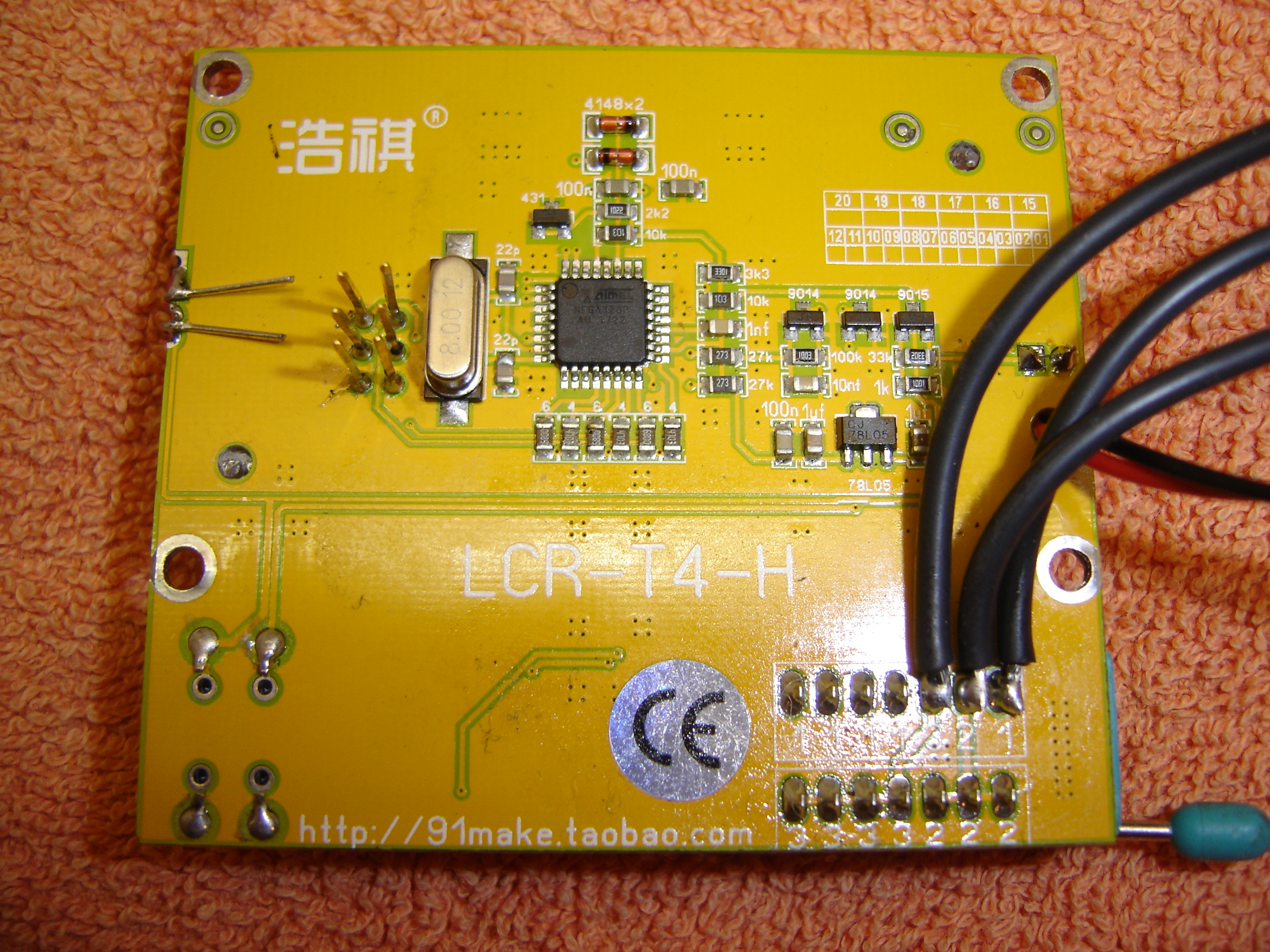

            #825
            Re: ESR meter upgrades
            Thank you all for your time and help.would not have got this far without it.
            Update,
            I decided to bite the bullet after multiple writing and erasing the chip think I tried every avrdude file I could, I fitted a new atmega 328p au smd chip and eureka it took the first firmware download,and this is the result. so may have a playround upgrading now it is working, what does the 16mhz upgrade achieve?
            John
              Congrats, nice solder work, used a hot air station I take it?

                  • england
                  #828
                  Yes you are spot on (hot air soldering) have been in the trade over 50 years so soldering is not a problem. Its programing I have problems with, but with help from all of you on this Forum I got a result, many thanks.
                  John

                    #829
                    Great work TEDDIBEAR!
                    Glad you got it working

                      • england
                      #830
                      Now that it is up and running what would I need to adapt this LCR T4 to work with a rotary encoder & 16mhz crystal, if it is possible with this model. if so what firmware would I need.
                      John
