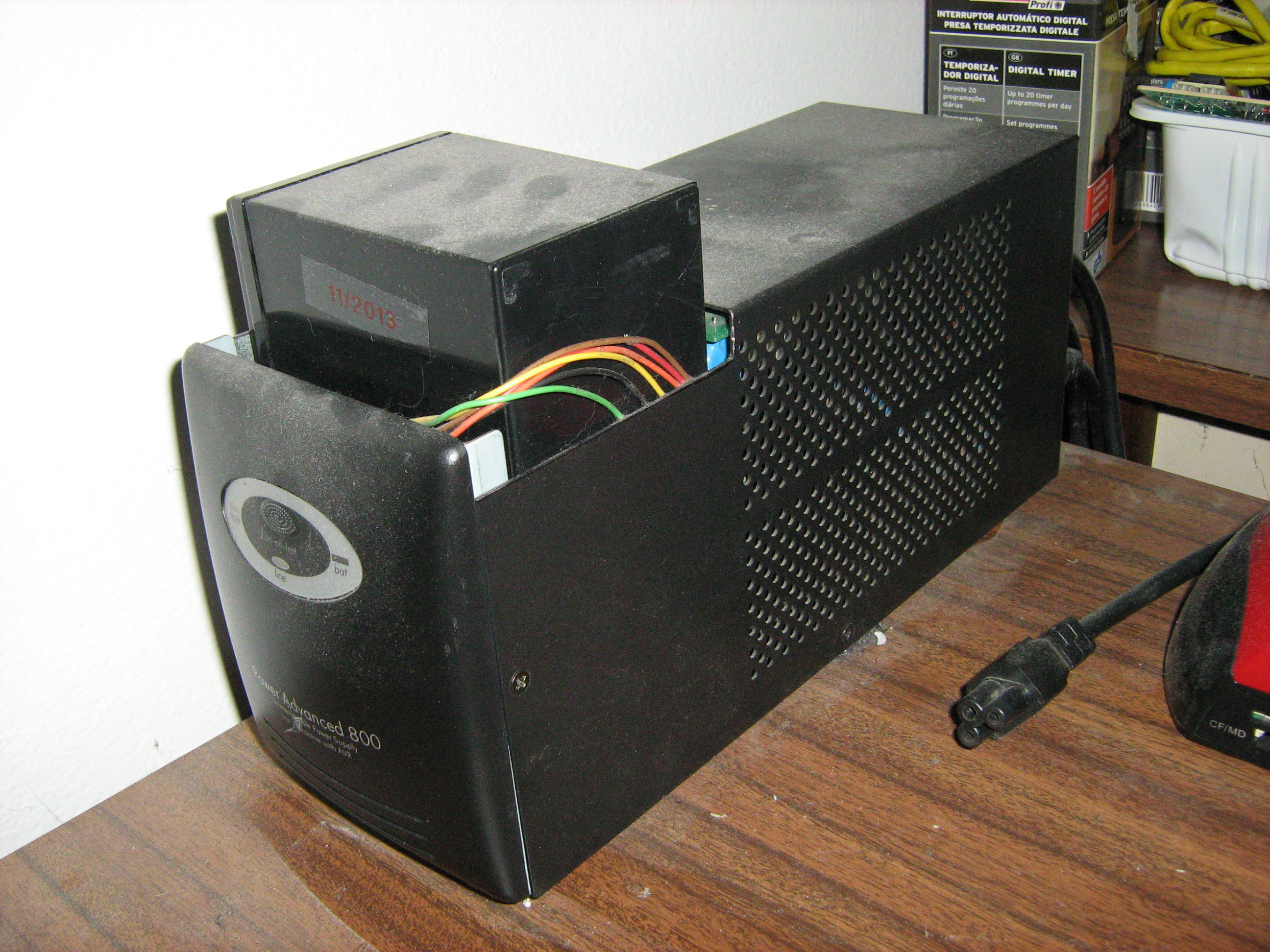

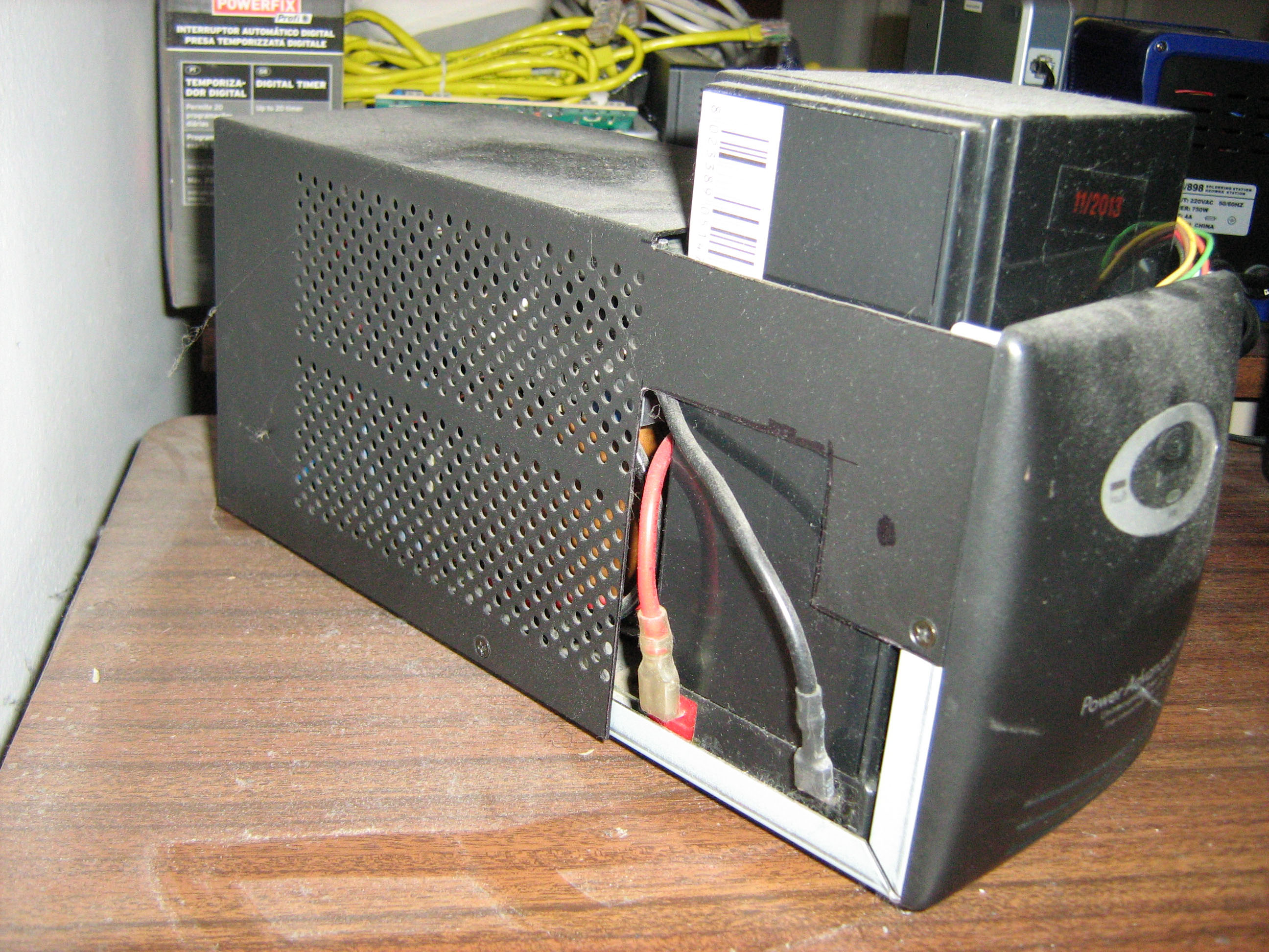

      I made this many years ago.
      This ups is over 10years but it's a good one, not so powerful but enough for my business. It came with a 4,5Ah battery that is cost/energy expensive. The standard nowadays is 7,2 or 9Ah, one or more in series, cost/energy cheaper and easier to find.
      So i cut the metal chassis and fitted a 7,2 one easily. I filed the cuts so they're not sharp and there's not way the battery poles could touch the chassis.
        If you get another UPS like that to fix, try hooking up a car battery next time. You will get much much longer run times. Not to mention the fact that you will also have a spare car battery if the one in your car goes weak or needs a jump-start.

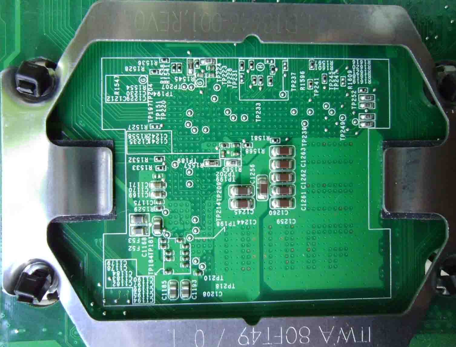

                      I acquired a Gigabyte GA-7BESH-RH dual LGA771 motherboard with a single Xeon 5140
                      Xeon 5140 are cheap, so I bought a second to see if it fixes issue of only half memory being recognised, but then wondered how I was going to cool it
                      771 coolers are scarcer than proverbial in Australia, and exchange rate coupled with shipping makes sourcing from USA prohibitive

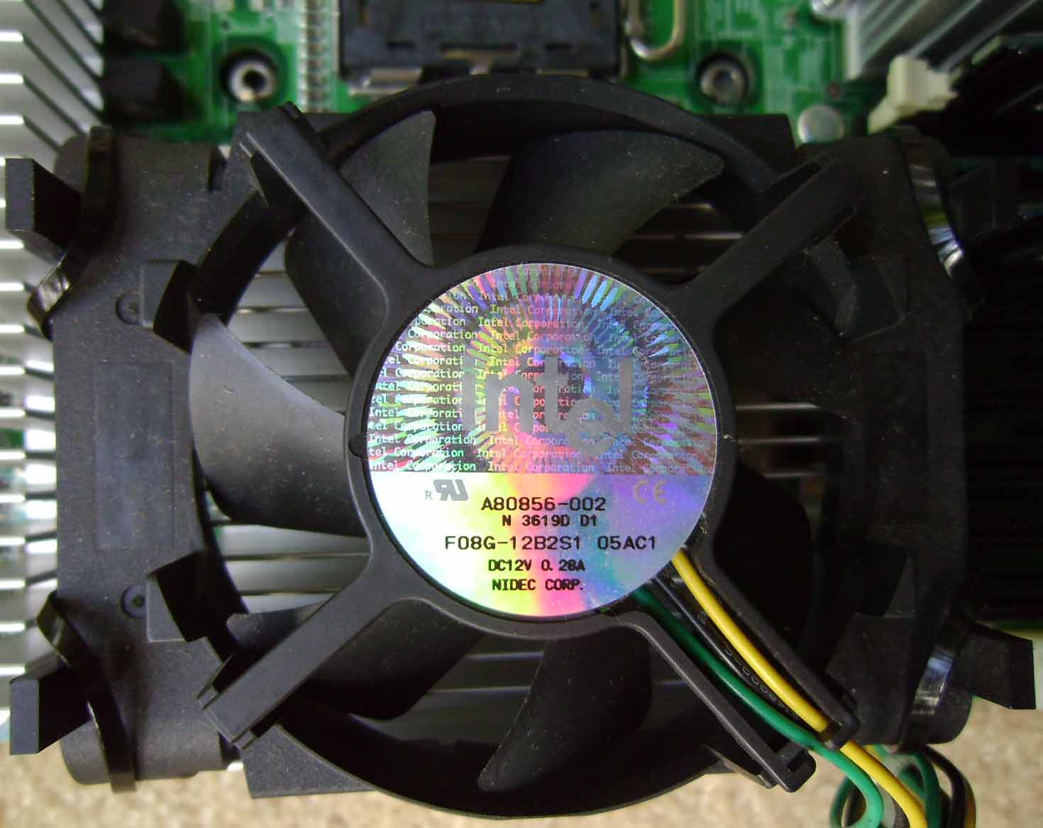

                      So I decided to use Socket478 HSF(s) held by ubiquitous cable ties
                      I haven't got second Xeon 5140 yet - here's original, only 65W TDP and this cools it well

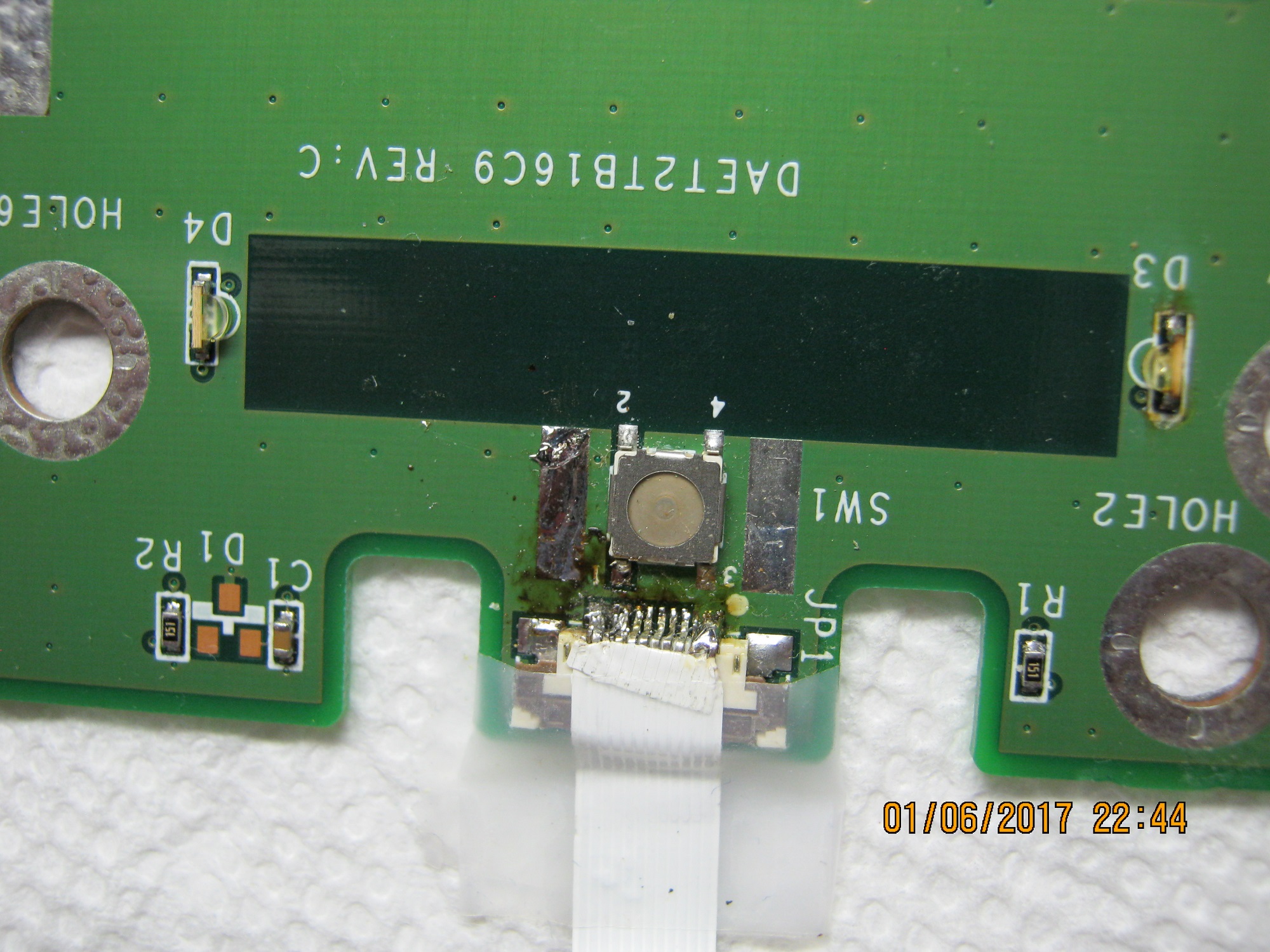

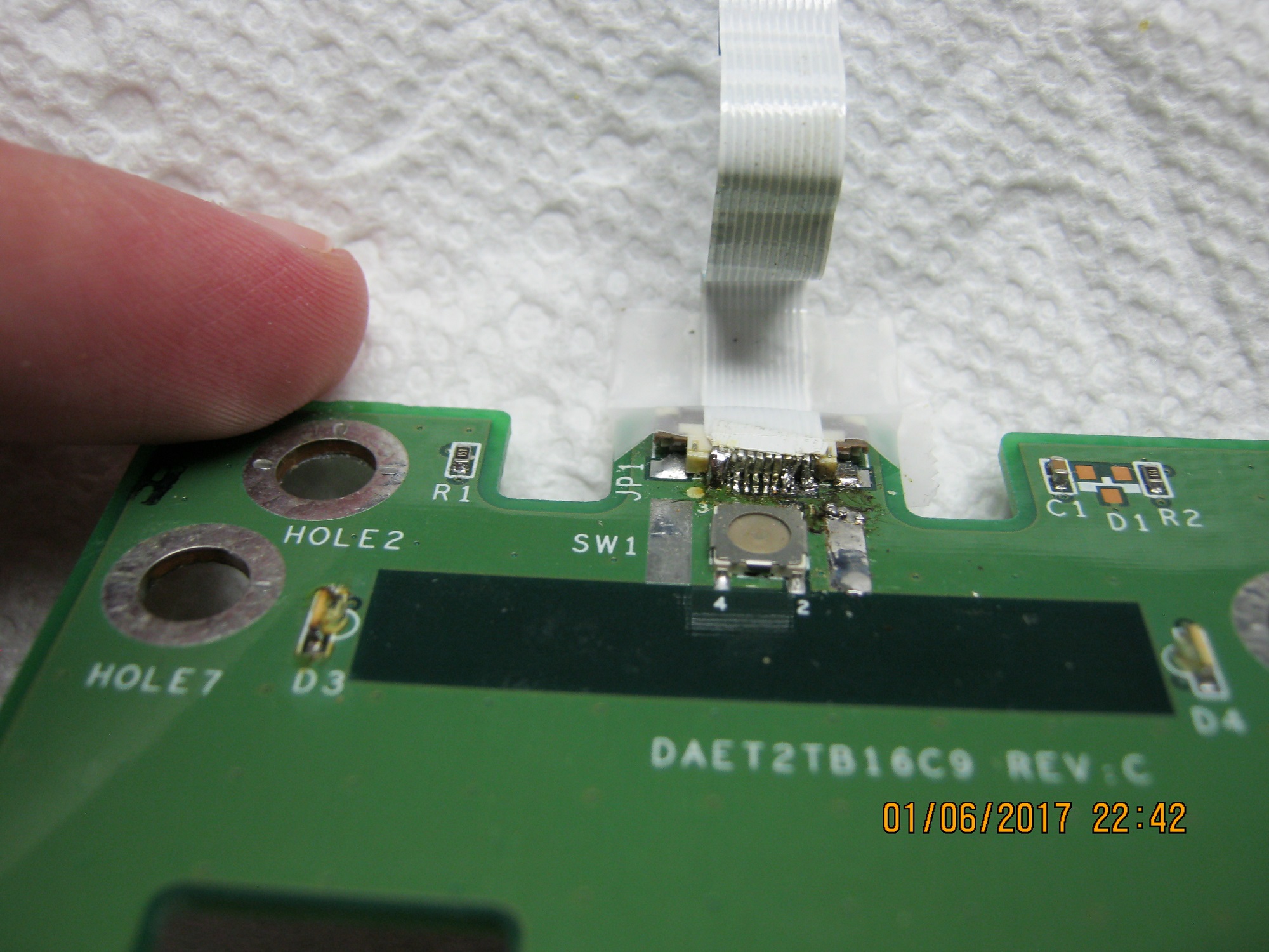

                        That old HP laptop with the "repaired" fan also had a damaged touchpad cable. Instead of spending $3.90 on a new cable, I soldered it down. This mess actually works.

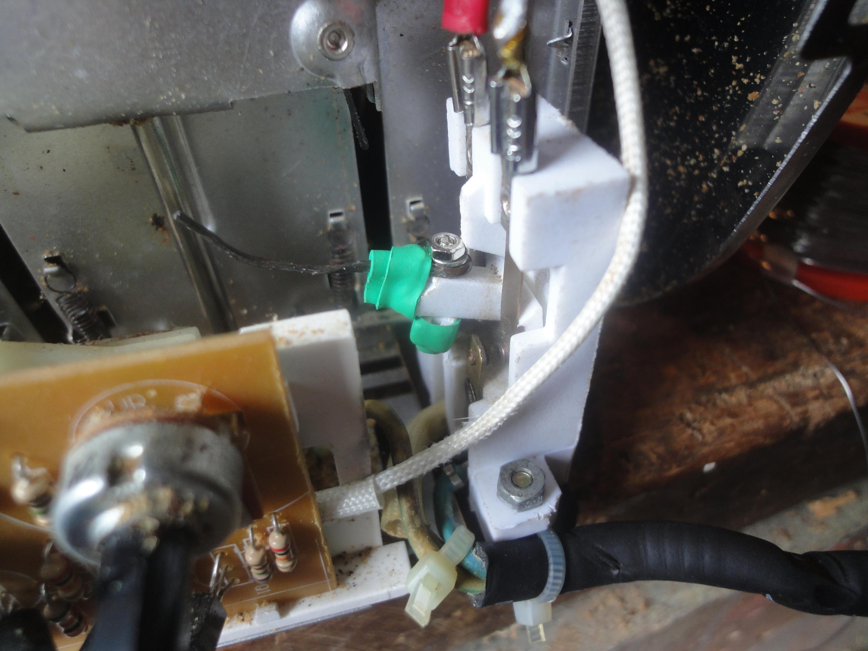

                                    Here's something a little different - the toaster died over Christmas (the main switch fell to bits) and I had to replace it with a dissimilar one.
                                    The actuator was all wrong (had to snap it off and replace with a screwed-on piece of hairclip) and I had to make a mounting plate to bolt it onto the chassis as the holes were misaligned, and also it would have meant 240v input wires shorted directly to the chassis.
                                    I had to crimp and solder the heater leads to some spade terminals.
                                    It works!
