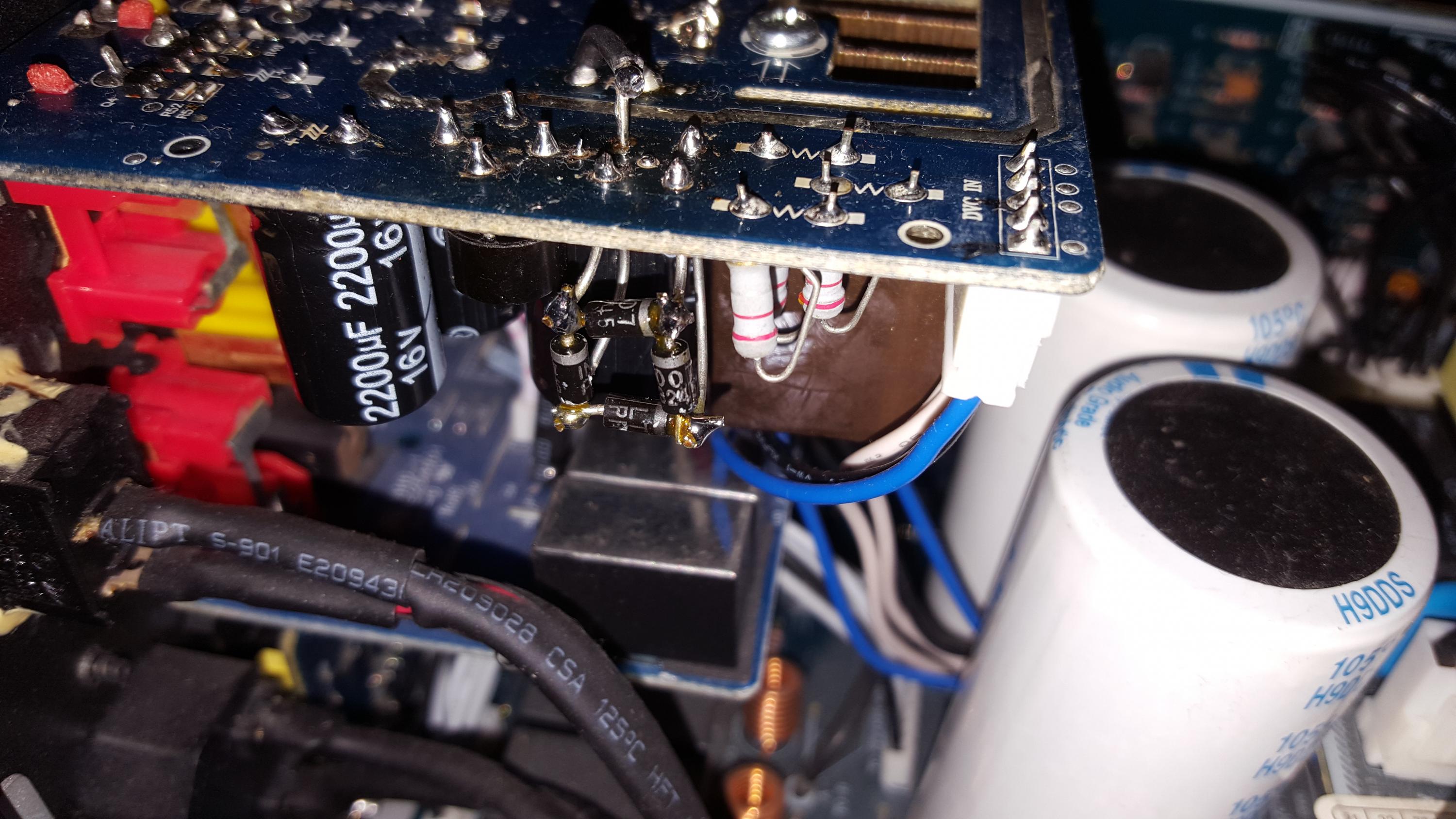

                                Originally posted by madan1
                                Back to basics ( and of course it is a temporary fix.. "temporary" )
                                We need Electroboom here to say That's a FULL BRIDGE RECTIFIER!
                                Regarding the temporary part... as my dad would say about a friend of his who borrow his car wrenches: Oh he didn't steal them from me. He just borrowed them "temporarily"... for almost 20 years.

                                  #516
                                  Re: The ghetto mod thread
                                  Originally posted by stj
                                  shame about the track damage.
                                  why is there so much flux on the diodes??
                                  The board is made out of cardboard... as soon as it smells a hot iron and the tracks start to run away.. no, realy.. cambridge audio - engineered in the UK, made in the PRC with the crappiest boards available! Even straight out from the factory, it had damaged tracks and solder blob bridges.
                                  And in addition, I had to remove/install several times the original bridge rectifier and even swap it with the other one ( next to my ghetto fix ), before being sure it had failed. The rectifier was not dead, but partially working.. it was outputting 100% of the negative rail and about 70% of the positive.
                                  About the flux - I just did not care to clean it.
                                    • 31293

                                      #518
                                      But do you know what's the funny thing? They've put a big ass 1.4KW toroidal transformer which weights a ton! This is an expensive hardware part and most manufacturers tend to save money from it. Such transformers can be found only in the high end products of the other companies ( onkyo, denon, yamaha... ). I really do not see the logic here - "let's use a 100 buck power supply, but let's cut $10 from the boards.. yeah... great idea!"
                                      Oh, and another funny thing - the sucker sounds better than my high-end yamaha aventage... go figure

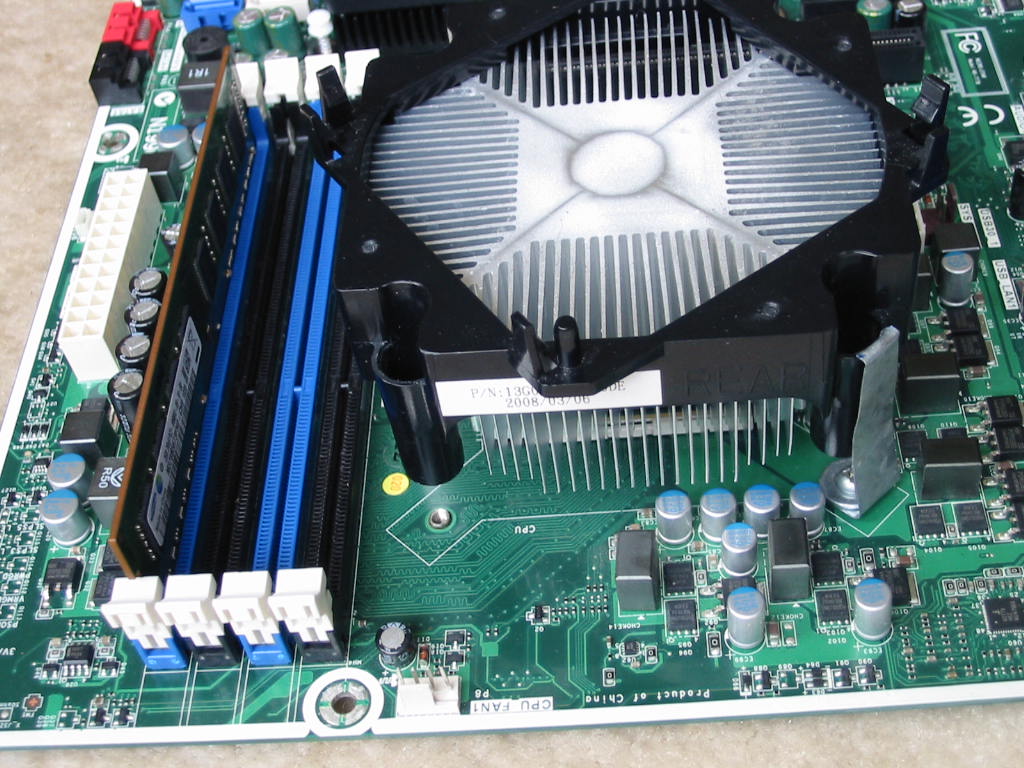

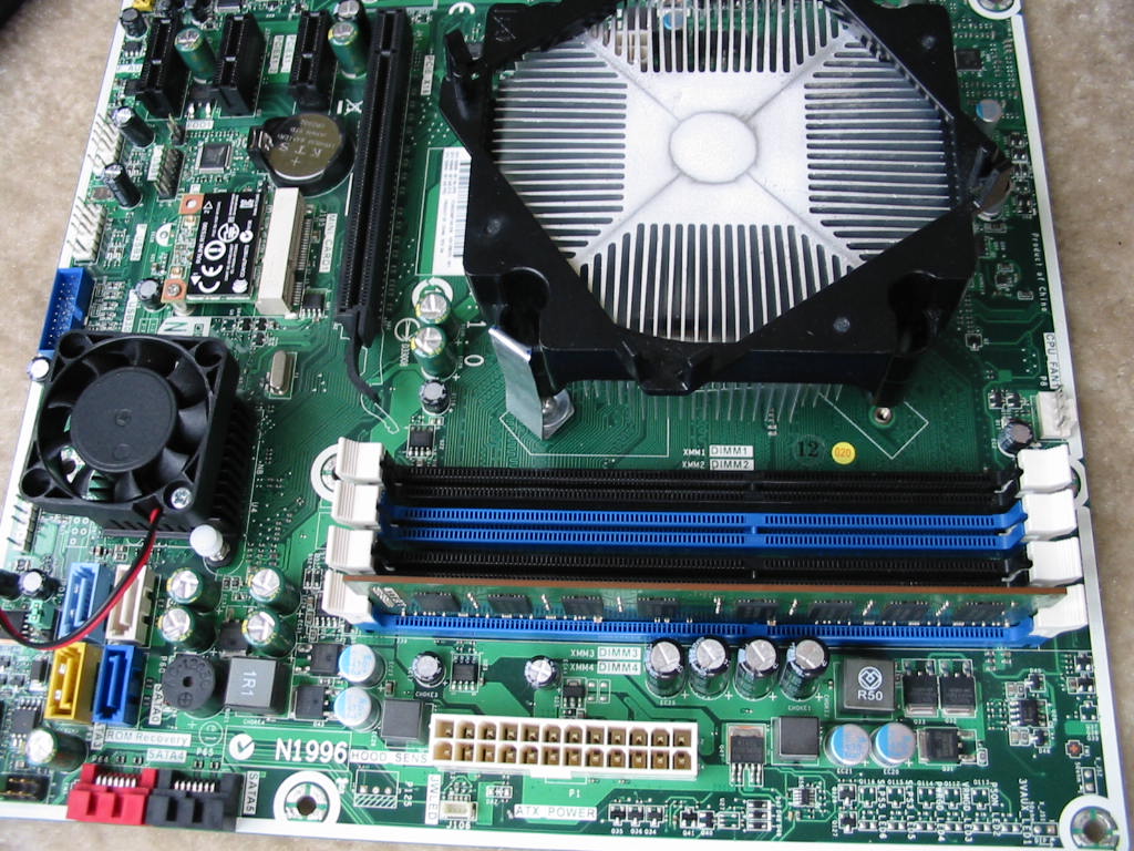

                                          MSI MS-7778 “custom” APU heatsink
                                          What do you do when you don't have the right parts (heatsink), but you are determined to finish the build?
                                          Info: HP Jasmine/JasmineR (MSI MS-7778) socket FM2 motherboard with non-standard (for AMD) heatsink mounting. I think the mounting pattern on it is/might be LGA115x. I didn't have a spare heatsink with that mounting pattern, so I adapted my own.
