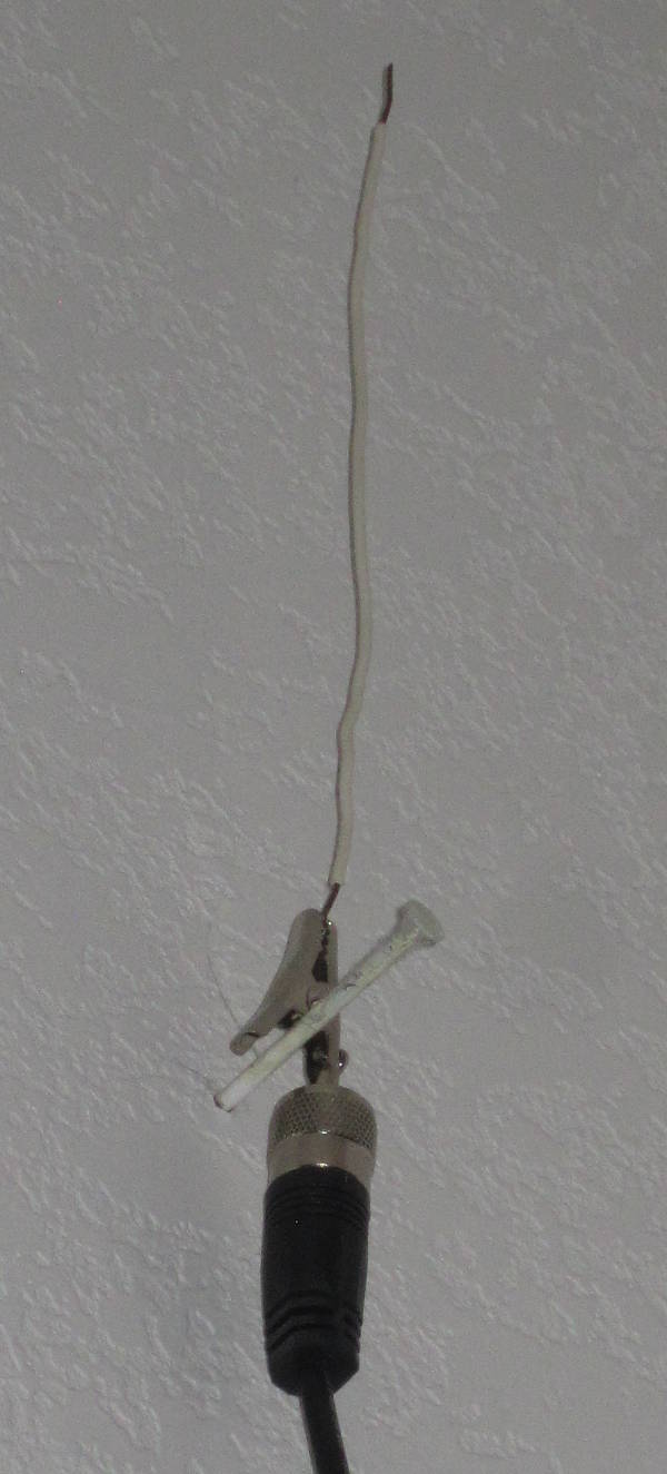

    Come on, more ghetto mods please!

      Re: The ghetto mod thread
      that's not ghetto - it has a connector, last time i needed something like that i just stripped about a foot of the insulation and braid off!!
        You can afford sacrificing RG58? Dang!
          i used to have a reel of it, from the days of installing tv antenna's.
          now i have a 250m reel of CT100 from dish installing - now that is some good shit!! copper core, copper braid, copper foil!!!
            I have tons of 75Ω cable (RG6, RG59?), but so little 50Ω cable...
            75Ω cable seems like a dime a dozen feet, 50Ω... no idea where to even get it cheaply.

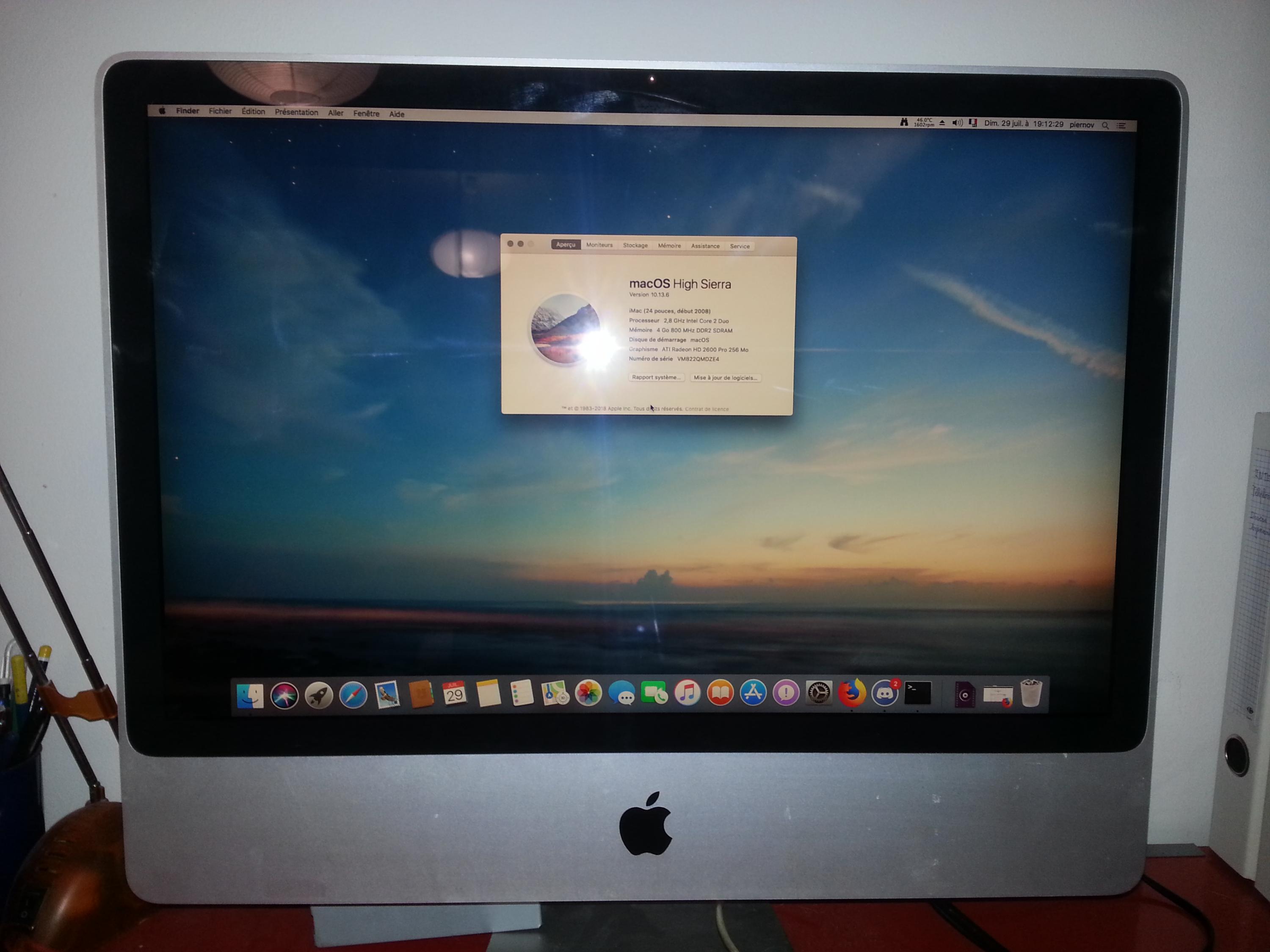

              #426

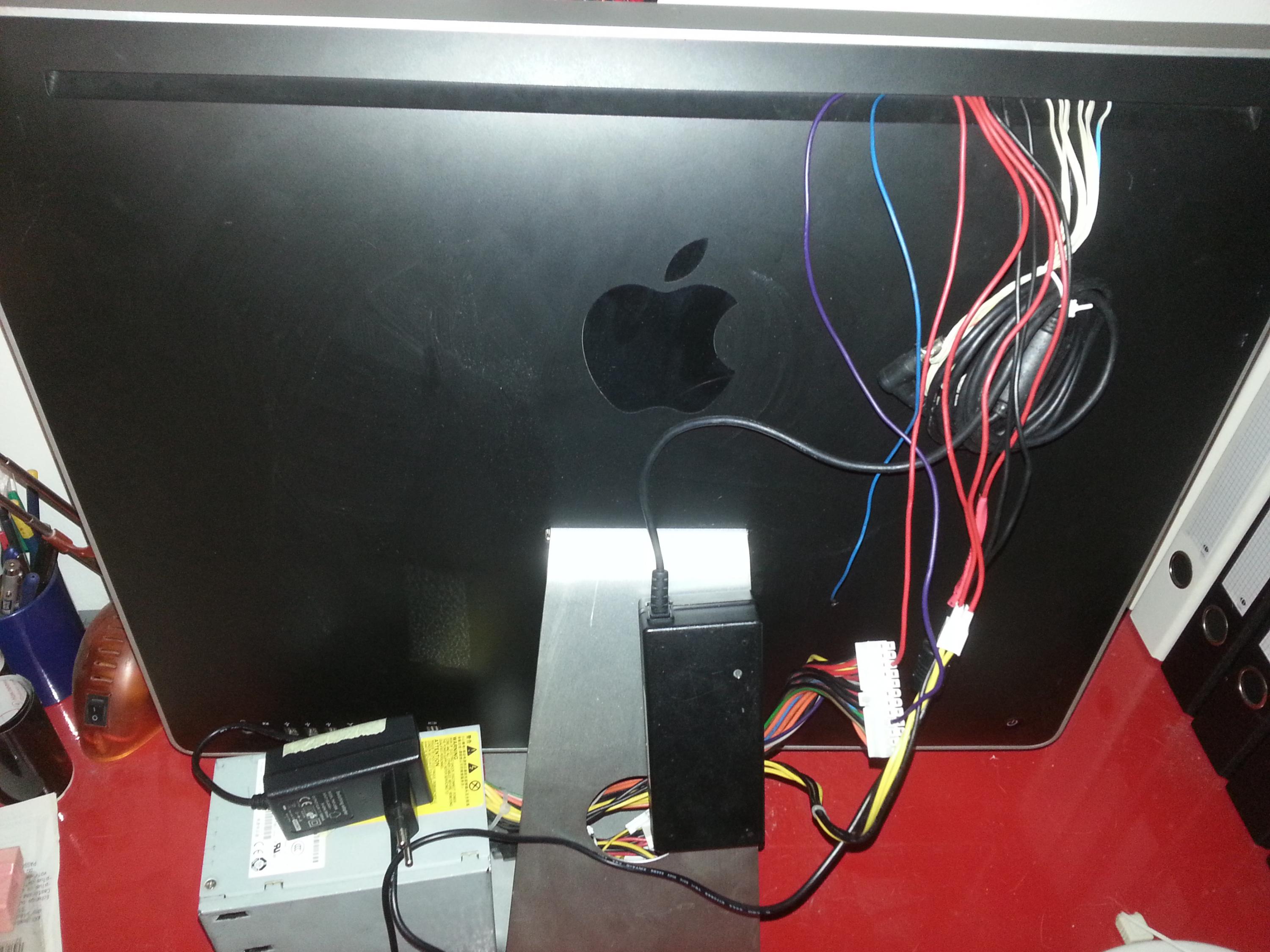

              iMac 2008 24" PSU mod.

                  #428
                  what voltages does it actually need??

                        #431
                        24V 3A for backlight
                        12V 16A
                        12VSB
                        (approximated max current consumption, keep some margin)
                        I used a 20V 4A laptop power brick for the 24V, works ok.
                        12V is from an ATX PSU.
                        12VSB is from a 1.5A adapter because I use the PSON signal to turn on the ATX power supply. Otherwise short the green wire of the ATX PSU to ground and you can tie the 12VSB to the 12V line.
                        The original iMac PSU has a built-in thermal sensor. The value of the sensor is not shown in software (all sensors are here on HWMonitor except this one). I couldn't figure out how it works so I use a software to control the CPU fan (or else it will go to full RPM after 30 seconds). Allows me to adjust the speed for decent cooling of the GPU as well, I want it to die as late as possible.
                          so if you changed the backlight to run on 12v you could use an xbox360 psu.

                            #433
                            Lol, nice work. Anything to get it going again.
                            It appears you are using a Bestec PSU. If it's a ATX-250-12E, you won't even need a 12V adapter for the 12VSB - the 5VSB on the Bestec ATX-250-12E will naturally reach 12V after a few years of use

                                #435
                                Good catch, it's an ATX-300-12Z though. Crap PSU but got 2 of them so one has its use now...

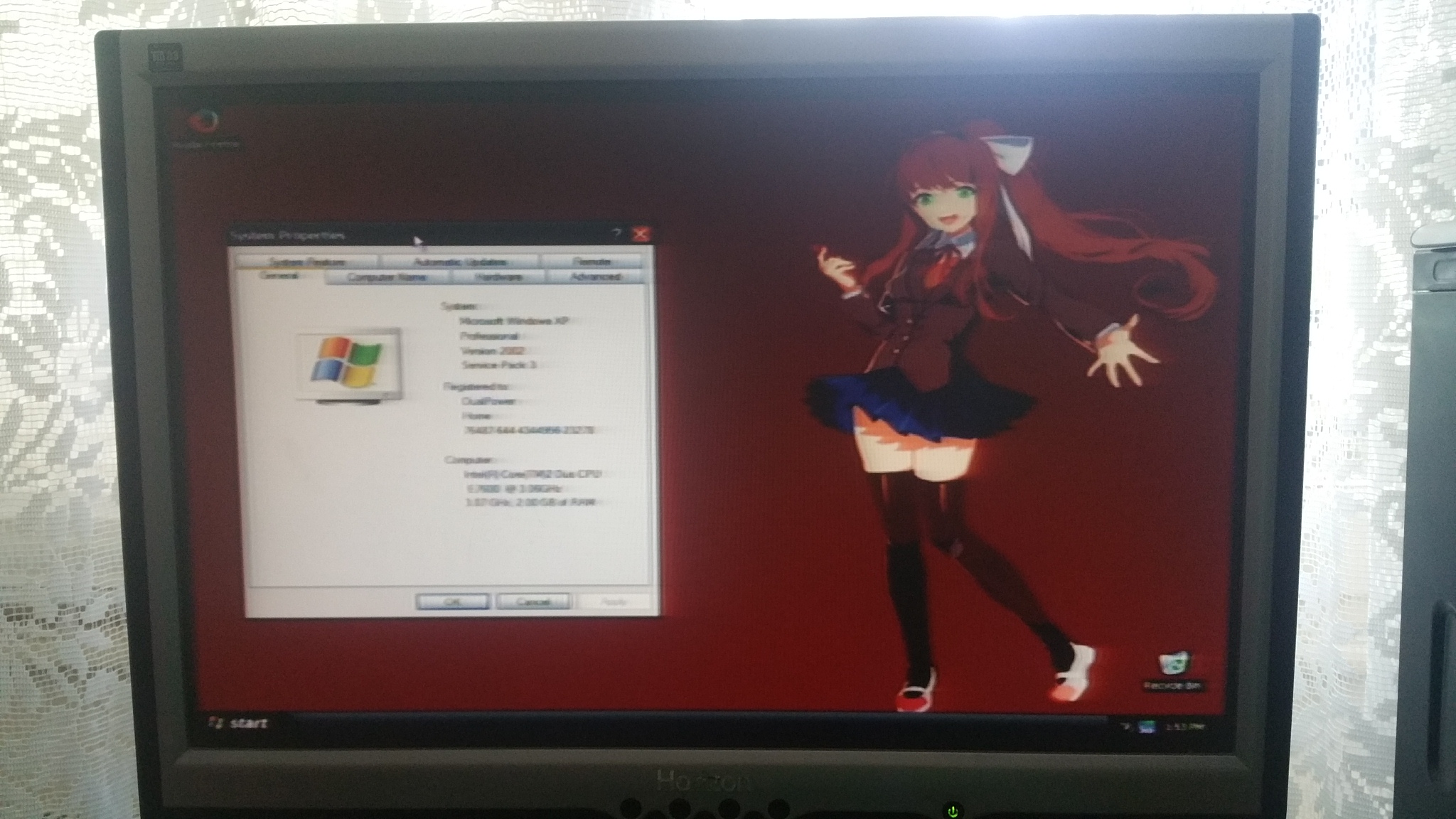

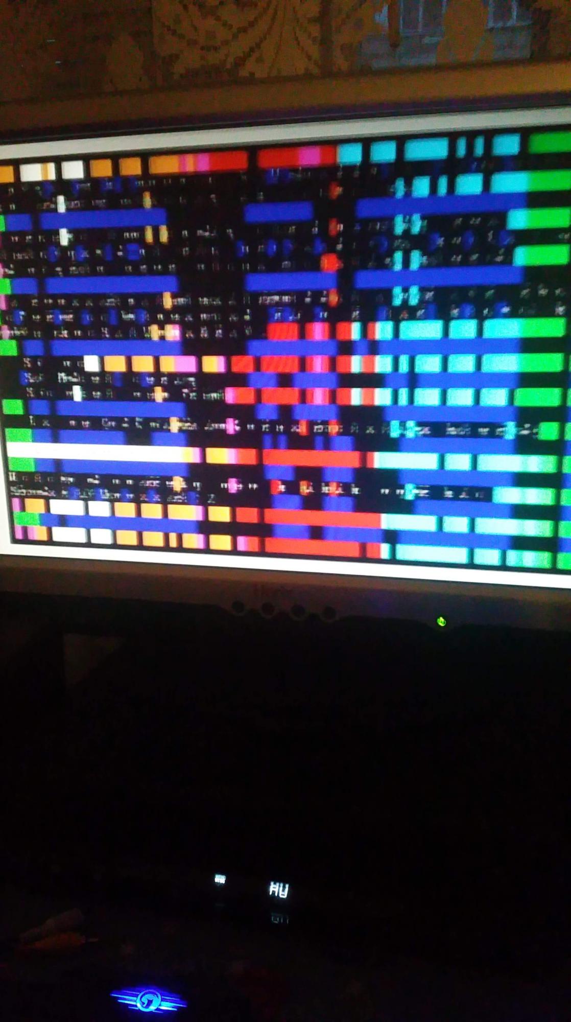

                                  Bought a Geforce 8400GS, turned out to be a artefacting lemon.
                                  Before:
                                  It had its moments when it wouldn't artefact though. Took advantage of that, and ran 4 rounds of Furmark,one after the another, bringing the card to 86*C each time.
                                  Surprisingly, the artefacts went away,never to come back, but just to make sure, I added a 12cm fan (which is kinda loud, but I didn't want to risk anything at this point) on the case side panel, and now everything is well, keeping the card at a cool 56*C (as opposed to over 70 without it before running Furmark).
                                  Here's a photo after the fix. Excuse the image quality, I'm using a DIY S-Video cable and that was the sharpest quality I could get. (I use the PC to tape shows and other things using the VCR to which the PC is connected.)
                                  I'm really going to laugh if this fix will be a long-term one, especially since I didn't pay a lot ($2.50 - 10RON) for it, and because the chip uses the G86 core.
                                    good background, shame about the o.s.

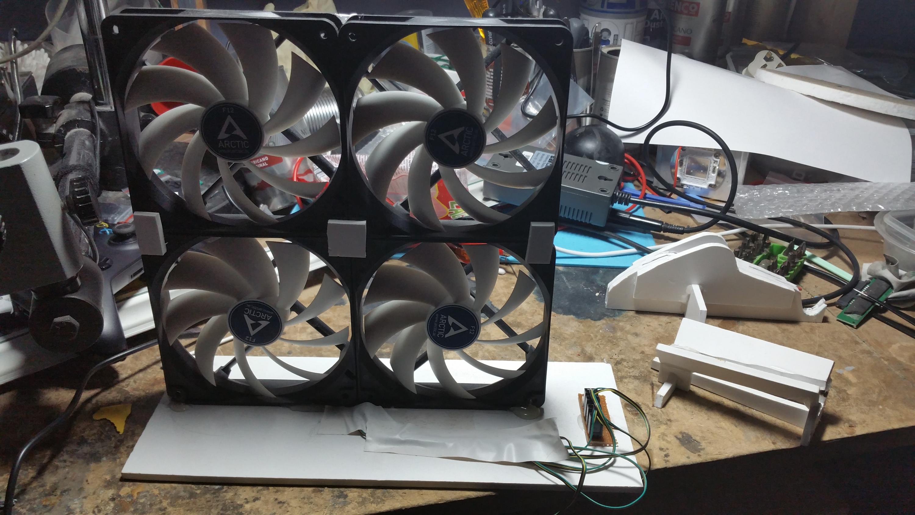

                                      #438

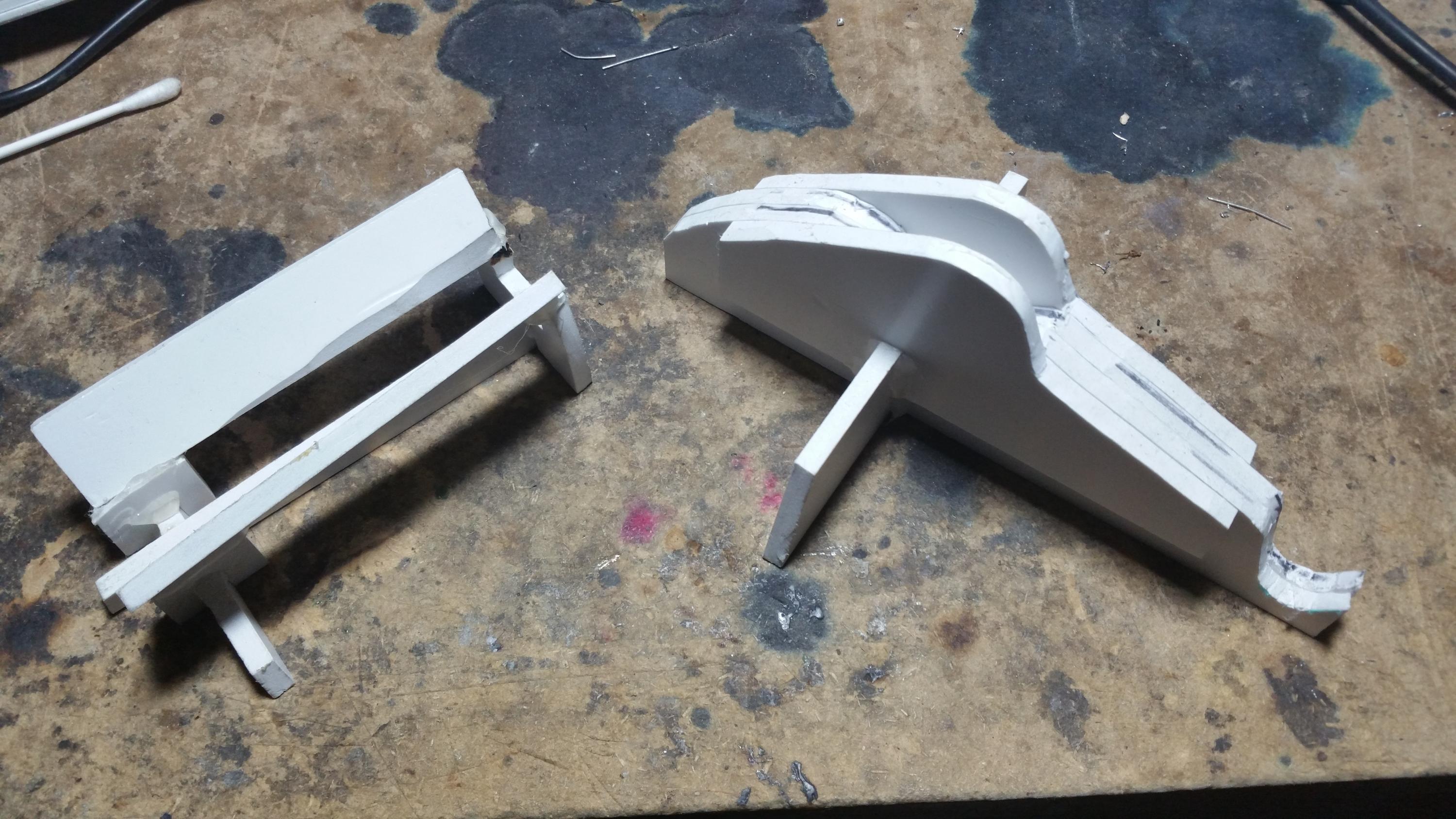

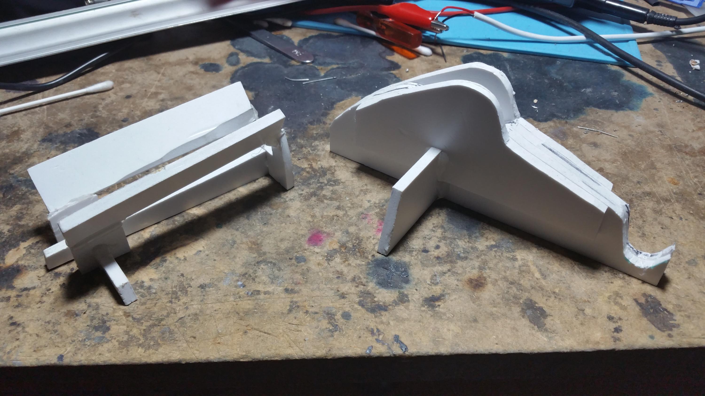

                                      Here's a fan mod and a couple of things I've made.
                                      Bonus points if you can guess what the two white things are for.
                                        R.I.P xp though, it did serve me real well through the years.
                                        With 2GB of RAM I felt like Vista/7 is too much for the machine I put the 8400GS in, so the best choice was XP (besides Linux)

                                          • 31301
                                          #440
                                          white bits remind me of a sword or gun stand.
                                          like you use to put one on a shelf.
