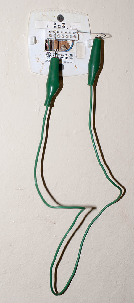

      Heater wouldn't turn on, relays just sit there and click, get random garbage, etc. Checked the basics, nothing showing bad. Was thinking bad control board from the garbage error light codes and rapid relay changes.
      For shits and giggles jumpered W to C by hand and suddenly it actually came on. Turns out the cheap thermostat that came with the place is bad. For time time being there's a new thermostat in place.

        i hope your not running mains through that green cable, i had one of those melt on me!

          24v @ 1 OR 2 AMPS.

            Correct, it's just 24VAC.

              I was running 8 amps through one of those cables. Don't have to say that these things don't like it, but will take it for a short while...
              However the drop across the cable was sufficient to cause problems with the inverter I was trying to power...
              Now I don't know if the insulation on these are good enough for 120V (but probably not 220V?) - Melting due to insulation failure or too much current?

                i burned one with 12v running through it - the current handling of the wire is less than it looks.

                  That wire and insulation looks quite thin.
                  Mine are much thicker and I have used them on 240v before without problem, although at fairly low current.

                    I dare you to stress-test one of those with 240VAC. If it doesn't melt, just go for 4 120V outlets or 2 240's.

                      Are those alligator jumper cables from Harbor Freight Tools? If yes, the package for those says they are 18 AWG and rated for up to 300 V (which, I am almost certain implies DC and not AC).
                      I've also ran 7-8 Amps through my HFT alligator jumper cables, and they got only slightly warm after a while.
                      ... unlike the test probes that came with my cheap HFT multimeters. Those can take only about 1-2 Amps continuously. With 5 and above, they get hot and their vynil coating becomes really soft and bend-y within a minute .

                        That particular one is fairly thin. They usually only get used for 12VDC @ 1A or less, 12V PSU to a breadboard power connector.

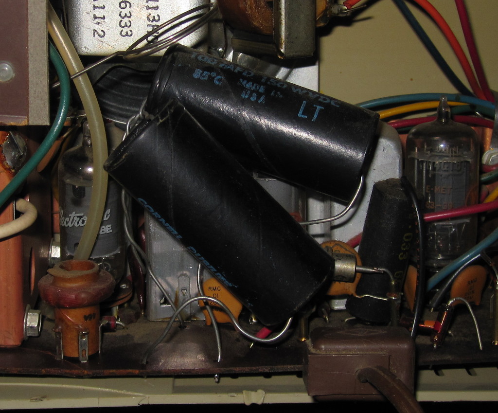

                          I guess this sort of qualifies for a ghetto mod, so I had to cross post this.
                          Alas this was not my handiwork. Thinking about 'undoing' this...

                            Insulation? We don't need no stinking insulation...

                              Yeah the cord was made into a cheater cord too, but I don't think that can be considered a ghetto hack anymore? No?
                              But yes, that's +120V, free for the touching... Then again, no isolation transformer in any case...

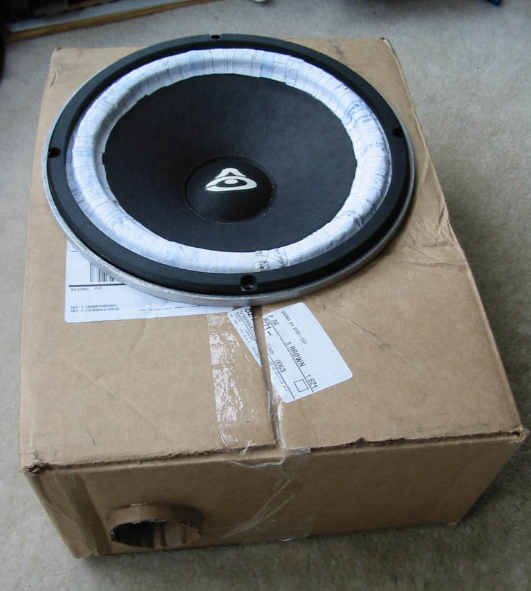

                                I don't think I need to do much of a description here (but you know I always do ).
                                Basically, I got four of these Cerwin Vega VSW-10 speaker drivers for free (see this post.)
                                I used almost the exact same method to make the paper surrounds as I did with these:
                                https://www.badcaps.net/forum/showpo...&postcount=112
                                Worked even better this time. Only different thing I did is I glued the paper surround to the speaker cone first rather than to the basket. Was able to center the cone (again) without having to remove the dust cap to put shims between the voicecoil and magnet. And these speakers had much tighter tolerances than the Nova-18.

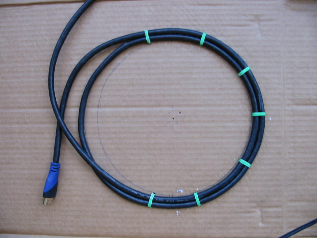

                                Also, I made the paper surround from many small pieces of paper rather than one big piece. It took a bit longer, but the surround has overall better shape, IMO. And here is what I used for the shape:
                                https://www.badcaps.net/forum/attach...1&d=1454559535
                                Yup, same old broken HDMI cable I used for the Nova-18's.
                                As for the cardboard test box... it's crap, I know . Took only 20 minutes to make, though. And it works more or less - better than free-airing the speaker anyways . The port doesn't seem to want to function properly, for some odd reason: the longer I make it, the less bass I get from the speaker without actually improving the low-end response . I guess I need to build me a proper wooden test box.
                                However, between that box and my Nova-18 speakers, I can't say which has less bass. Both seem to drop quite sharply below 70 Hz (especially the Nova-18). The funny thing is, the Nova-18 woofers seem to do better in the cardboard box. Meanwhile, the Cerwin Vega woofers don't sound that great in either. They are good woofers, though. When on the ground free-airing, you can definitely feel the whole ground vibrate a lot. I think they just need a proper box.
                                Forgo to mention that the test amplifier I used was also limited to about 1 to 2 Watts per channel, max. before introducing any audible distortion. So maybe the CV speakers weren't getting enough power. According to this,
                                https://www.badcaps.net/forum/showpo...postcount=1233
                                they need at least 5 Watts to meet stated specs.
                                Thoughts, comments, suggestions on this bodged piece of work?

                                  ^ you should hear my vintage Zeniths... cutoff is 12hz. You can't ever hear that!

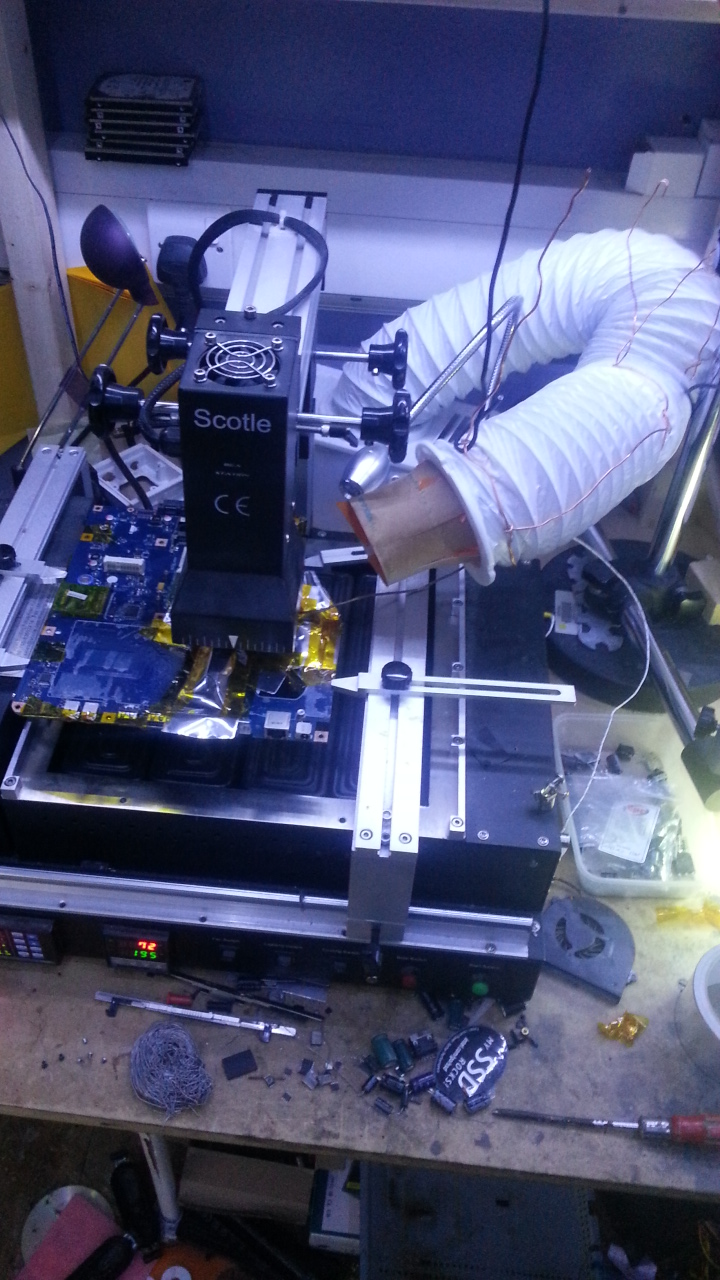

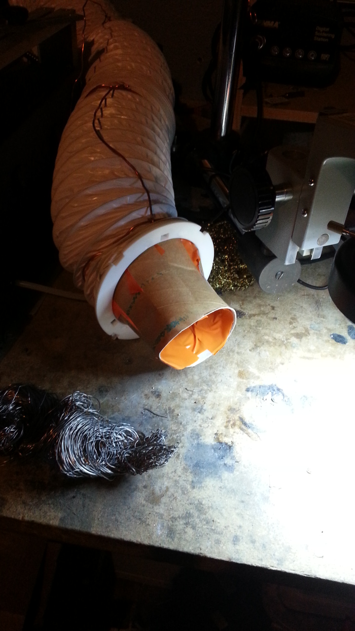

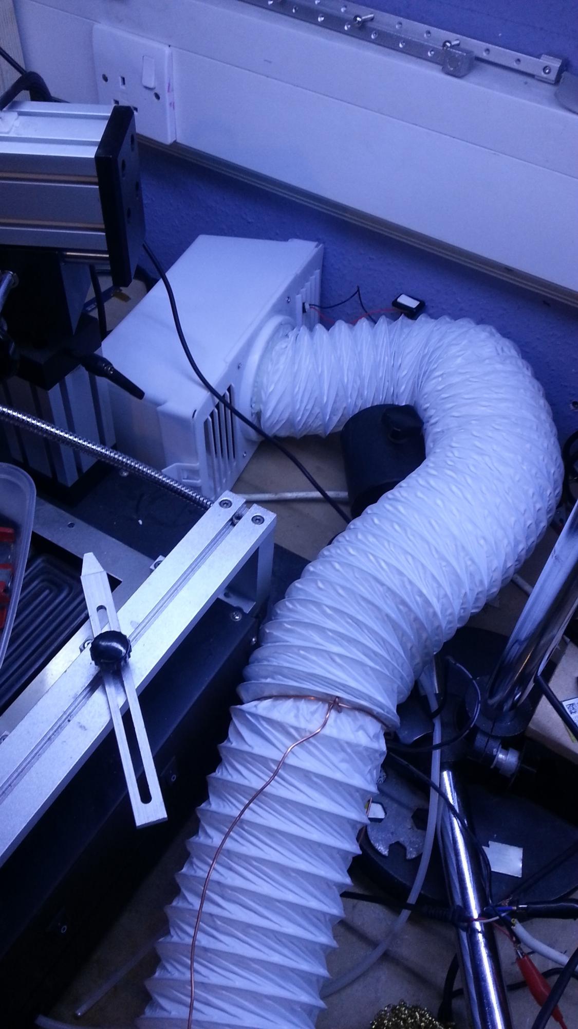

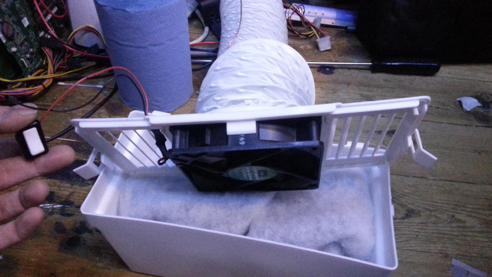

                                    Here's my ghetto fume extraction.
                                    A tumble dryer condenser box, some cooker hood charcoal filter, 12v fan and some mains cable (for strength).
                                    I think that tape should be coloured red momaka ? Port and box sizes are a science and it needs more Power !!

                                      I think you are mistaken here.
                                      Cut-off usually refers to -3 dB drop in SPL from speaker frequency response (though some manufacturers will extend frequency response window for their speakers up to -10 dB to get better numbers).
                                      To hear / feel 12 Hz of bass, you will need stupid amounts of power and air movement. Even 20 Hz takes a huge amount of power on multiple-kW car audio systems to reach reasonable SPL.
                                      So I doubt your vintage speakers will go down to 12 Hz. The cone moving at 12 Hz doesn't amount to much, really. Any sound you hear from that is mechanical noise from the speaker's damping system. Also, most vintage speakers have small X-max and fairly shallow motor magnets, so most will struggle to go below 50 Hz without loosing volume significantly.
                                      Nice!
                                      My friend tried to make a similar setup for his machine a while back, but wasn't as successful. He only used a 50 mm fan, so the fume extractor wasn't sucking the fumes all too well.
                                      How can you tell if it's working well, by the way? Less fumes in the shop? I imagine the smell of burned flux is not affected.
                                      Pretty decent Scotle machine as well - at least in terms of case construction, that is. If you get a chance, make sure the wiring inside it is done right too. My friend had an early ACHI IR PRO SC blow multiple times on him due to bad wiring (stranded wire on a terminal block with screws doesn't work too well if the wire ends are not tinned).

                                      And it was - originally. (I'm assuming you're talking about the foam surround.) The foam was old and crumbled into tiny pieces, though.
                                      It is, but there are also many computer calculators / software to help with that. I think I just need to flip the port 90 degrees (i.e. have it on a different side of the box).
                                      And yes, it does need more power. The cone movement on these CV speakers is quite stiff, which is good for high-power speakers - you don't want your cone shooting across the room when the low-end bass hits. Or do you?

                                        Thanks, i built it originally for bench soldering and sucks fumes about 8cm away. The smell was quite bad after doing a reflow but there wasn't any visible smoke going anywhere other than in the pipe and i didn't get a headache. I might upgrade to a mains fan and vent it up and out through my loft.
                                        Noted about the wiring, i do need to give it some maintenance when i get a chance the ratchet and pinion that moves the top isn't engaged so I'll check the wiring out then.
                                        Yeah, your tape needs to be like the original foam...red
                                        And yes, I like bass you can feel. Although when i turn my stereo up it vibrates one of my doors in its frame. (i need to attach some draft excluding foam strip).
