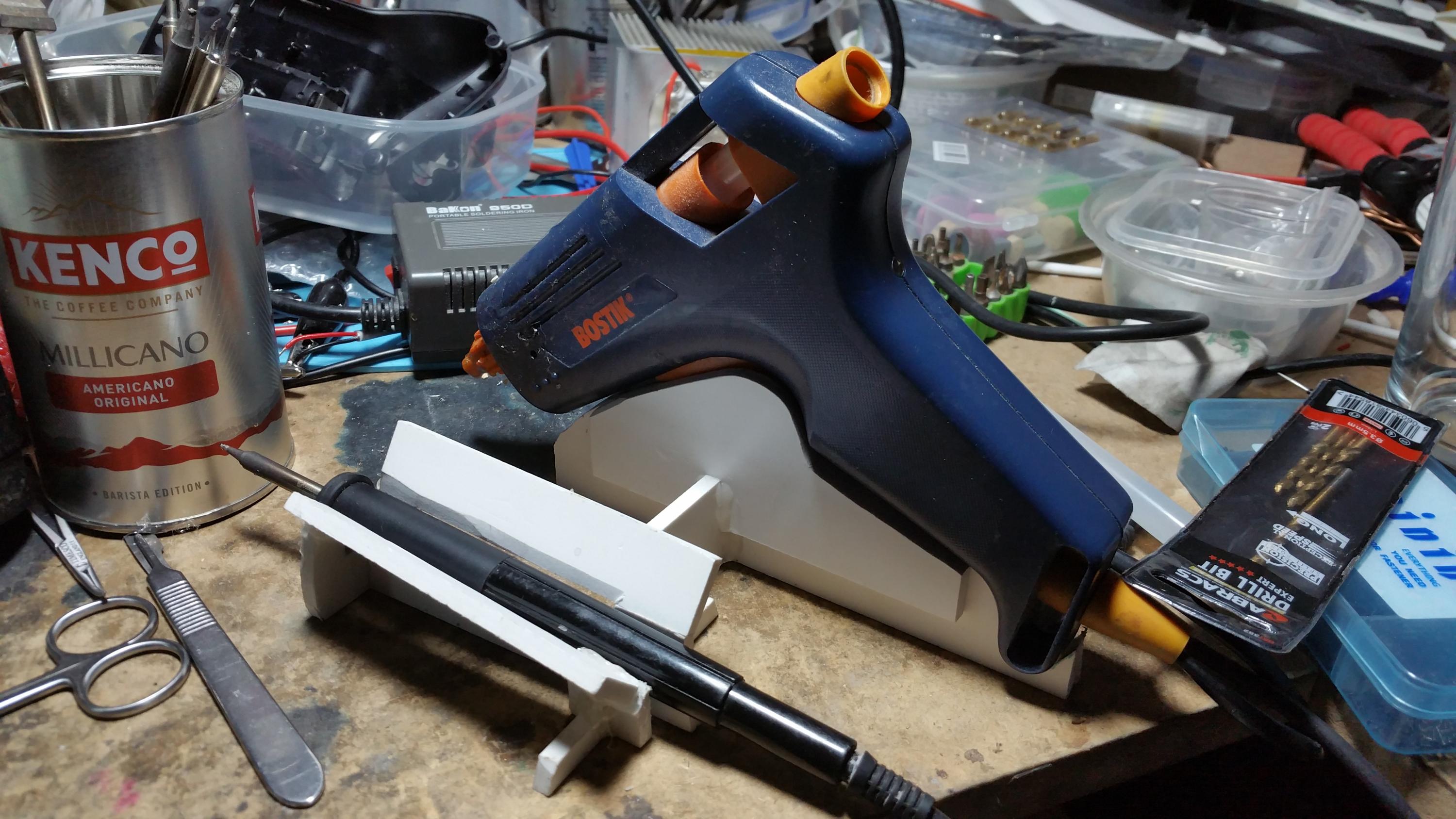

    Originally posted by stj
    white bits remind me of a sword or gun stand.
    like you use to put one on a shelf.
    Not so stabby shooty but close enough.
    It's had a trim since the last photo.

      ^ Soldering iron stand for the v-shaped piece was what I had in mind first as well (or perhaps a hot air wand "stand". But the other piece, I really couldn't think of anything. My first guess was some kind of special mobile phone and/or tablet test jig / holder. But a hot glue holder?? - no way. I just put my hot glue gun on the bench and hope that it doesn't leak (seems as some of my hot glue guns get older, the start to leak glue a lot more). That's one reason I don't keep them nozzle facing down anymore.

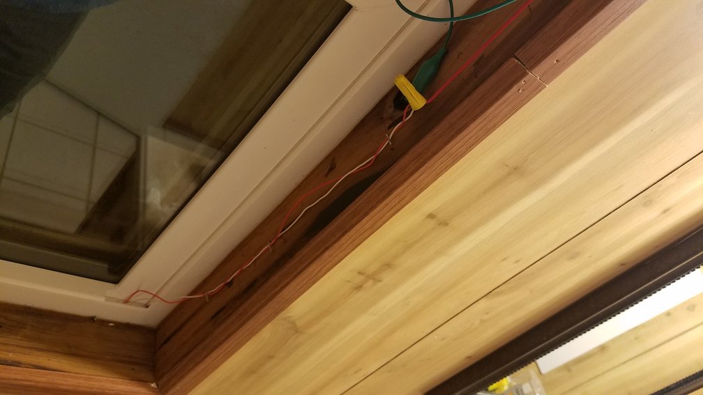

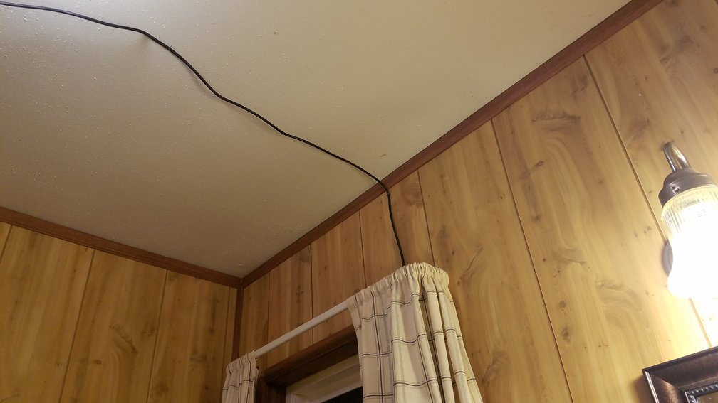

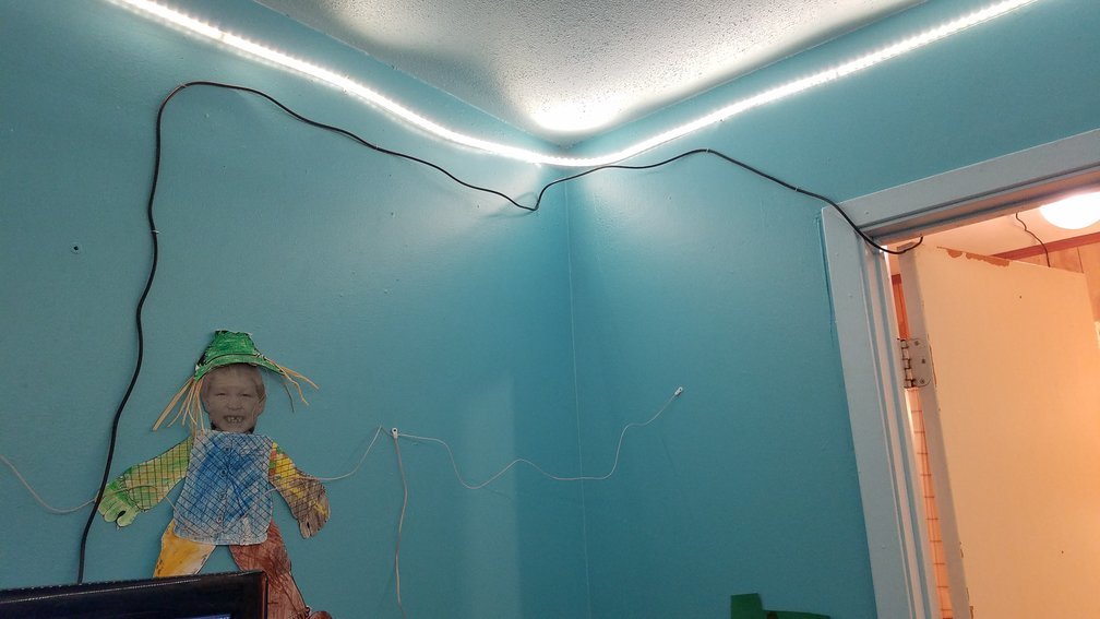

                      I have so many computers and junk in my room that EMI/RFI runs rampant. Not to mention the fact that there's an A/C condenser unit with 2 VFDs next to my bathroom. I also like listening to the radio. Obviously, there's a problem: 99% of the stations on the dial are swamped.
                      Here's my fix. I have some shielded wire from an industrial thermocouple attached to the stereo receiver's 75 ohm input. The shield is connected to ground. This goes to a set of jumper clips which goes to some bell wire. The white wire is connected back to the stereo receiver's ground, but is also connected to a ground stake driven into the ground. The red wire (signal) is connected to a homemade all-direction antenna, which was held from falling by a pair of old wire strippers. All the wire is held in place with staples.
                      This takes me from getting a couple staticy stations to 19 or 20 stations in crystal-clear stereo.
                      Suck it, RFI.
                      And bite me, FCC.

                        ^ Man, all of that long unshielded wire... just pray a lightning doesn't strike near your house, as that can easily fry your stereo (or at the very least, the receiver portion inside). Otherwise, everything else is proper

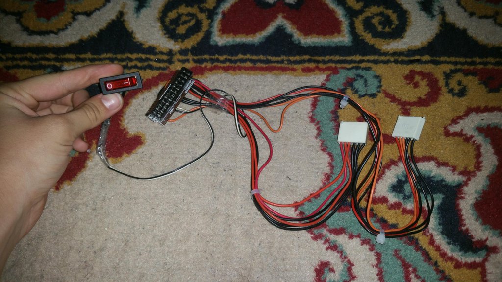

                          Anyways, my latest "invention"
                          ATX to AT adapter. Ripped a 24pin plug off a dead MSI board, used two AUX plugs off two PSUs, added a switch.
                          Works fine, just tested it on a 486DX-50 board I am going to work on as soon as I can source a ISA GPU.

                            Honestly FCC doesn't care.
                            However your neighbors do. If you're reducing the enjoyment of other peoples' enjoyment of RF services, this is a problem. The FCC was made to allow others who can no longer enjoy RF to take actions against people who make lots of RF trash hash.
                            If you have no neighbors, knock yourself out until you reach the next person nearest you who cares.
                            The normal rule of "out of sight out of mind" doesn't work for RF, where other infractions against others can easily be seen, you can't make the same argument for RF so a new set of rules need to be made - FCC rules.

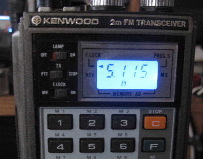

                                This actually is not a "ghetto" mod but I didn't want to make another thread. Maybe it's a ricer mod, but that backlight is sorely needed on this old HT 2m ham radio. In any case the 30mA incandescent backlight burned out. Of course I didn't have any 12.8V 30mA incandescent lamps that would fit that spot, so ... how about an LED!
                                Turns out a T1 LED fits. However I didn't have any orange or even white T1 LEDs, have a lot of red ones which would look funny. I did have a blue T1 LED. Tuned it to about 5mA and got:

                                  not bad, it's not easy doing led swaps - you often get uneven lighting because of the more focussed output.

                                    Yeah I was worried about that, but fortunately lucked out probably because of the size of the screen. Also the LED was a "flood" versus a "spot beam" LED (you can tell by the distance between the die and the top surface) so that probably helped a little.

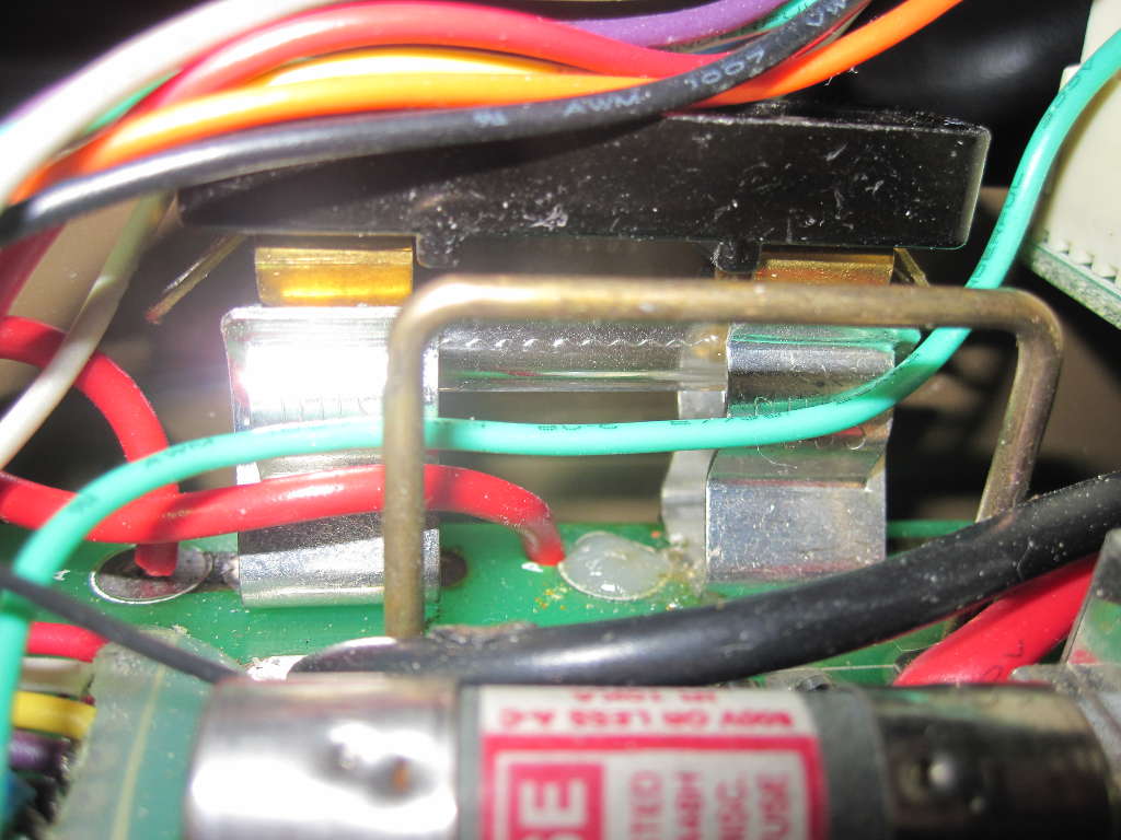

                                      Well here's my fuse.
                                      From top to bottom:
                                      - the colorful wires that pass data to/from the main board and the display board
                                      - the jury rigged black fuse holder frame
                                      - the gold plated contacts of the black fuse holder fuse
                                      - (foreground) the 10 amp shunt loop
                                      - the 3AG 3 ampere regular blow fuse
                                      - the original 10mm fuse holder nickel plated contacts
                                      - the green wire
                                      - the red wire that feeds from the front panel
                                      - the green main PCB
                                      - 10A measurement black wire
                                      - and finally the original 10mm x 38mm BBS4 fast blow 4A fuse lying there ready for the trash can.
                                      I guess it's not as ghetto as if I wrapped the endcaps of the 3AG fuse with aluminum foil to make it thick enough to meet the 10mm needed for the contacts, but oh well, it's a workaround to get this to work.

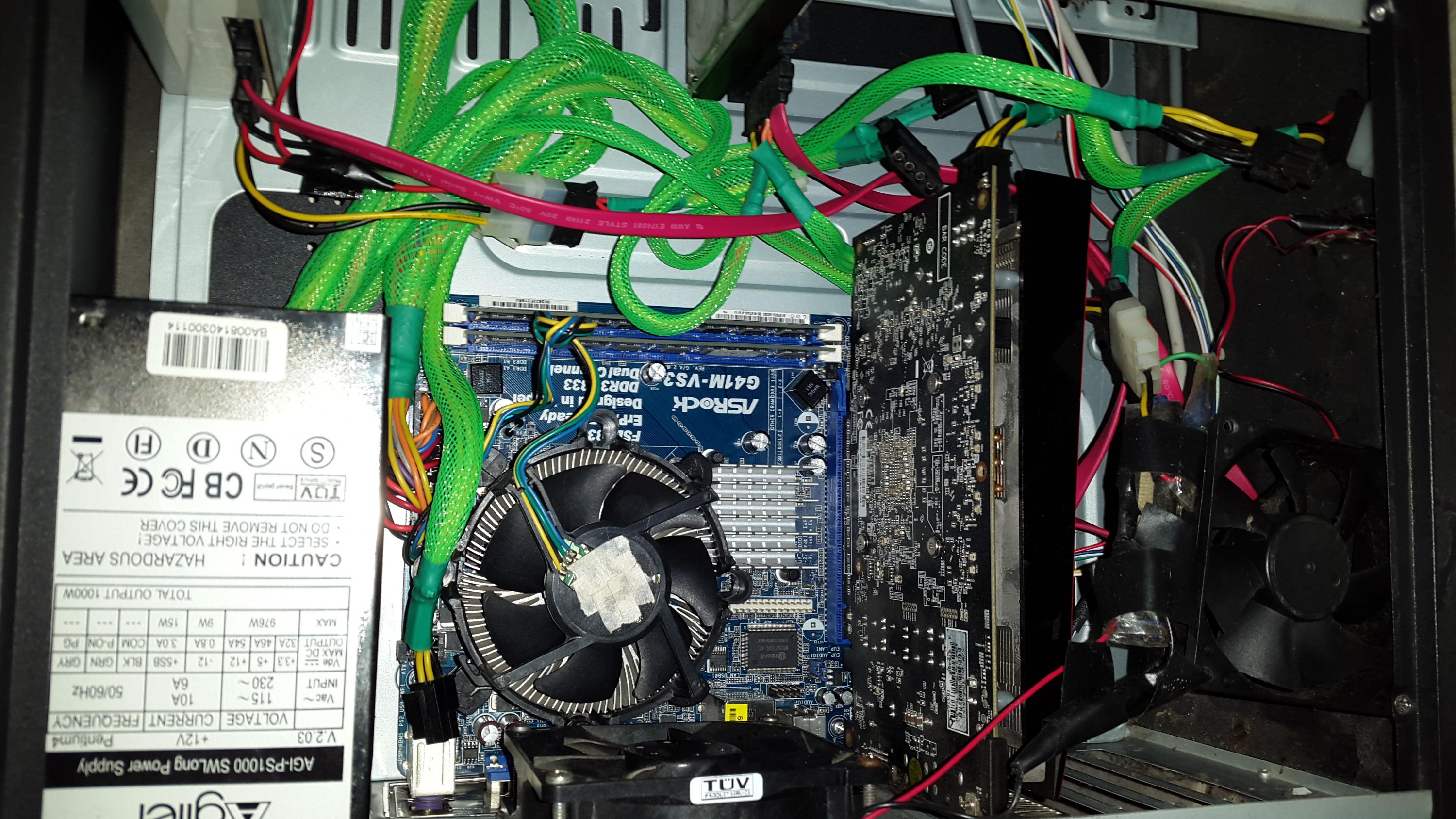

                                          well lets start...
                                          this is my main pc:
                                          Asrock g41-vs3 rev2.0
                                          Pentium E5700 @3.69Ghz (246 FSB IIRC)
                                          4gb of ddr3 ram (2x2) dual chanell @984Mhz CL-7
                                          PowerColor R9 270 Turboduo
                                          Agiler Agi-1000ps psu
                                          random case

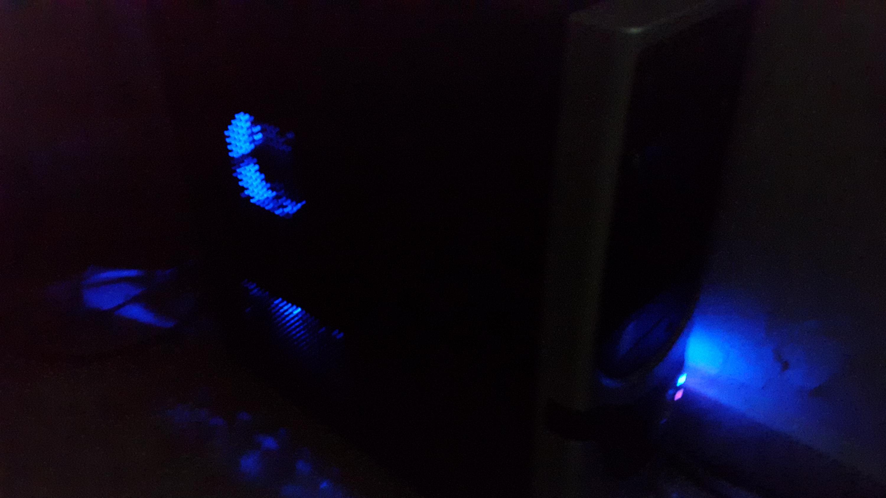

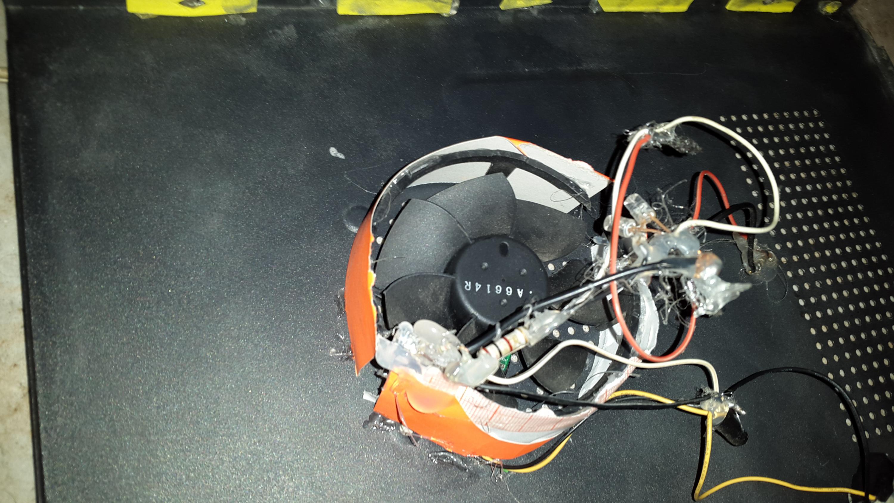

                                          on this pic you can see there is a black thing on top of the bottom fan(i saw that there was a hole on the bottom of the case, i had a 80mm low rpm fan that could take some cold air from the side grill for the gfx so...) is a 10w 20ohm resistor for the nidec beta V 92mm fan on the back

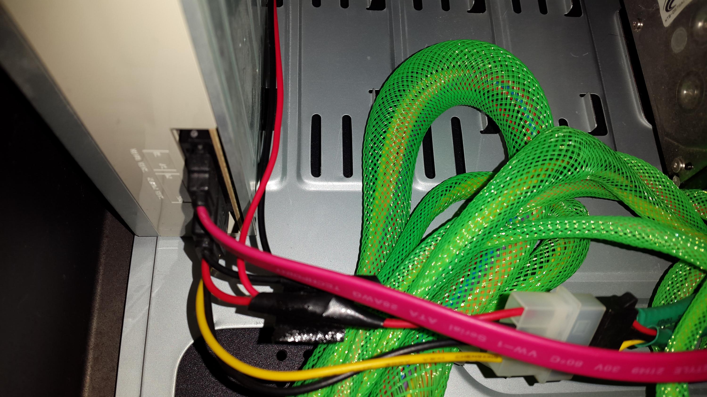

                                          here you can see some tape on the 5v and ground wires, the cables connected to those are going to a guetto mounted 120x38mm fan that moves a ton of air even at 5v
                                          in reality you cant actually see the foam unless you get very close
                                          here you can see the guetto mounted fan using a molex conector cutted from a cd drive and blue leds
