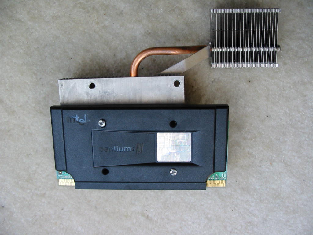

    I found a Pentium III slot processor (500 MHz Katmai, SL35E) without a heatsink at my new job. It was going to get thrown out with this month's cleaning, so I took it.
    As usual, I decided to put an Xbox 360 GPU heatsink (revision 2) on it as I have an abundance of those. The result wasn't so pretty...
    ... but it worked!
    Yes, the mod does look like crap. But for only 30 minutes worth of my time, it could have been worse.
    Really, the main problem was finding thin bolts that were long enough to attach to the heatsink, and of course, drilling holes in the heatsink with the right spacing. The only bolts I had on hand that met the requirements had stripped heads. So I ended up dremeling the heads of those bolts and using them.
    Despite the numerous encounters I found online that said that older Pentium III CPUs like this wouldn't work on a Dell Dimension XPS R400 motherboard, I decided to try it on mine anyways. To my surprise, everything worked absolutely fine. The board POSTed and successfully booted into Windows XP. Heatsink didn't get even warm during my brief tests (nor the CPU for that matter).
    Of course, when I get time, I will put a better heatsink on there - perhaps an Xbox 360 CPU heatsink. Then the CPU could be nearly passively cooled.

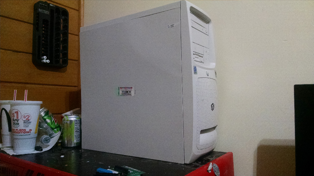

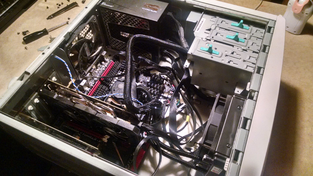

          This... is my new computer setup.
          Points of interest:
          • Power supply held in by putting screws through a PCI slot cover into the fan grille
          • Power switch works, but only because the (proprietary) connector is on sideways
          • Case from a Gateway E-1600 XL

            ^That's a pretty cool build, though. Looks completely stock on the outside.
            Total sleeper!

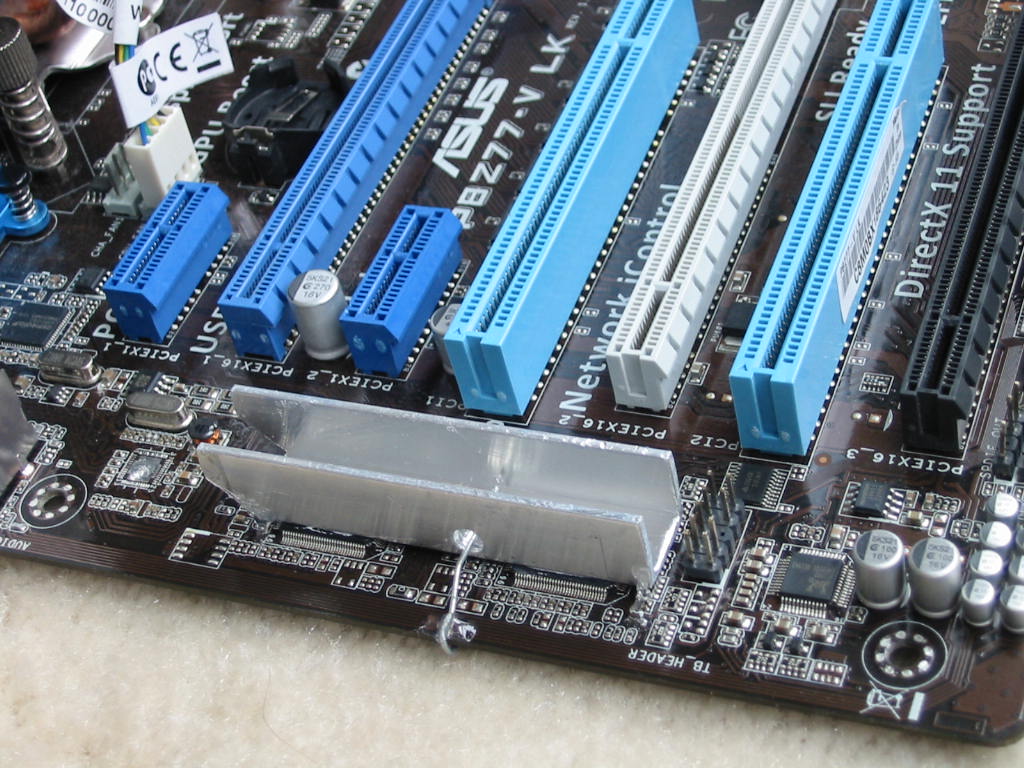

              We had a pretty big thunderstorm in May, and a lightning struck a tree 15 feet (5 meters) away from the house of a co-worker of mine. He said he had many electronic devices dead. One of them was his roommate's desktop computer - a custom build in an older Dell XPS case. So he asked me if I could take a look at it.
              Upon plugging the PC in, it appeared to have no power at all. LED on the motherboard was dead. So I tested with another known-good PSU of mine, and same problem happened. I checked the 5VSB on the PSU that was in the XPS PC, and it was there and fine under load. So indeed something was wrong with the motherboard.
              With the PSU plugged in and connected to the motherboard, I noticed both the LAN chip and the LPC super IO were extremely hot. Measuring resistance on the motherboard's 3.3V Standby rail (generated by 5VSB) showed about 4 Ohms with the PSU disconnected - that's not right! So I removed the LAN chip and the resistance raised to about 10-11 Ohms - still no good! But then I decided to plug power to the motherboard anyways... and guess what? - The standby power LED on the motherboard came ON!
              So then I tried pressing the power button... and I saw the num lock LED on my test keyboard light up - now that's a good sign!
              Thus, I connected a monitor, and sure enough the PC was posting.
              However, the LPC Super IO chip was still scorching-hot. Also, I was not able to make the computer turn OFF at all, so looks like the Super IO and/or southbrdige had taken some damage. But other than that, the PC appeared to POST and I could even boot into Windows. Nonetheless, I felt uneasy regarding the hot Super IO chop, so I decided to make a custom heatsink for it. And the result:
              ... not very pretty.
              The heatsink blocks the PCI-E 1x, PCI-E 16x, and PCI slots right next to it. However, its size was needed, as that partially-shorted SuperIO chip is dissipating close to 1 Watts of power. Without the heatsink, it would burn my fingers within a few seconds. With the neatsink, the bottom of the heatsink right over the Super IO never went over 55C. So that heatsink is making a big difference.
              FYI, the SuperIO chips is the one on the right side of the heatsink in the picture above. The chip on the left is the USB 3.0/3.1 controller, and it wasn't affected at all. Luckily, this layout allowed me to place a much bigger heatsink on top of the SuperIO, without worrying how to balance it on it. The heatsink is held down by a bent paper clip.
              Anyways, that is all for now. Also, the motherboard's model is P8Z77-V, in case anyone wonders.

                I'd change that SIO chip and replace the LAN controller.

                  Nice heatsink job, but I have to agree with TechGeek...
                  Partially shorted ICs don't usually last very long, and I'd be worried also about overloads on the 3.3v standby regulator for the SIO chip.

                    LAN controller was some QFN-thingy, so I didn't feel like bothering to look for a replacement.
                    As for the SIO... I found a dead motherboard (power, no POST) at work with the same one (just for extra info: the SIO was a Nuvoton NCT6779D). But being a 128-pin chip, I just didn't feel like removing that and then finding out the new one from the dead mobo might be dead too. I also found some new ones on eBay, but they were from overseas IIRC, so that was a no-go with the wait time.
                    And eventually, the saying "if it ain't broke, don't fix it" got the better part of me. Well, technically the PC wasn't working quite right still, but working enough to be usable. For example, Windows appeared to work fine (sans the network). It's only when I tried to shut the PC down, the HDD turns off, but all of the fans stay ON and the CPU fan goes to max speed. Press the power button, and the PC boots up again normally ... as if it was shut down. So the only way to shut it down after the Windows "shut down" sequence is to unplug the PC. My co-worker joked we should put XP on that PC and turn of APM, so that every time the PC is shut down, it would display that classic "IT IS NOW SAFE TO TURN OFF YOUR COMPUTER" message
                    Another thing I forgot to mention is that the CMOS battery got used up very quickly after my "repair". It was at 3.2V when I placed it back in the mobo (measured in circuit). Within 1 hour, it was already at 2.75V. I measured the current, and the motherboard was drawing close to 1 mA from the CMOS battery with the PSU disconnected. On a normal working motherboard, the current draw from CMOS battery is typically 1-2 uA, or 1000 times less. So clearly there was something wrong in that circuit too. Thus, I ended up not installing a CMOS battery at all (which unfortunately means that if the PC is shut down and unplugged, the CMOS settings will be reset every time).
                    So I told my co-worker it is probably best to keep the PC on all of the time... which is what my co-worker's roommate was doing anyways (and judging by the amount of dust in the machine, I don't doubt it one single bit ). Hence why it got damaged during the thunderstorm.
                    That was the first thing I checked when I saw the motherboard's standby LED came on after removing the LAN. I fed the 3.3V Standby supply directly with a 3.3V source to check the power draw. It wasn't too bad: somewhere around 330 mA at 3.3V... which is close to 1 Watt of power.
                    I was also actively checking the temperature of the 3.3V standby regulator while testing the board, and it wasn't hot at all.
                    But really, the main thing is that my co-worker's roommate was already half-way ready to buy a new PC and didn't actually care much to fix this one (most of my co-workers think that even a 6th gen i5/i7 is too old). As such, my "repair" was more or less just for fun. Had my co-worker's roommate given me this motherboard, I would have actually gone to the trouble or replacing the SIO. But that wasn't the case, so it is what it is.

                      And what happens if you remove the regulator for the Super I/O CHio?
                      That should fix the 'things gettin hot' issue. And if it still boots...

                        Well, these days the SIO chip provides quite a bit of 'glue logic' between the southbridge and other components, sometimes also BIOS as well, and incorporates many low-level system functions, like power button control, /PS_ON signal to PSU, keyboard controller, ACPI\sleep functions, fan control, voltage monitoring\overvoltage or overtemp protection etc.
                        I'd say from the point of view of a modern computer system, there's many reasons why you'd want one, even if you never used the serial or parallel ports...

                          If there is a Super IO chip on the board, it handles BIOS/CMOS settings, power control, and also voltage, fan, and temperature monitoring. So it is needed.
