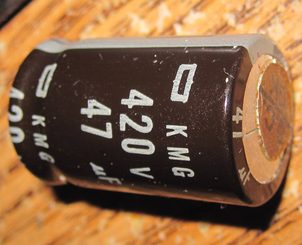

      Speaking of the APFC cap, is it common for these to fail? That was quite odd for it to fail. The regular doubler caps, I've never seen fail...
        Yes, fairly common for crap cap brands to fail in an APFC circuit while the same caps will do okay in a voltage-doubler circuit. In fact, some APFC circuits can stress caps enough that even the good Japanese brands can fail.
        All in all, I like to avoid APFC whenever possible.

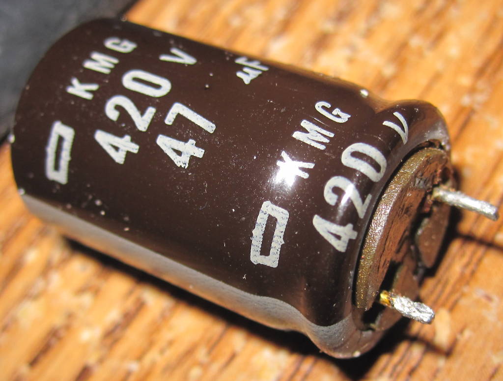

          Ah... interesting, will have to look out for that as I end up with more and more APFC PSUs (currently have a few in service now when I used to have all doublers.)
          Pity that APFC caps tend to be very spendy, good reason to avoid...
          Though in this case I can't truly blame this capacitor. It may have failed, but it was kind of in the heat...
          Unless it was a phony?
                Looks genuine to me.
                I guess just poor thermal design with stress from the APFC did it in.

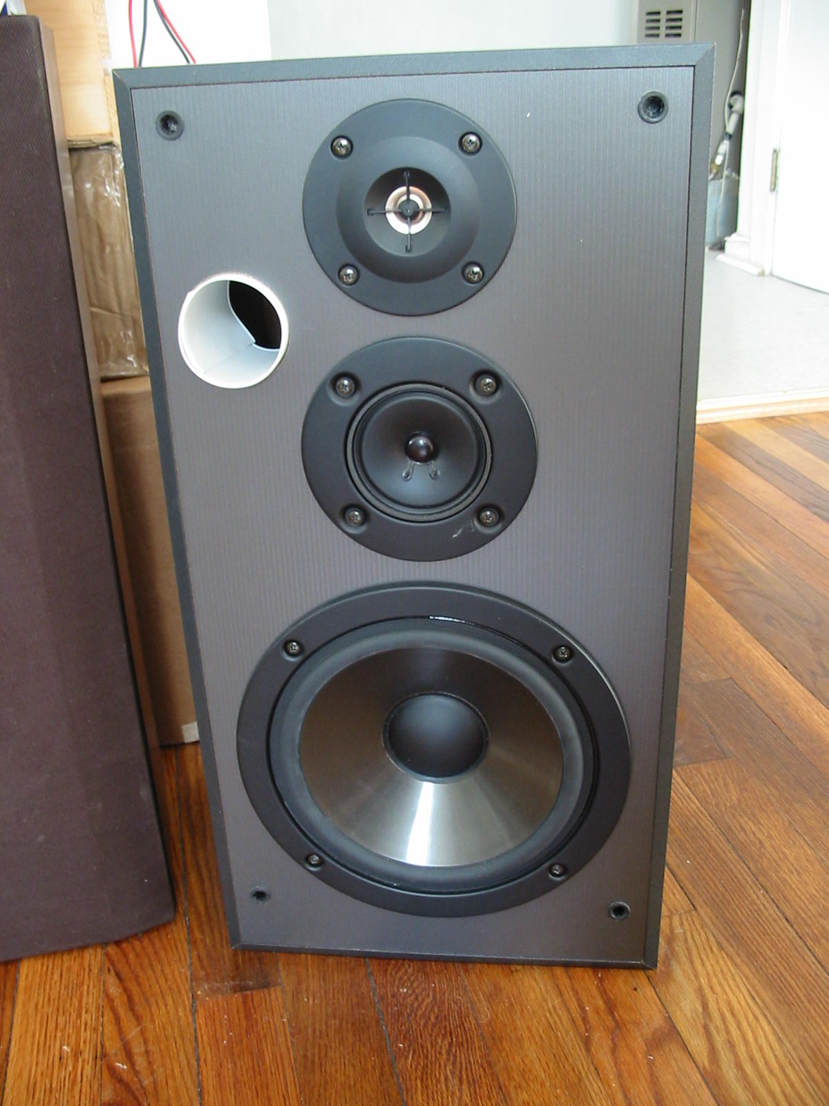

                      11) (Not visible in the pictures, but its picture posted below) Another ghetto speaker mod: the outermost speakers, a pair of Sony SS-MB215, had a hole drilled in the front of their cabinets (under the grille.) I stuck a short pipe (made from paper by myself ) in each hole to add a port to the speakers. This helped boost bass a good bit. However, I didn't make the pipe too long, so the speakers were only good for about 35-38 Hz at the lowest. Here is a picture of the mod:
                      https://www.badcaps.net/forum/attach...1&d=1524015447

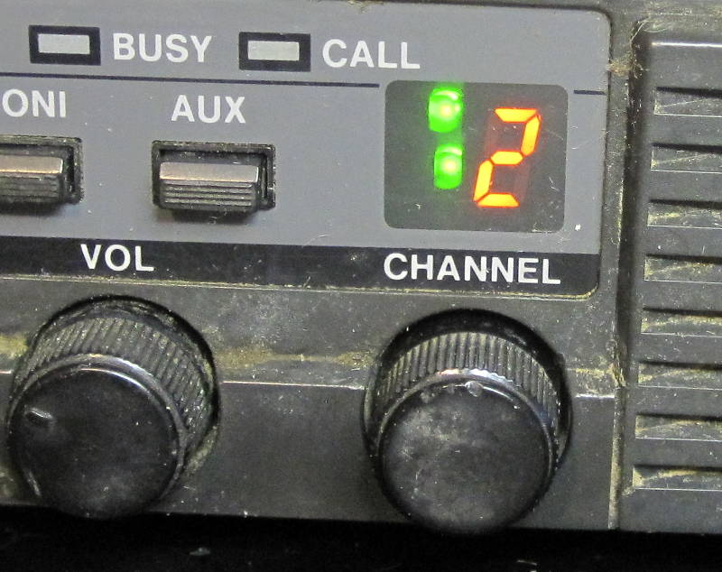

                        I removed the (mechanical) channel limit from 2 channels to 12 channels in this UHF radio. Too cheap to get another 7-seg LED to display the 10s digit and too cheap to get yellow/orange LEDs to match the existing LEDs.
                        I should have at least bent the leads and pointed them sort of slanted but too, but too lazy to do that, even...

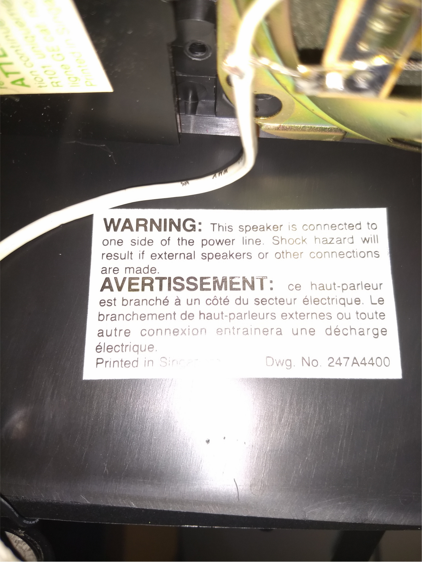

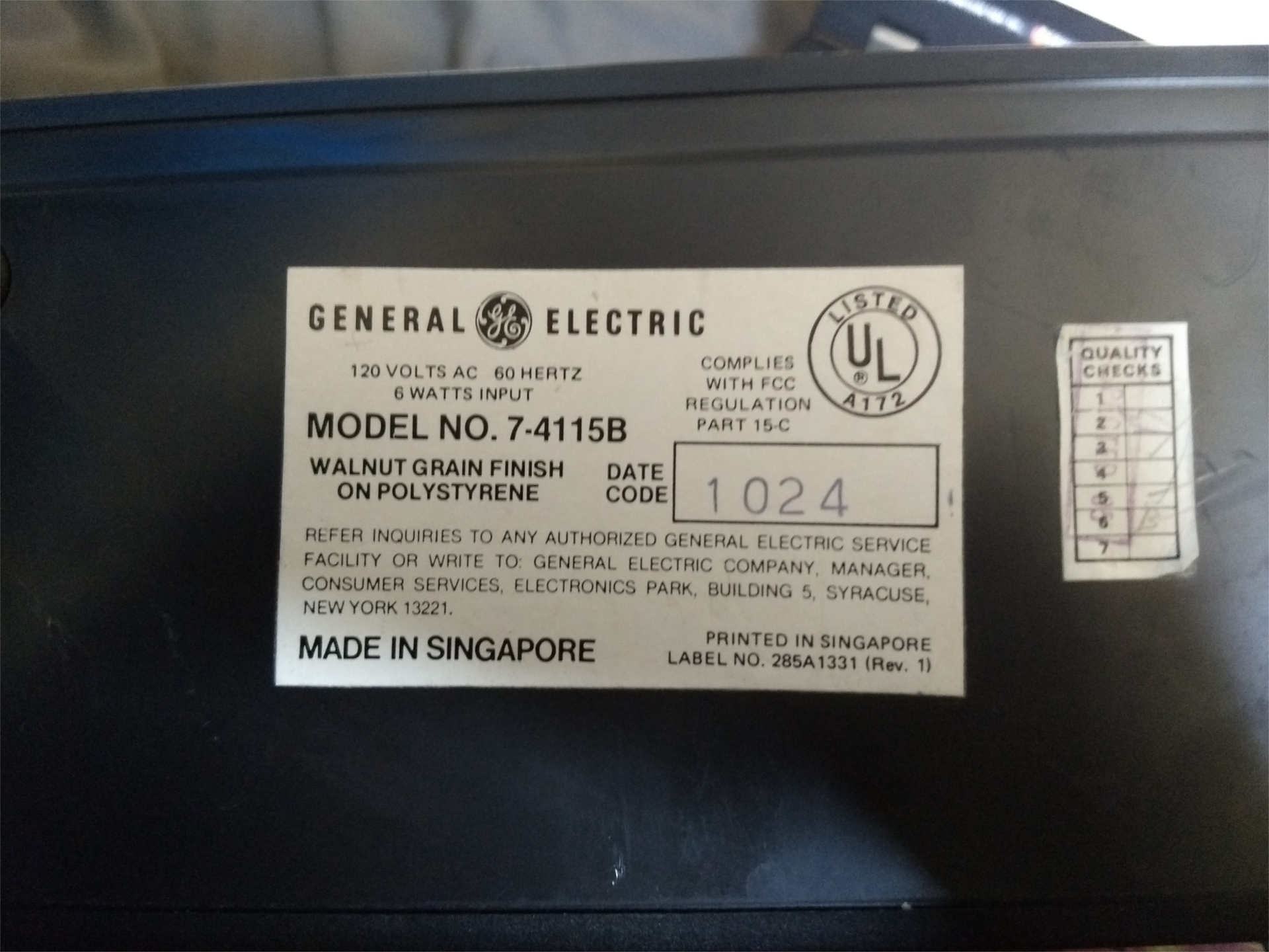

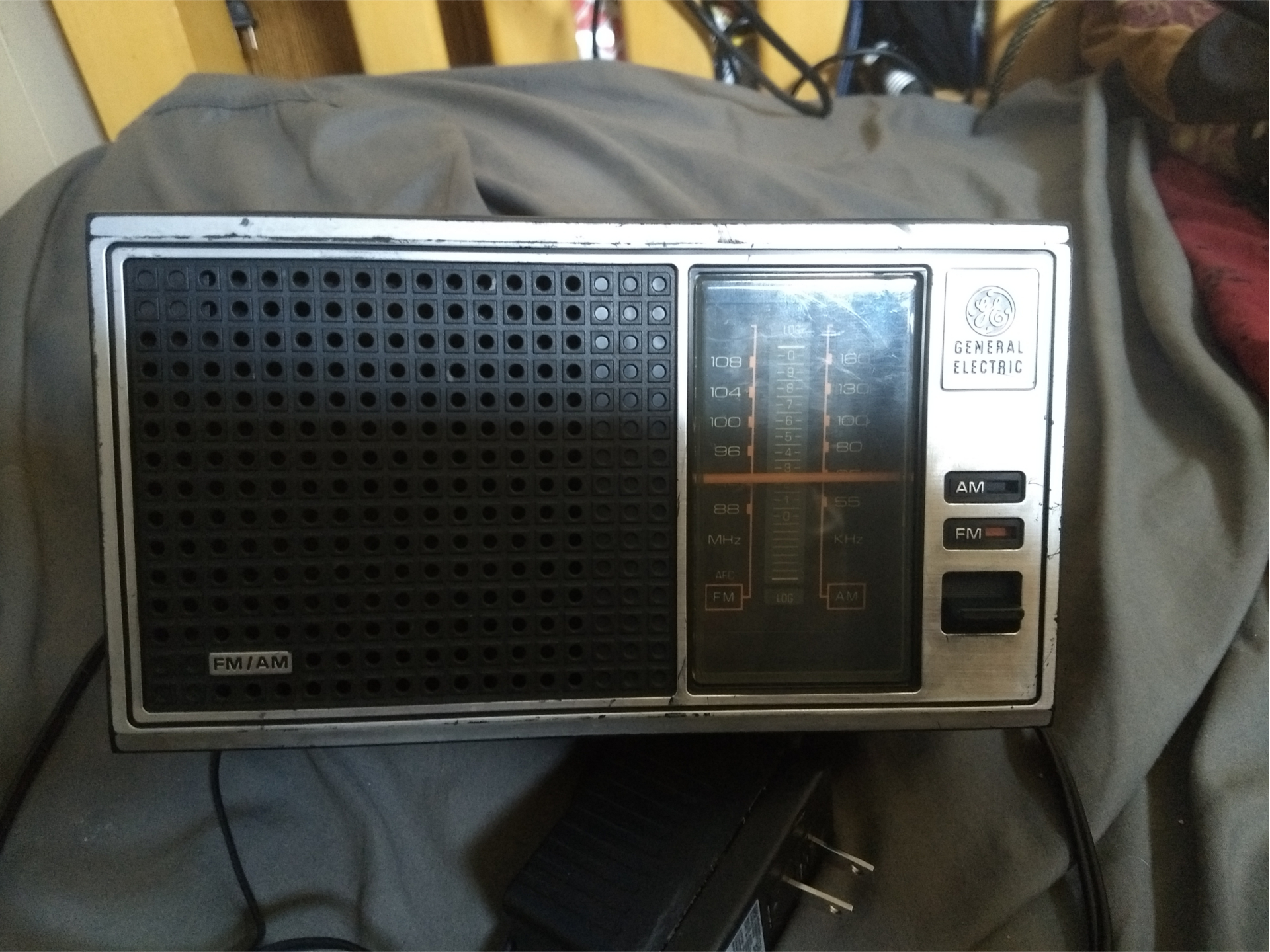

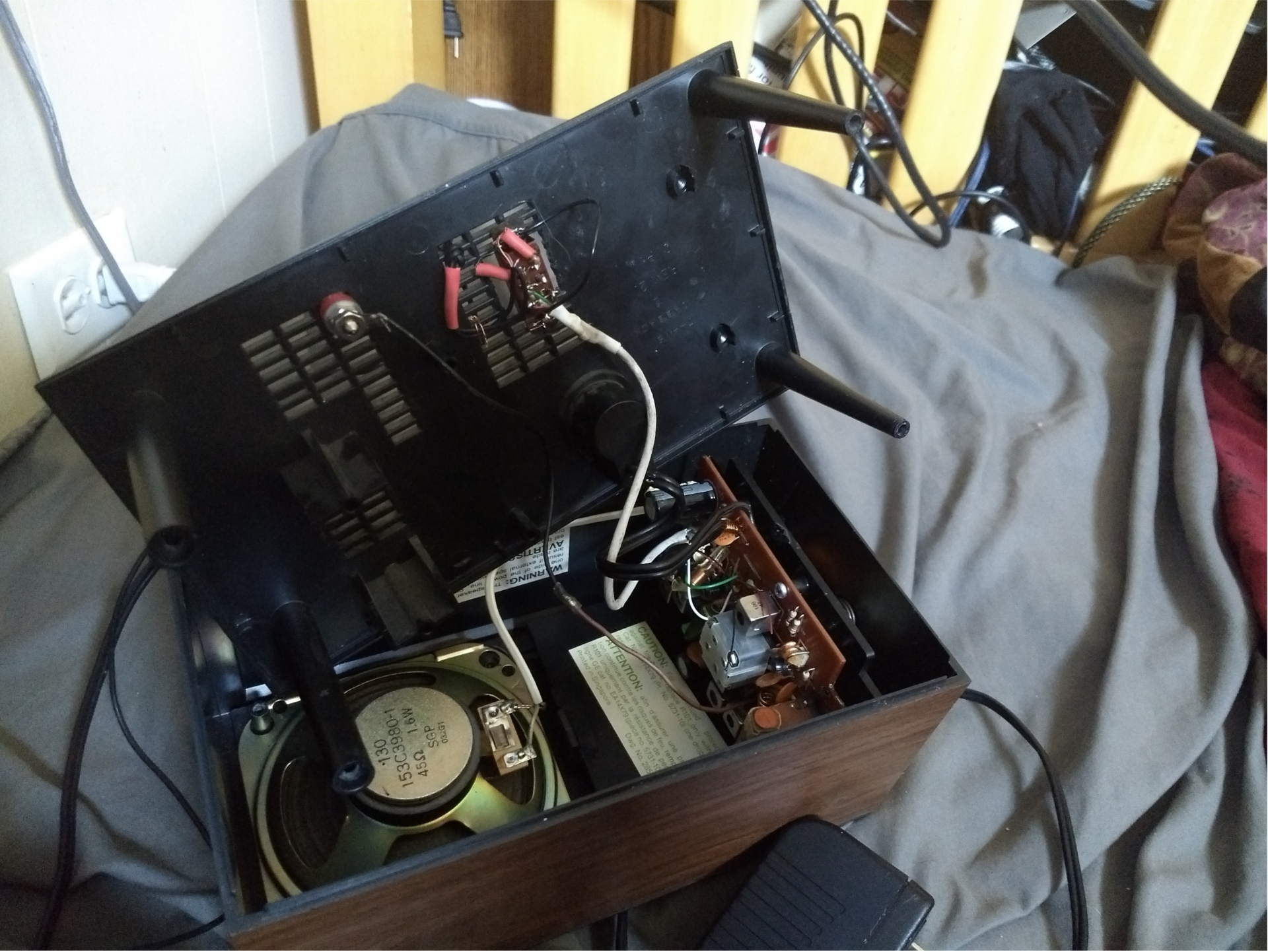

                          Since we are on the topic of Radios.
                          I picked this up out of a free pile from a yard sale down in Denver.

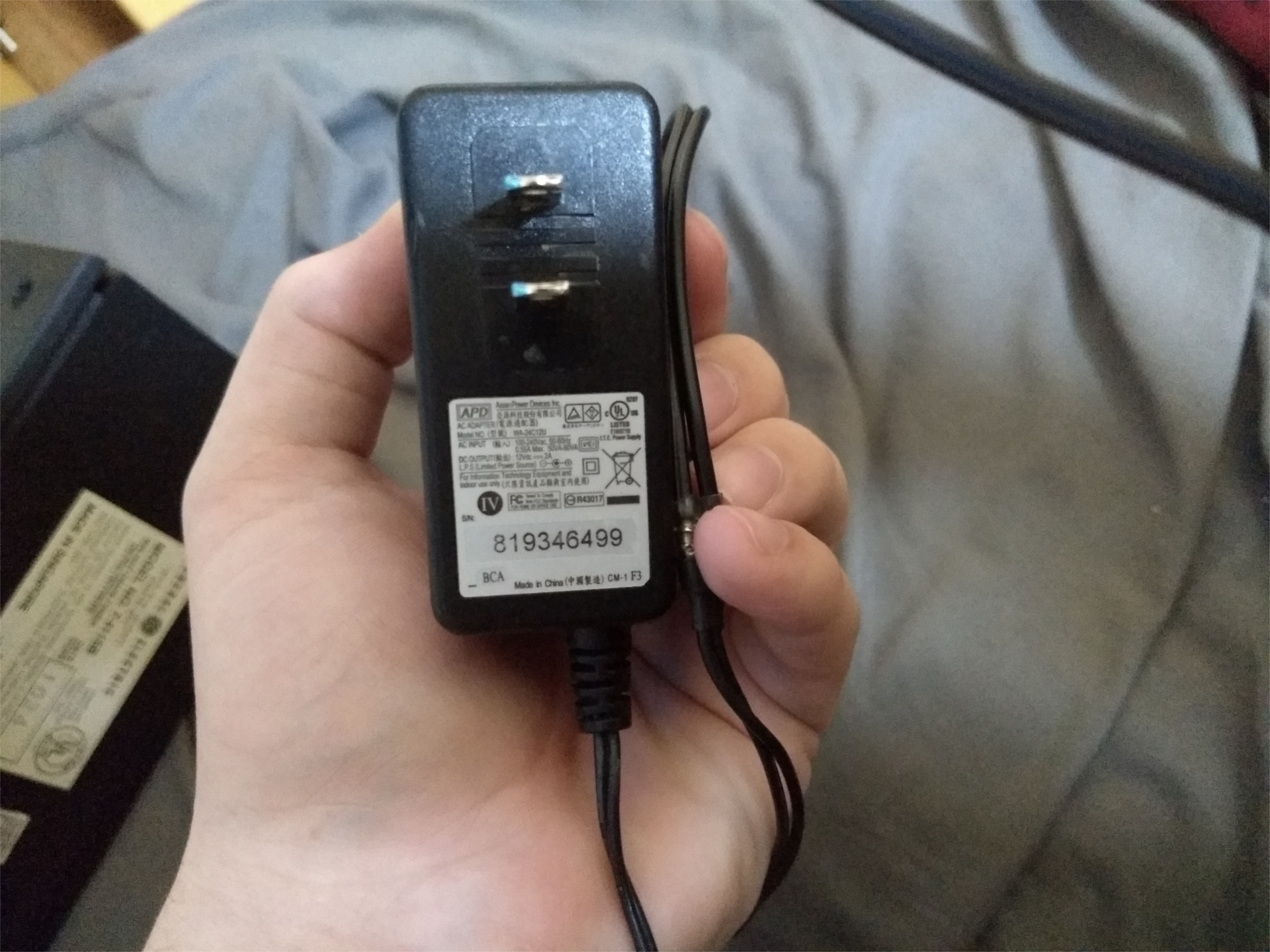

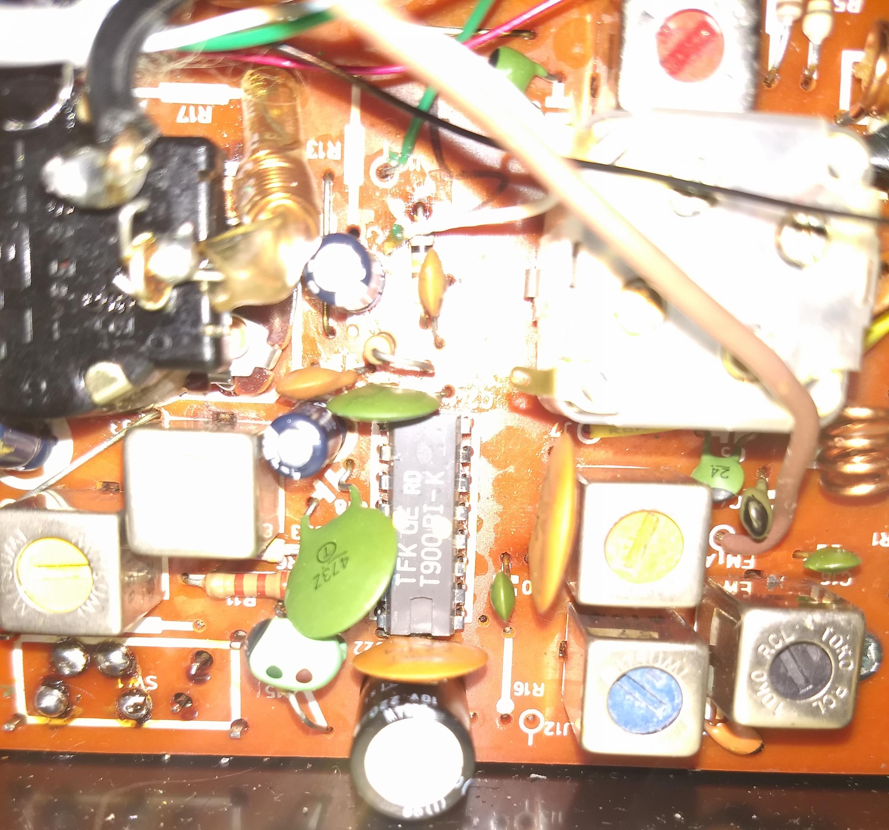

                          I plugged it into the inverter on the work truck and the inverter blew out. The line dropping resistor had toasted the standoff, fell on the mainboard and shorted the mains.
                          Seeing how it's a 12vDC power supply, i being the notjob i am, deleted the rectifier diode and spliced on refurbed 12v walwart!
                          Now it works, but FM is piled at the top of the band, AM is deaf, and the audio is distorted. All the lytics
                          So here are the new ones installed.

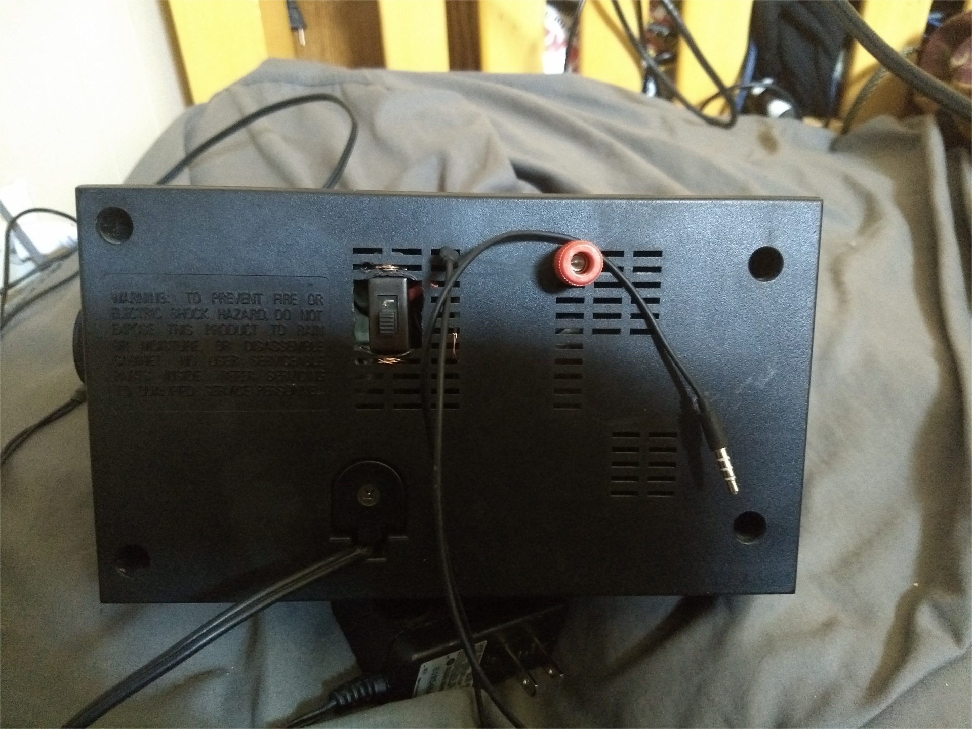

                          Now for the ghetto part!
                          This no longer applies, though, i could make it...
                          Added an external antenna connector and aux input.
                          The FM was originally coupled to line through a low value ceramic capacitor.....
                          And the backside
                          Sorry for stuffing the repair in here as well. A cheap 1980's GE radio isn't worth its own thread. Nor ordering parts. Even if it does sound fairly decent.

                            Oh btw, that 2-way radio, the LEDs I used were kind of weird, rectangular on bottom but round on top. They also were too tall and hit the front filter. So, I grinded off the tops of the LEDs so that they'd fit into that place. There, now I can tell if the radio is on channel 1 vs 11, or 2 vs 12 (I didn't mind channel 0 which was 10, however. Just the other two "aliasing" to n-10 was annoying.)

                                Yeah I was kind of surprised of these "early" transistor radios that also did not isolate much like AA5 tube radios. All later transistor radios seem to be isolated.
                                I suspect the ones that are battery operated were all isolated due to the need to run off of lower voltages. Don't know... What kind of power supply did this radio use? Capacitive dropper?

                                    so it actually dropped 80 volts across line? sheesh... thought it would reactively drop at least part of it versus drop ALL of it across a resistor?
                                    • goontron
                                      5000!
                                      • Dec 2011
                                      • 4108
                                      • US
                                      #418
                                      Re: The ghetto mod thread
                                      ^ Nope. I think out of that 6w rating, 2w is sunk in the radio, and 4w is sunk in the resistor. A large 1k ohm resistor.
