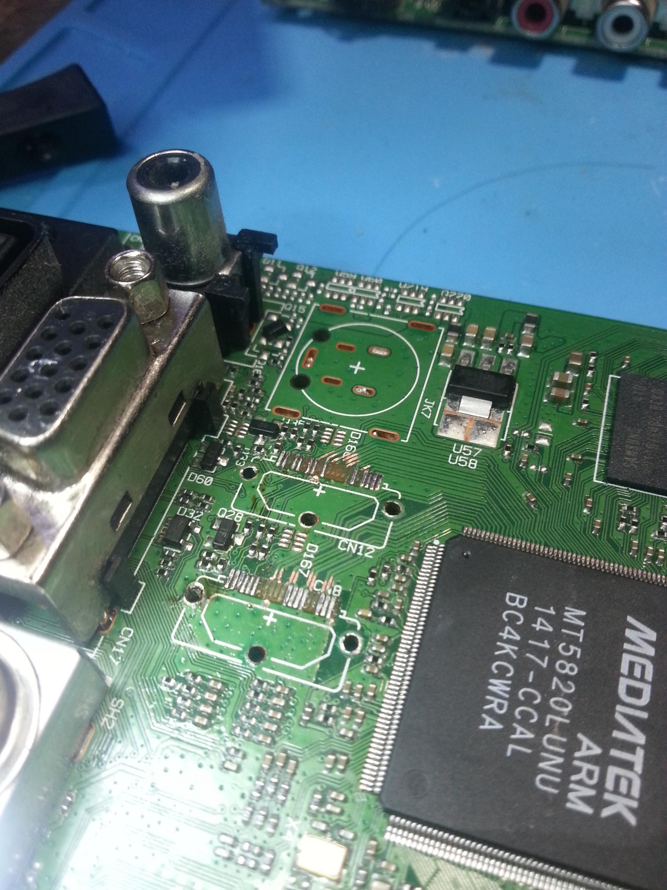

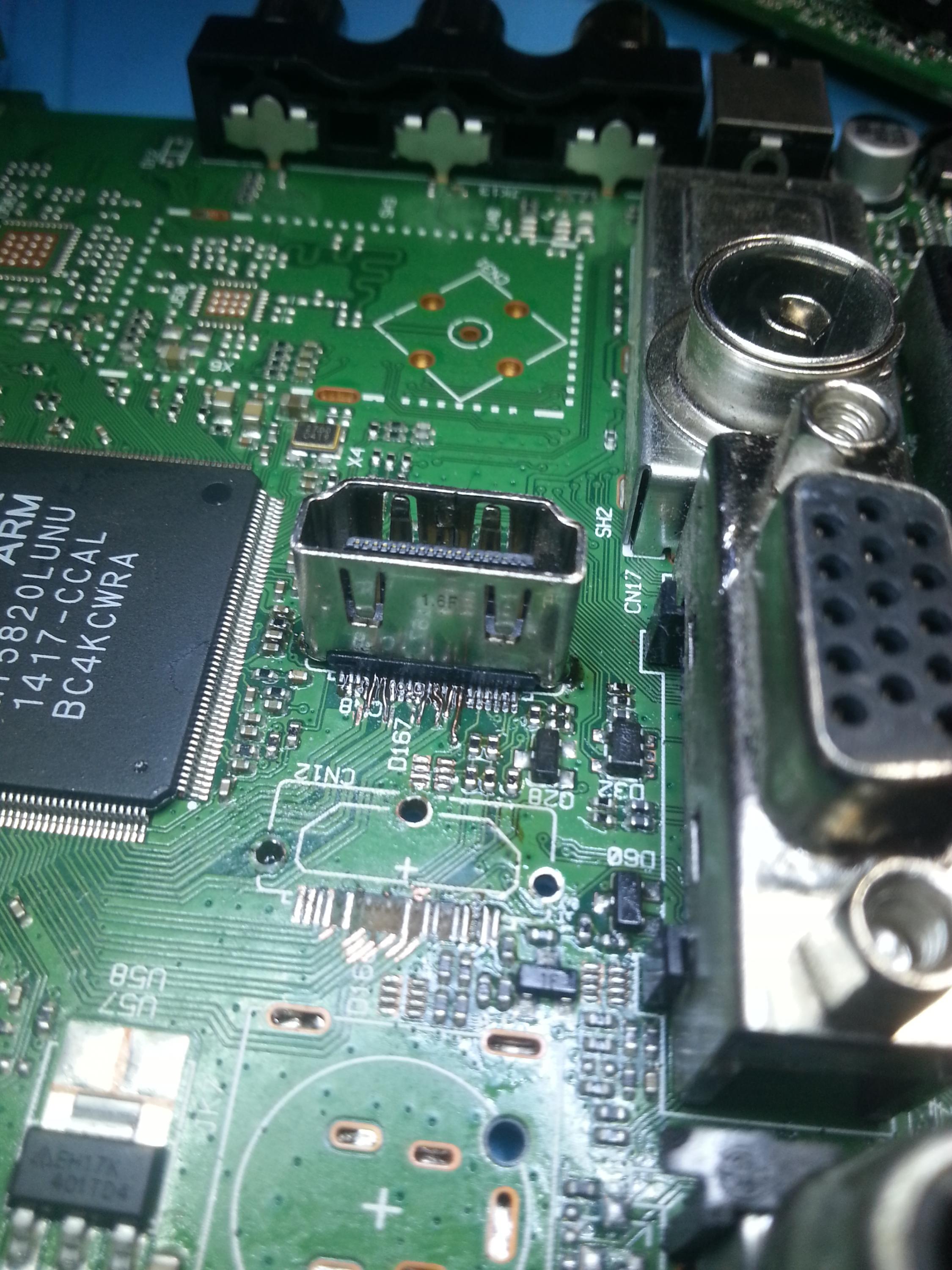

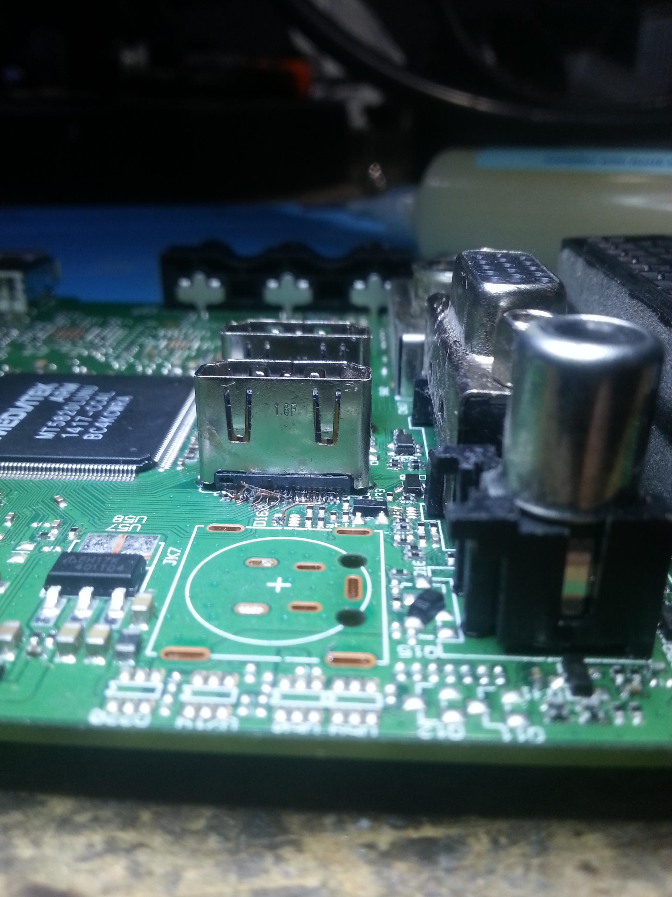

                    Here's one from yesterday/today. A vestel taken off the wall still with two HDMI cables plugged in.
                    I possibly should have looked on ebay for a board and I wasn't given the remote so haven't tested it yet.
                    I will be sealing the wires once I've tested the repair as they are bare strands of copper and not coated magnet wire.
                        Dang, I thought I've done some fine trace repairs, but never so many next to each other. I admire your patience for this one.

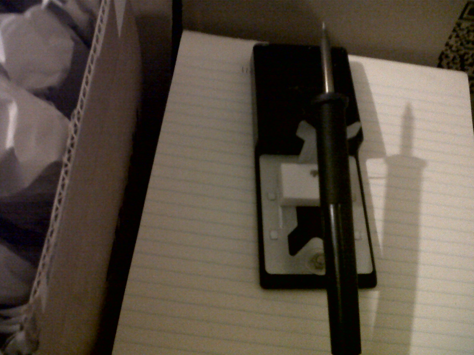

                              T12 soldering iron stand.
                              ingredients:
                              1 weller iron stand - base section for weight.
                              1 joke stand from china.
                              1 pencil eraser
                              2 M5 screws.

                                  it's actually more comfortable just throwing the iron onto a "V" instead of poking it into a spring!

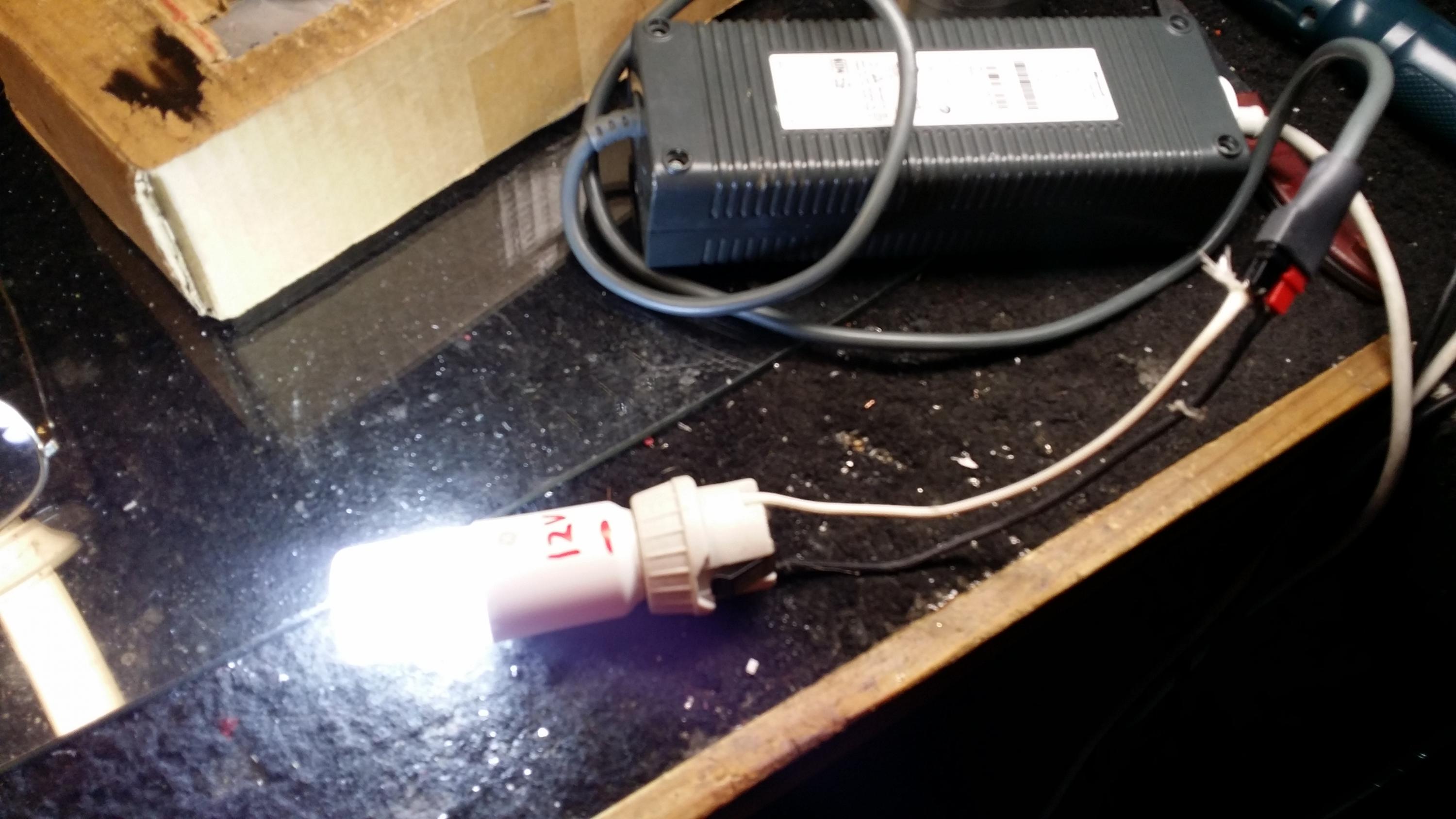

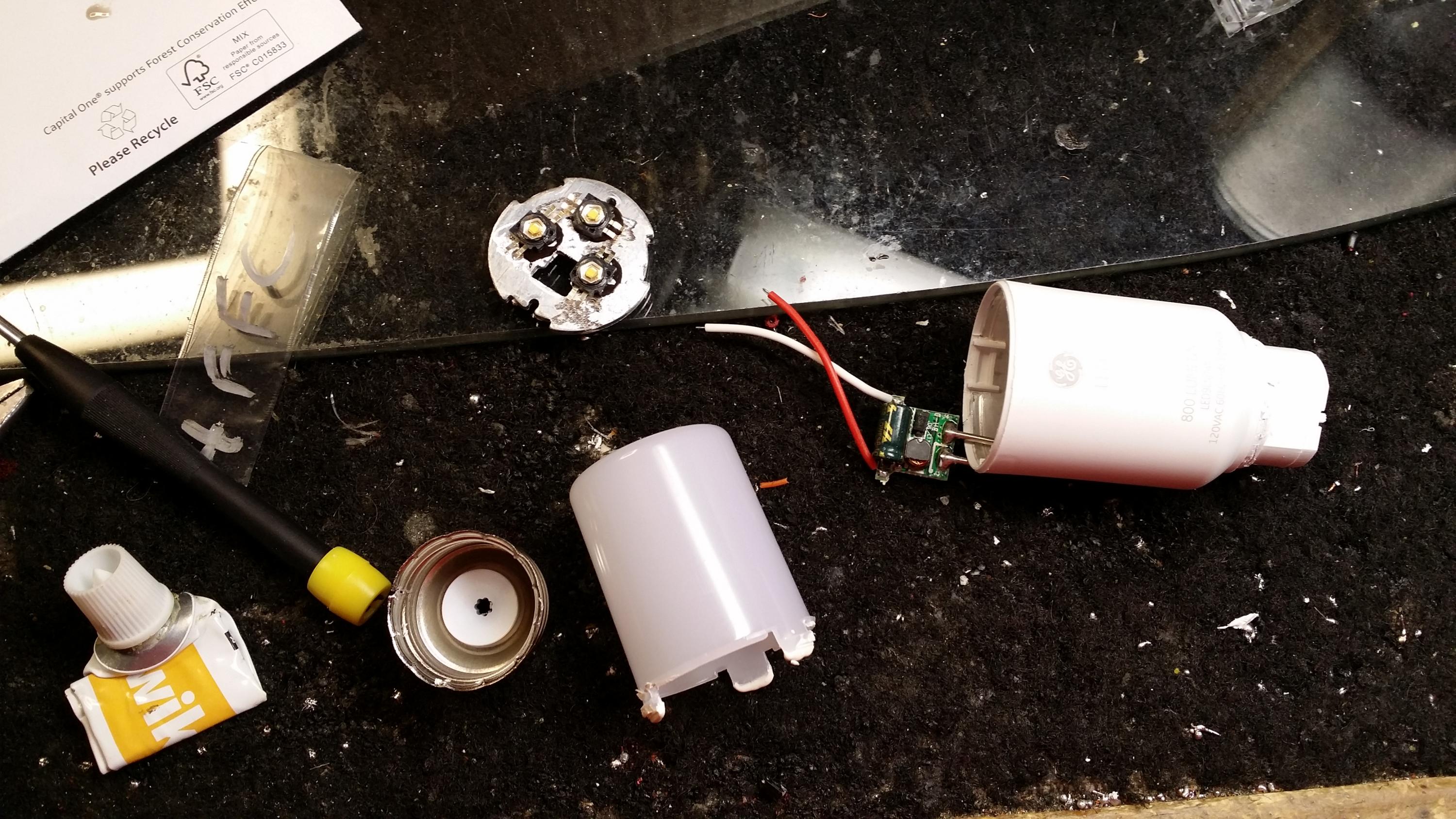

                                        Power Mac G4 Quicksilver PSU replacement
                                        Original PSU failed, no power at all, and I didn't know how to fix them back then (6 years ago). So I took an ATX PSU and modified the connector's wiring.
                                        And I added a laptop power brick (from a Compaq Armada 4120) to feed the +24V line (with 20V but it works) as I was using the original Apple display which doesn't have an external power connector. Before that the +24V was feeded by the +5VSB.
                                          Ha, nice! I think I've seen people do/suggest that here before on BCN when those proprietary Apple PSUs bit the dust. It works, so why not.
