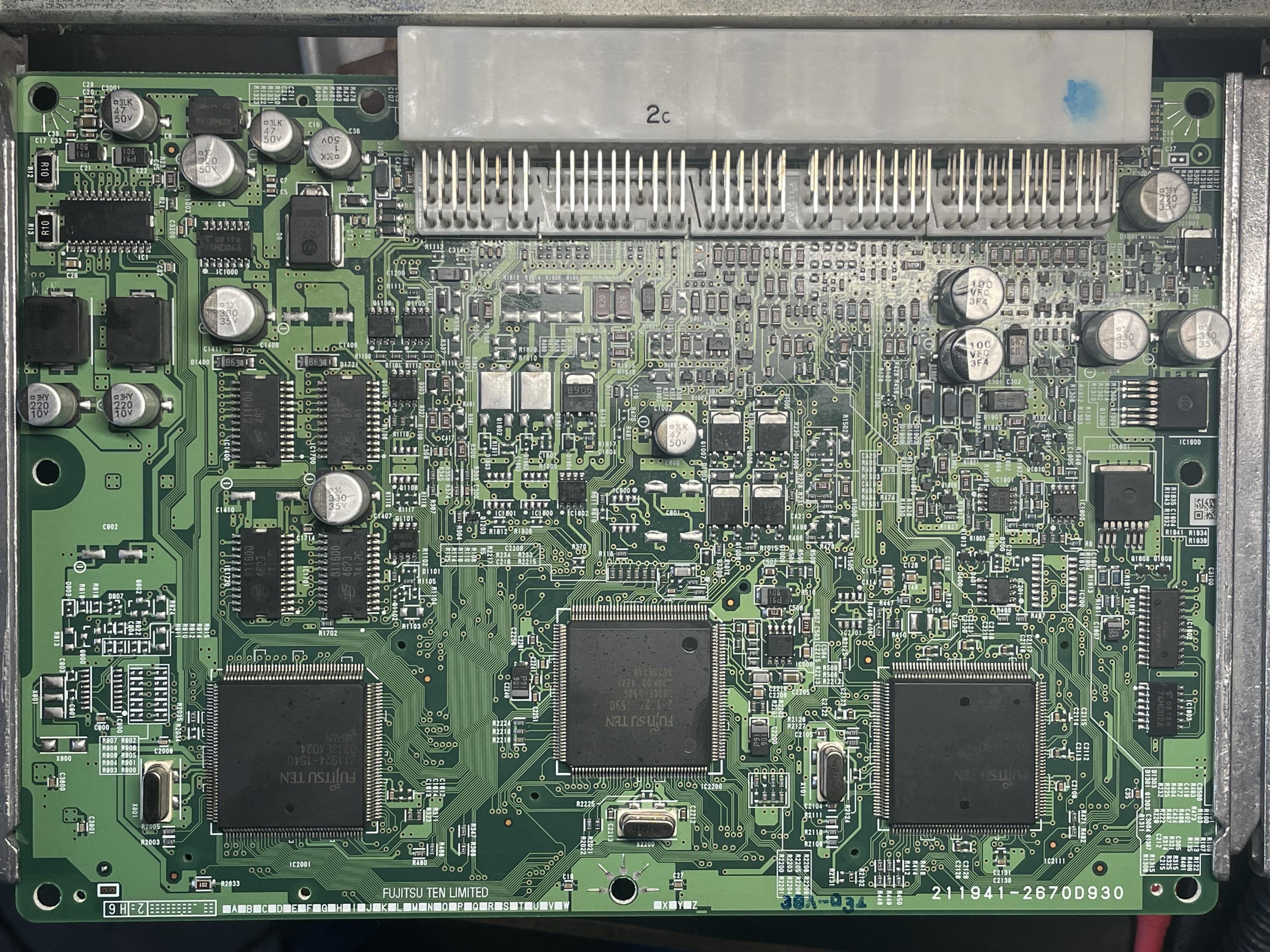

    03 Toyota RAV4 ECU transmission problems / reset
    I've got here an ECU 89661-42840 from an 03 Toyota RAV4. Got the usual transmission problem that is ECU related. Symptoms are not shifting as it supposed to, no shift etc. Turn the car off, wait a minute and back on and it will work again for a bit. I think she's in limp mode here or something.
    Anyway... There are tons of those RAV4 that have this problem. My problem with it is, that it's a right steering import vehicle and the dealer can't read the ECU.
    I went all over the ECU resoldering a whole stack of resistors, no problem. BUT I am stuck on resetting the transmission in the ECU.
    I've read up on how to delete the adaptive crap in the 25080 flash, by deleting everything on the 000100 block. My ECU has a different layout and 3 large Fujitsu IC's and a 25040 flash. The smaller flash still has the 000100 block in there, but it's almost like erasing the whole IC.
    If someone can explain to me what kind of info this Atmel 25040 stores and clean the transmission adaption stuff out / verify its the same way like on the 25080 etc, would be awesome.

            Re: 03 Toyota RAV4 ECU transmission problems / reset
            Here is a pic of my ECU, less the Atmel 25040. That's sitting in my TL866.
            I think one needs a proper scan tool, other than that you wont even get the option to reset the tranny. It's not just to read out the error codes. I never heard of carly.
                        For now I just did resoldered the resistors and the ground points. Put the Atmel flash untouched back on the board. Let’s see what happens.
                        • CapLeaker
                          Leaking Member
                          • Dec 2014
                          • 8340
                          Well... this didn't help any at all. Same problem. Sure enough, it is a Japanese import car. The car talks in Japanese, and the stickers in the door all all Japanese too, LOL.
                          I took the car out for a drive and actually found out that there is no problem shifting in first, second and third or reverse / nor any hard shifts. However I had a MIL light on and didn't get fourth gear and no overdrive. I did notice a rough idle while in gear and stopped at a traffic light. Using the emergency brake and leaving the car in drive, the rough idle is gone? Weird.
                          Turns out I was able to read the car with an Autel scanner. The car came back with an P1653 code. I checked the gas cap and boy was there ever a vacuum in the tank! Anyway, after restarting the car, the MIL light disappeared and I had 4th gear with OD. So hopefully either fixing / replacing the gas cap and putting in an new vacuum switch will cure that bitch!
                              Code P1653 Toyota Possible Causes Low engine oil level Faulty Oil Control Valve
                              • CapLeaker
                                Leaking Member
                                • Dec 2014
                                • 8340
                                Yeah, oil control valve…. Has two vacuum hoses go to it and it’s on the left rear side of the engine. I don’t understand what the P1653 code has to do with the 4th gear being locked out? Anyway I guess they have to put that valve on and see what happens next.
                                    I never seen a limp mode that only takes 4th gear and OD away, but I go after found trouble, fix what I know is wrong and try again. See what happens... gonna be a while until I get the parts, but time will tell.
                                    • CapLeaker
                                      Leaking Member
                                      • Dec 2014
                                      • 8340
                                      Put that valve on, fixed the vacuum problem in the fuel tank and she works like a charm.
