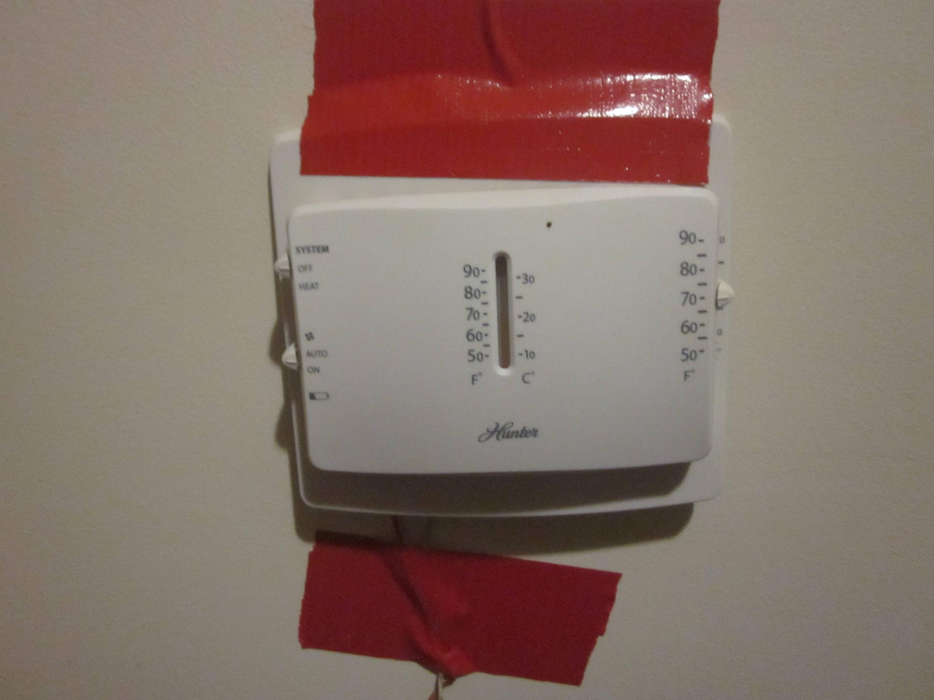

            I couldn't afford a space heater with a thermostat, so I found a 12V power brick and a thermostat that wasn't currently being used, and bought a PowerSwitch Tail II. A bit of wiring later, and now I have a space heater with a thermostat.

              ^ That's a great idea! I have a spare thermostat as well. If my college apt. is really cold for the spring semester, I might just do something like that for the bedroom I sleep.

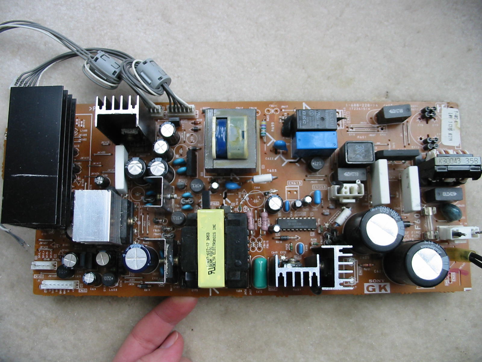

              Now here is the "project" I was talking about in my last post above:
              https://www.badcaps.net/forum/attach...1&d=1418712856

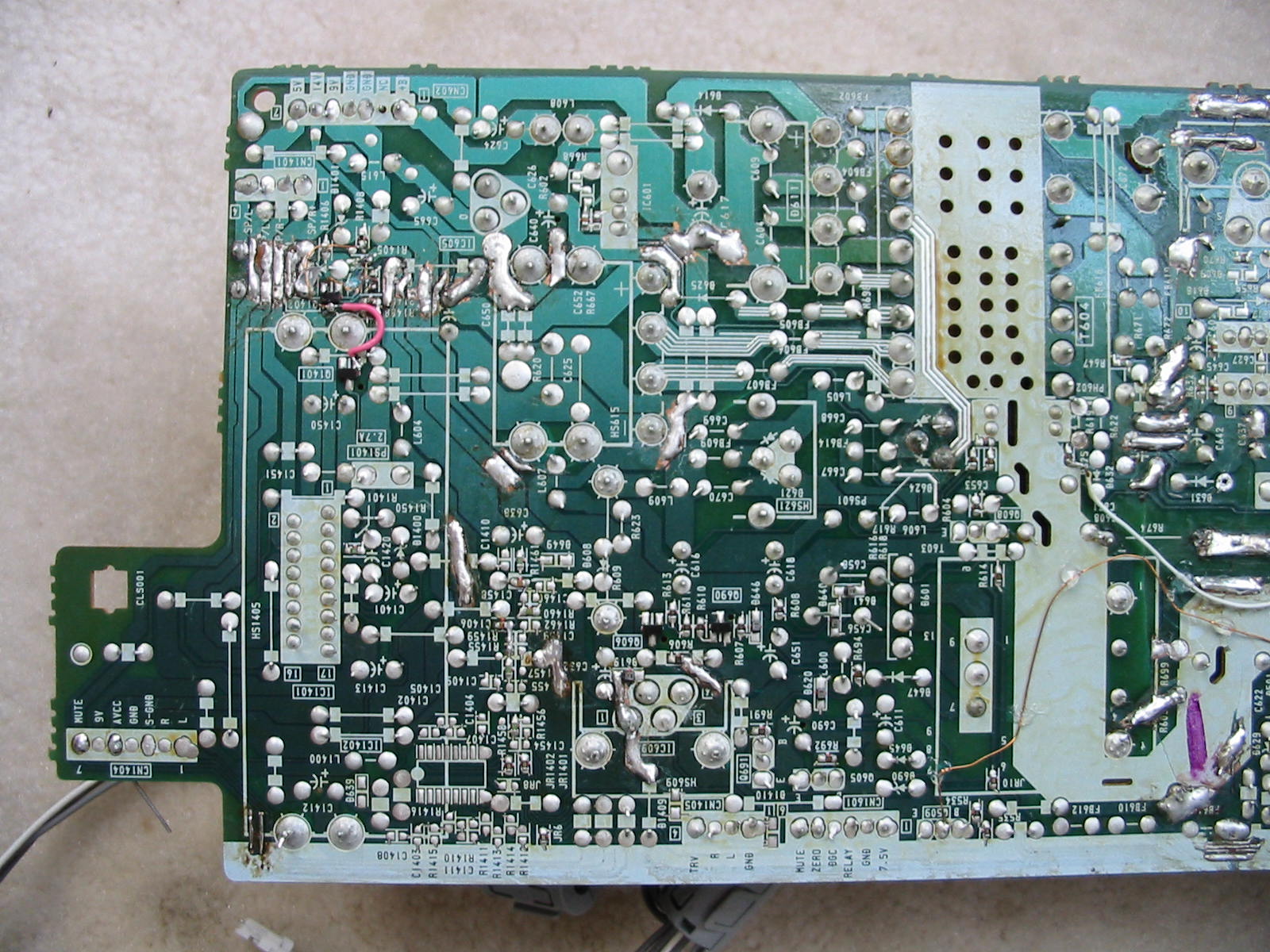

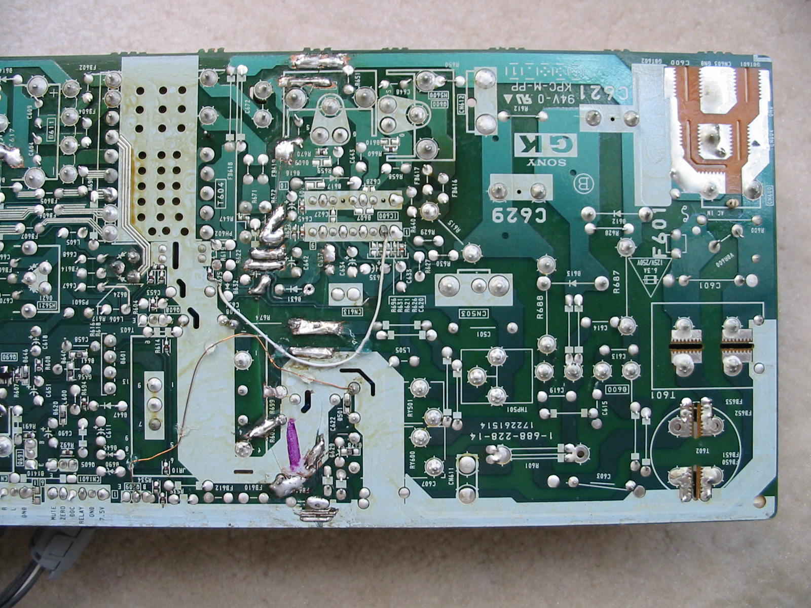

              Looks like a plain ol' boring PSU board, doesn't it? Indeed it is a PSU board out of a Sony KV-36FV310 TV. But what you don't really see (and know) is how broken this board was when I got it.
              The TV was a dumpster special and had sat at the bottom of a big dumpster probably for quite a long time. I guess the copper scrappers must have noticed it, because the back case of the TV was busted, and the Yoke and rest of focus/deflection coils were all gone. So when I got to it, that PSU board was broken in half (and the main board was mashed even worse). Moreover, whoever opened it wasn't gentle with it at all. Aside from the PSU board being broken in half, it also had over 5 spots where the PCB was cracked and the trackes were ripped. So if you look at the underside pictures,
              you will see how many solder "jumpers" I had to put to mend the board togheter. Some traces were too small, so I had to use thin wire. And here I used whatever I grabbed from my "salvage" wire bag (including that thin copper enameled wire again ).
              So why did I fix this board? Simple. That big black heatsink on one side has a TFA9844J amplifier attached to it. Although I can't seem to find a datasheet for it, pin-wise it seems identical to the TDA8947J amps in my Xbox 360 amplifier, and those are quite good for mini amp projects (can do up to 13W in BTL with fairly low distortion, and up to 40W with 10% THD).
              Miraculously, after mending everything together and plugging the PSU board in, nothing blew up (granted I did use a dim bulb tester). I then found that I had to tie the "Relay" pin to the "7.5V" standby pin to turn the "main" PS ON. After that, I played an audio signal into the L/R inputs and the amp actually worked!
              So it looks like I have another amplifier "project" board now. I can't find a datasheet on the TFA9844 amp IC at all, though. Perhpahs I shall email Philips/NXP semi to find out. If it turns out to be indeed similar to the TDA8947, that would be sweet. Might just become my next amplifier project (but maybe after fixing the PCB a little better - right now, the only thing holding it together is the solder and nothing else).
              My other concern is that the PSU voltage for the audio is only 14V and drops to 12.5V when the amp is cranked to a medium volume. Not sure how much power I would be able to push out. I am guesstimating 10W RMS tops since the amp does appear to be in BTL mode right now. That should be enough, though. I tried using my Sony SS-MB215 8 Ohm floor standing speakers with it, and the sound output was decent at medium level.
              Anyways, it sure was fun to repair that PSU/amp board.

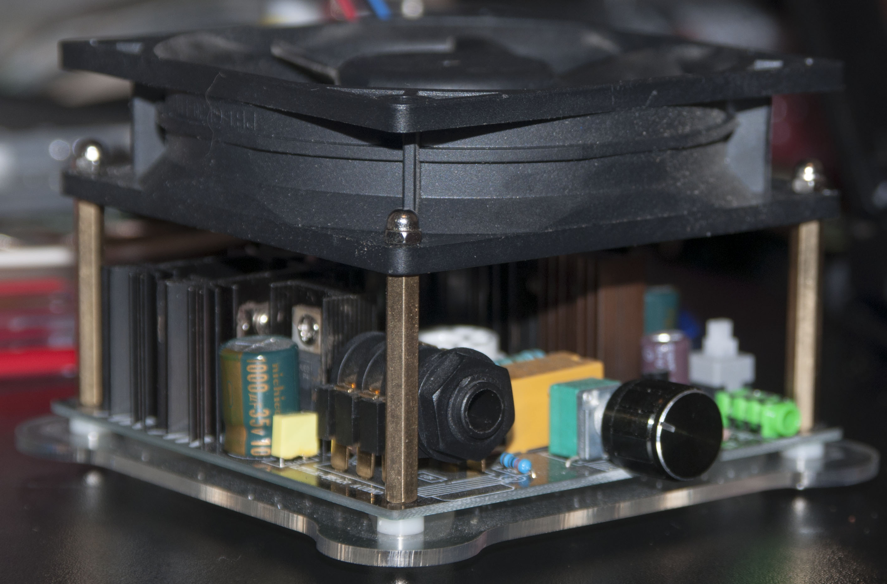

                    Working at figuring out a cooling solution for the modded Little Bear P1 amp I got. This particular one had the MOSFETs and OP Amps replaced but the cooling remained the same as stock, getting hot enough to discolour two heatsinks.
                    This here's just a mockup of what I'm thinking should do it. I'm aware that running a fan off the internal power will introduce noise into the circuit (which matters for an amp) but it's not hard to run a second 12V lead with an inline pot along with the 24V input for a fan.

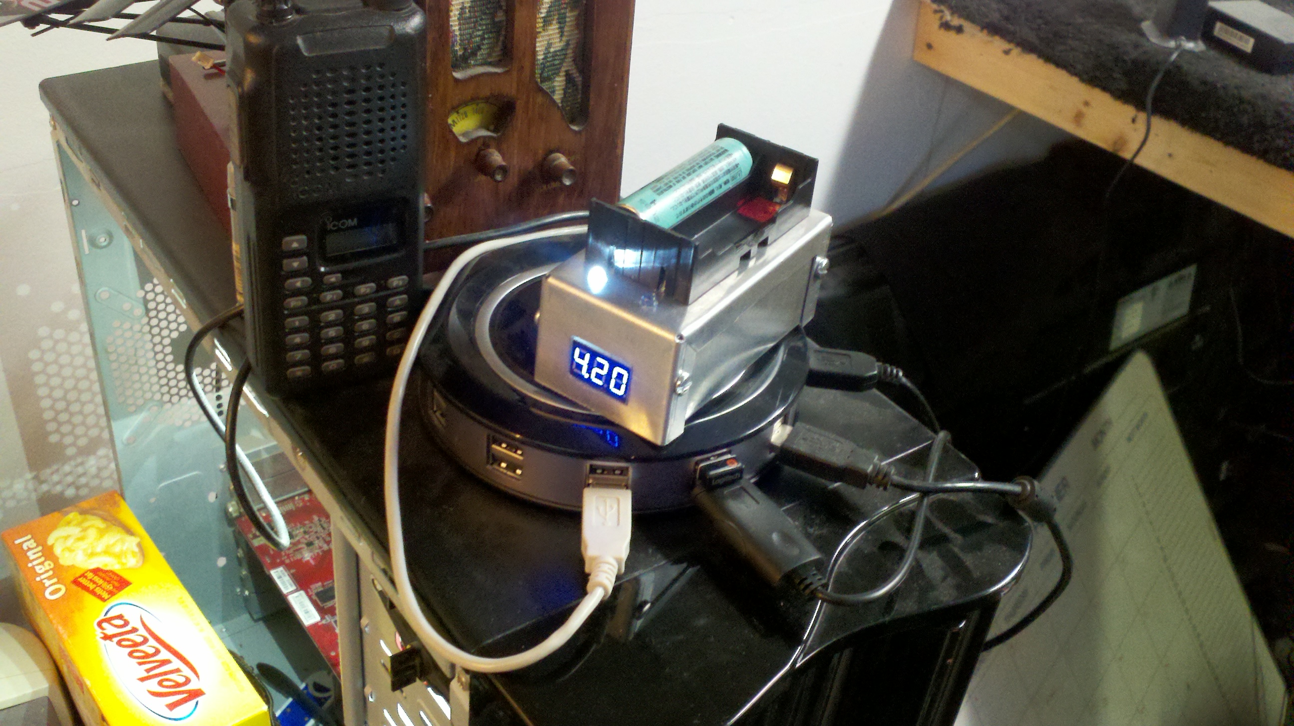

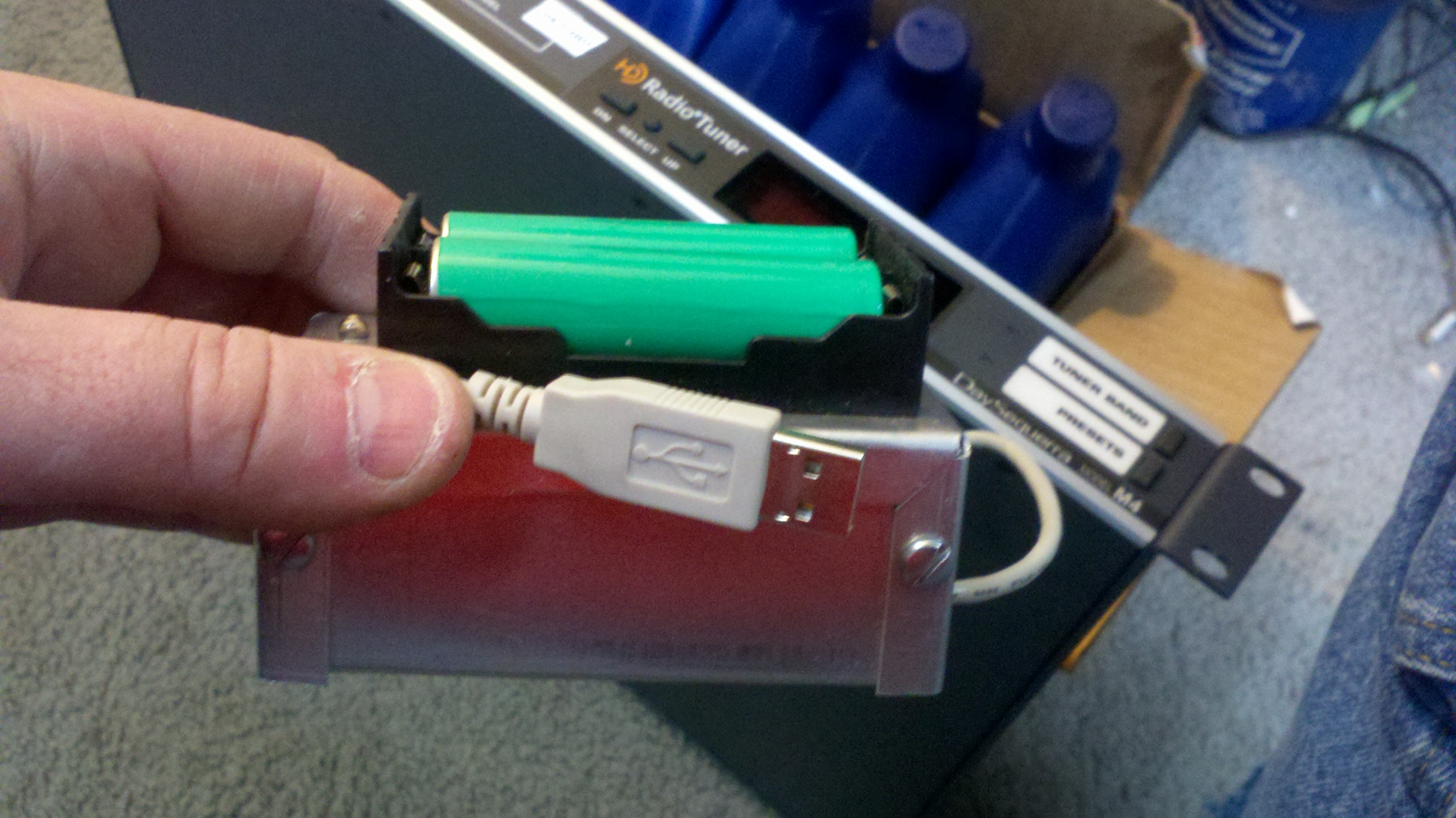

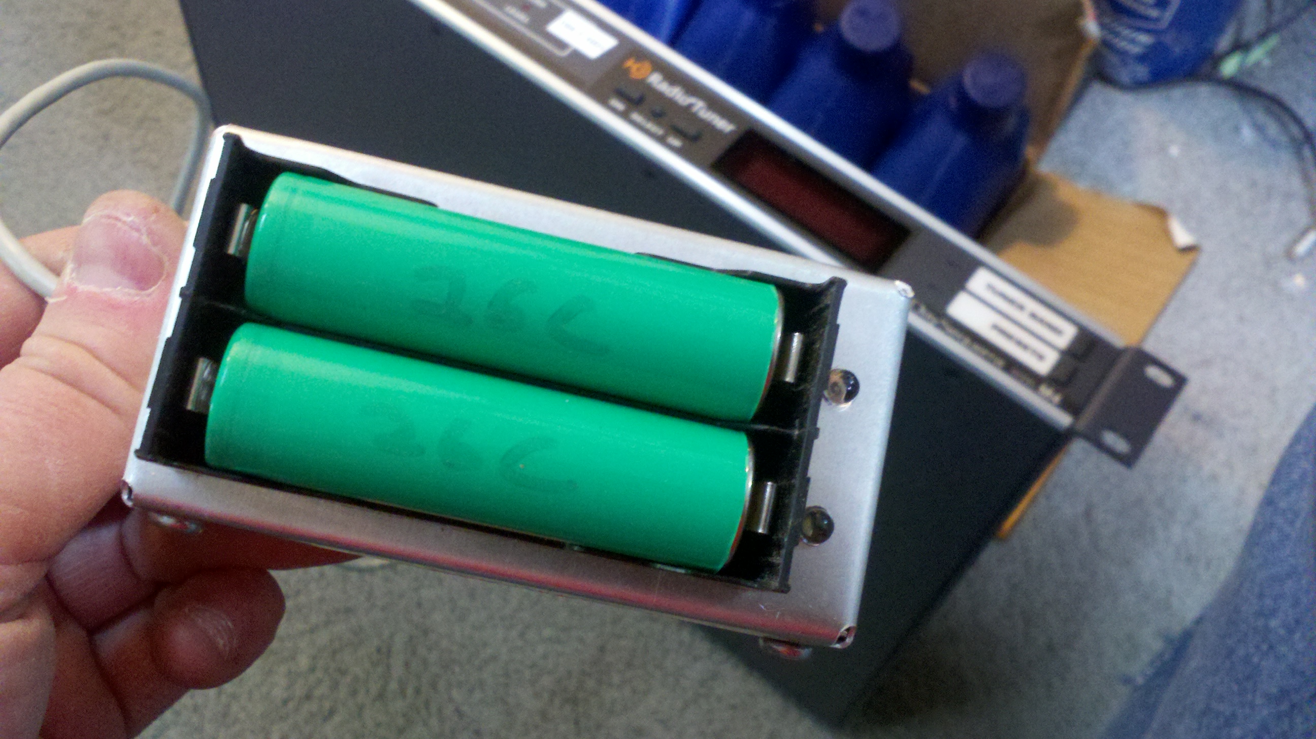

                        homebrew ghetto 18650 charger

                          Nice but what's inside the box?....

                            a tp4056 and 3 wire voltmeter

                              Is it really ghetto though? It looks too good!

                                I agree, it looks quite well made. I am guessing you made the case too? (or perhaps a friend who does metal work?)

                                  Looks like a fairly standard aluminum project box to me.

                                    Yah. That doesn't qualify for this thread unless there is duct tape, jagged edges and/or wire ties involved

                                      compared to the box mods we make it is.

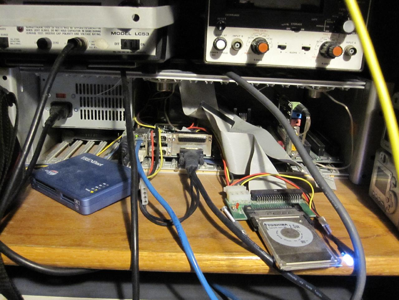

                                        My "ATX" case for an ATX dev board for the Geode GX1.
                                        - Old aluminum card cage from something rather. No clue.
                                        - sound card with no bracket to make it fit, and zip tied speakers to the top of the cage for "sound" (which I no longer use)
                                        - Drilled holes and threaded holes into the rails to attach standoffs.
                                        - When I noticed there were not enough standoffs I stuck some coaster CD-R's as insulation.
                                        - PSU is not even an ATX PSU, it's some custom PSU that doesn't fit regular ATX cases, I just shoved it in where it fits. Fan is useless (but this board is a low power board and the CPU does not even need a heatsink.
                                        - Not visible, but I had a bit of a PCB that was useless that I retrofitted into a power up one-shot that would turn this board on whenever power comes back. It's shoved into the card cage slots into the back for mechanical stability else it's just floating.
                                        - And of course I need space so my Sencore LC meter and Monsanto (yes I think that company...) timer/counter are on top...
                                        I normally run this headless but it's on a KVM switch now.

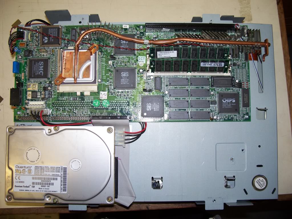

                                          Upgraded a Monorail Computer many years ago and upgraded the CPU from 166 to 333mhz. Needless to say there wasn't room for the heatsink and fan, but the chipset heatsink assembly from a G5 worked well with a little...persuasion.
