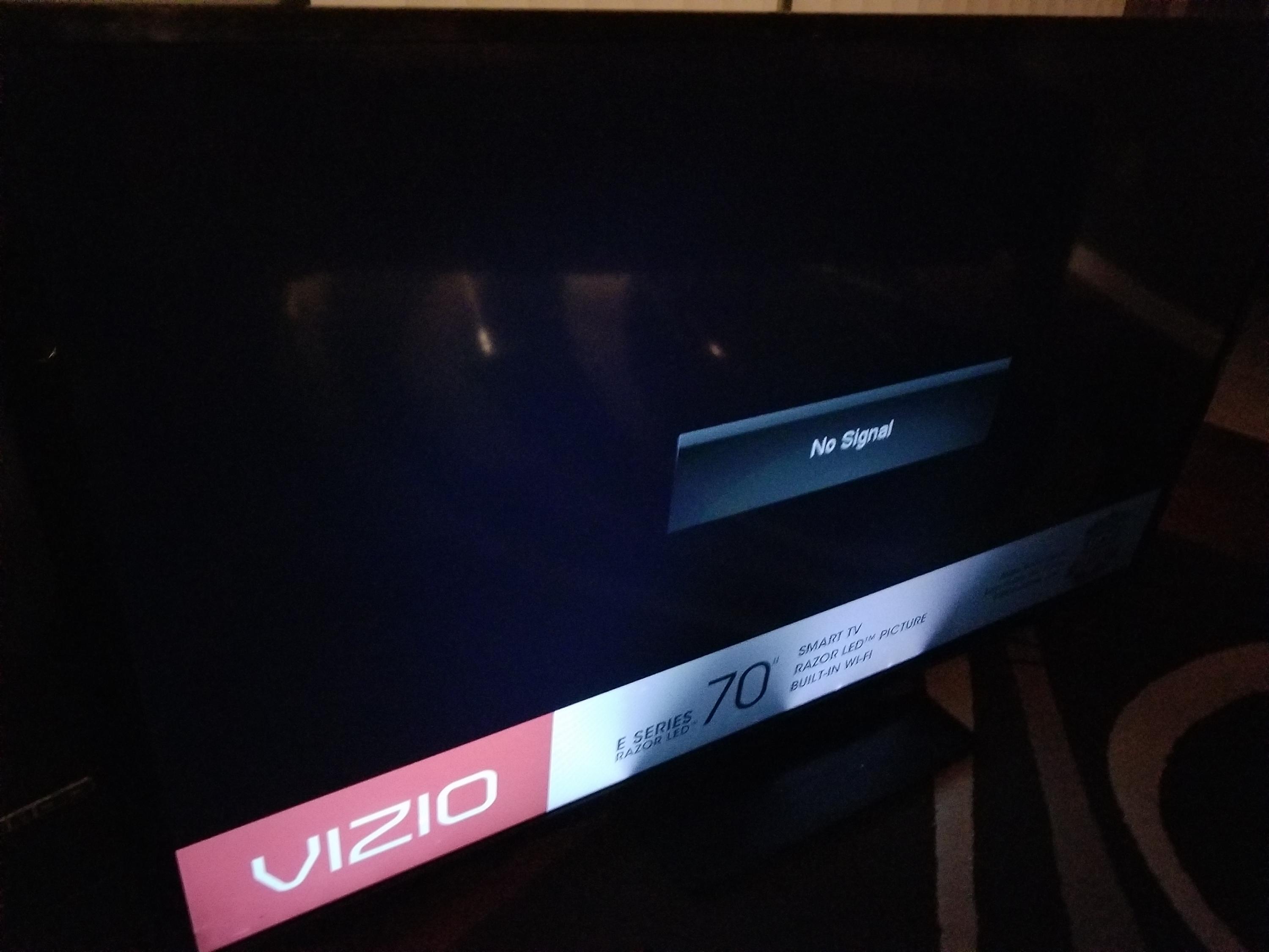

      Hey Guys, just wanted to say thanks to ALL involved! I was able to save this 70" bad boy! It's now my primary TV.
      A little spin as to what I was reading in the thread. Admittedly I did not read the whole 40 pages.
      So I had a different transistor that seemed to be shorted. I did not remove it from the board for testing. So I looked for all the correct voltages and found them!? I thought for sure the Tcon would have shit itself?
      So anyway, I isolated the side with the bad chip and took the ribbons off and she was good!
      Biggest and cheapest TV I have ever owned.....Thanks to you guys. I meddle a bit but would have NEVER been able to figure this one out!

        Just bought a vizio e701i a3. With black screen but power and sound. Replaced tcon board and about 10 minutes later it faded black from left to right. Would this be the same symptoms as mentioned or should I just get a better tonight board. Again 5years old and just went out. Thanks much

          yes the tabs need to be removed from the bad side of the panel that went dark first then new or repaired tcon.

                I just completed a fix of a Vizio E701i-A3. I'd like to share a few lessons:
                1) If you look up your T-Con board at www.shopjimmy.com, you will see that there is a whole slew of compatible T-Con boards:
                http://www.shopjimmy.com/vizio-runtk...d-see-note.htm
                You can use the list there to look for your best deal on ebay or wherever, however . . .
                2) Based on the following info posted by freakaftr8 (page 32, post #634):
                "It appears that the lower-end Vizio/Sharp/Sony that uses the e701's t-con board is the only board that seems to short out when failed drivers happen. All the Sony and sharp in Vizio 3D models seem to have more robust t-con boards that can handle the side drivers shorting. Also on a side note I would like to add that I ran across another customer with the common shorted-out t-con bad right hand side drivers on an E701. I was able to use the t-con board out of a Sony 70-inch 3D model and it worked perfectly."
                I chose a RUNTK5489TPZA board (which, I believe, is from a Sony) instead of one of the RUNTK5261 boards which is what came out of my TV. [I did go through the trouble of trying to fix my T-Con and was very careful and the repair looked beautiful, but the board still did not work.] The lay-out of components on the 5489 boards is slightly different than the 5261 boards. It doesn't have the FET in the location shown in post #3 that everybody is replacing. I believe that the 5489 boards are more robust. This is based freakaftr8's info above plus the fact that I operated my TV for a good while (maybe a total of a minute or-so) with the incorrect corner ribbon disconnected while I tried to decide whether I had guessed correctly as to which side to disconnect first, and the TV kept working. [What I was seeing with the bad side connected and the good side disconnected was the bottom 4/5 of the screen had a halfway-decent picture and the top 1/5 was black (Keep in mind that there are five side driver tabs, so my top driver was the problem.). When I finally had the BAD side DISconnected and the good side connected, I saw a nearly-perfect picture on 4/5 of the good side and a dark image on the bad side.] So two lessons here: Choose a 5489 board (which will tolerate making the wrong guess as to which side to disconnect for much more than a few seconds), and when you see a ~perfect image on the connected side of the screen (over most of the height anyway), you can feel confident that your DISconnected side is the one that is bad.
                3) A third related lesson is just buy a replacement T-Con board that is not one of the ones from the E701i-A3, e.g., one of the 5489 variety. If you are going to buy FETs, you are going to want to get several, and with shipping, it will cost you $10-$11. Plus, it is no trivial task to unsolder/resolder the FETs. And, when you are done, the T-Con may still not work. To clinch the deal, the 5489 T-Con that I bought cost me all of $7 with shipping.
                4) When pealing the tabs off of the screen, if you peal them in one motion - either from the top-down or from the bottom-up, you will leave a little corner piece of the tab on the sceen. The last little bit of corner just wants to stick to the screen and tears off of the tab. So peal a little bit from the top or bottom first, then switch to the other end and tear the whole tab from there.
                I tried this 5489 za board and it did not work for me at all. (in both the 60" and 70" vizio) mine came from a 60" LG

                                  Wondering if anyone can give me some pointers here.
                                  -I have the e70i-a3
                                  -One day the picture died and but the audio was still pumping
                                  -saw this thread and seemed to have same symptoms
                                  -Ordered new t-con board from shopjimmy
                                  -installed new t-con board, removed lower right ribbon cable, plugged TV back in
                                  -no change in symptoms, screen is black, no 'v' upon fire up, but backlight is on
                                  -checked connections, reinstalled right side ribbon cable, removed left side ribbon cable, tried again and once again there was no change in symptoms.
                                  Any advice?
                                  Much appreciated!

                                    If you don't have any voltages on the board besides 12 v off of the coils if you look through my post and find out how to measure voltages on this board, There's a good possibility that you shorted the board out again Because you disconnected the good side 1st.
                                    Check the COXA transistor to see if it's shorted again.

                                      So I checked the 100 3r3 and 4r7 posts as you recommend:
                                      100: 12v
                                      3r3: 0v
                                      4r7: 0v
                                      Did I fry the new tcon board already?
                                      • freakaftr8
                                        • Oct 2012
                                        • 3743
                                        #819
                                        Re: e701i-a3 no picture but backlights
                                        Yes most likely unfortunately
