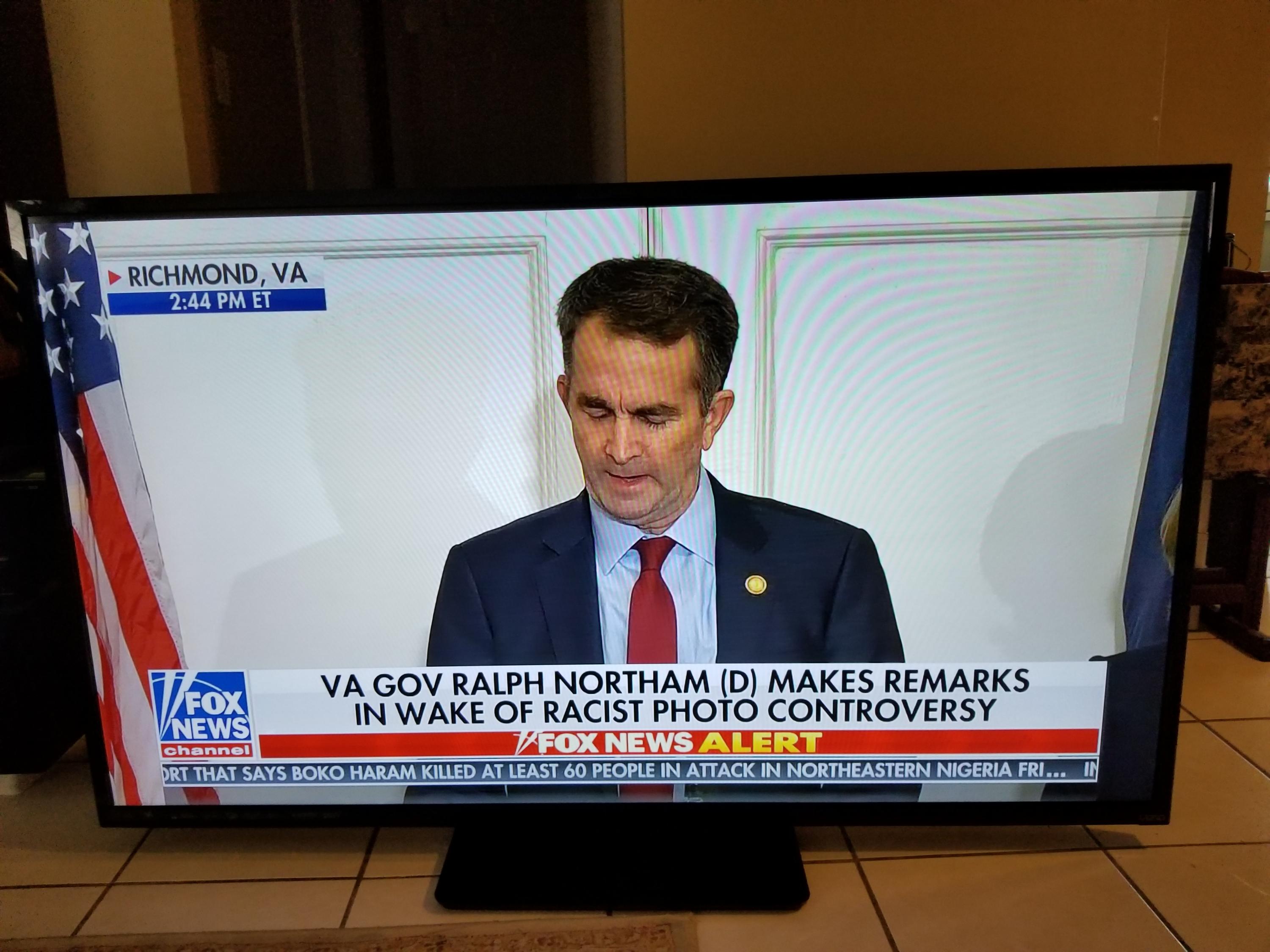

                      I have a ?, I replaced the transistor on T-Con. The right side ribbon drivers are disconnected (by the connector on the corner of the screen which is damaged anyway, but the tabs not yet torn off the LCD panel). This is the picture I get. Just distorted in the middle of the screen. Is this right?
                        Re: e701i-a3 no picture but backlights
                        well... what happens is that the side tabs are still there BUT they are "unpowered" because the corner cable is disconnected. The result is that they "load" the other side "a bit" such that the dark area of the screen shows up.... middle to the side disconnected. IF you actually put in a "nice known test pattern", you could readily see any other potential issues. Having said that since you did replace a component on the board and now you get a picture and the card works, this is a strong indication that the problem was related to that side and thus like many in this thread, you are likely able to save the set by removing the side tabs on the bad side.

                          The problem is, I damaged the small ribbon cable feeding the right side. So I can't hook it back up to see. So that picture is left side hooked up only. I just wanna make sure before I rip the tabs off that the right side is the issue, which I think it is.

                                  I want to say first to be very careful with the ribbon cables in the bottom corners, as I damaged mine, and even though I think that's the bad side, I cannot confirm with picture test. If you look at this photo, that's what my screen looks like now after disconnecting the right side ribbon.

                                  I just haven't ripped the tabs off yet hoping someone would comment on my screen photo first.
                                  As you can see only the middle of the picture is bad and confusing me..
