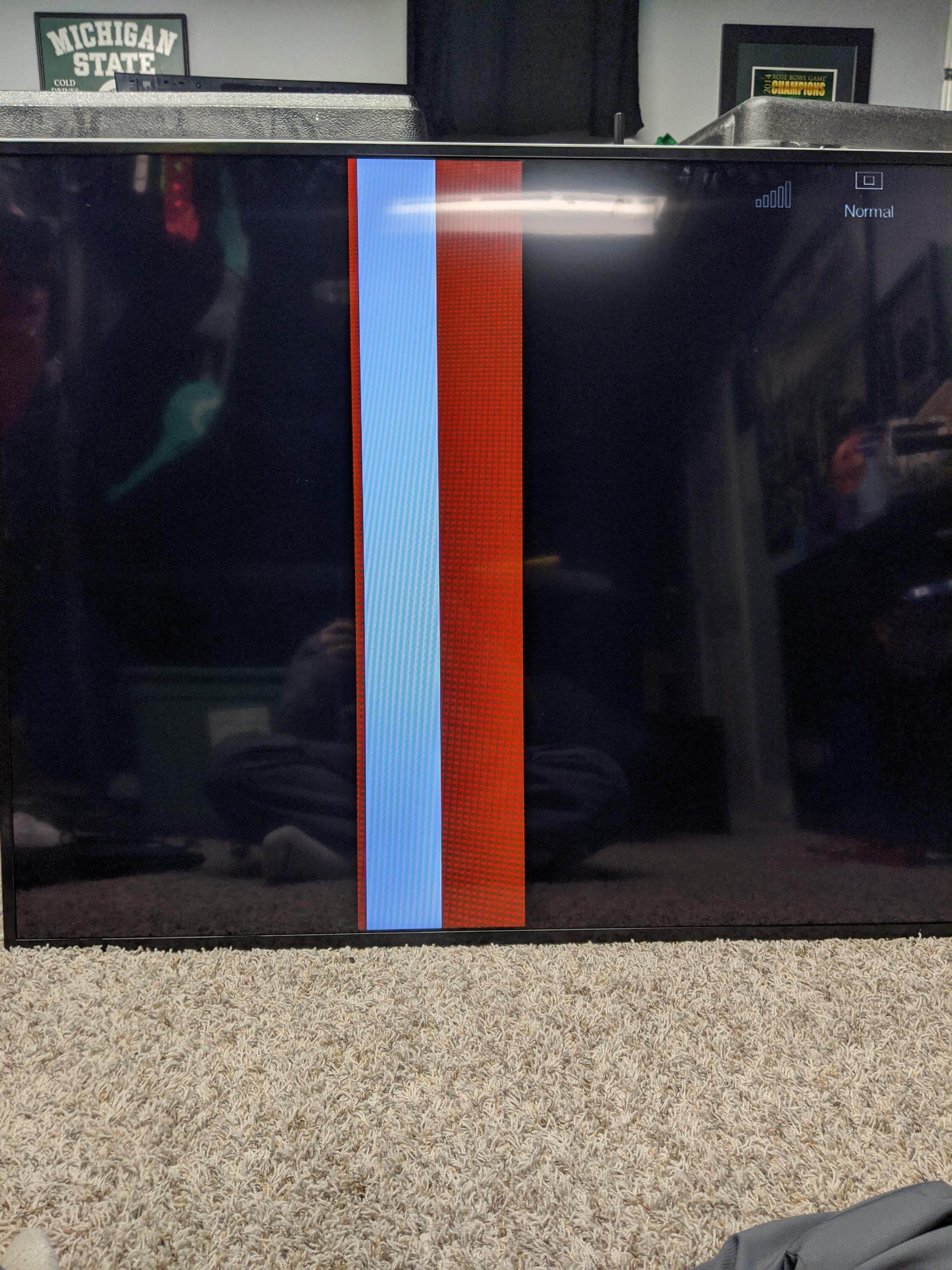

              Hi guys-
              I just fixed up a Vizio m701d-a3r. Same problem as the majority of others, left panel was bad.
              I now have the middle of the screen with 2 huge vertical bars covering up. I will post a pic once I get down to the dungeon to take one. Curious as to whether this is bad tcon or bad bottom lcd?

                Originally posted by suprteacher
                Hi guys-
                Here are a couple pics.
                • budwich
                  • Jul 2015
                  • 3097
                  #968
                  Re: e701i-a3 no picture but backlights
                  that looks like one of the cable from the tcon to panel isn't set properly.

                    I thought that too. I cleaned them and reseated them. Now I get this???

                      Wondering if it's a bad cable? Tried switching them around to see if it was a bad cable or bad panel on the bottom. Not sure if I screwed everything up by doing that.

                          I just messed with it again and am back to the red and black lines. I am seating the cables using a magnifying glass.
                          I tested the mosfit and get 15.6v on the top. 15.6v on the right bottom and 0v on the left bottom.
                          I was tapping on the tcon to panel ribbon on the offending side and it would flicker to get the whole vertical line red. Lost for now
                          • budwich
                            • Jul 2015
                            • 3097
                            #973
                            ok... that's good and bad. It appears to show that there is something up in the area. How are switching / reseating the cables. You are releasing the clamps and then lightly lifting the ribbon which should then "pop / spring out" from the connector just based on ribbon "flex" / tension. You need to look closely at the cable itself to ensure all the conductors are ok (lightly gold plated, i think). Further look under the clamp to see if things are ok there with the pins / "fingers". Further, the cabling associated with the "lines"... is this on the same side that you indicated was the "bad side". Lastly, when you said you fixed your set, what exactly did you fix?

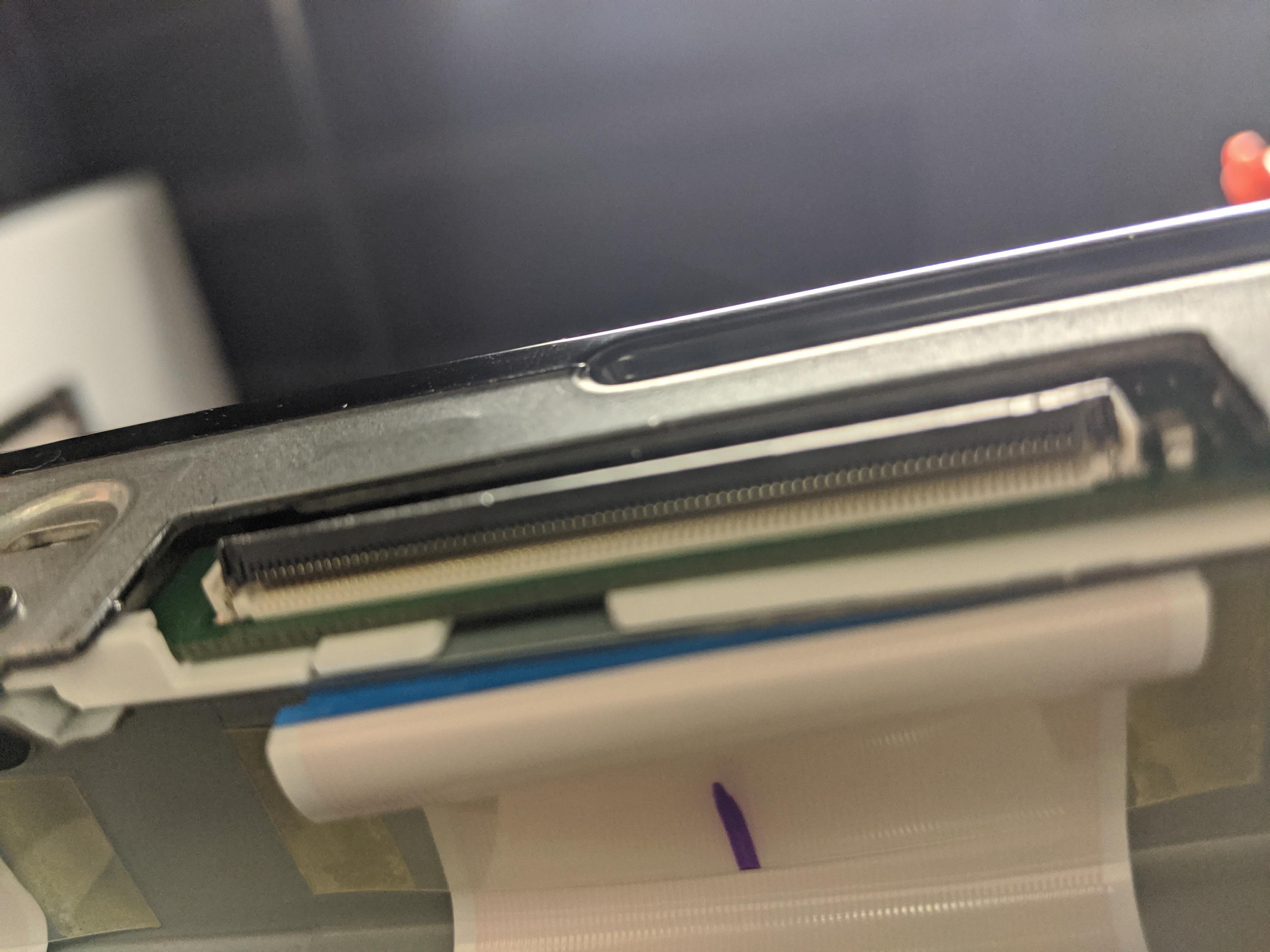

                                  I took a couple pics. First one is what tv looks like now. Identical area of both sides of screen (just different colors). Next couple pics are of the 2 ribbon cables where I see what looks like a problem. Last pic of of the slot where the ribbon cable goes into the LCD from the tcon board.
                                  • budwich
                                    • Jul 2015
                                    • 3097
                                    #977
                                    :-( certainly appears that you have found an issue. The question is what is causing the problem especially since you switched cables and it appears now the "switch" has caused the other cable to have a similar issue. The last picture is not clear enough to see any problems with the connector. You need to look very closely... maybe using some form of magnification to check the area.
                                    With the power off, can you put back the cable the way it would be normally and take a close up of the area again. This will show us how you are "seating" the cable. Take a picture of one of the other cables that is currently seating to compare.
                                    Further, from the way that the cable is "damaged", you are likely not going to be able to easily see the problem from the "front" as it is likely in the "last miillimeter" IF it exists.
                                    IF you are lucky, you should be able to find replacements.... BUT you need to find the ROOT cause otherwise you will be just repeating the "failure".
                                    Further, the cable may "saved" with some very careful trimming to remove the millimeter or so of the bad end.... I think some have done it in the past... but it is probably a long shot depending on your skill and tools. Still further, now that you know where the problem "starts" and that you may have ruined a couple a cable ends... don't do much more with that connector in terms of inserting... BUT I do believe that the cables might be reversible... meaning that the other can be switched around to insert into the "bad connector". This could be a ONE TIME test... to see if inserting into the connector causes the damage. Take the other end of a bad cable and check it to see that is "good". IF so, try inserting it into the connector, clamp, then unclamp and remove. IS the result, a now damaged cable? Hopefully you understand.... good luck.

                                      I tried reversing the cables with the ends that go to panel now going to tcon board and the end that used to go to tcon board now going to the panel. I get the exact same result.
                                      I then tried fixing the ribbon cables by 'trimming' the problem area off the end. I then seated the cables back in and have the exact same result.
                                      I am able to jiggle one cable to get the middle bar to change colors, but it never brings up a picture. The new messed up section on the right side is now stuck in that multicolored vertical bars, never changing while jiggling either cable.
                                      Throughout my research, it is looking more like the bottom panel now has something messed up. I wonder if I'll be able to take any of the driver's from the bad panel and be able to fix the bottom drivers?
                                      My next step is to get a new tcon board and new ribbon cables I guess to double check that the bottom drivers are actually the problem.
                                      While waiting on the new parts, I'm going to gently move the rest of the bottom led driver cables to see if the tab bonding is the problem. Hopefully this isn't the case.
                                      Thanks for all the help. I'm wondering if in my haste to fix, I screwed something else up that wasn't broken in the beginning.
