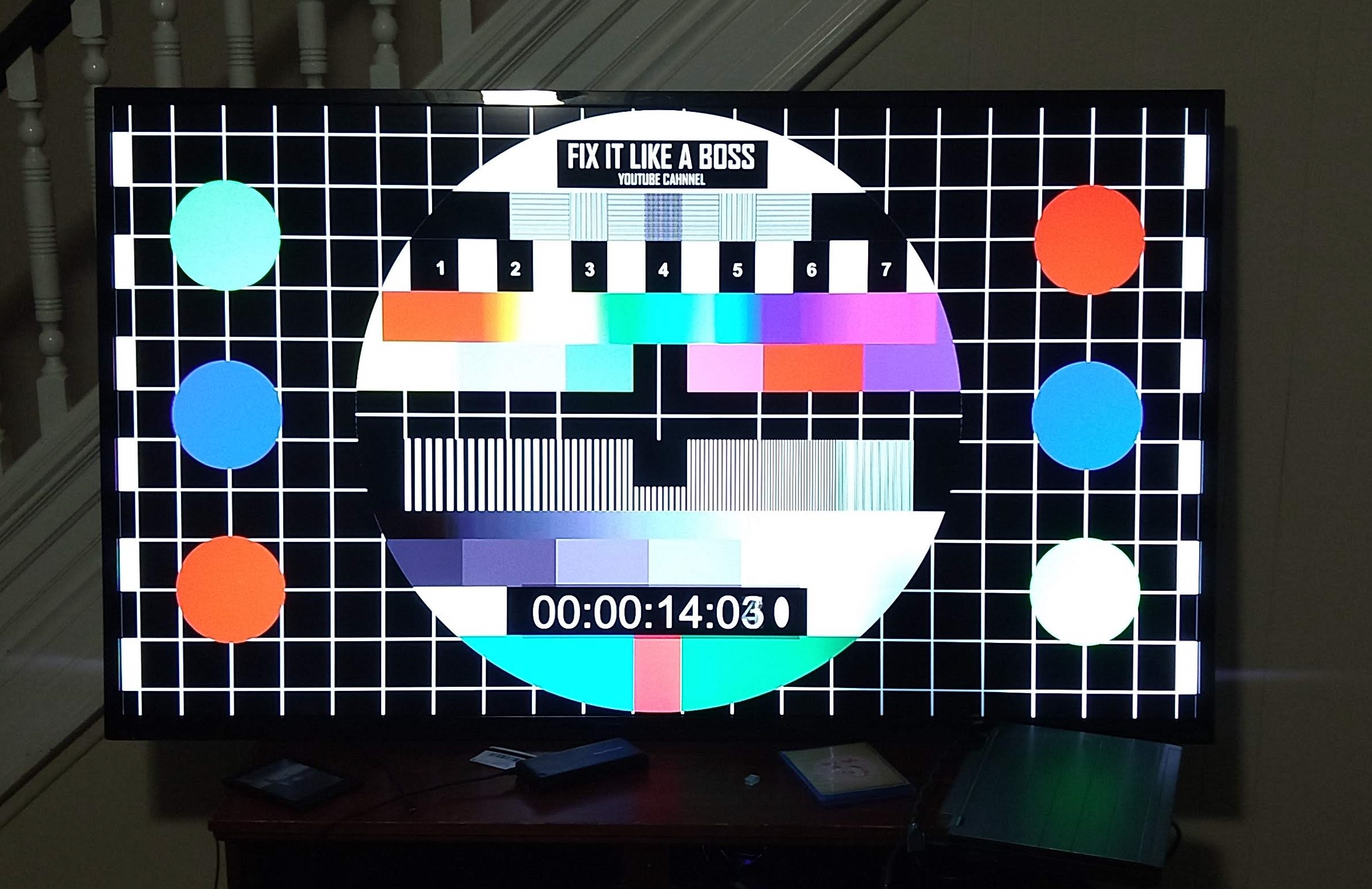

                                    #957
                                    Re: e701i-a3 no picture but backlights
                                    I have a working TV! It appears that there may be one bad LED in the backlight, though.
                                    The T-con I used was part RUNTK5489TPZA, thanks to Charleyd's post (https://www.badcaps.net/forum/showpo...&postcount=797)
                                    I paid $9 for mine on ebay. Started up TV with RIGHT side (Vizio logo side) drivers disconnected, and got good left picture.
                                    Proceeded to remove right side drivers, and it came right up!
                                    It is difficult to see on the test pattern, but much more visible on the other image - is that a blown LED in the backlight causing the dark half-circle on the bottom right side?
                                    • diif
                                      • Feb 2014
                                      • 6978
                                      • England
                                      #958
                                      Yes, I think so.
