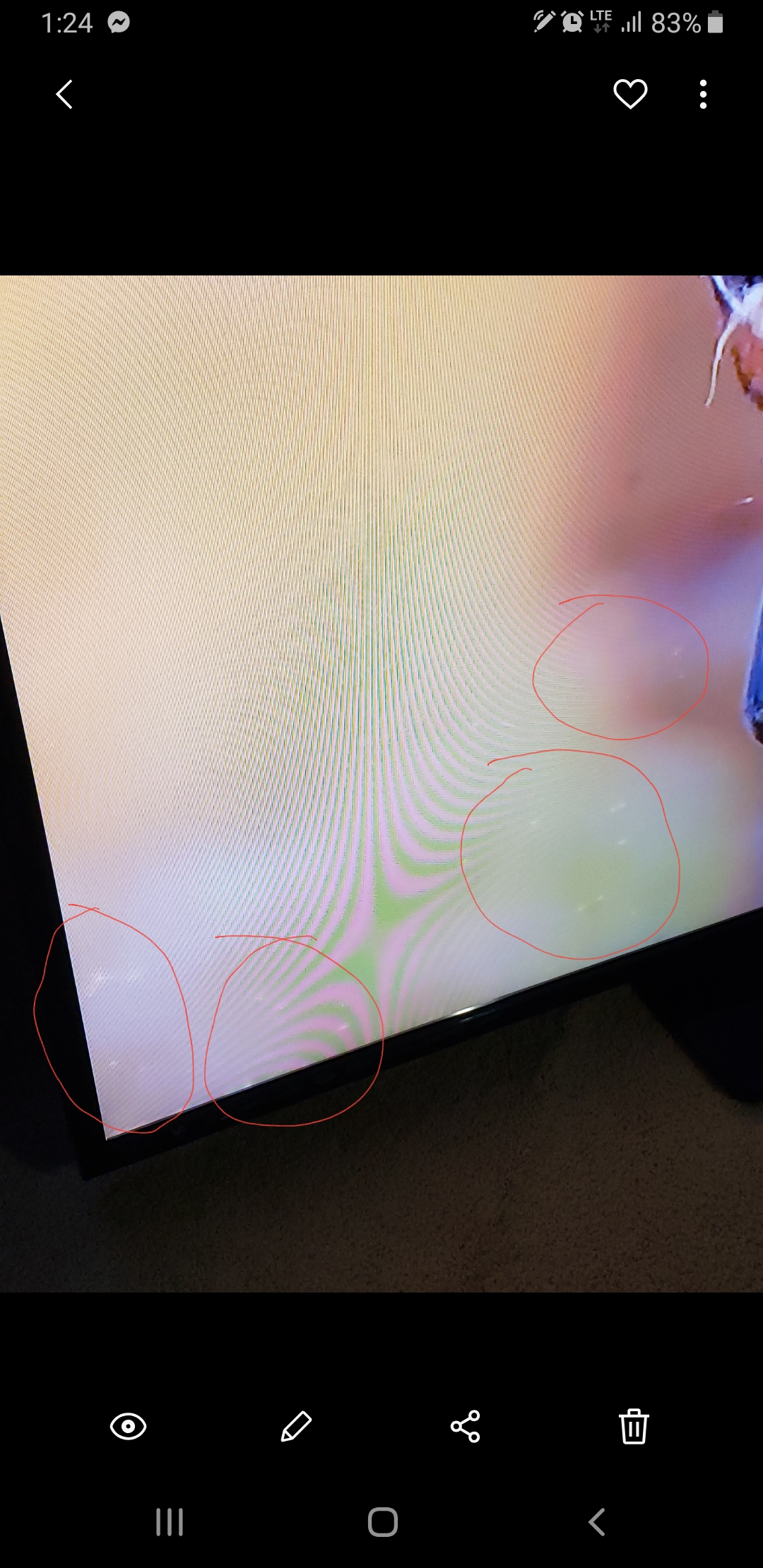

                            Has anyone messed with a Vizio D650i-B2? I have one where there's just ghosting picture of vertical lines but disconnecting one side of the panel at the T-Con board gives a good half picture on the other side of the screen. I have not taken the TV apart down to the panel to see if there are any side ribbons that can be removed. Panel # T650HVN05.9

                              @Kevin, take it slow, tab removal can not be undone, in a lot of the tvs that were fixed by this ingenious method, thanks Freakafter8, had horizontal lines running thru the display, which is not to say that it has to be, just that you want to make sure the tab/s are the problem before removal. Did you try the disconnect one ribbon cable at a time to see what you have on display?
                                Yes I have repaired an E701i-A3 with the same issue and fix. One side of this panel is bad I just don't think there are side tabs on this one. I took one apart with a broken screen a couple weeks ago but didn't pay attention.

                                  are you looking from the front? Side tabs (no boards) are only visible when the front plastic bezel is removed.... but a 65 may not have them. I think they do... 60 or smaller usually don't.

                                    Maybe check the mlcc caps on driver board for shorts or very low ohms, guess it could also be a tcon issue.

                                      Guess you could try the "cut tape" method, sometimes you have to fuss with tape placement to get it right, might not work but doesn't cost much: https://www.youtube.com/watch?v=j7vl7-vZEL8

                                        I see what they're doing with the tape, but is there any method for which pins to cover or trial and error?

                                          I think most start on outside and work their way in, mostly trial and error.
