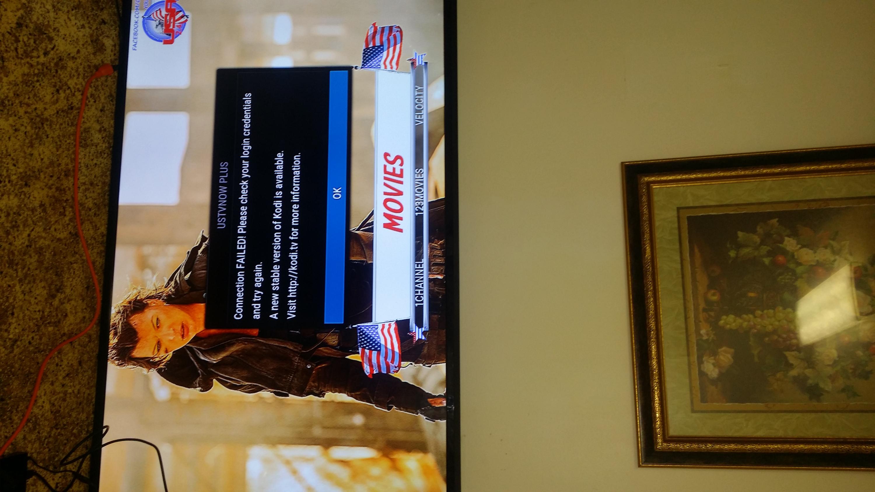

                                  Re: e701i-a3 no picture but backlights
                                  I have unplugged the left white ribbon and still just backlight when I power it up; and then I tried the right white ribbon, and still just backlight. I even tried unplugging them both. I ordered a t-con board to get here in a few days.
                                  For my TV, Vizio said it was purchased after the recall date so best to just buy a new TV. Does this indicate that the side drivers are okay and I just need to install the new t-Con board? I don't want to burn a t-con board without being sure about the side drivers.
                                  Thanks in advance!
                                    Looks like it is a bad panel for me. I replaced the t-con and now it boots, but the right half of the screen is gone and there's a horizontal bar across the bottom. I guess I should just trash the TV.

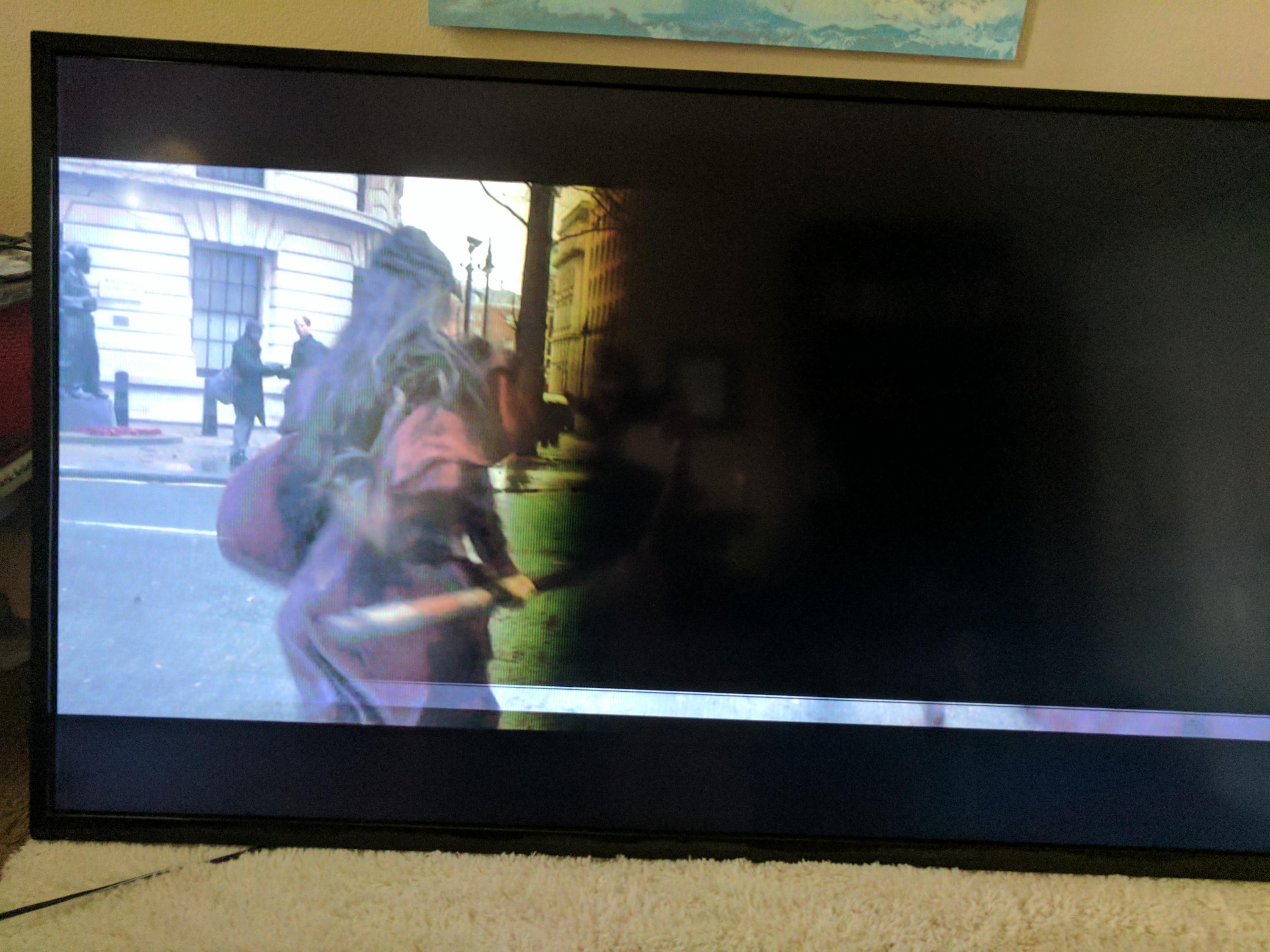

                                        It sure would be awesome if there was a save. Here's a pic of the picture. I assumed this was a panel issue, but since I don't know what I'm talking about any advice would be wonderful.
                                        • budwich
                                          • Jul 2015
                                          • 3097
                                          #720
                                          ok... so you got the picture part right... now how about some description of what this represents... what cables are connected, what are not. My guess is you have bad tabs on the right side (looking at the picture). You should spend some time and read thru the thread as there is lots of info and you are basically close to a save.
