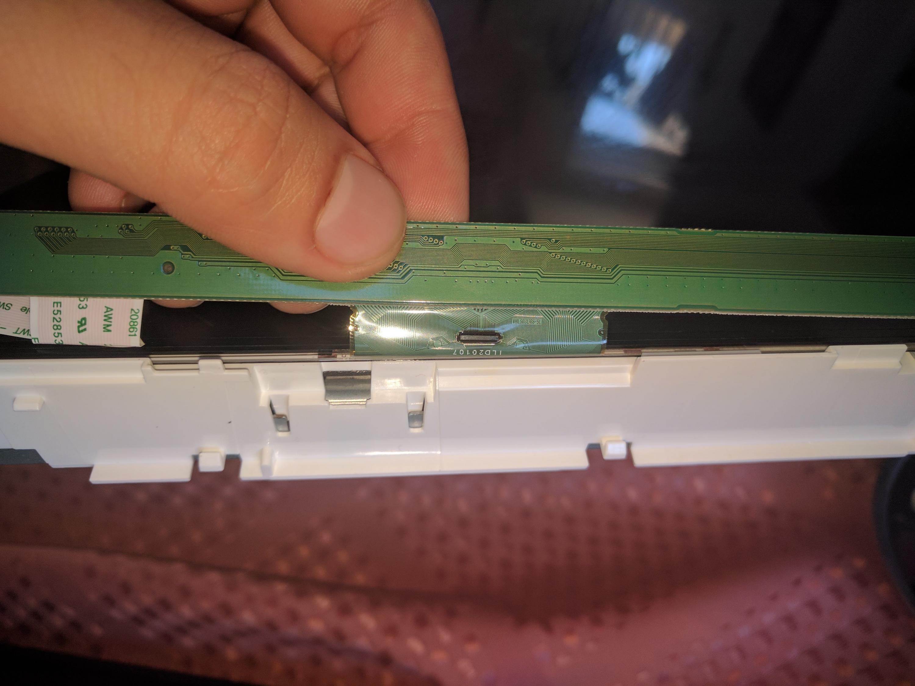

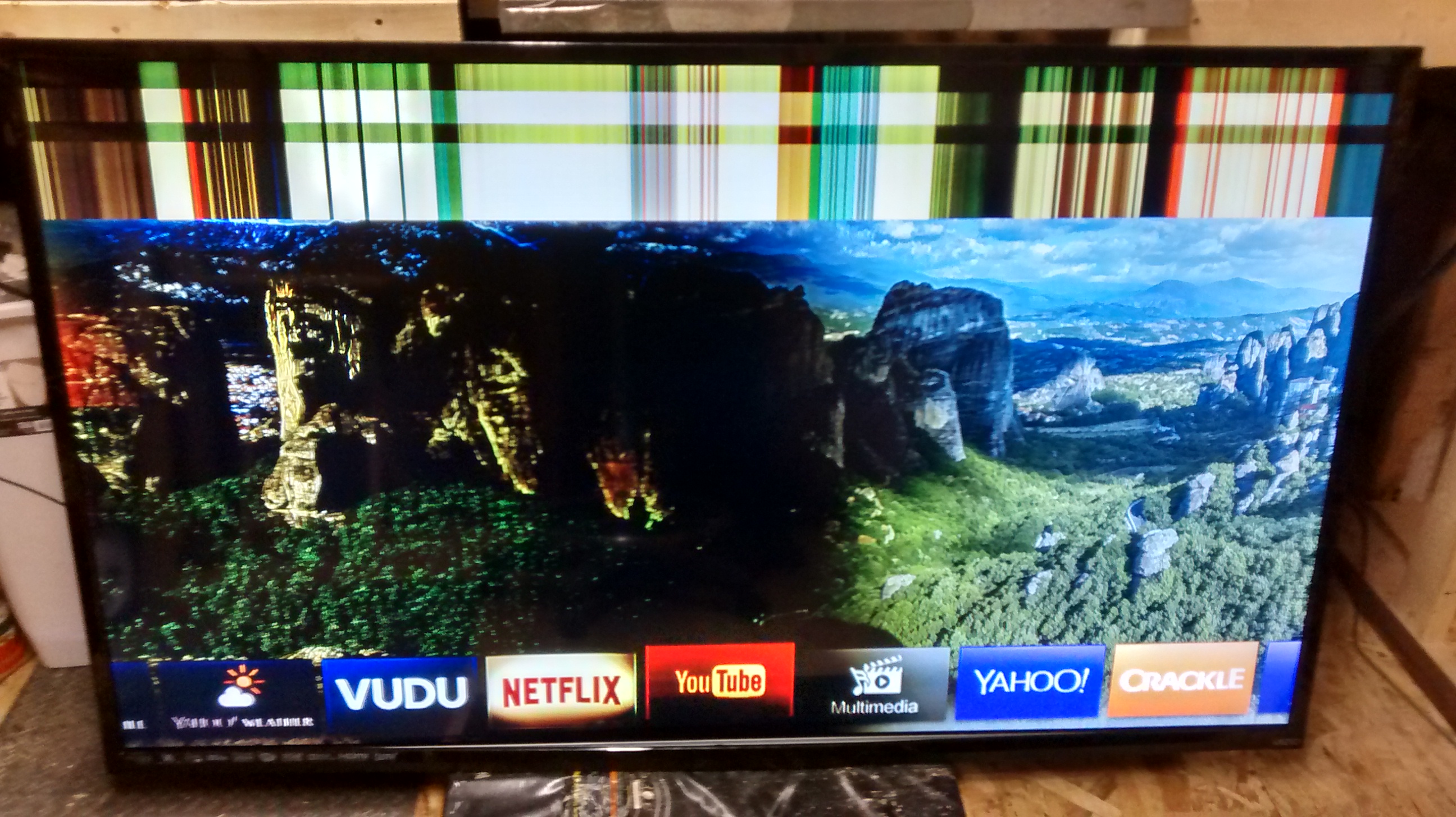

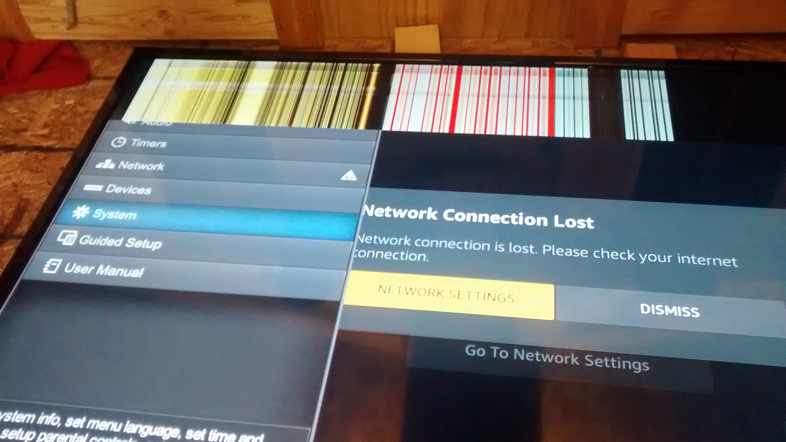

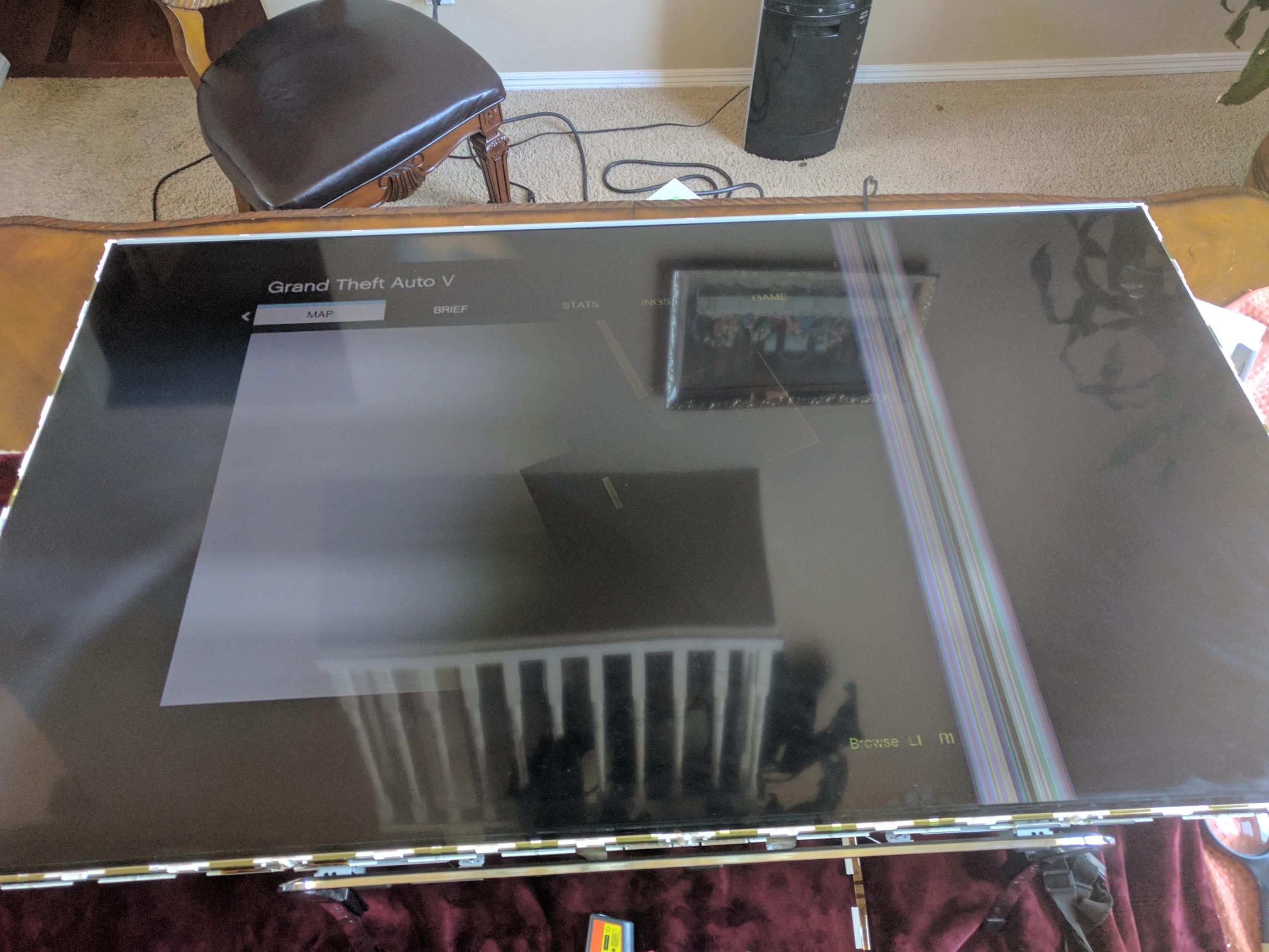

            Hi guys,
            I have a sony kdl 70r550a tv and I feel like I may have discovered this thread too late. I would love to get some feedback from you guys to figure out if I have caused irreversible damage to the panel.
            The tv started with the 5 blink error, so I took the tv apart and without much research, I tried unplugging the white ribbons coming off of the tcon to the panel. when I unplugged the right side ribbon, the tv turned on with the left side looking good [first attached picture]
            I removed the ribbon cable that freak have mentioned and this was the result [second attached picture], PROGRESS.
            so long story short, I did all that testing before reading this thread. I took it a bit further and started trying to de-attach the bottom boards. I made a stupid mistake as I tried reconnecting the ribbon cables back to the bottom right board while the tv was on [I thought I disconnected it]. Now the tv looks like this [third attached picture]
            After reading the thread, I visually inspected the drivers on the ribbon cables connected to the panel from the side boards, and I noticed that the one at the right bottom is a bit brown [see fourth picture for the burnt one I found, and fifth picture is what the other ones look like]
            Now I know if I didn't eff up and connect the ribbon cable while the tv was on, ripping the side panels would have probably fixed the problem, as many of the people here have experienced.
            Would you guys be able to identify [from third picture] what could I have damaged?. I would like to try to remove the side panels and see what's gonna happen, but I don't wanna jump into it before I get some feedback from you guys. Thanks
              Re: e701i-a3 no picture but backlights
              Unfortunately since you have a vertical bar one of your COF chips which drives the panel from the top or bottom is fried. This will not be repairable.
              Never adjust connections while power is on, unfortunately you had to learn the hard way.
