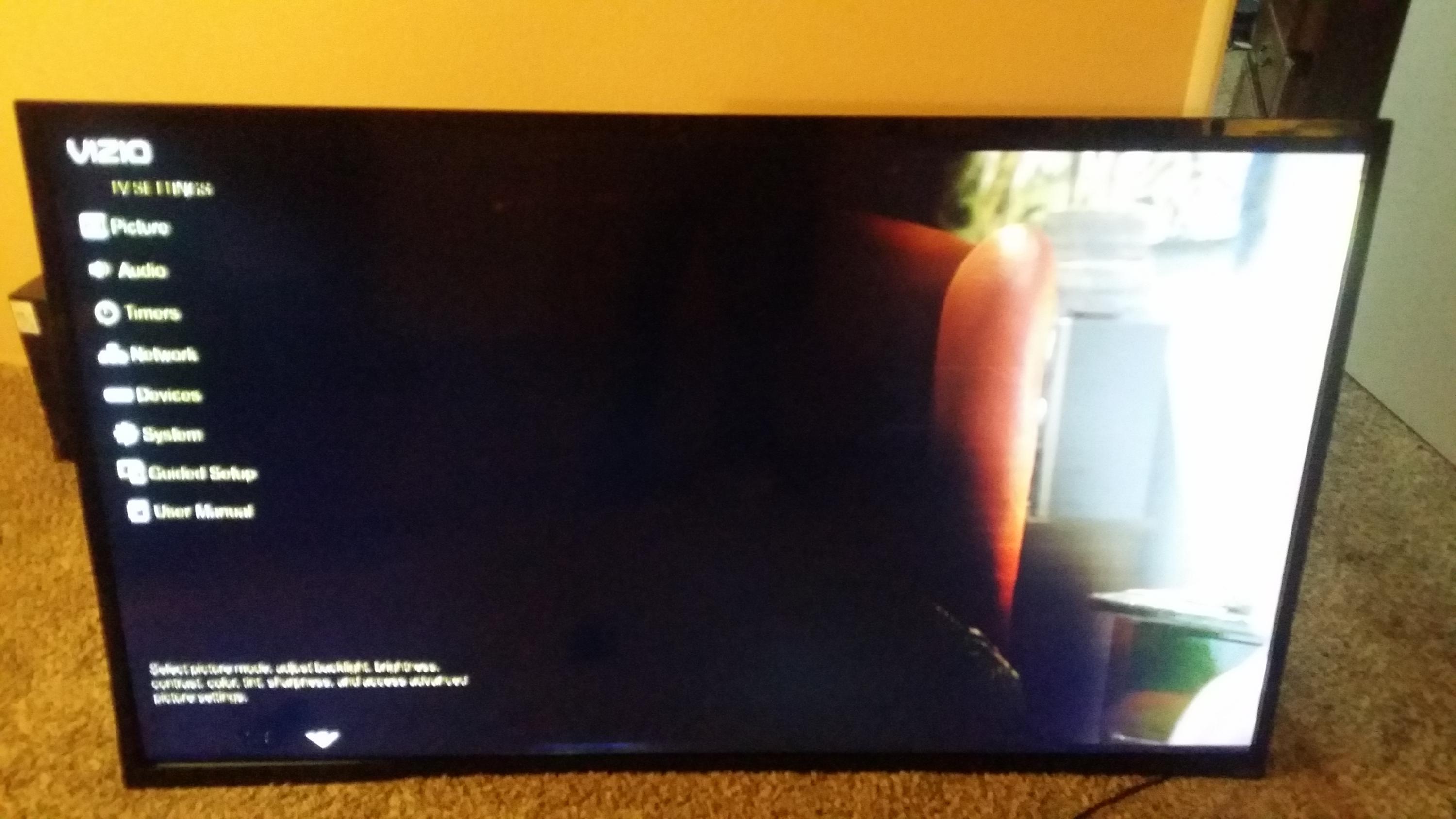

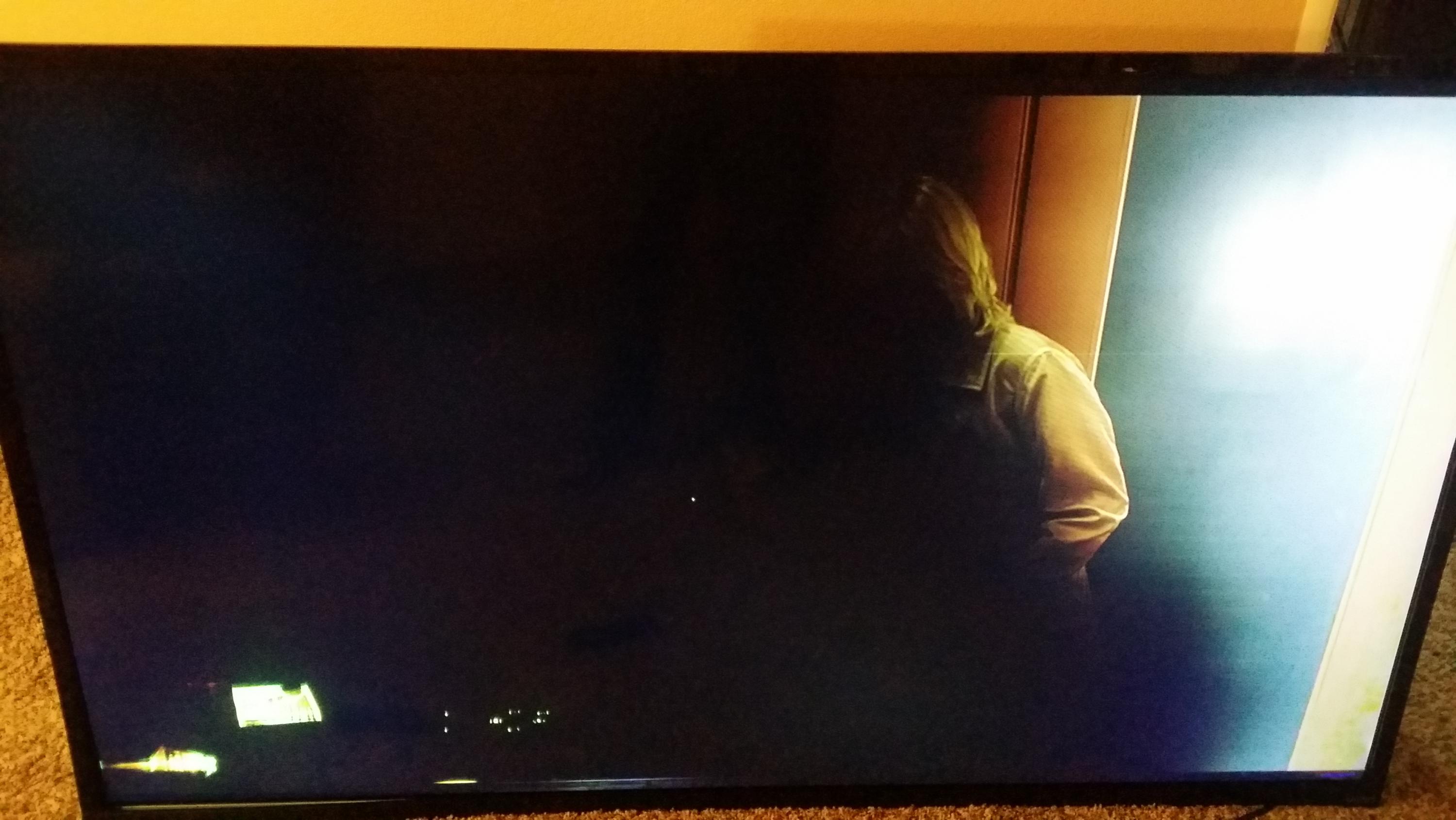

              Removed bottom left ribbon cable to drivers and this is what I have. Anyone know if this is a bad left side driver? Haven't tried other side but can you tell by the picture? Dark pic in middle and I'm not sure if panel is bad.

                I was given a tv with this same problem. I replaced the tcon board and disconnected the ribbon cable connecting the driver board on the right(from the front) side. My results are attached. Going to attemp to remove the right driver tabs. I'll share my results for any still facing the problem.

                  Can't tell from the pictures, what is your result one half good picture and other half distorted or horizontal lines running thru it? and you tried unplugging both ribbon cables from tcon to panel one at a time right? (always with tv unplugged from power) when unhooking cables.

                    Yes. Sorry for the bad pics. Removed the right side driver tabs, but part of it didn't come off cleanly. I'm slowly cleaning the residue off. Currently there is a section in the middle with some short horizontal colored lines,

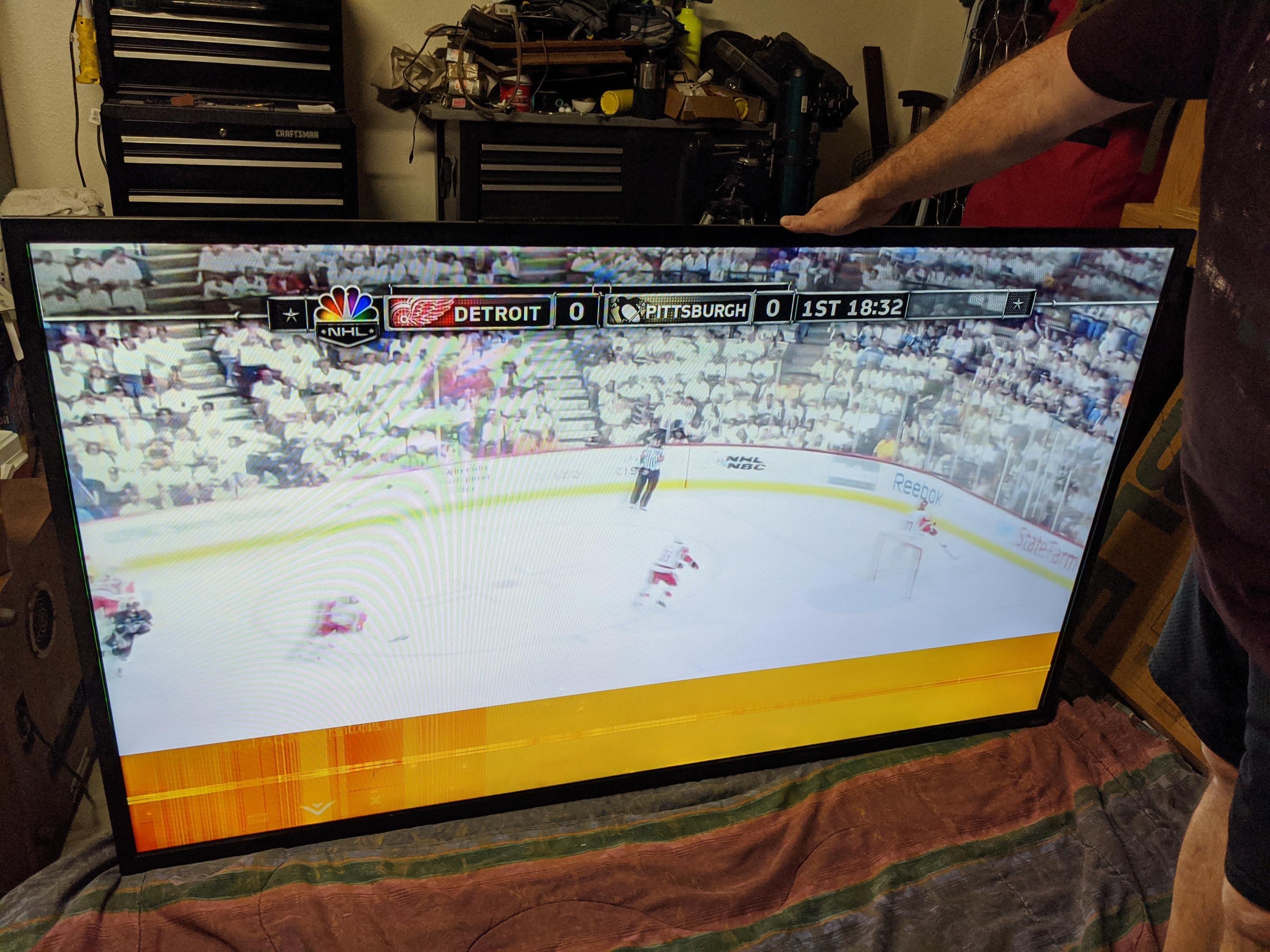

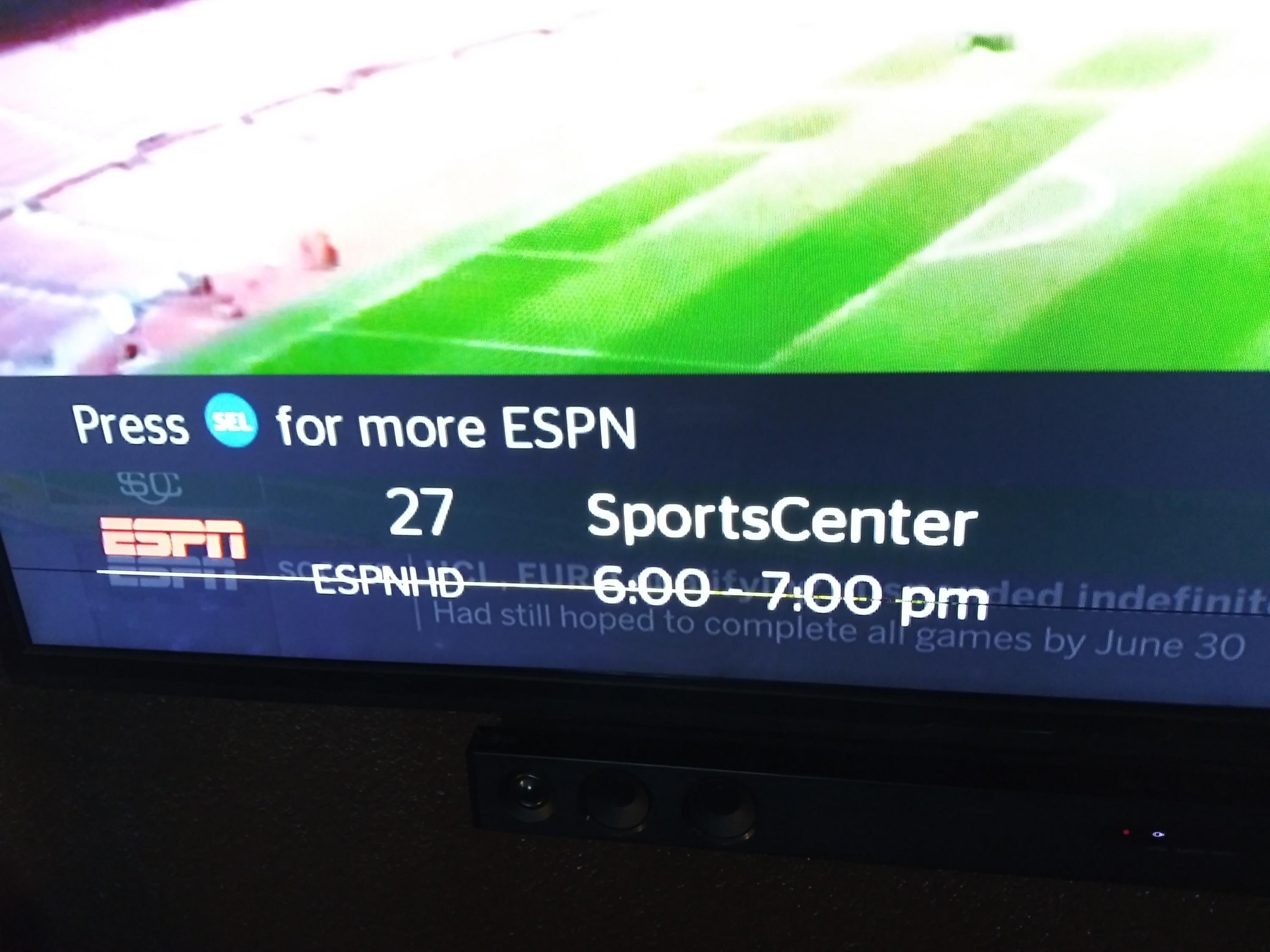

                      I have performed same fix and picture came back. I watched tv for about 2 months and yesterday on the bottom of the screen thin horizontal line appeared. See photos. Line does change colors every once in a while. When i was removing tabls I removed completely board and ribbon cable tabs and they came off nice and clean. I am not sure what is happening with this line now. Is maybe place where i cut off ribbons shorted between those microwires? Is there board on other side of screen and what would taking off of those boards do (opposite side of screen)?
                      After doing fix suggested here tv was good but once i an a while i would notice tiny picture flicker but noone else noticed it. Anyone has any suggestions ? Thanks

                        the "fix" that you likely performed is to fix the card.... but the reason the card (component on the card) blew was because of the issue with the panel which the line on the panel shows. This will eventually take out the card component again. You need to remove the tabs on the bad side also for the tv to be completely saved.

                          Not sure what you mean here BUT if you mean strip the tabs off BOTH sides of the tv THAT would trash it, you need them in tact on the good side whichever it is or the tv will not work.

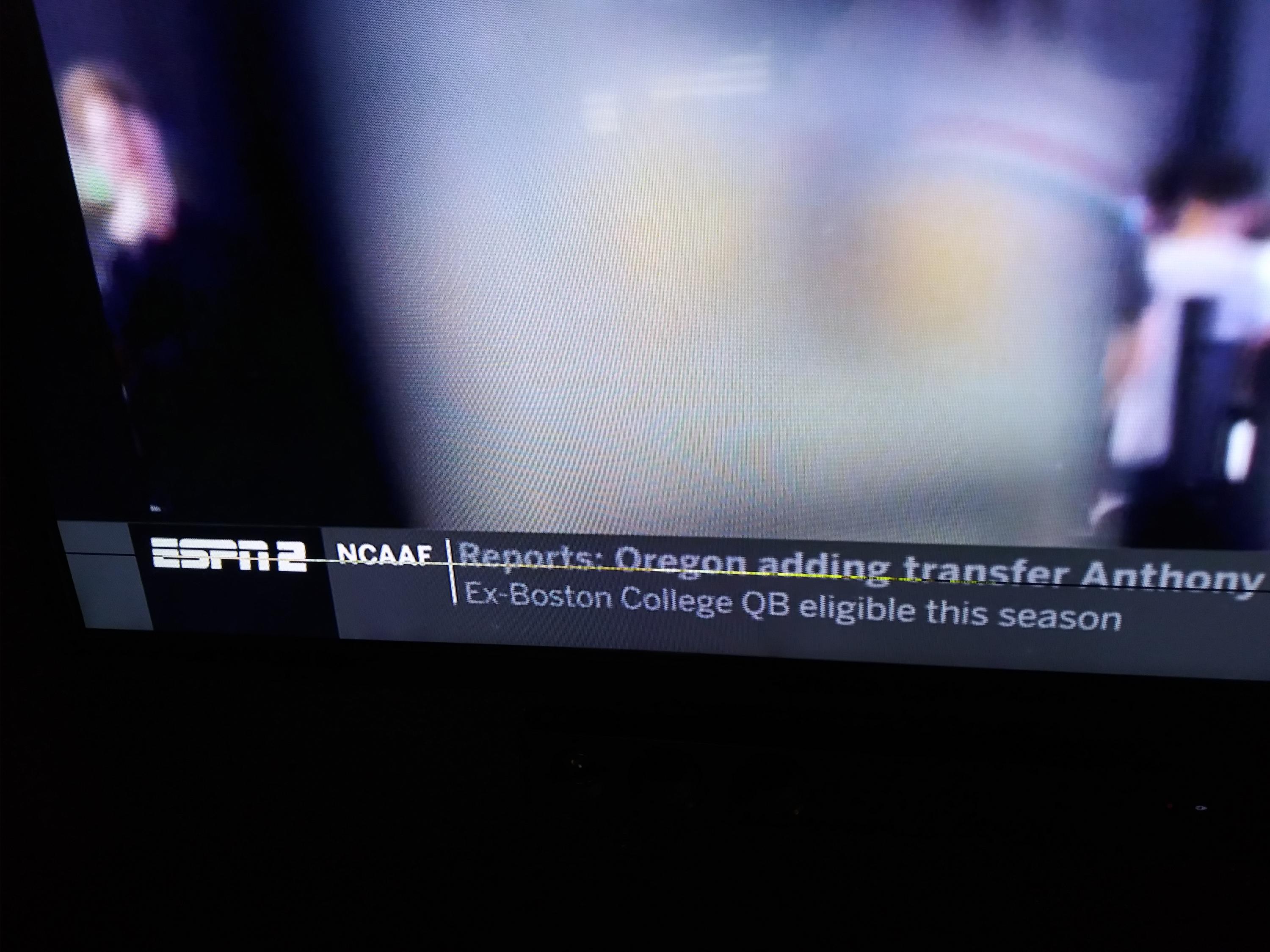

                                Doh! Did that and now the picture is perfect (several little tiny little white spots though) except the the bottom of the. See attached pic. Looks like I didn't do the tabs clean enough?

                                  could be .... without seeing what you actually have done, I have to take your word that you did as good a job as your "cable seating" was... :-) potentially some issue at the bottom corner of the panel on the side you removed. Did you leave the small corner cable in place on the side that you removed the tabs from?

                                    Thank you for the quick responses! The small corner cable and the driver boards are removed from the left side (facing screen)of the tv. I take the bezel back off and look real close at the panel there.

                                      :-( well double check the side area down in the lower part of the screen. Its a big tv and it can be tough to manipulate during your work so lots of things can go wrong.
                                      Another test you can try to see if things improve.... at the bottom of the panel, each "half of the panel", has a pair of edge boards. They are connected together with "U" type ribbon cables which a "unclampable" much like the tcon to panel cables are. Unclamp the "U" cable and see what happens (of course, do cable manipulations in an unpowered state.
