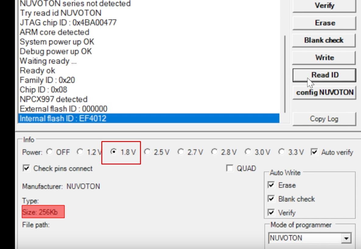

          Try :
          Select Nuvoton
          Read ID
          config NUVOTON - 256kb
          Read

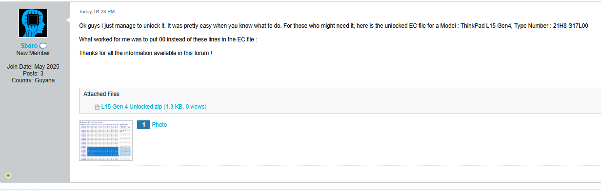

                          #112
                          Hello everyone, (et surtout Max :P)
                          I try to remove the SVP from a Thinkpad L15 Gen 4 with a NPCX997​. I extracted the locked EC file (in attachement) but do not manage to clear the password from it. Can someone help to clean the file or explain a bit more in details how to do it ? I tried to "zero-out" some part of it as shown in this topic before writting it, but without success.
                          Merci d'avance !

                            solved or not??
                            serial number for respect rules
                            PW07KVHM
                            • Sbaro
                              • May 2025
                              • 4
                              • Guyana
                              #114
                              yes it is solved, works like a charm ! Merci

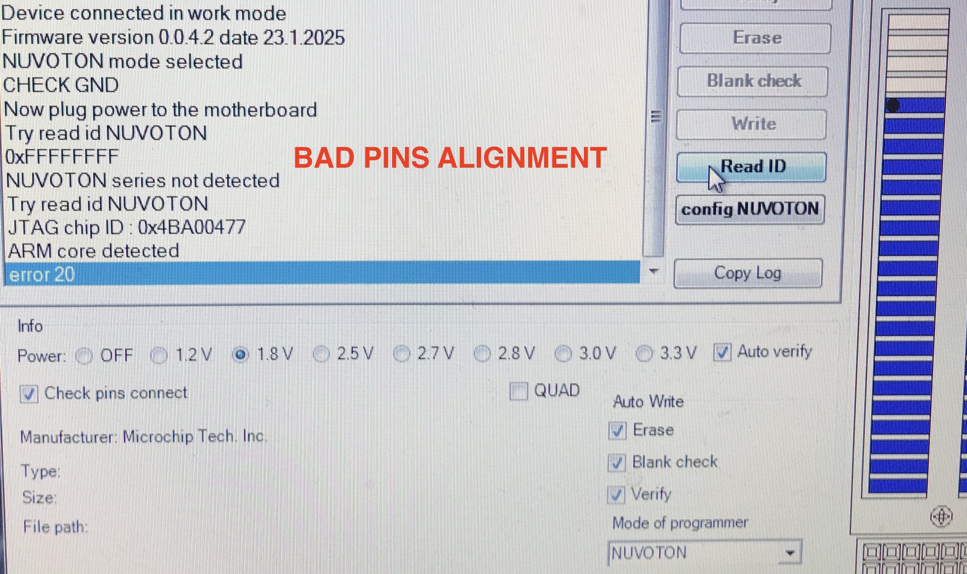

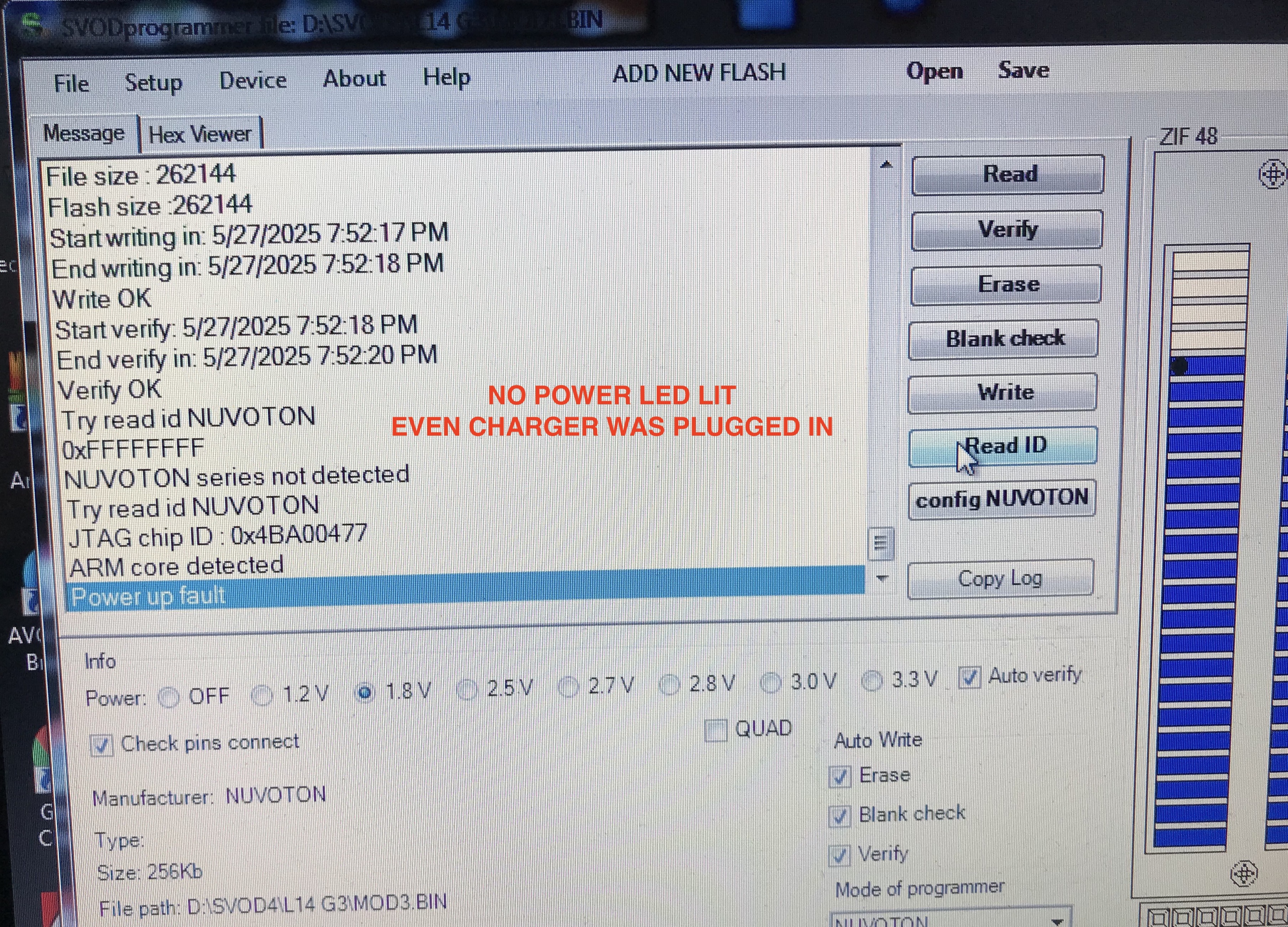

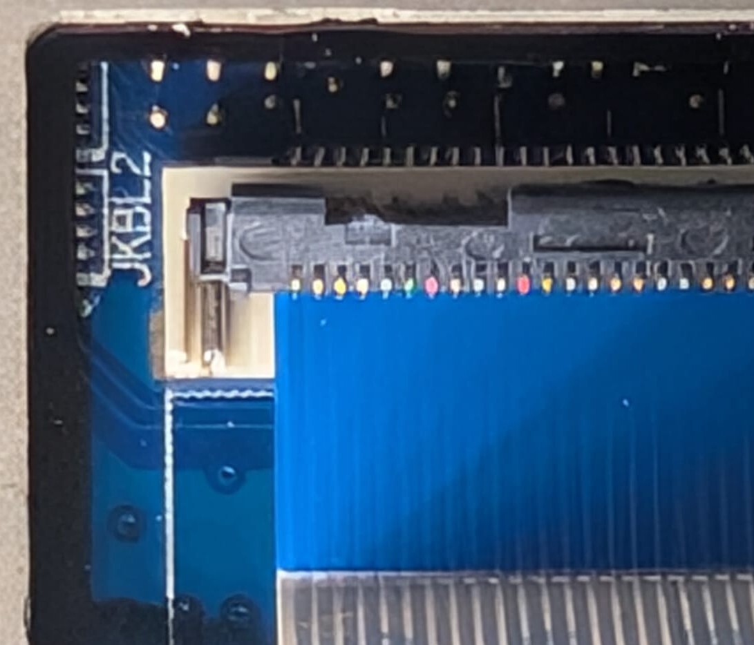

                                    #117
                                    Originally posted by Kodza
                                    I think some of these programmers are faulty, I have gone thru the same issue like you. If you select Nuvoton and try to read it does not detect and if you try support for Svod you don't get any useful help. But the only way I was albe to read the NPCX997 but with ERROR 20 was to select motherboard and click read the same time you connect the charger
                                    no, they are working. Error 20 appears when pins are not aligned or ribbon is faulty. I changed 32pins 0,5mm ribbon with 30pins 0,5mm from the svod kit because I had a lot of error 20 with 32pins ribbon after I used many times. You have to use a multimeter to check pins alignment microscope won't help. Check if you have last firmware and last software for SVOD4. Don't select any board, just select NUVOTON on Mode of programmer, 1,8V for Power and DISCONNECT trackpad, fingerprint, card reader, main battery, etc. Leave RTC batt. on. After plug in power adapter in motherboard check if power led is red then hit Read ID.
                                    Few days ago I unlocked a L14 gen.3 and I had "Power up fault " error beside "Error20", check photos.

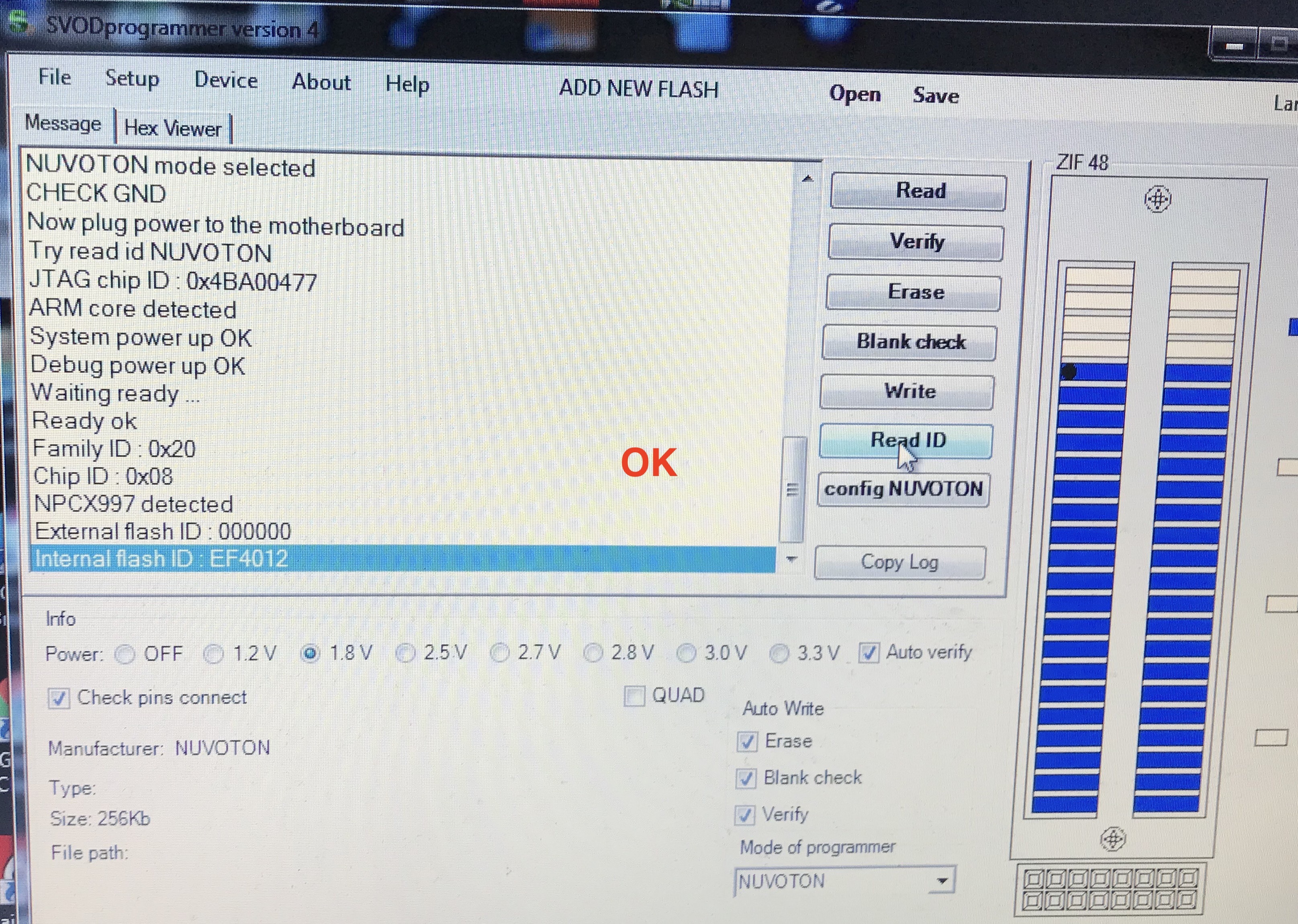

                                        #119
                                        Originally posted by Mullahs
                                        I tried almost every guide and suggestion here in this thread but i was not able to make it work. Maybe it has something to do with the laptop model i have (Lenovo thinkpad T14 Gen 5 -amd). I think i just will wait for new firmware and software update from SVOD.
                                        try to use the right method. read id JUST BEFORE YOU insert ac adapter. unplug battery, read id again if it fails. it has to work
