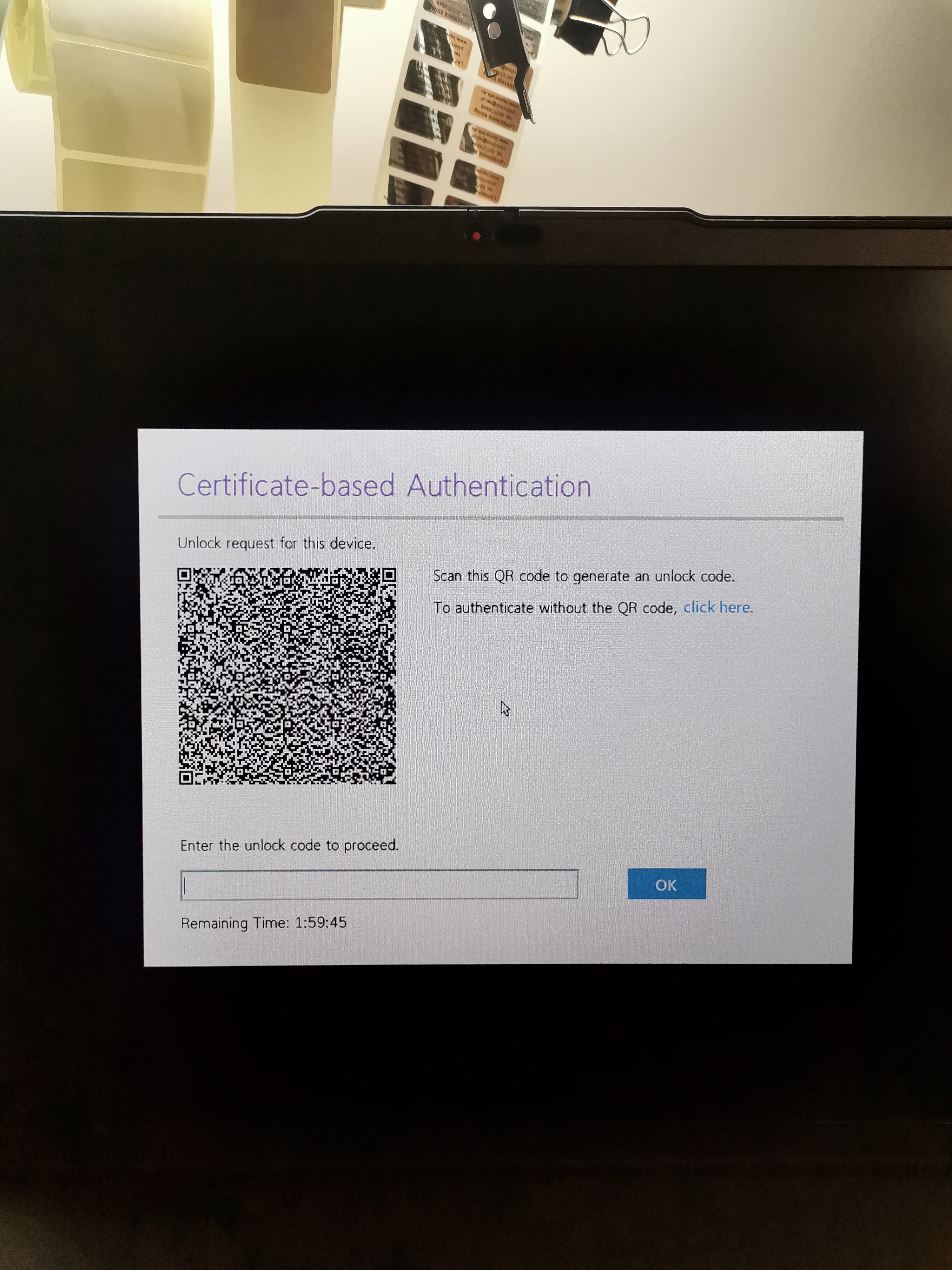

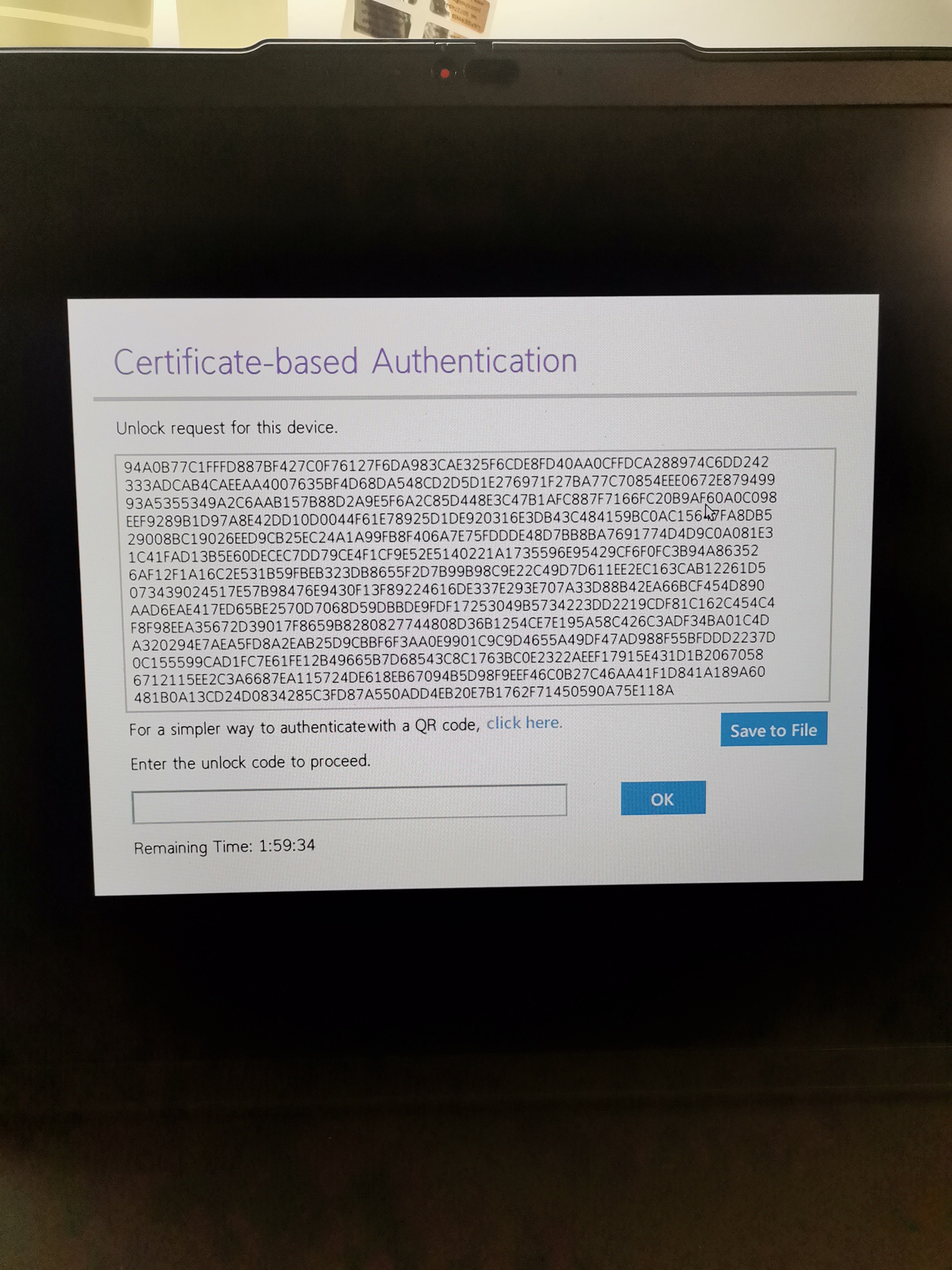

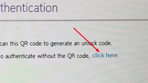

        Originally posted by gerlach
        Unfortunately, this file does not remove the password either. I installed it and when I try to enter the BIOS, I am prompted for a password.
        Write my previous posted dump and disconnect the internet.
        What happens if you click on click here?
        P.S. I cooked another content for you, try it after testing that click thing

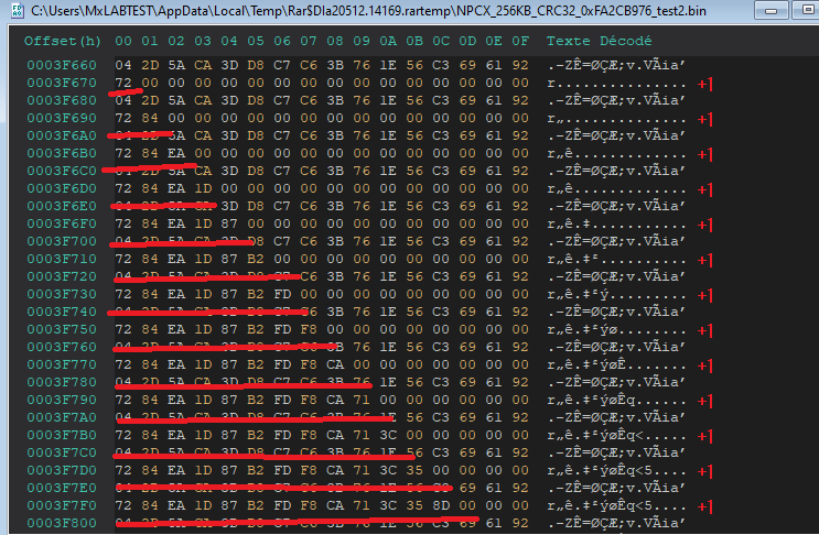

          #184
          I uploaded the file. The error still displays the previous two errors. Additionally, another one appeared: 0183 Bad CRC of security settings in EFI variable
          Have you ever tried cleaning them beforehand? Because I have the impression that some pieces are missing after CON#
          No checksum and password
          all that's left are hashed bits
          volinakis
          Click image for larger version  Name:	Nouveau Image bitmap (16).png Views:	0 Size:	30.9 KB ID:	3775356
          Normally, you don't need to delete it. Doing so would trigger error 2204.
          However, you can use it as a guide to help you delete any remaining items.​
            Click image for larger version Name:	image.png Views:	0 Size:	138.9 KB ID:	3775233
            I can't do this. When I uploaded the file from your last post, I got error 177 with an SVP error, and the laptop immediately aborted POST and shut down. The page with the link doesn't display. That page only displays after uploading batches that don't display the SVP error.

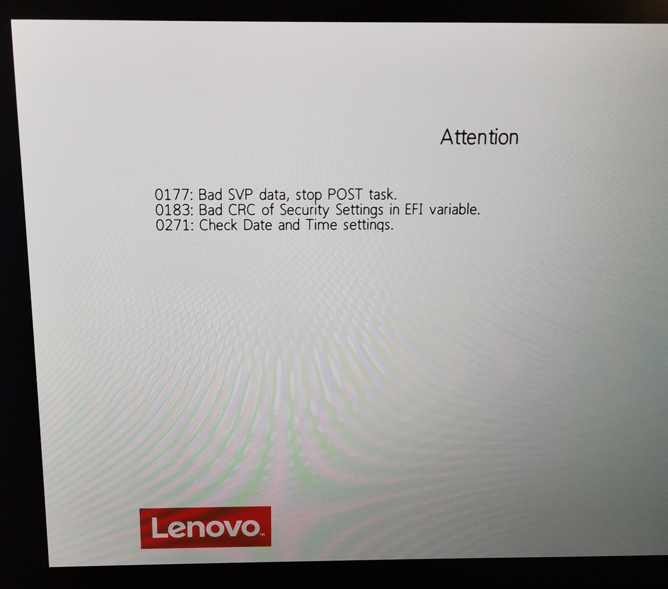

                    #189
                    OK, i think I got it...0177 SVP checksum error.
                    Try test 2...fingers crossed
                    I uploaded this file. There's no SVP error, but a prompt appears with errors. Picture one. After pressing F1, the password appears. Picture two. After pressing the "Click Here" link, a string of characters appears. Picture three.

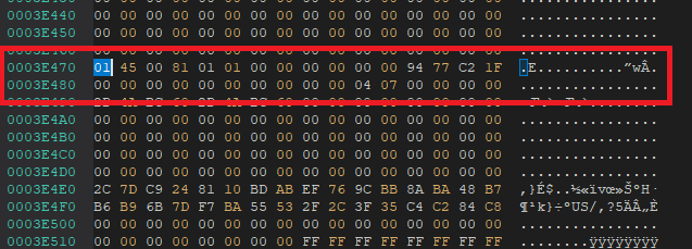

                      #190
                      Click image for larger version  Name:	image.png Views:	0 Size:	2.2 KB ID:	3775528
                      checksum here ??
Name:	Nouveau Image bitmap (10).png

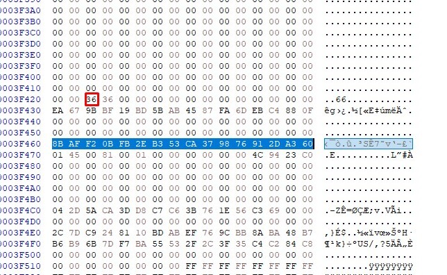

                      • Stefan Steff
                        • Mar 2024
                        • 421
                        • Romania
                        #191
                        Click image for larger version  Name:	image.png Views:	6 Size:	2.2 KB ID:	3775528
                        checksum here ??
                        Yes ...indeed...I missed that thanks Maxpower3
                        gerlach attached the re-corrected dump.
                        If this will work all credits go to Maxpower3

                                  #196
                                  look and compare lines with https://www.badcaps.net/forum/troubl...11#post3749311
                                  gerlach try this version
                                  edit try test 2 too .
                                  i made mistake
                                  I just spotted right before you updated your post ...7 hits
                                  Click image for larger version  Name:	CRC_Line.jpg Views:	0 Size:	134.9 KB ID:	3775570

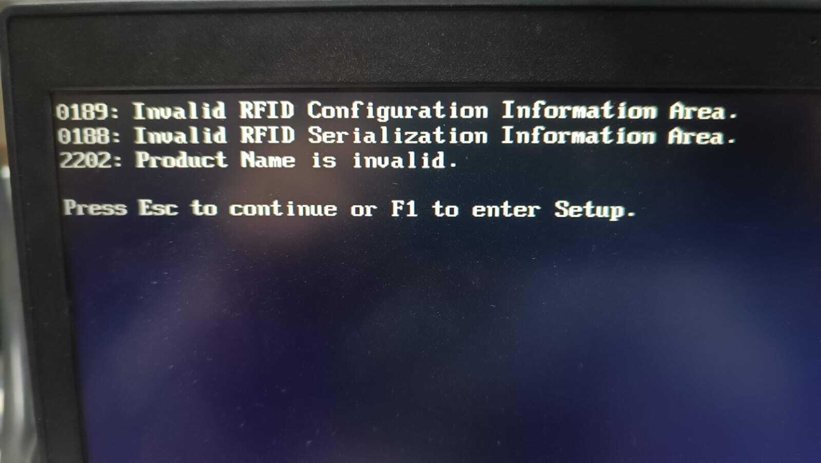

                                    #197
                                    I have updated to version ...test4 in the same post ...try that version.
                                    Thanks!
                                    That's linked to RFID.
                                    We recognize it because it's xx xx xx xx xx xx 00 00 00 00 00 00 xx xx xx xx
                                    ​Earlier I said error 2204 but it's 0188 and 0189​

                                      #198
                                      Click image for larger version  Name:	image.png Views:	0 Size:	602.3 KB ID:	3775572
                                      Click image for larger version  Name:	image.png Views:	0 Size:	2.0 KB ID:	3775573
                                      Now this is an info I should and will remember...I got 2 hits...
                                      Thank You !
