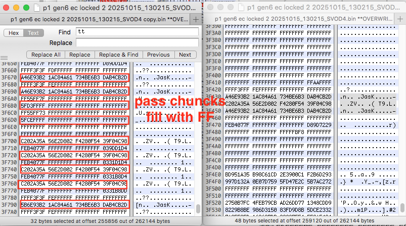

    Originally posted by osman68i
    Hi .
    I have compared the files but unfortunately no succes
    NEED DECODE TO FIND THE ORIGINAL FILE

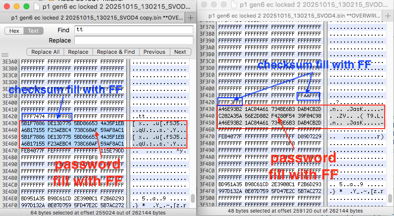

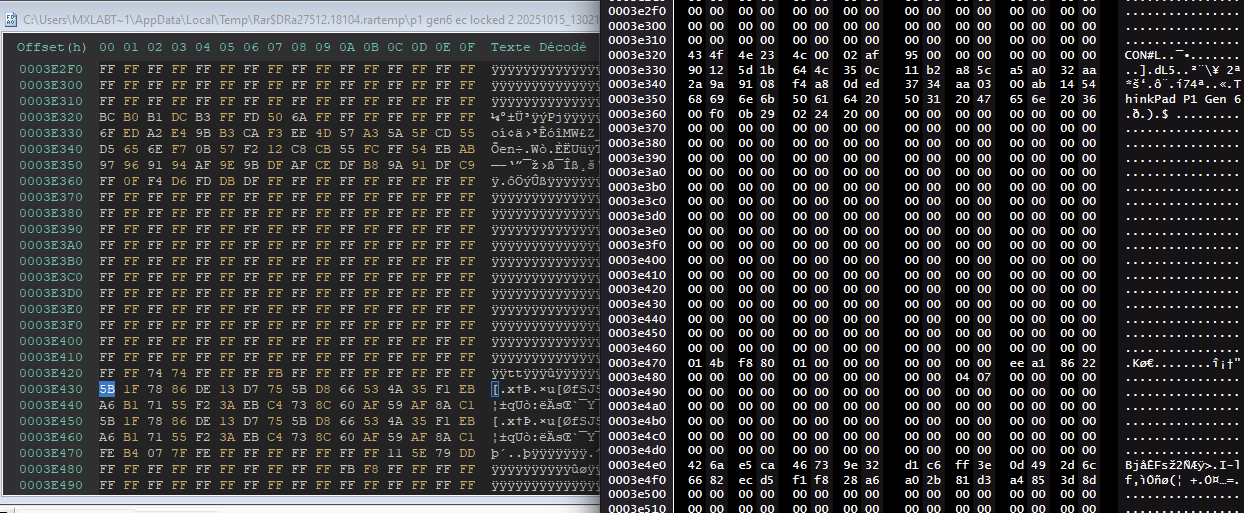

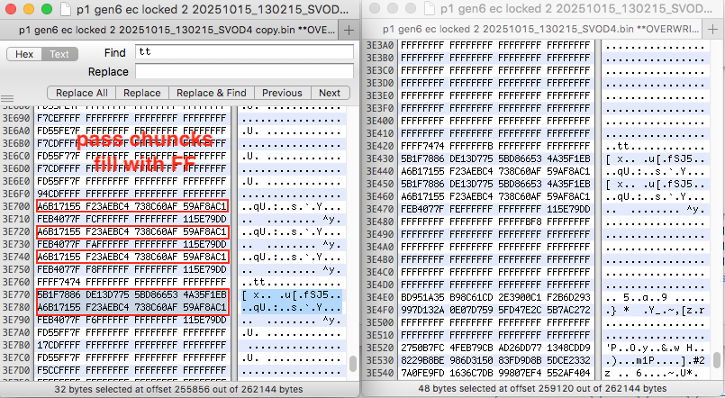

      #162
      Hi .
      help me with remove password
      last time Volinakis helped me
      P1 Gen 6
      sn: PW0A7G23
      try to do it yourself. There are 30-40 places you have to modify, look at photos.
Name:	Screen Shot 2025-10-15 at 15.28.19.png
Name:	Screen Shot 2025-10-15 at 15.29.25.png
Name:	Screen Shot 2025-10-15 at 15.38.08.png
      • osman68i
        • May 2015
        • 350
        • The Netherlands
        #163
        thank you very much Maxpower3 and volinakis
        password has been deleted thanks to you
