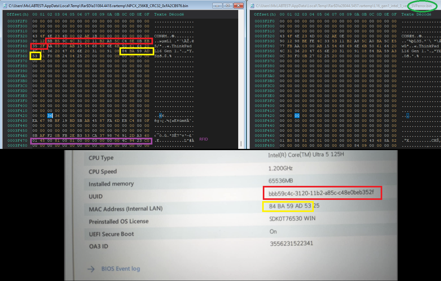

      Originally posted by gerlach
      Thanks a lot. It works. The BIOS has been unlocked. I just need to add the SN and other data and the procedure is done. Thank you to everyone involved.
      try it restore the original serial number with my second-to-last file.(test2)
      https://www.badcaps.net/forum/troubl...55#post3775555
      The current file comes from an L14 Gen3.
      MAC address, UUID, RFID numbers, etc... different, not good
      You also probably lost your Windows license with NVRAM cleanup.
      I sent it to you in a message.
      Glad it worked
          All I had to do was upload the batch file with my EC, the one I provided in post #180, and all the data was there. There are no more errors. Thanks again.
          Except these aren't your original numbers.
          The file has been completely modified.
          Don't trust software that does everything automatically.
          The finishing touch is always better done by hand.

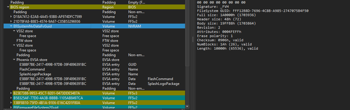

                    Originally posted by keczuk
                    This solution also make TPM in MFG mode so you can't use TPM encrytion on drive.
                    Any solution where to find TPM section in this section, because there is WinKey, TPM and other bios settings.
                        Move all nvram is not solution. I need only move TPM info from nvram section.
                        Look in the padding, there's TPM and TCG info there
                          • 22408
                          #232

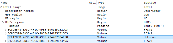

                          Look for PK ,KEK ,db ,dbx in NVRAM. Some are timestamped. Just an observation, need to do some more research into it.
