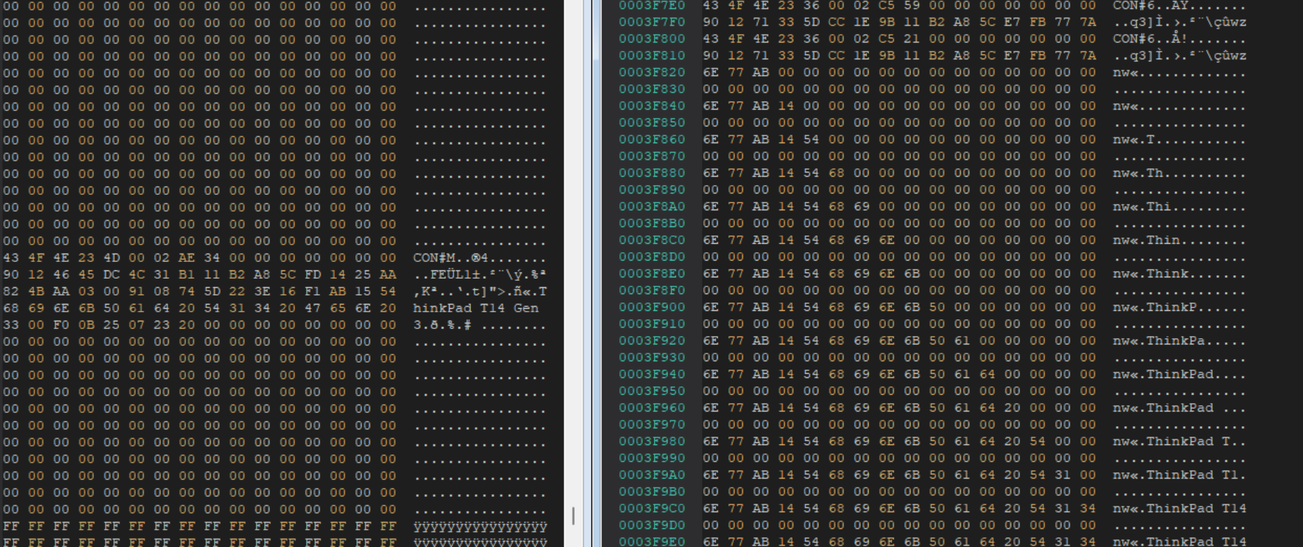

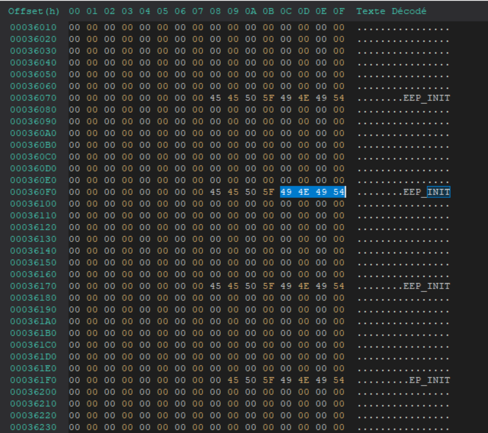

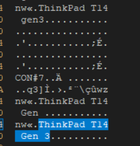

                  #48
                  Originally posted by ArtHunting
                  this dump without svp and after golden key
                  It's interesting to see the shifts.
                  Click image for larger version  Name:	image.png Views:	0 Size:	654.2 KB ID:	3580971
                  But your file no longer looks at all like the original.
                  I don't understand why either, I marked ThinkPad T14 gen3 and ThinkPad T14 Gen 3,
                  it's not the same!
                  Click image for larger version  Name:	image.png Views:	0 Size:	30.4 KB ID:	3580972
                  you had no error.
                  spelling in plnsrv.ini
                  Click image for larger version  Name:	image.png Views:	0 Size:	1.9 KB ID:	3580973
                  I would have needed a dump after initializing the eprom with golden key without number.
                  full init
                  Click image for larger version  Name:	image.png Views:	0 Size:	308.3 KB ID:	3580975

                    About ThinkPad T14 gen3 and ThinkPad T14 Gen 3, this is my faill. When i wrote with golden key first time Model Type make mistake, then I rewrote the value correctly. I'm sorry, but the laptops have already been given to the client, so I can't read the dumps.

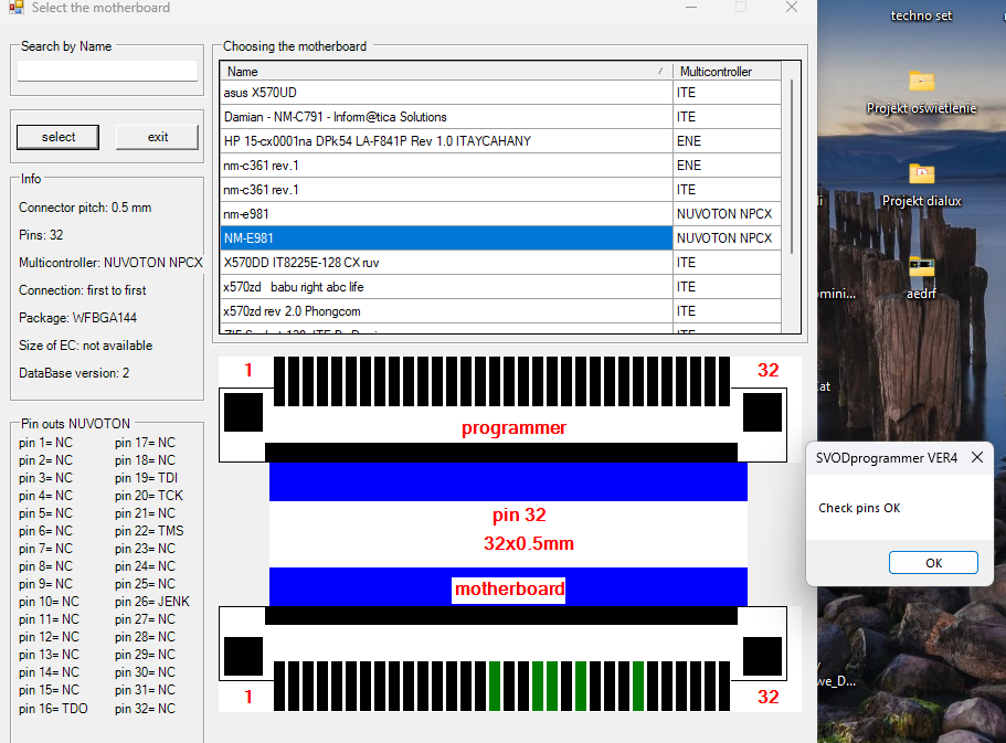

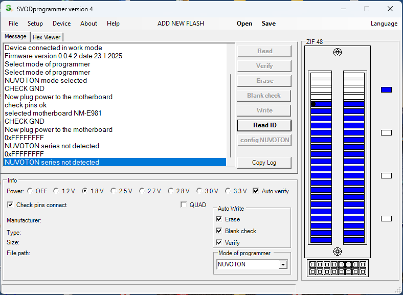

                      #50
                      Nm-e981 rev.1
                      no detect
                      please help me
                      • volinakis
                        • Jan 2021
                        • 2887
                        • N/A
                        #51
                        Originally posted by victrix1
                        Nm-e981 rev.1
                        no detect
                        please help me
                        don't choose any motherboard, just select "Novuton" in mode of programmer.
                        • victrix1
                          • Apr 2020
                          • 6
                          • Poland
                          #52
                          It's works, thank you.
                          Please remove bios password​
