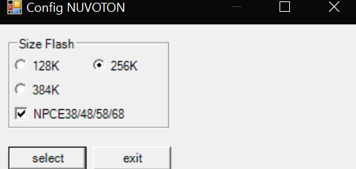

                                            yoga x390 (x13 to confirme )nuvoton npce288/388 sv password removal guide with svod4
                                            by couillu76
                                            before you start the procedure read the bios eeprom and save it you might need it at the end
                                            1do not power on your svod yet
                                            2plug you ribbon 30x0.5 to the left of the keyboard connector
                                            3test pin with testeur if it beep go to next stage
                                            4 open svod software select 1.8v
                                            5 now plug your svod
                                            6 select nuvoton
                                            7 plug charger on the board/laptop
                                            8 press read id
                                            9 select 256k
                                            10 read nuvoton
                                            11 save reading, now unplug the svod
                                            12 open HxD software and open your 256k file the one you just saved
                                            13look...
                                            03-26-2023, 06:19 AM

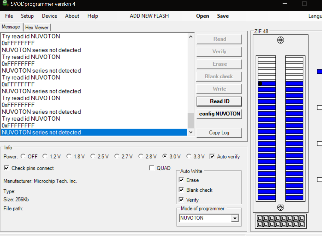

                                            Read EC NPCX997 Lenovo T14 Gen 4
                                            by vanminhscdt@gmail.com
                                            I can't read EC Npcx997, device not found
                                            Can anyone help me?
                                            Where did I go wrong or what else am I missing to read it?​
                                            Lenovo T14 Gen 4
                                            S/N :PF4YA55W
                                            M/B : NM-F261 RE 1.0
                                            Thank...
