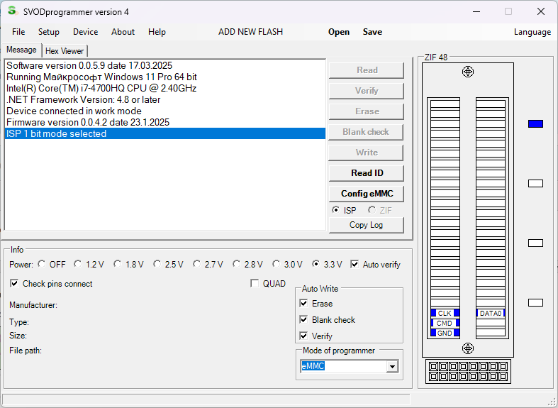

Hello, is svod 4 able to read emmc? Do I need a special board or is it enough to solder into the pinout and insert the other side of the cables into the programmer? somehow especially set the svod?
Svod 4 reading emmc
Hi, same question here - there is a dedicated mode in the SVOD4 app and the pinout is also quite simple (as you can see on the attached screenshot), but I wasn't able to find a proper adapter board for this programmer.
The only SVOD adapter I found is compatible only with SVOD3. I'am sure there must be some other option, but I'am only discovering chip programming world, so maybe someone else will be able to help us get this sorted
I asked someone who knows the creator of SVOD and he says that there has been an eMMC adapter for SVOD4 in the plans but since quite a few SVOD3 units are still not sold - he postponed that project and as of now it is only possible to directly connect to an eMMC chip and program it that way with SVOD4. Hope that at some point those compatible adapters will be released though.Comment
