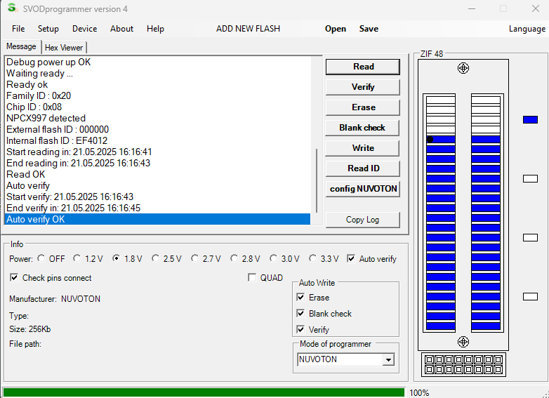

        Hello again everyone! I wanted to thank everyone for their help. I was able to successfully erase the SVP from my laptop and change the settings to allow me to boot into Linux. I really appreciate the time/effort/experience that goes into helping newbies like myself.
        Everything works as expected, so it is not critical, but I get a message about "invalid RFID serialization area" which tells me there is something slightly off with the binary I flashed. I will post the original and modified binaries later if anyone cares to look.

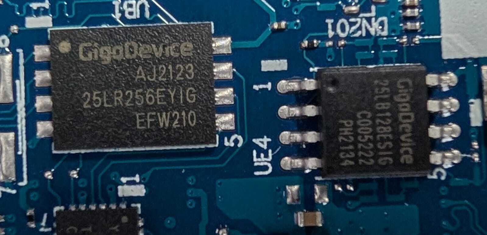

          Hello arestlessknight,
          It would be great if you could give us some information and the binaries. I have the exact same laptop:
          Model: Lenovo ThinkPad T14 Gen3 AMD
          Type: 21CG-S1D600
          Serial No.: PF-4AFKP5
          Mainboard Type: NM-E441 Rev: 1.0
          BIOS Chip 1?: 25LR256EYIG
          BIOS Chip 2?: 25LB128ESIG
          Chip: GigaDevice
          Do you also have both installed BIOS chips? Or which of the two is the correct one? See image.

            a BIG BIG Thanks to the SVOD team who activated my tool.
            I now notice a new box in the software and now reading is done perfectly

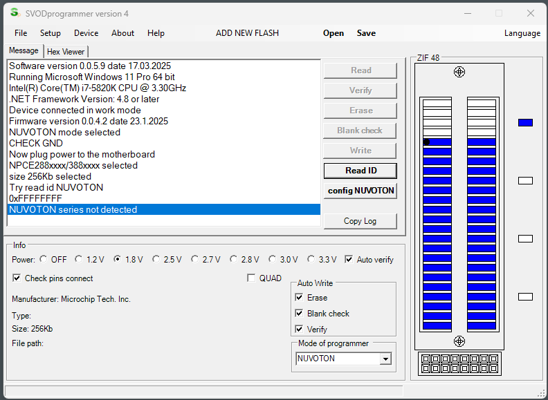

                    #69
                    Thank you Kodza.
                    OK, it doesn't work for me even with version 0.0.5.5.
                    According to SVOD support, software 0.0.5.9 should work with NPCX997K without any problems.
                    Maybe I need to connect the programmer directly to the chip and not via the keyboard input.
                    I hope someone can help us here.

                        #71
                        Originally posted by james-b0nd
                        Thank you Kodza.
                        it should work, few days ago I unlocked a T14 gen3 AMD. I think I have an older software version from March, I didn't update it to last version but I will try also with new version. Set voltage (power) to 1.8V, sometimes it helps even NPC isn't powered by SVOD4. I also let the CMOS battery plugged in so the motherboard doesn't start up. Oh, one last thing: I always remove motherboard from chassis or remove all connectors entering in motherboard.

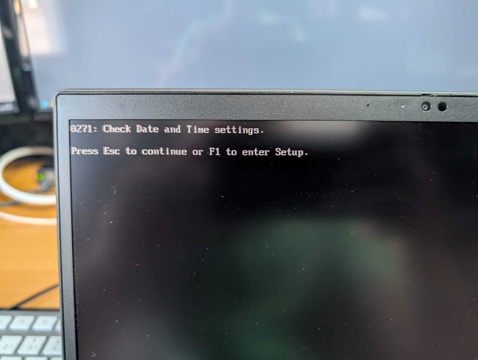

                              Great, thanks for all the tips. Reading the bin file worked. Can someone tell me how to proceed?
                              • volinakis
                                • Jan 2021
                                • 2887
                                • N/A

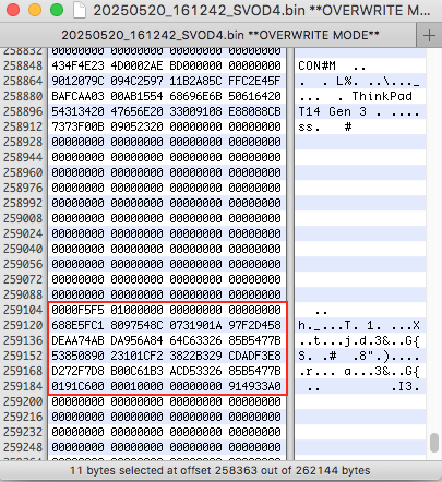

                                #75

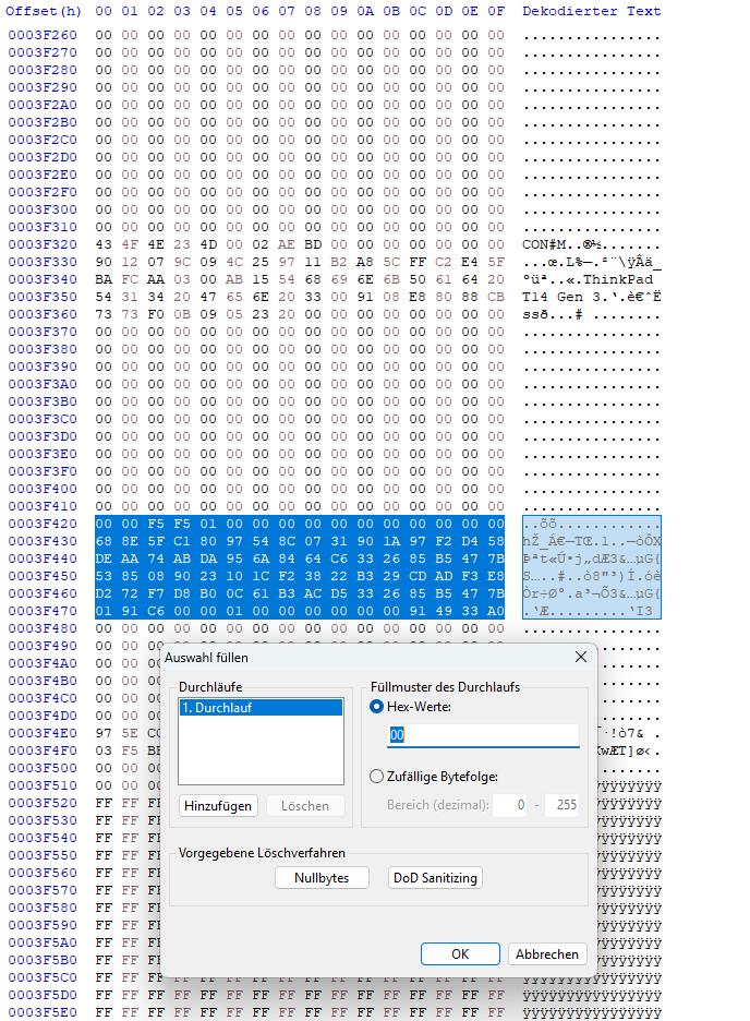

                                fill with 00 Click image for larger version
Name:	Screen Shot 2025-05-20 at 20.39.07.png
                                • james-b0nd
                                  • Mar 2025
                                  • 20
                                  • Deutschland

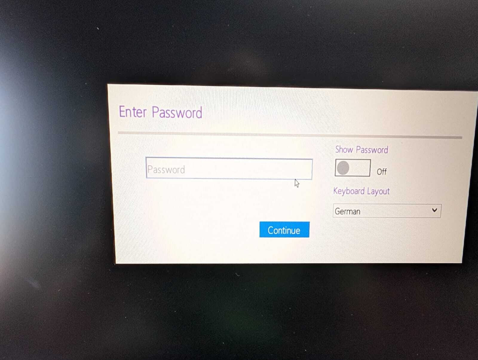

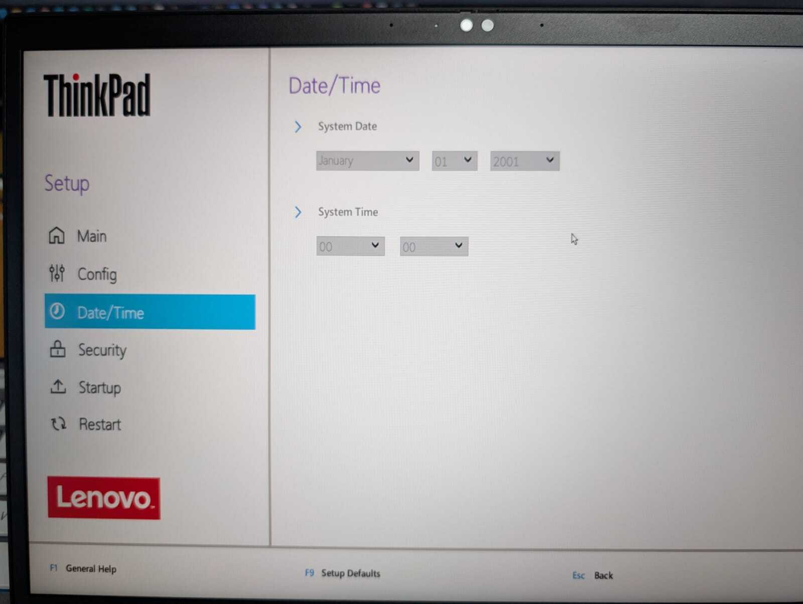

                                  #76
                                  Thank you so much, Volinakis.

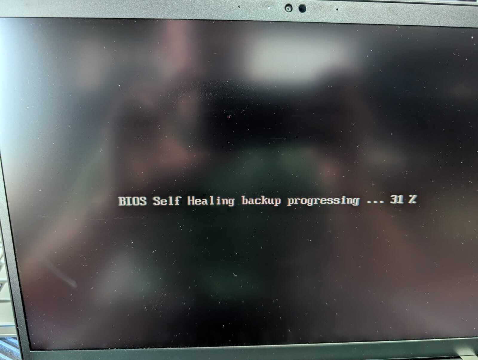

                                  - I filled in the area with 00.
                                  - Then I wrote it back to the chip.
                                  - When I restarted, the ThinkPad created a self-healing backup.
                                  - F1 > Supervisor Password Blank
                                  - I can now access the BIOS, but I can't make any changes.
                                  What do I have to do now?​

                                      extract Ec from update, is the .fl2 file or ask help from Maxpower3. I filled that area with 00 and it worked for me.

                                        #79
                                        Hello volinakis, could you describe in more detail what I should do? Where can I get the .fl2 file? Sorry, this is my first time.

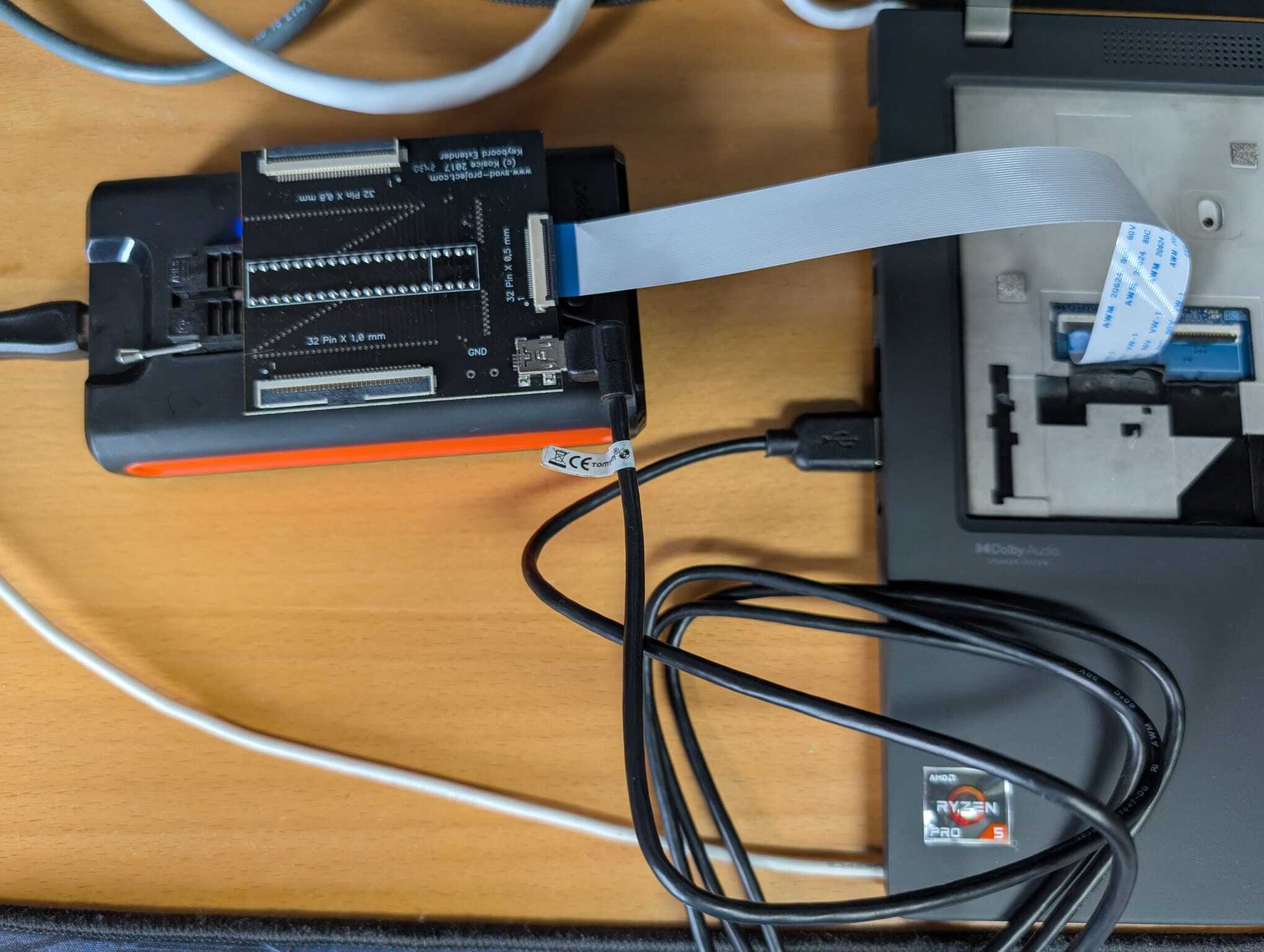

                                          1. Remove the battery
                                          2. Remove the CMOS battery
                                          3. Connect the ribbon cable EXACTLY to pin 1 on the left (see photo)
                                          Click image for larger version  Name:	Pins.jpg Views:	0 Size:	118.9 KB ID:	3642180
                                          4. Connect the SVOD4 USB GND cable to the laptop
                                          Click image for larger version  Name:	Connect.jpg Views:	0 Size:	165.1 KB ID:	3642182
                                          5. Start the SVOD Pragrammer v4
                                          6. Select the programmer mode (NUVOTON)
                                          7. Select 1.8 V
                                          8. Select config NUVOTON (256K and NPCE38/48/58/68)
                                          9. Connect the power supply to the laptop
                                          10. Read the ID
                                          11. Read
                                          12. Save the .bin file
                                          Click image for larger version  Name:	SVOD.png Views:	0 Size:	44.1 KB ID:	3642179
                                          13. Open the file with a HEX editor
                                          Click image for larger version  Name:	HEX1.png Views:	0 Size:	119.2 KB ID:	3642181
                                          14. Fill the displayed area with 00
                                          Click image for larger version  Name:	HEX2.png Views:	0 Size:	16.8 KB ID:	3642178
                                          15. Save
                                          16. Then use SVOD4 (Write)
                                          17. Reinstall everything: battery, CMOS battery, and keyboard
                                          18. Start the laptop. Sometimes you have to try 2-3 times.
                                          19. Then it should start.
                                          20. When I restarted, my ThinkPad created a self-healing backup.
                                          21. Then you'll see a message asking you to enter your supervisor password. Just leave it blank and click Continue.
                                          22. Then you'll enter the BIOS.
                                          That was my approach. Unfortunately, I can't get any further here because I can't make any changes in the BIOS.
                                          @volinakis
                                          23. Extract Ec from the update, which is the .fl2 file. Then fill the area with 00.
                                          Unfortunately, I don't fully understand step 23. Perhaps you can explain it in more detail. Thank you in advance.
                                          Perhaps this guide will help someone who's just starting out.
