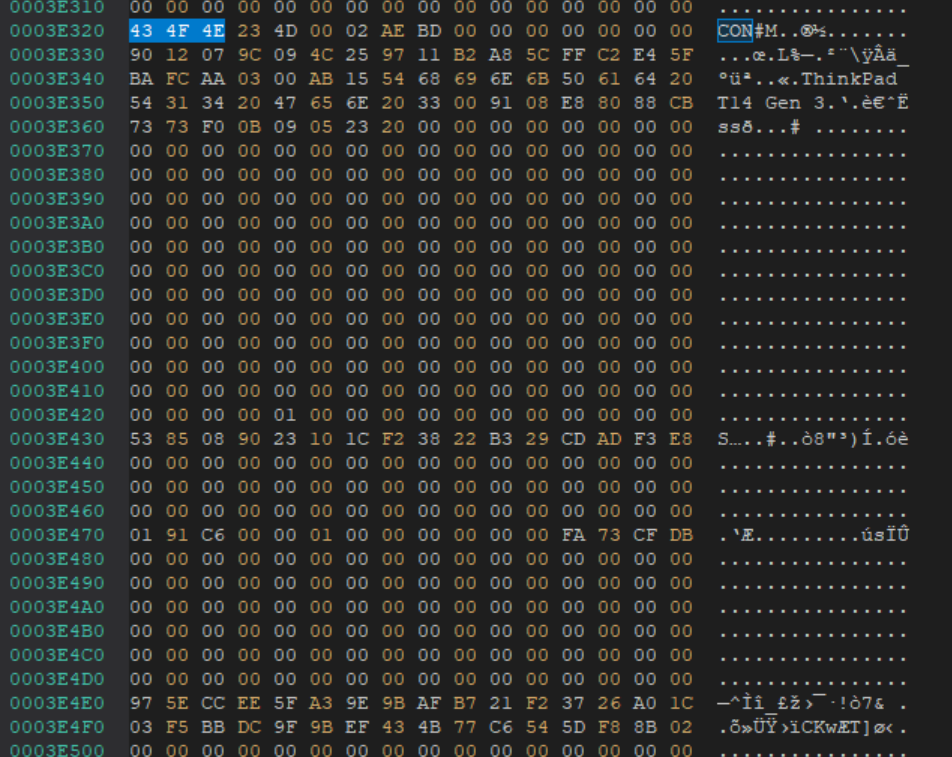

    Click image for larger version Name:	HEX1.png Views:	0 Size:	119.2 KB ID:	3642181
    14. Fill the displayed area with 00
    Click image for larger version Name:	HEX2.png Views:	0 Size:	16.8 KB ID:	3642178
    clean 3e420 too
    ​ Click image for larger version
    try but not working because many repetitions

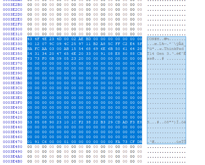

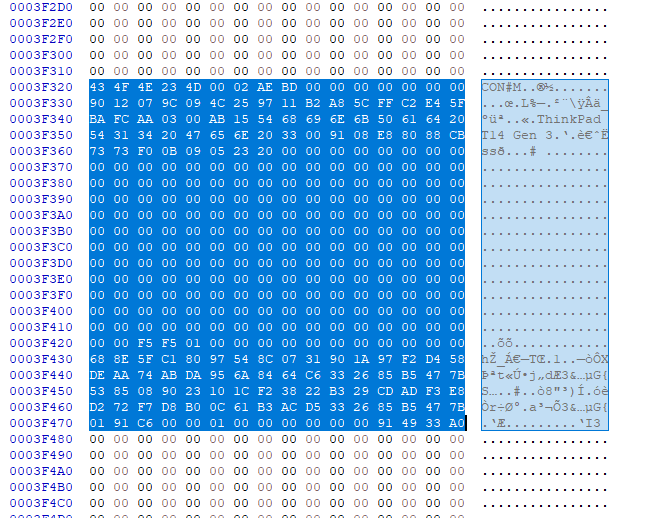

      #82

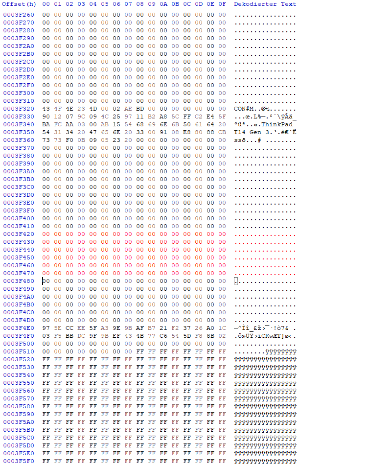

      I'd like to send you my original .bin file. Could you edit it completely for me?
      We have two layers here:
      3e320 and 3f320 (see images)
      I've already scoured the internet with the help of AI
      And there are many different methods for what needs to be zeroed out.​
ID:	3642336 Click image for larger version

            #85
            clean 3e420 too
            Click image for larger version  Name:	image.png Views:	47 Size:	321.3 KB ID:	3642310
            As soon as I reset the three numbers in the 3e420 line to zero, the supervisor password is activated again and I can't access the BIOS.
            What exactly did you do to make it work for you?​

              #86
              try

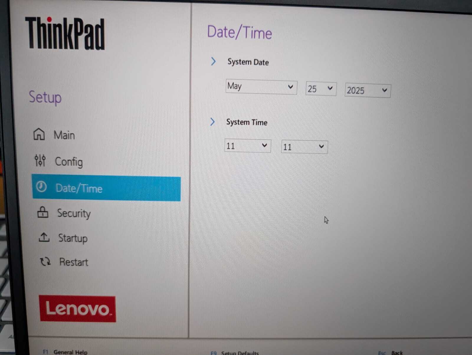

              • james-b0nd
                • Mar 2025
                • 20
                • Deutschland

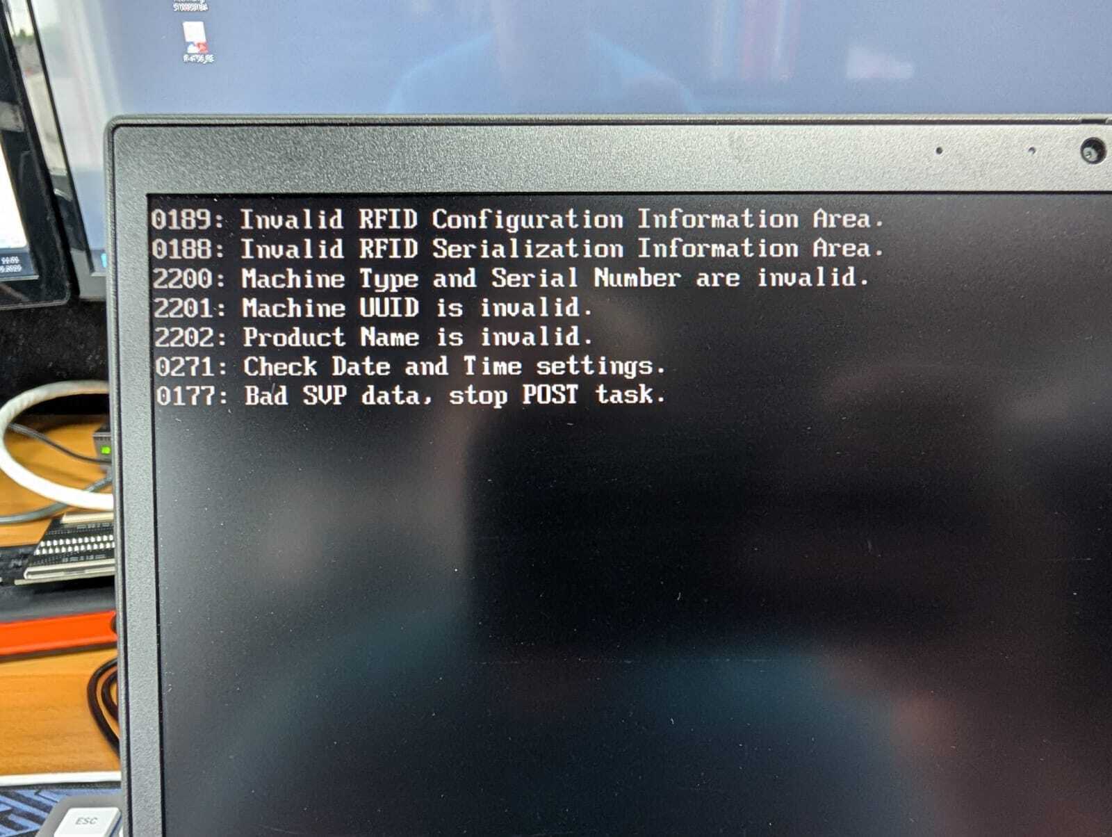

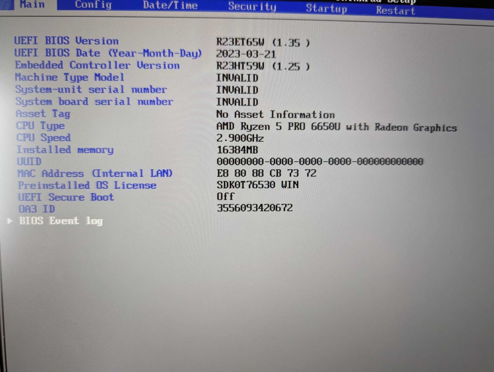

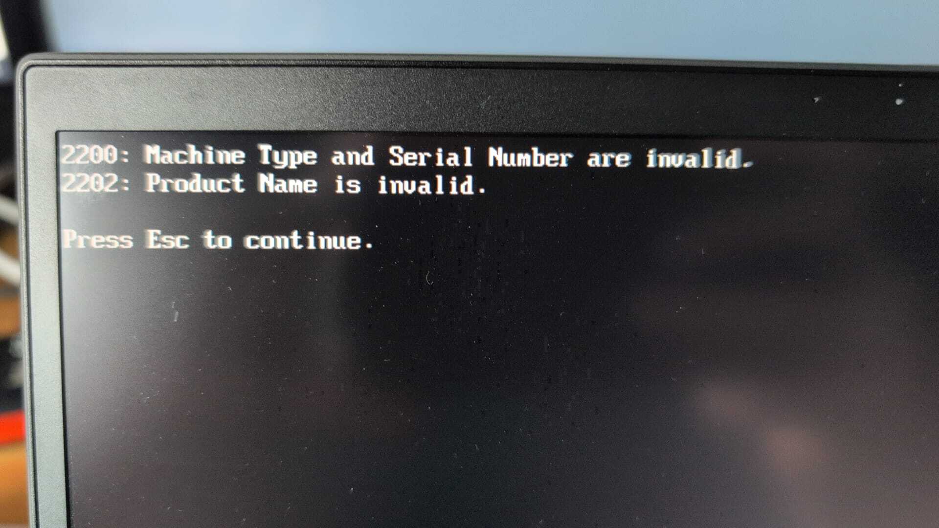

                #87
                GREAT! Thanks Maxpower3.
                Now I can edit all the data in the BIOS.
                I still get the following messages at startup:​
ID:	3644885 Click image for larger version
ID:	3644884 Click image for larger version

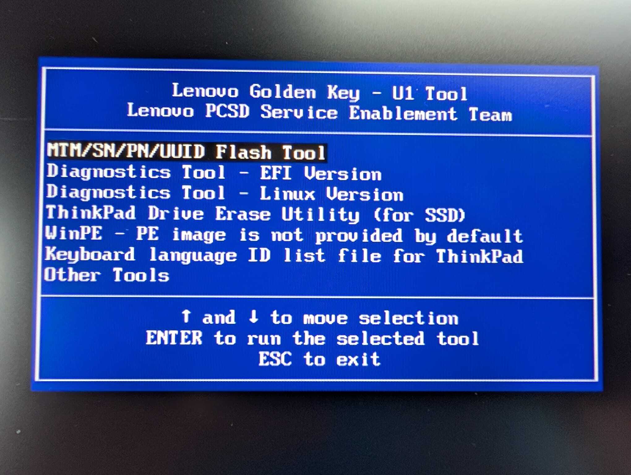

                • Maxpower3
                  Bad Veteran
                  • Feb 2018
                  • 1393
                  • France
                  #88

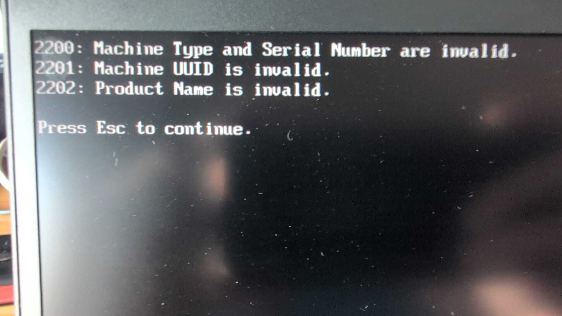

                  Click image for larger version  Name:	Messages.jpg Views:	0 Size:	137.1 KB ID:	3644885 Click image for larger version  Name:	BIOS-MainPage.jpg Views:	0 Size:	131.7 KB ID:	3644884 Click image for larger version  Name:	data.jpg Views:	0 Size:	88.2 KB ID:	3644883
                  use lenovo golden key for clean dump and restore your number after

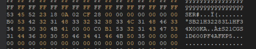

                        #91
                        OK, I'll read through the thread today and do it later and report back.
                        B0 (8) SB21H32283L1HF34X00KA
                        C0 (1) S21CGS1D600PF4AFKP5
                        Model type ThinkPad T14 Gen 3​

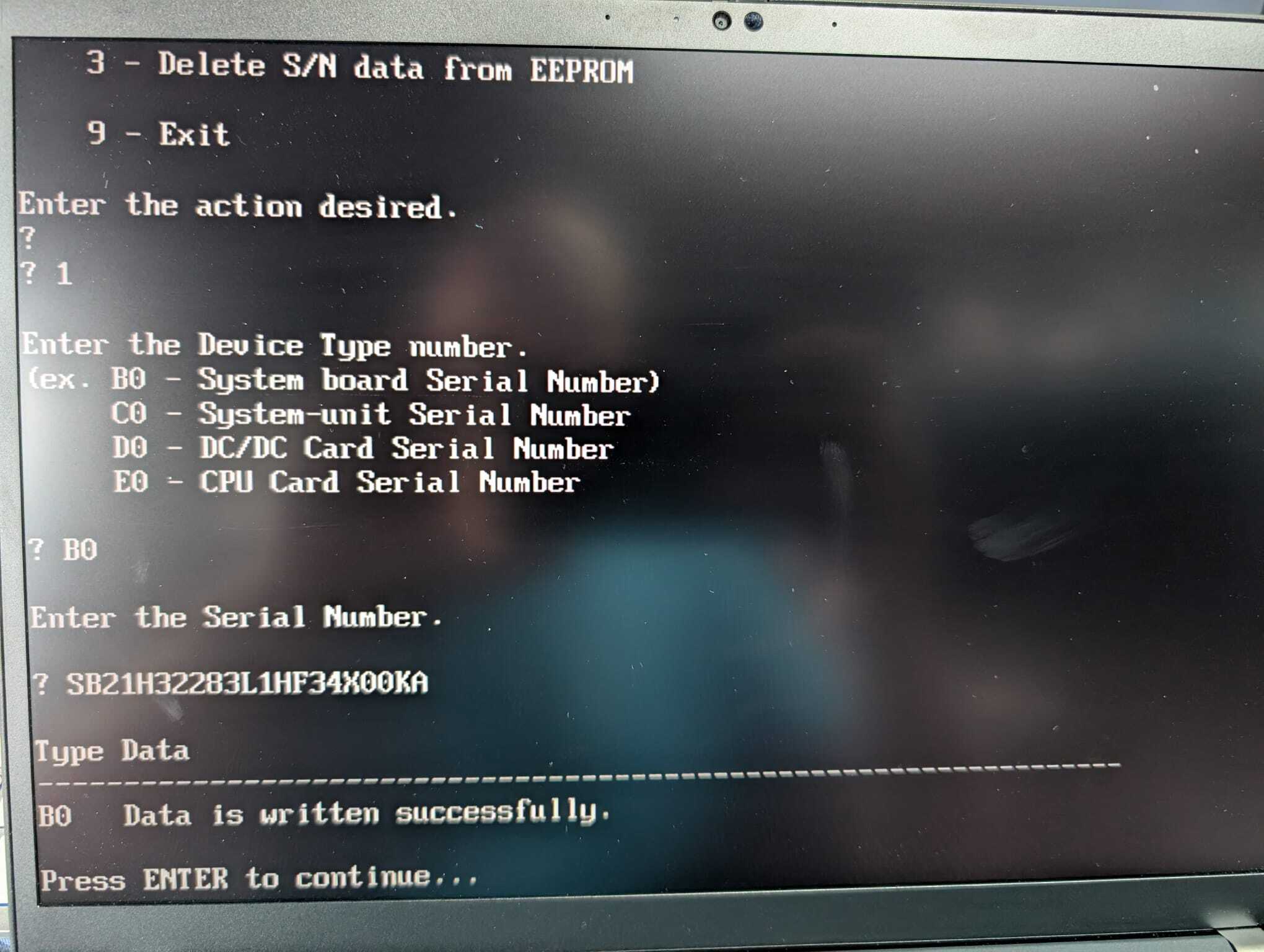

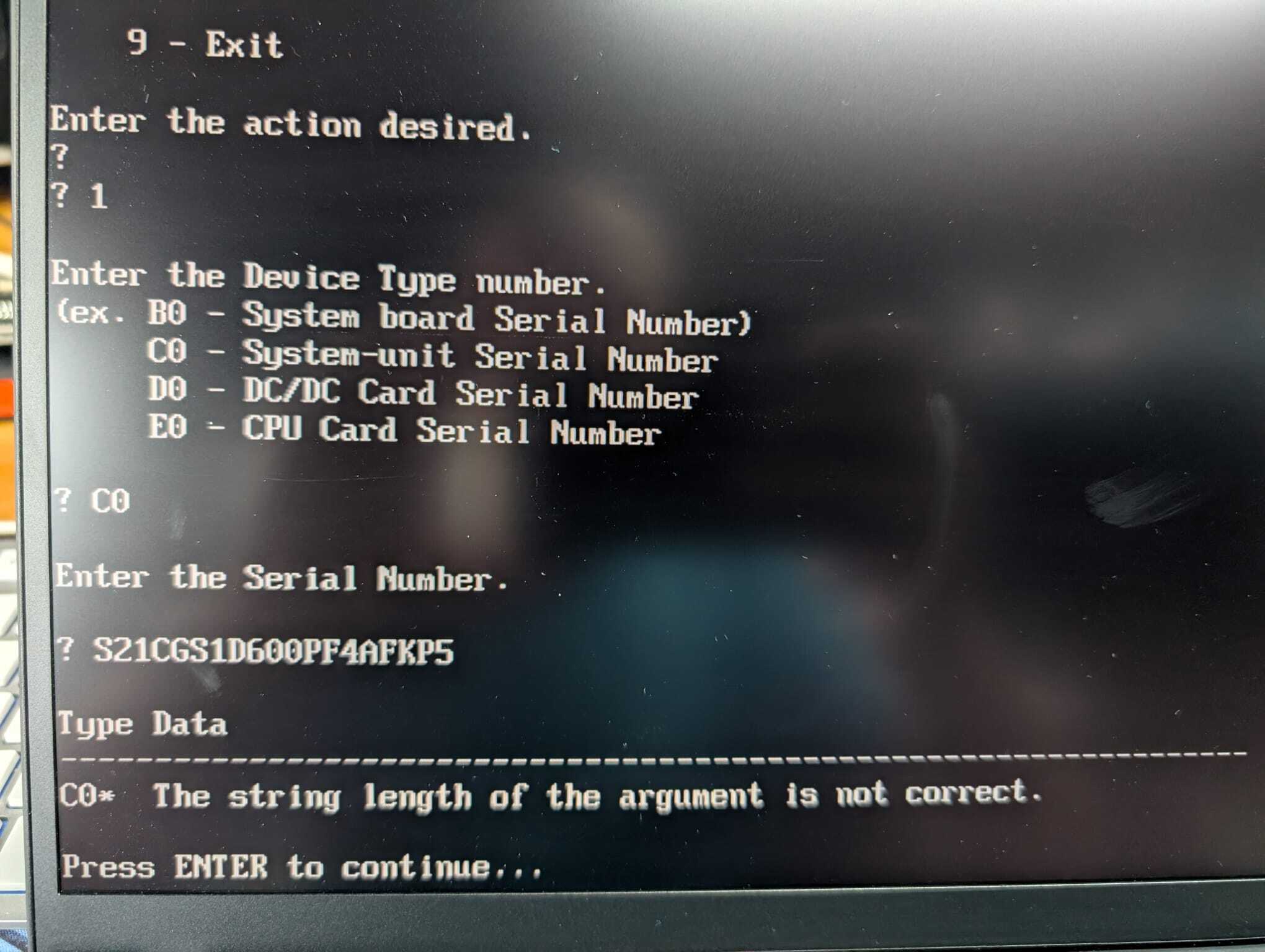

                        • james-b0nd
                          • Mar 2025
                          • 20
                          • Deutschland
                          #92

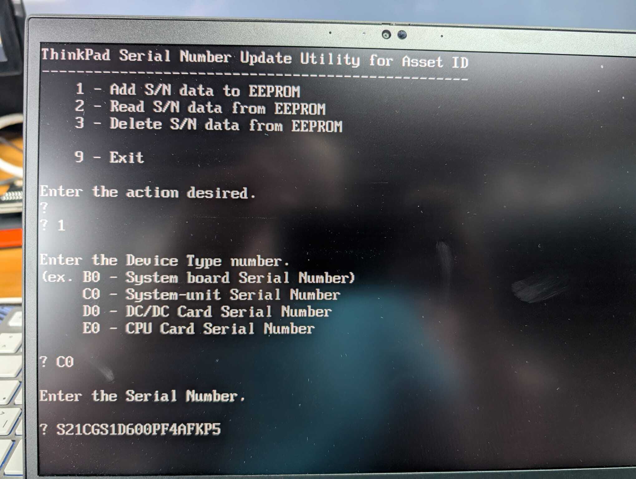

                          I can't get any further here
                          Click image for larger version  Name:	failed.png Views:	0 Size:	34.2 KB ID:	3644902
                          OK, just ignore step 2 and then click on "Update" and it will work.

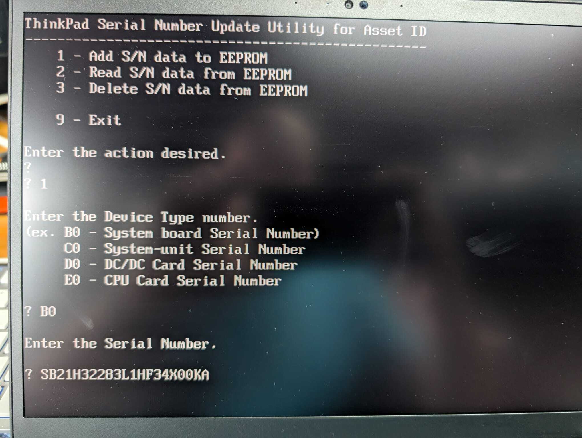

                          • james-b0nd
                            • Mar 2025
                            • 20
                            • Deutschland

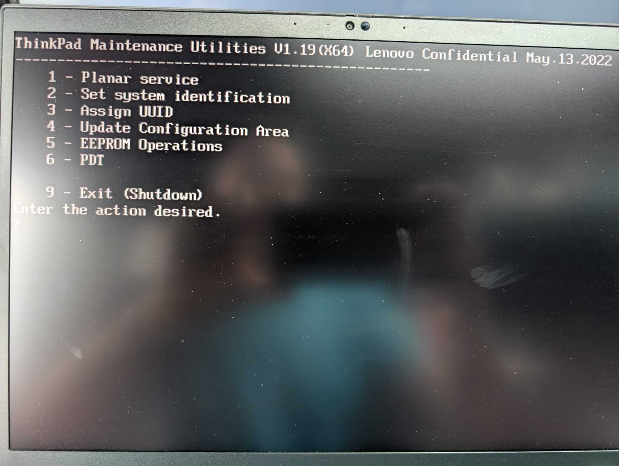

                            #93
                            OK, here's what I did.
ID:	3644934 Click image for larger version
ID:	3644933 Click image for larger version
ID:	3644932 Click image for larger version
ID:	3644931 Click image for larger version
ID:	3644930 Click image for larger version
ID:	3644929 Click image for larger version
ID:	3644928 Click image for larger version
                            ​​​​​​​I can't set the "C0"
                            • Maxpower3
                              Bad Veteran
                              • Feb 2018
                              • 1393
                              • France
                              #94
                              Click image for larger version  Name:	A (2).jpg Views:	0 Size:	215.1 KB ID:	3644934 Click image for larger version  Name:	A (3).jpg Views:	0 Size:	178.1 KB ID:	3644933 Click image for larger version  Name:	A (4).jpg Views:	0 Size:	193.2 KB ID:	3644932 Click image for larger version  Name:	A (5).jpg Views:	0 Size:	144.8 KB ID:	3644931 Click image for larger version  Name:	A (6).jpg Views:	0 Size:	157.6 KB ID:	3644930 Click image for larger version  Name:	A (8).jpg Views:	0 Size:	166.2 KB ID:	3644929 Click image for larger version  Name:	A (7).jpg Views:	0 Size:	156.7 KB ID:	3644928 Click image for larger version  Name:	A (9).jpg Views:	0 Size:	150.1 KB ID:	3644927
                              C0 1S21CGS1D600PF4AFKP5
                              Click image for larger version  Name:	image.png Views:	0 Size:	75.3 KB ID:	3644946
                              And B0 must start with 8S I believe. I marked in parentheses
                              Did you clean the dump before rewriting the numbers?
                              It's better to start with a clean dump.
                              Otherwise you risk having errors.
                              Use the eeprom operations function.(5)
                              • james-b0nd
                                • Mar 2025
                                • 20
                                • Deutschland
                                #95
                                That worked

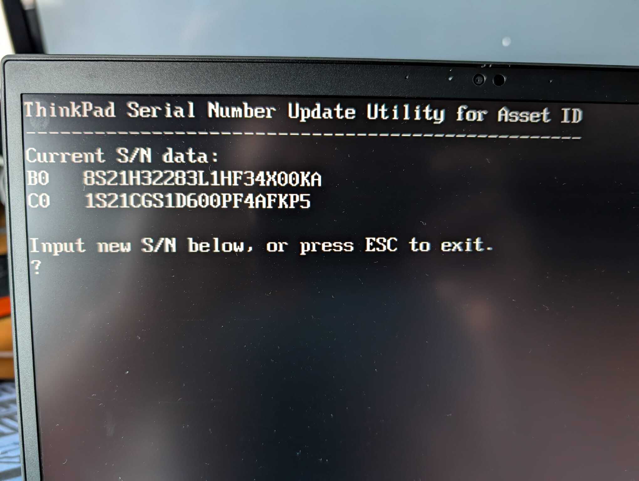

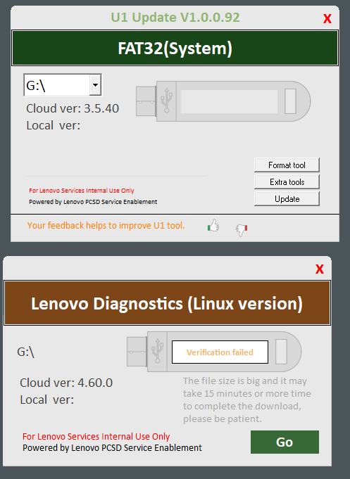

                                  #96
                                  He writes that he wrote the SN, but unfortunately, it wasn't written. What is the reason for this?
ID:	3645134 Click image for larger version
                                  • Maxpower3
                                    Bad Veteran
                                    • Feb 2018
                                    • 1393
                                    • France
                                    #97

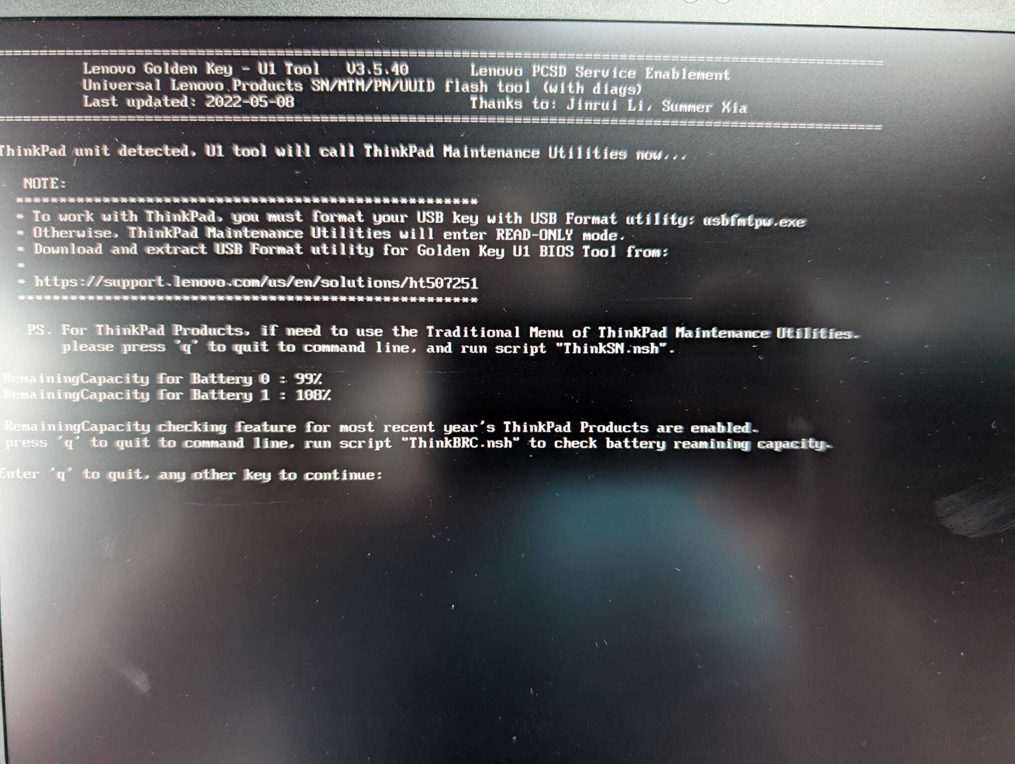

                                    Click image for larger version  Name:	2.jpg Views:	0 Size:	82.0 KB ID:	3645134 Click image for larger version  Name:	1.jpg Views:	0 Size:	238.5 KB ID:	3645135
                                    try with planar service
                                    what version of U1 (3.5.40)??
                                    try maybe last update

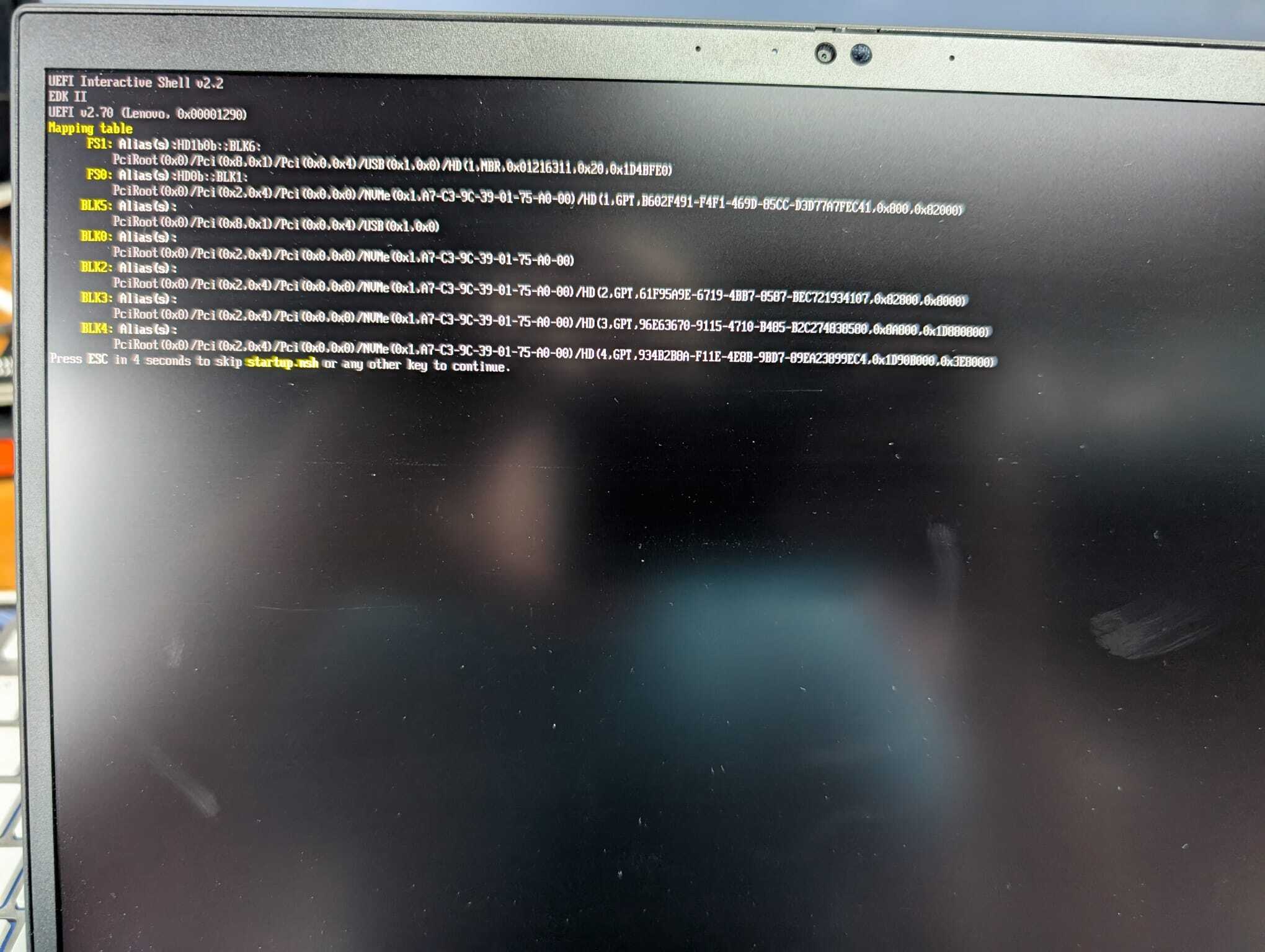

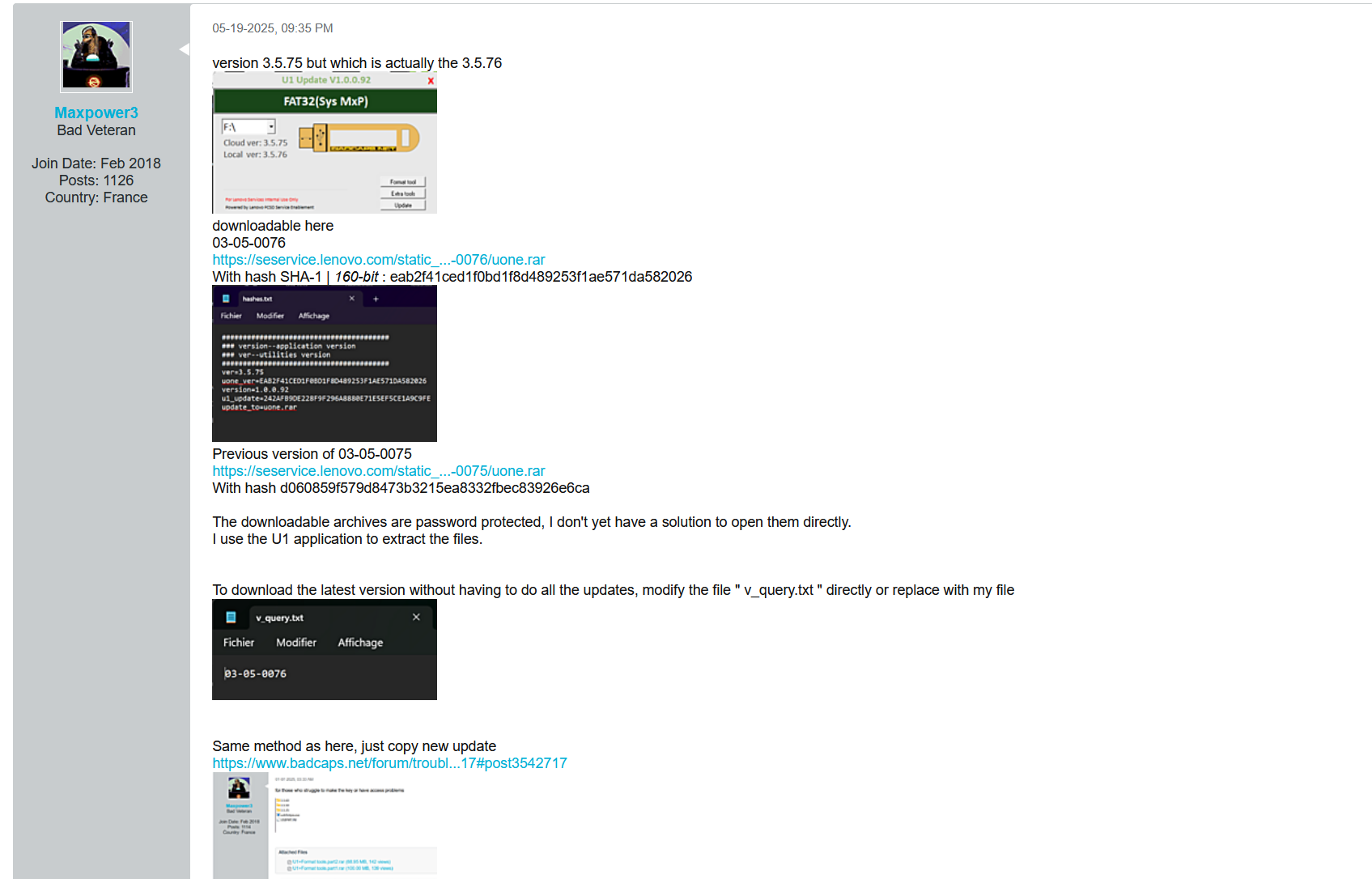

                                    • james-b0nd
                                      • Mar 2025
                                      • 20
                                      • Deutschland
                                      #98

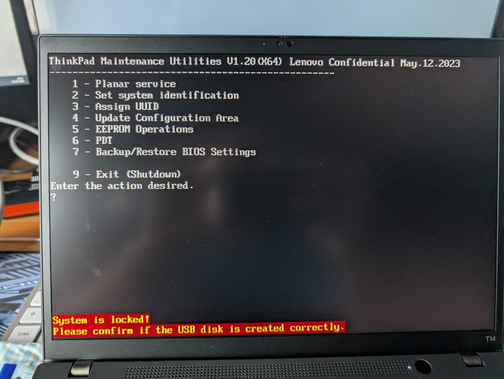

                                      I've now tried 3.5.75, and it shows me that the system is locked.
                                      At least I've gotten a few fewer error messages.​
ID:	3645224 Click image for larger version
Name:	2 errors.jpg
                                      • Maxpower3
                                        Bad Veteran
                                        • Feb 2018
                                        • 1393
                                        • France
                                        #99
                                        Click image for larger version  Name:	locked.jpg Views:	0 Size:	137.0 KB ID:	3645224 Click image for larger version  Name:	2 errors.jpg Views:	0 Size:	119.5 KB ID:	3645223
                                        USB key incorrectly formatted, use the usbmtpw utility and put files in the key after​.

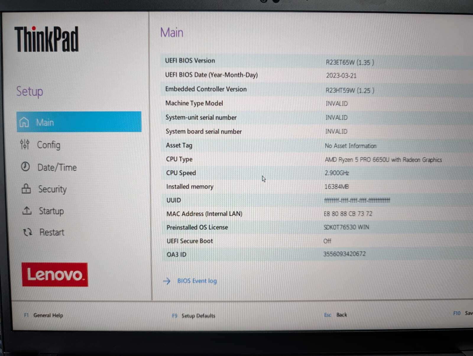

                                          #100
                                          Everything worked now!
                                          All error messages are gone.
                                          GREAT, thanks Maxpower3 😁
