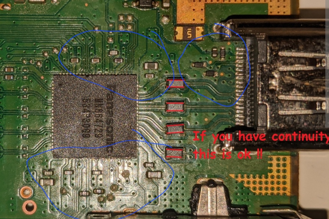

              Re: ps4 1215 model Changed port and encoder still no video?
              Check the resistance between the HDMI pins and encoder pins going through the filters.
                they are good all have contiuity , if the hdmi readings are good doesnt that mean the lines from the hdmi port to the encoder are good ?
