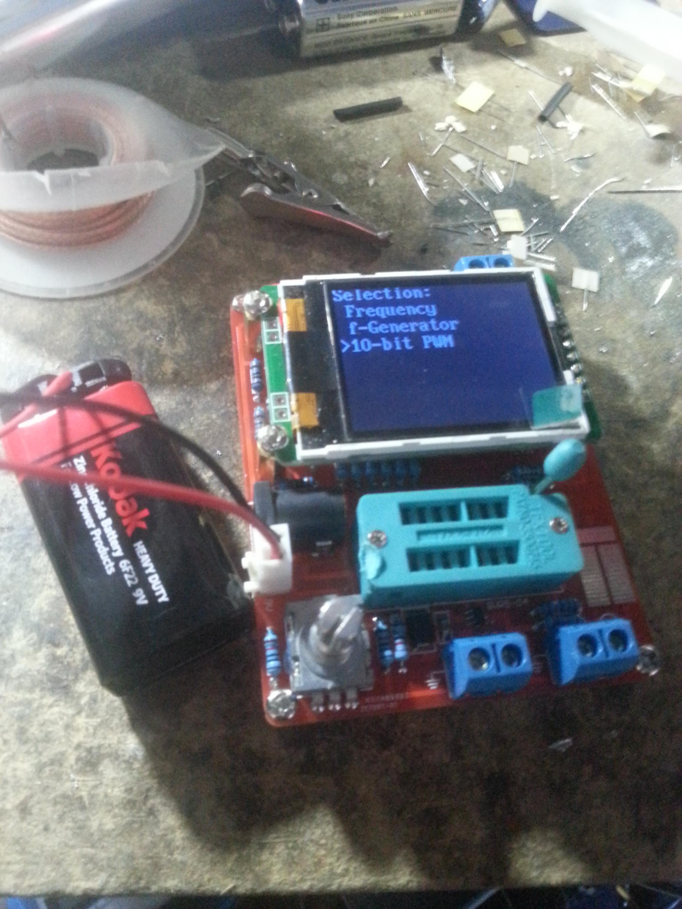

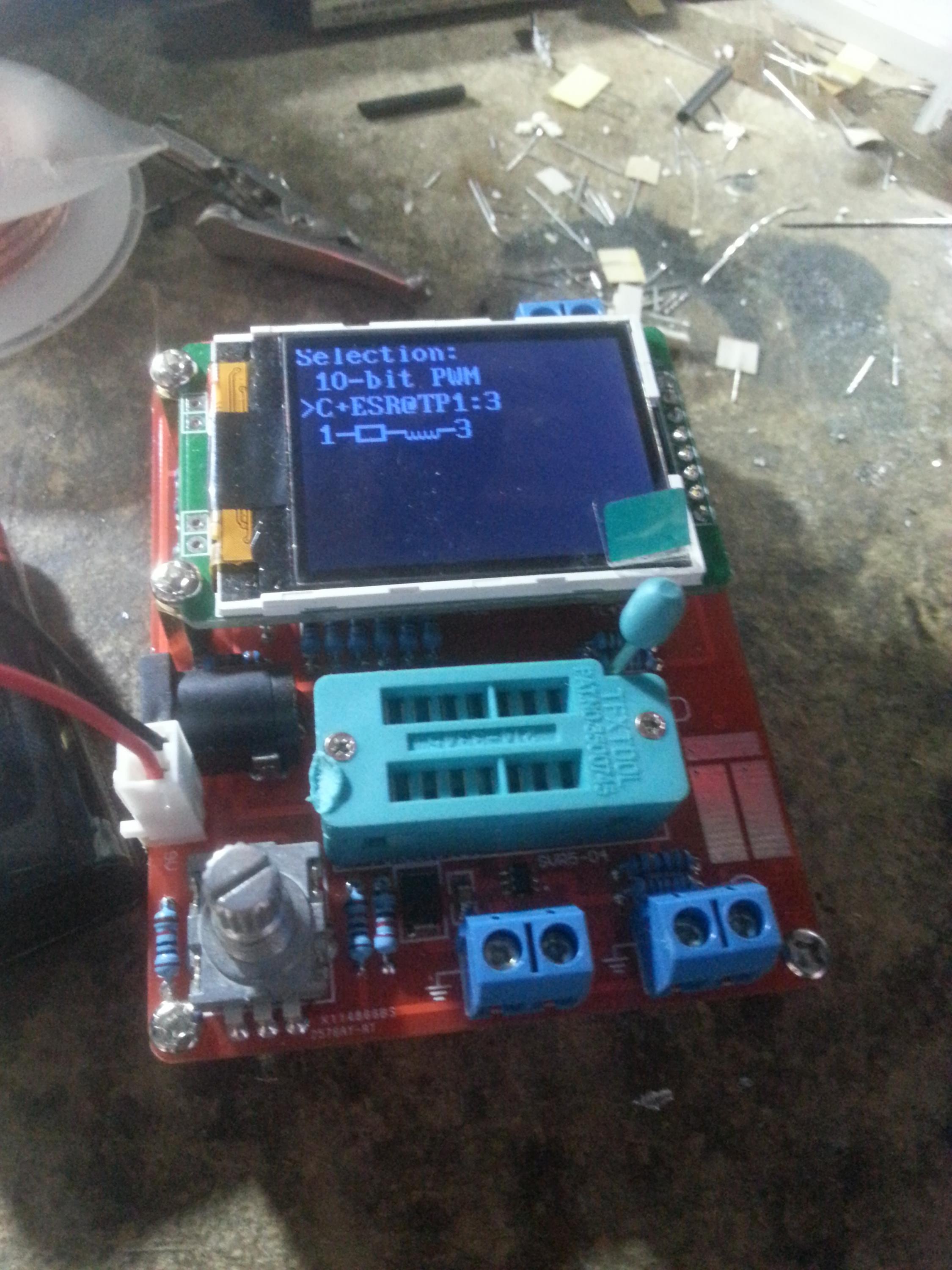

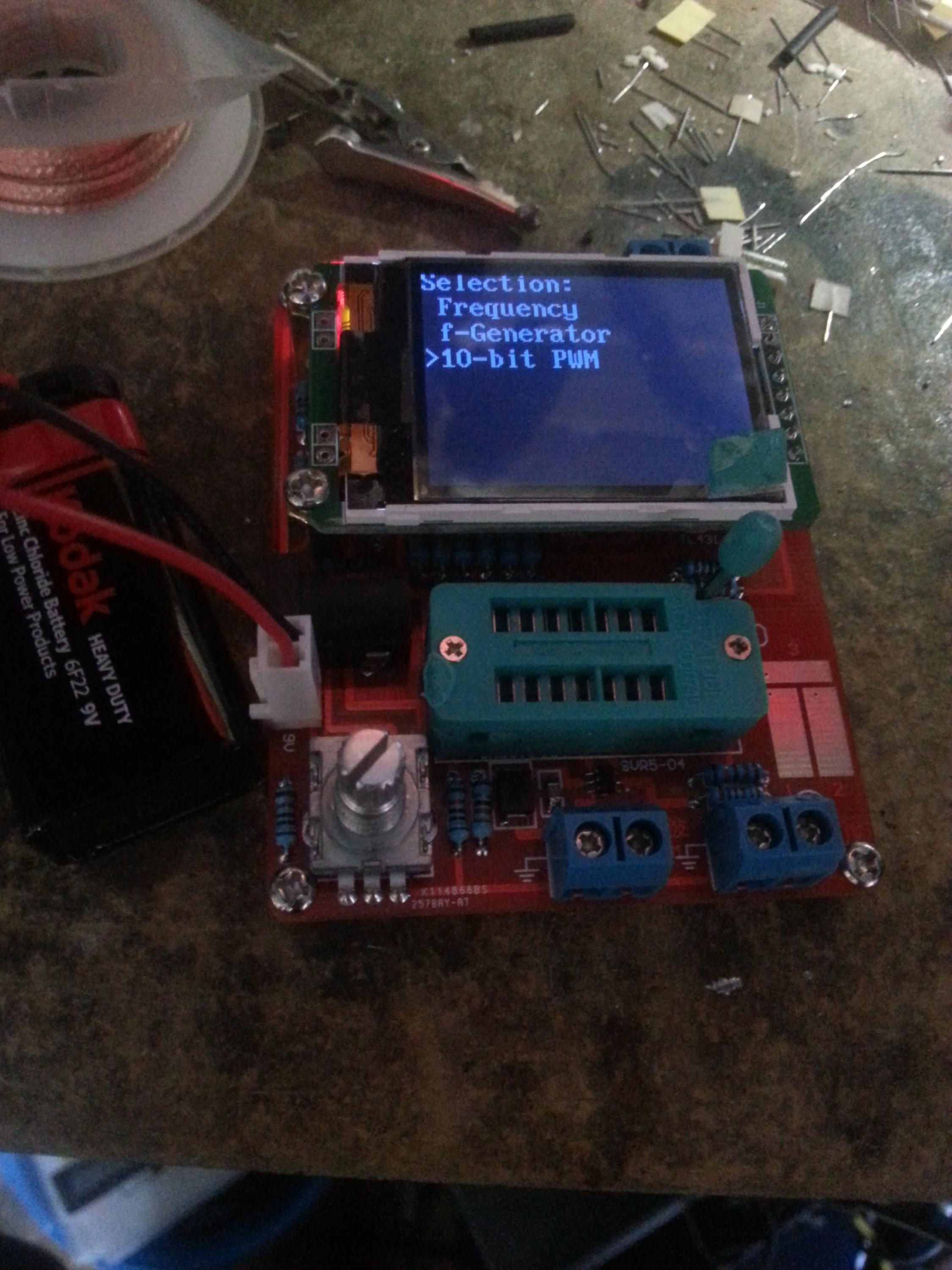

                                      Not wanting to miss out, my kit arrived a couple of days ago.
                                      Any idea what 10-bit PWM is for ?

                                          #500
                                          Re: ESR meter upgrades
                                          10bit PWM is exactly that, it can generate a PWM signal (5v) with 1024 steps controlled by the encoder.
                                          handy maybe for testing dimmers or servo's
