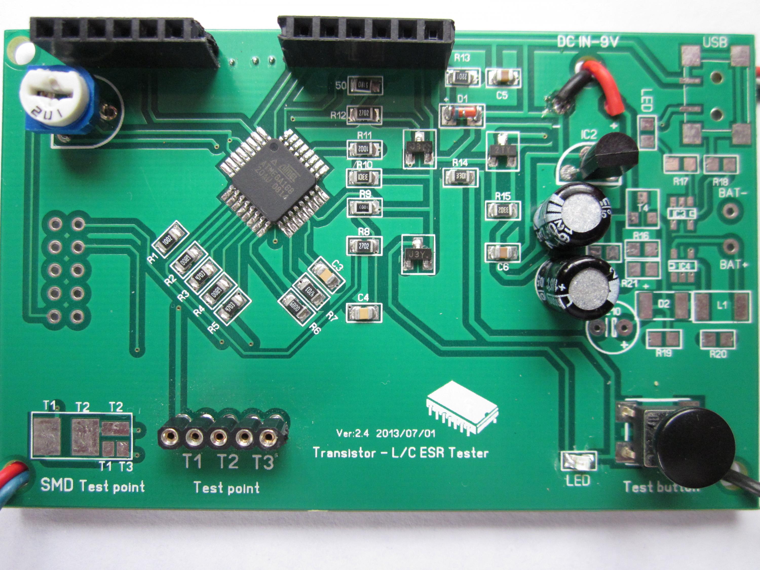

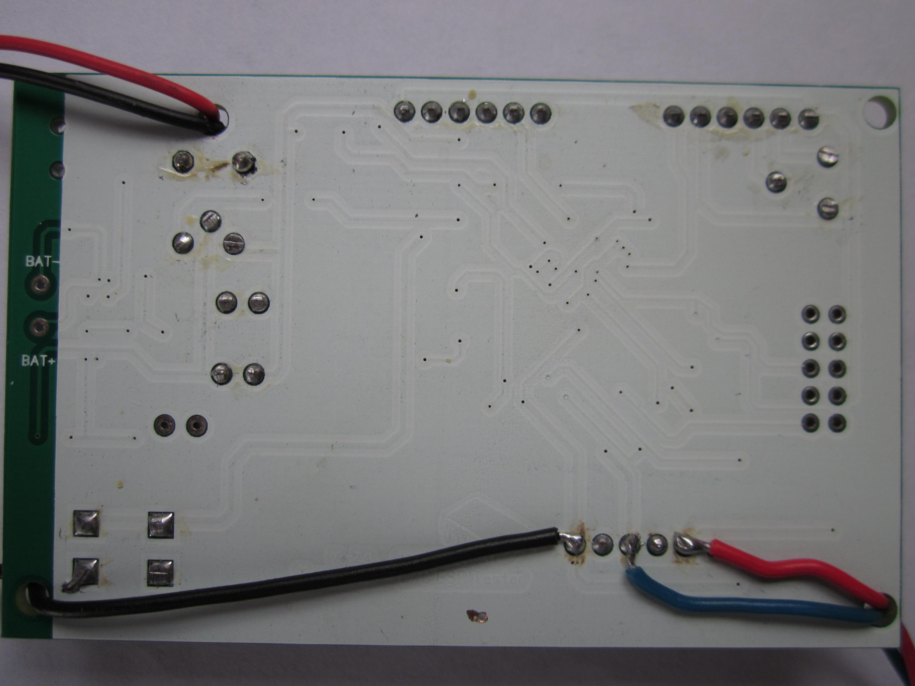

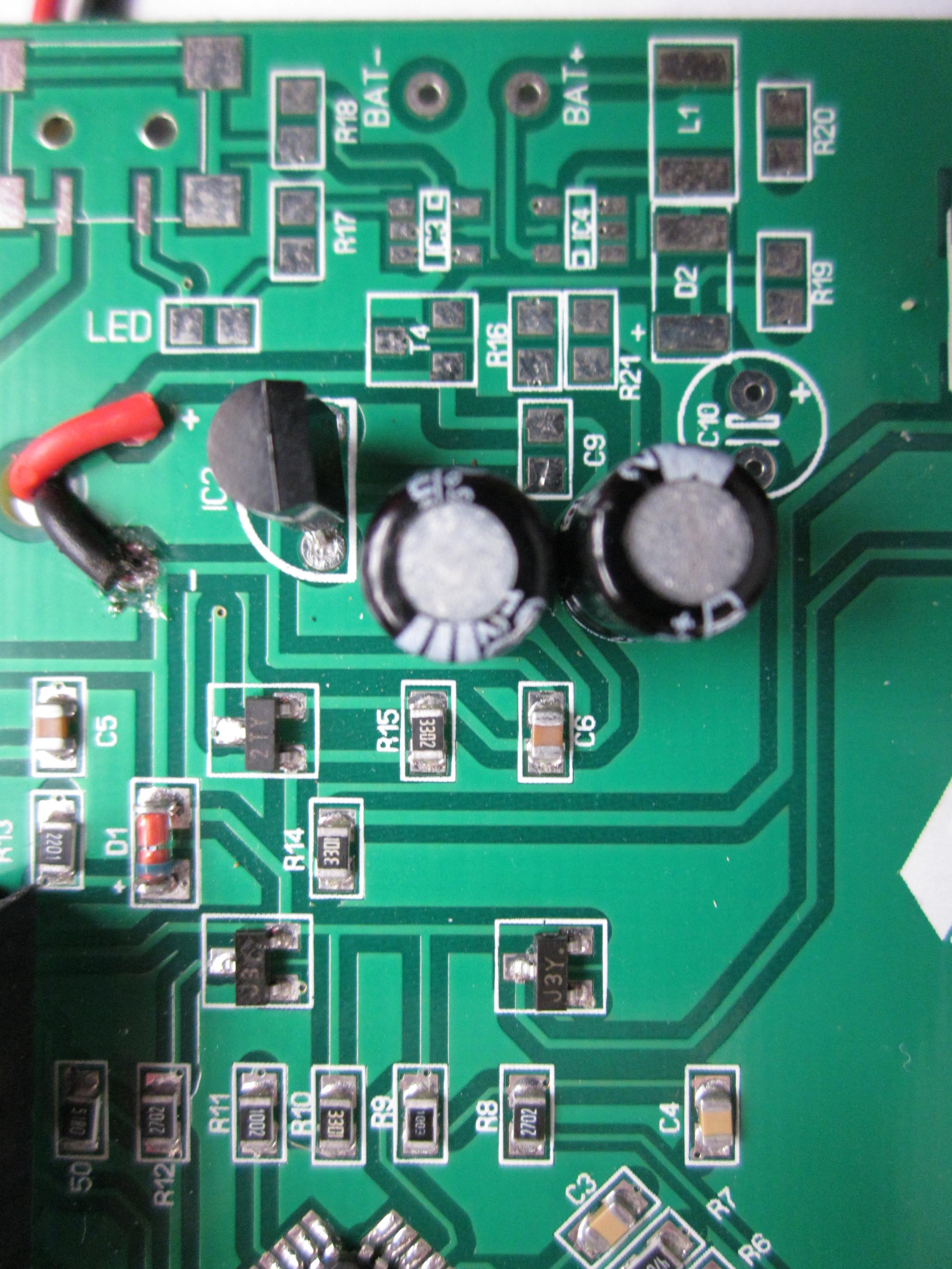

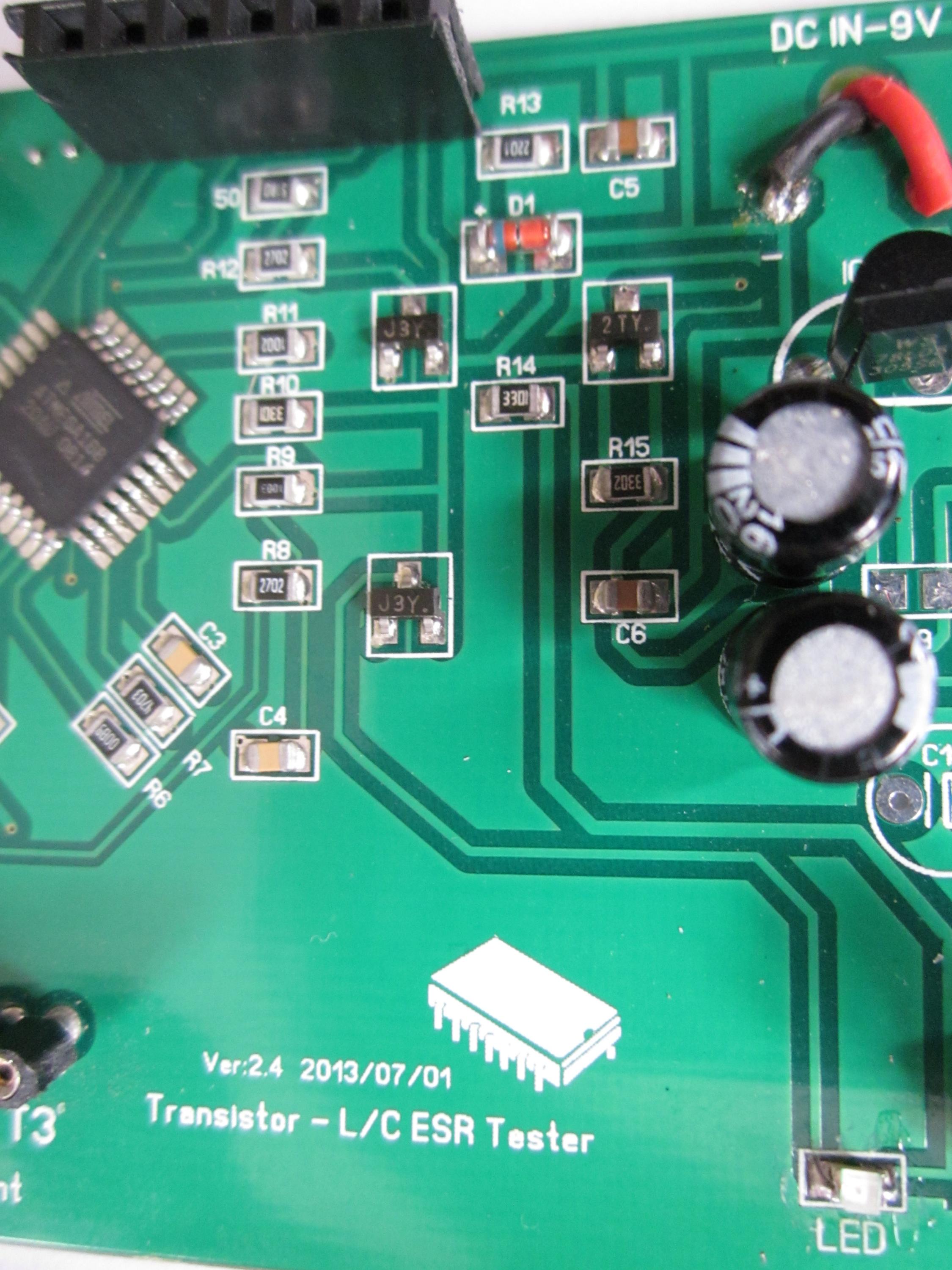

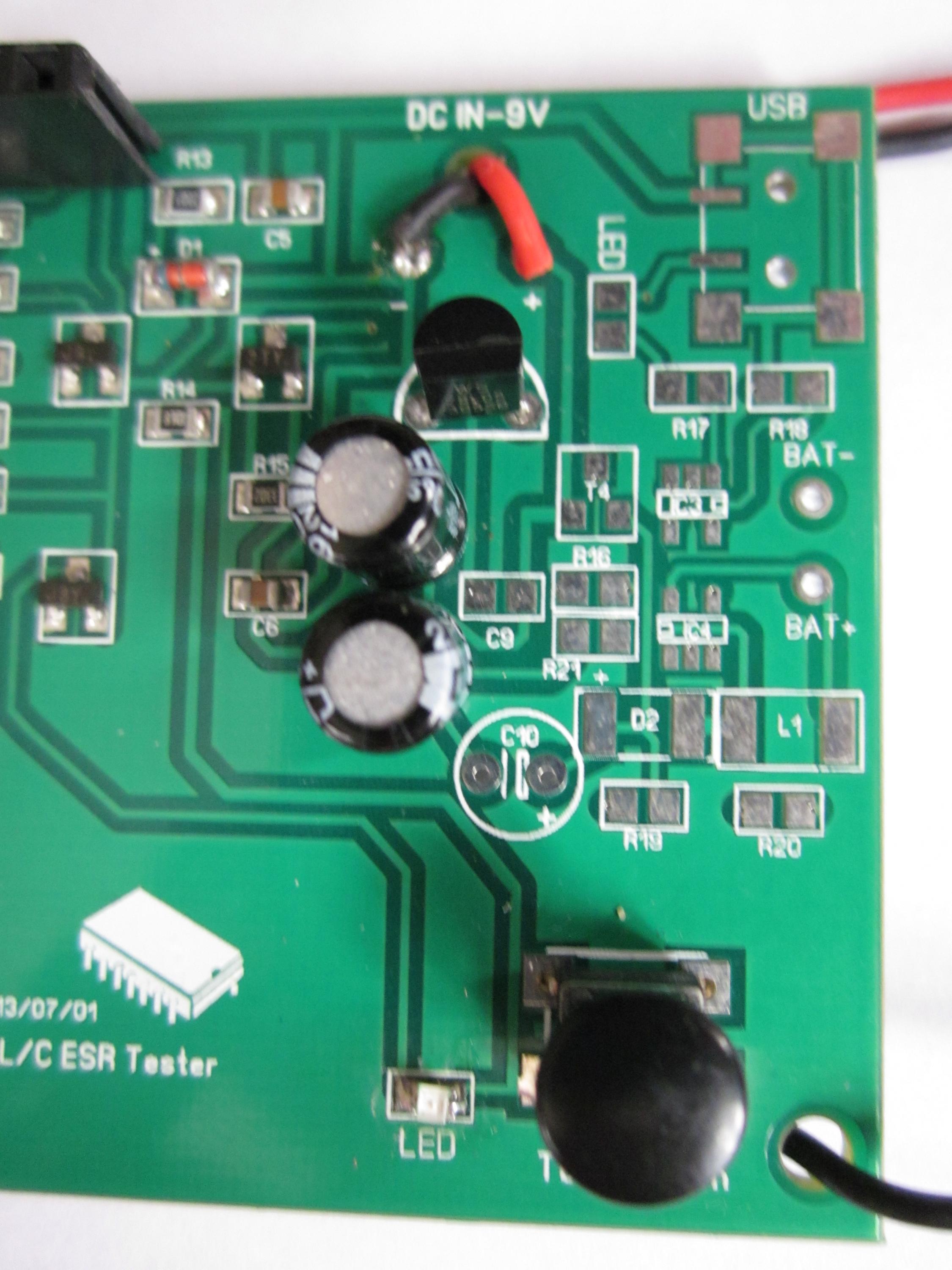

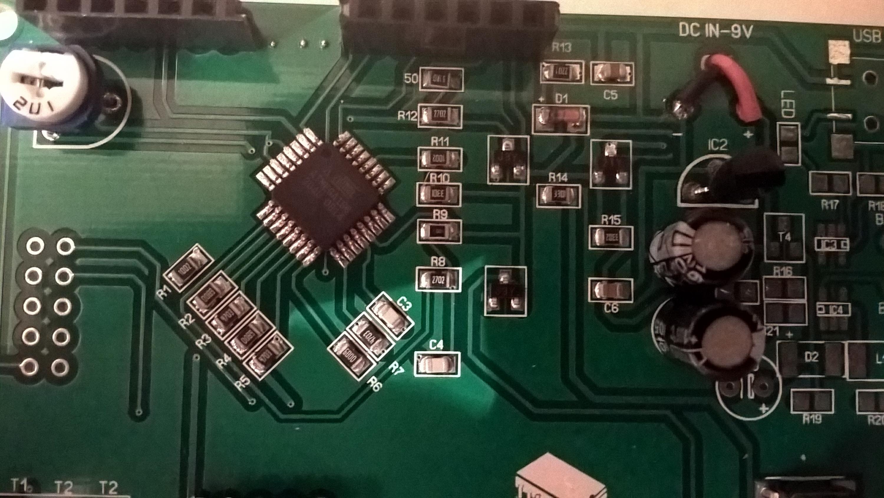

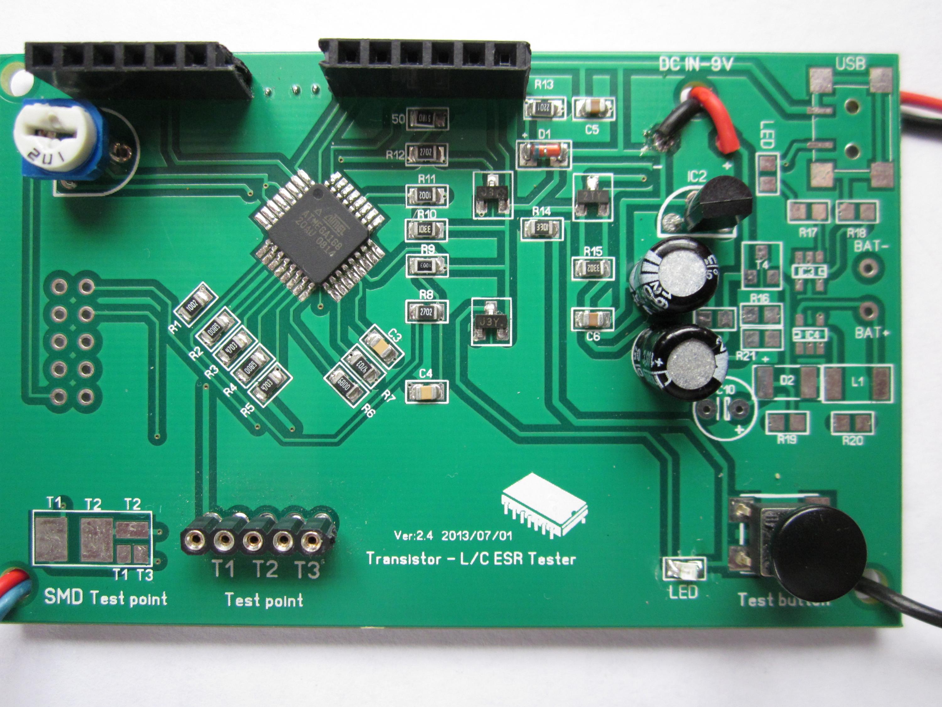

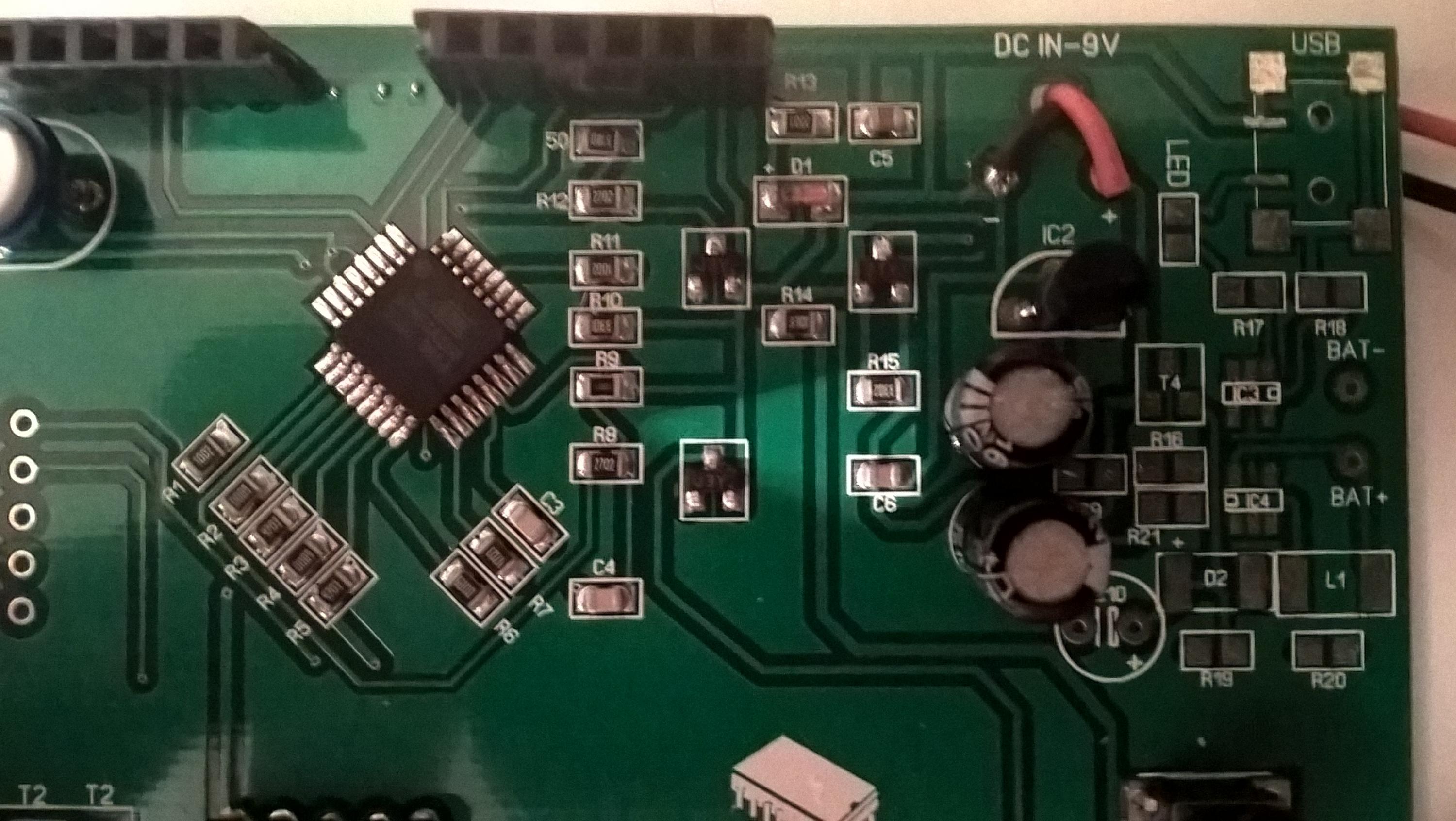

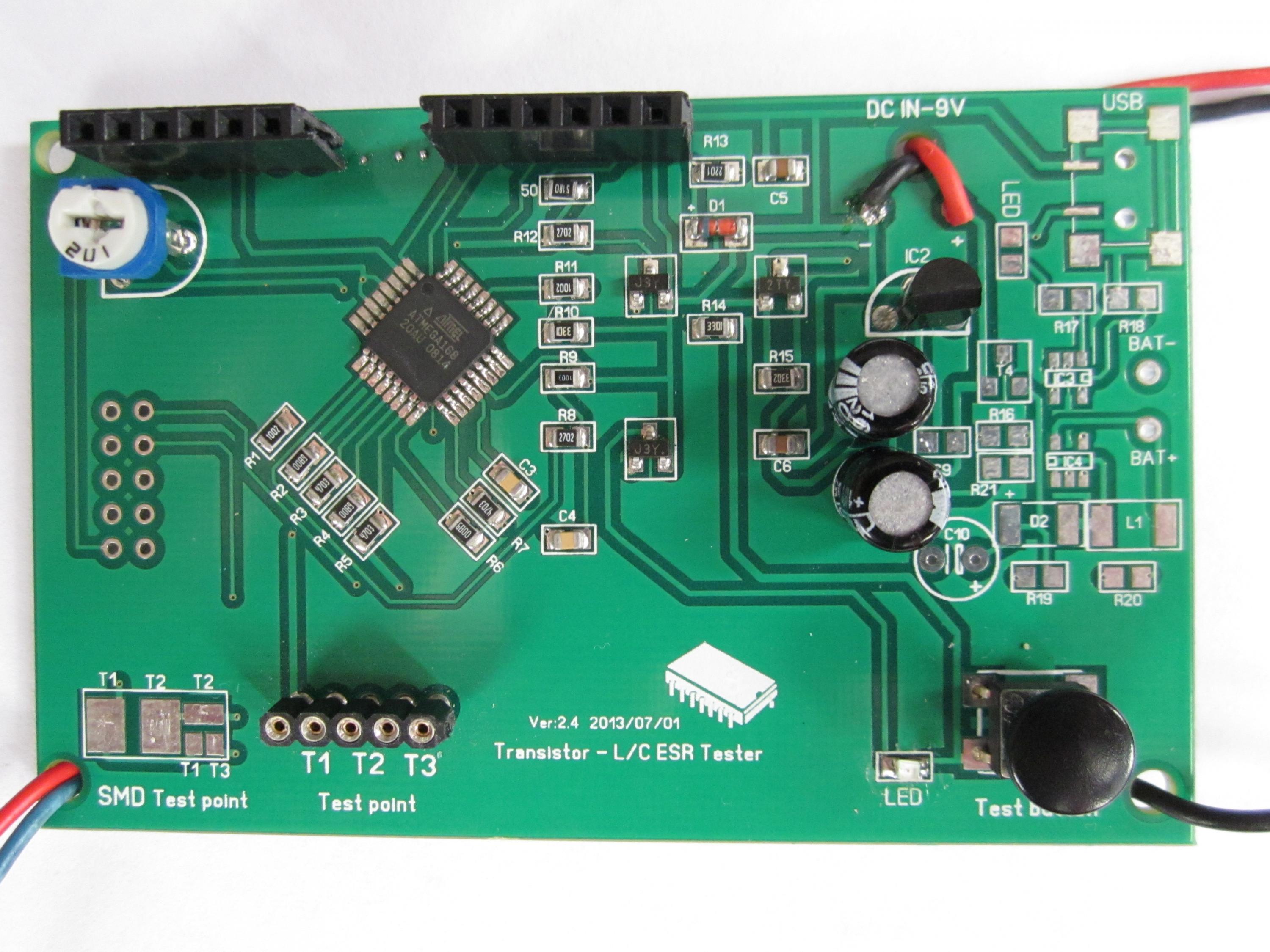

ESR meter upgrades
This is a sticky topic.
    • 31190
    #281
    Re: ESR meter upgrades
    no, you need the header because the chip is surface-mount.
    i can build the files for you.
    the regular ones are for 8MHz at the moment for some reason.
    • vinceroger69
      • Mar 2012
      • 6714
      • uk
      #282
      Re: ESR meter upgrades
      Hi that will be great if you can build the files i need all what im waiting for is the ic too come now
        • 31190
        #283
        Re: ESR meter upgrades
        can you compare the board to the schematic in the pdf and see if it has a voltage reference like an lm431 or just a zener diode on pin27.
        if it is a zener then upgrade it to an lm4040 from my RS links.
        also, does it power on when you hit the button, or is it one of the ones that is on as long as the battery is connected?
        last question:
        is the lcd 2x16, or 2x20 ?
        Last edited by stj; 07-04-2016, 01:17 PM.
        • vinceroger69
          • Mar 2012
          • 6714
          • uk
          #284
          Re: ESR meter upgrades
          screen 24.6 mm by 73 mm powers on when i press the switch and there is defently a zener on the board location d1 and i did order two lm4040 so alls good there.
          Last edited by vinceroger69; 07-04-2016, 01:51 PM.
            • 31190
            #285
            Re: ESR meter upgrades
            about the screen, i meant the characters, not physical size
            D1 is not a zener - i cant see any trace on pin27 - got any foto's of the underside?
            it may not even have a reference - cheap bastards.
            if that is the case, you also need a small 2k2 1% resistor.
            Last edited by stj; 07-04-2016, 02:14 PM.
            • vinceroger69
              • Mar 2012
              • 6714
              • uk
              #286
              Re: ESR meter upgrades
              nothing on the back its covered with a white plastic sheet so cant see nothing this thread
              http://www.eevblog.com/forum/testgear/$20-lcr-esr-transistor-checker-project/75/
              the one by kubi48
              has really good info ive just found it may help us out and how do i tell what size the characters are?
              Last edited by vinceroger69; 07-04-2016, 02:34 PM.
                • 31190
                #287
                Re: ESR meter upgrades
                not the size, just count them - how many across a line!
                • vinceroger69
                  • Mar 2012
                  • 6714
                  • uk
                  #288
                  Re: ESR meter upgrades
                  2x16 sorry stj its been one of those days
                    • 31190
                    #289
                    Re: ESR meter upgrades
                    see, not so hard!
                      • 31190
                      #290
                      Re: ESR meter upgrades
                      i was just thinking about that old character display.
                      once the main board is upgraded, want to upgrade the display too?
                      http://www.ebay.co.uk/itm/311500898933
                      • vinceroger69
                        • Mar 2012
                        • 6714
                        • uk
                        #291
                        Re: ESR meter upgrades
                        I have got a spare original type lcd with a blue backlight but never fitted it although your link does seem a better option though, stj what are the mounting point things called the pins with plastic on that you solder on to the lcd pcb that then pushes into the connector on the main pcb i looked yesterday but cant find nothing listed.
                          • 31190
                          #292
                          Re: ESR meter upgrades
                          the pins are 2.54mm pinstrips,
                          the sockets are sold at rapid, but i cant remember the name - i do have a few though from a repair job.
                          • vinceroger69
                            • Mar 2012
                            • 6714
                            • uk
                            #293
                            Re: ESR meter upgrades
                            Originally posted by stj
                            the pins are 2.54mm pinstrips,
                            the sockets are sold at rapid, but i cant remember the name - i do have a few though from a repair job.
                            Thanks just found some on ebay now and once all my parts come i will update my 2016 version tester first and then modify my old tester as and when i have time etc im just waiting for the usb programer to come now then i will need the latest update files for the 2016 tester if you have a link many thanks again stj.
                              • 31190
                              #294
                              Re: ESR meter upgrades
                              i will build one when you get the hardware together.
                              • vinceroger69
                                • Mar 2012
                                • 6714
                                • uk
                                #295
                                Re: ESR meter upgrades
                                thankyou as you know this is the kit i got from ebay i beleive the ic is totally blank so will need all the files im new too all this programing stuff but i get theres is some type of eeprom files? that boot the tester up backlight font size etc then the added files to test diffrent componets etc with new updates to make it work more acurate and add more functions.
                                  • 31190
                                  #296
                                  Re: ESR meter upgrades
                                  it's a flash file and an eeprom file.
                                  flash holds the software, eeprom is used to store fonts & stuff.
                                    • 31190
                                    #297
                                    Re: ESR meter upgrades
                                    can you work out the wiring on the lcd connector for me,
                                    trace it back to the chip pins.
                                    • vinceroger69
                                      • Mar 2012
                                      • 6714
                                      • uk
                                      #298
                                      Re: ESR meter upgrades
                                      stj with this spare meter the 2x16 screen one, i think the modifications i will do just do is swop for the blue backlight lcd i have already and add the 16 mhz crystal and 2 capacitors and remove D1 and swop it with the lm4040 also change the main ic for the larger capacity one im waiting for and add the header to program it all , as this is only going to be a spare meter.
                                        • 31190
                                        #299
                                        Re: ESR meter upgrades
                                        no, d1 is power related - leave it alone.
                                        you fit the lm4040 with a 2k2 1% resistor.
                                        look in your pdf.
                                        btw, if you fit a blue display you may need to change the resistor driving the backlights - blue leds use a higher voltage than green ones.
                                        • vinceroger69
                                          • Mar 2012
                                          • 6714
                                          • uk
                                          #300
                                          Re: ESR meter upgrades
                                          ok so D1 i wont touch
                                          is this the section you mean in the pdf ?
                                          The additional 2:5V
                                          precision voltage reference connected at pin PC4 (ADC4) can be used to
                                          check and calibrate the VCC voltage, but is not required. You can use a LM4040-AIZ2.5 (0.1%), a
                                          LT1004CZ-2.5 (0.8%) or a LM336-Z2.5 (0.8%) as voltage reference. If you don't install the precision
                                          voltage reference and you don't add the relay extension, you should install a pull up resistor R16 to
                                          PC4 with a higher resistance value (47k). This helps the software to detect the missing voltage
                                          reference. A optional ISP connector has been added to easier load new software versions to the tester.
                                          Edit! im going too take some good pictures later of my pcb that way if you have a few spare minutes can you highlite what i need to change just so i get it right in fitting the LM4040 and the resistor thanks stj
                                          Last edited by vinceroger69; 07-07-2016, 04:19 AM.
                                          • chth96
                                            Is it possible to test small ceramic disc capacitor with analogue meter?
                                            by chth96
                                            I read EBOOK of Testing Electronic Component and found that
                                            "In order to test the small blue resin coated ceramic disk capacitor which has 104 50v specification,it is possible to test this small ceramic capacitor by making use of analogue meter.
                                            Set to times 10Kohm that has 12v output from the probe to check disorder of ceramic capacitor.
                                            It is not uncommon that testing result of digital capacitance meter is okay,But It show shorted reading when you check it with analogue meter."
                                            Is it really possible to test small ceramic disc capacitor with analogue...
                                            03-09-2024, 10:03 PM
                                            Modification of a Fluke multi meter that uses three AA batteries to use a 14500 lithium ion battery
                                            by sam_sam_sam
                                            I have had with regular AA batteries that leak this meter is expensive new I already replaced the battery battery clips once and the same thing happened again and I am tried of so it is getting modified to accommodate lithium ion batteries that are the same size excluding the positive terminal and removing the battery clips I will have enough room for the BMS protection board
                                            I going to put 3 lithium ion battery in parallel with the BMS protection board and a way to charge the battery externally and heat shrink the battery pack and use a JST connector so I easily remove the battery...
                                            12-31-2023, 06:04 AM
                                          • jorpec
                                            Changing the scale of an analog meter
                                            by jorpec
                                            Hi
                                            I want to change the scale of an analog meter, to monitor the charge of an li-ion single cell, so the needle at the end would point 4.2 volts and the 0 on the meter would point 2.5 volts or so, i tried to add diodes or a zener in series with the meter but the changes of the ambient temperature also changes the voltage value on the meter
                                            I wonder how i can accomplish this so the meter would be precise at any temperature ?
                                            Thnaks
                                            01-23-2023, 10:37 AM
                                            How an incandescent light and a ESR meter ** friend**have a machine blowing fuses
                                            by sam_sam_sam
                                            About a month ago we had a transformer jumper wire that burned in two different places between two transformers caused over $200 thousand dollars worth of damage to VFD drives at least 10 of them and a memory card and quite a few power supply as well
                                            Now we have most of the equipment that got damaged back up and running except a feeder that has issues and we are waiting for some parts for
                                            Now we also have another piece of equipment that was blowing fuses on the 110 volt controller switch circuit with the “E” stops and one switching power (24 volt) supply and a transformer...
                                            12-14-2023, 07:45 PM
                                          • irepair559
                                            ps4 1215 model Changed port and encoder still no video?
                                            by irepair559
                                            hi guys so i have this ps4 fat 1215 i believe ( the one with the ps4 pro/slim newer encoder ic ) so i replaced hdmi and 2 blown filters and still no pic so i replaced encoder and still no pic. i made sure port is solid even checked with a breakout hdmi and tested ground and data lines.. Filters are all good , though 2 of the newer ones are larger then the original ones i dont know if that matters ?
                                            Made sure under the scope encoder pins all look solid went over with fine tip and solder again. Idk but this thing is stressing me out..
                                            ps4 seems to boot fine blue light then solid...
                                            01-01-2023, 12:41 AM
