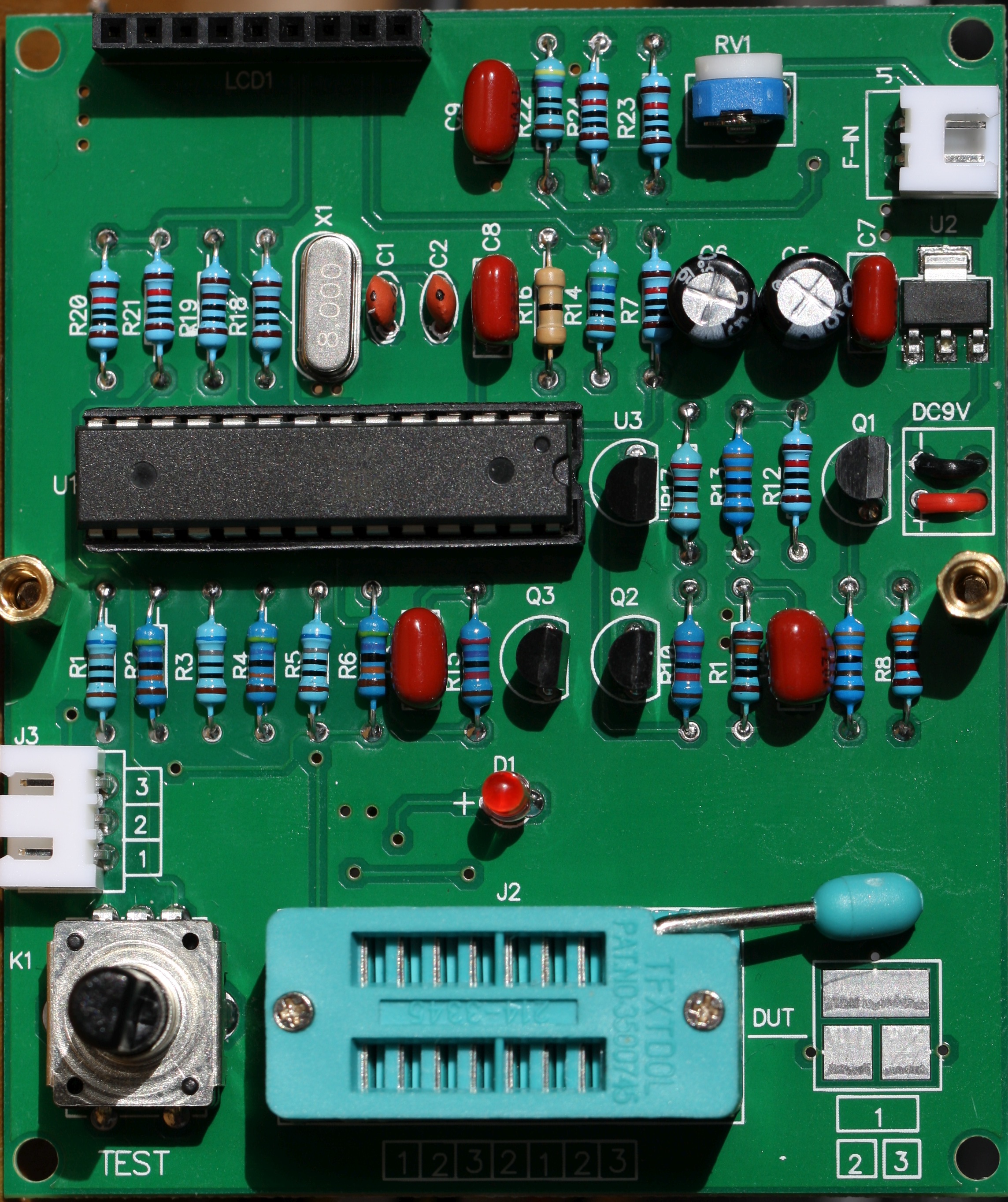

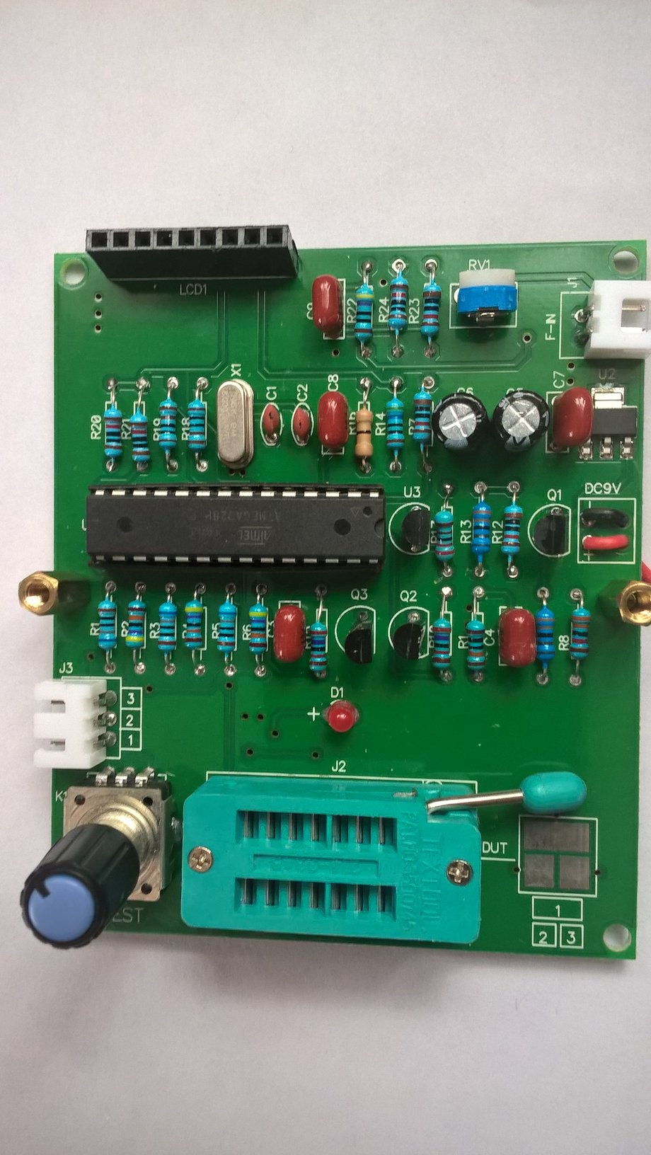

ESR meter upgrades
This is a sticky topic.
    • 31188
    #341
    Re: ESR meter upgrades
    btw, contact the seller for a refund or a programmed chip!!
      • 31188
      #342
      Re: ESR meter upgrades
      more display types to try
        • 31188
        #343
        Re: ESR meter upgrades
        and one more
        • vinceroger69
          • Mar 2012
          • 6714
          • uk
          #344
          Re: ESR meter upgrades
          Finally mine arrived too!
          I've got the same as vinceroger69, with the firmware from this post I get scrolling characters on the screen when I power on.
          With the other firmware from this post it is blank.
          The chip did contain a few bytes of code when I got it but for sure it was not a complete program.
          The programmer acted like it was empty; like vinceroger69 explained in this post. (I attached what was there in the rar file).
          With the scrolling text I can't do anything, if I press the encoder nothing happens, I need to remove the battery to power off.
          The LCD is marked LCM_12864_V1.30 2015.09.01
          I attached pictures showing the scrolling text and of the LCD backside.
          I used a Willem GQ-4X USB Programmer to program the chip and set the fuses.
          (I had to do a "Erase" first which I did not at first realize, took many attempts until I found out that was the problem because the program never got written properly, I did the programming in circuit.)
          Thanks for the update at least its not just me having issues with these kits from this seller im in the same situation as you at the minute just trying to find the correct firmware for it (i havnt had time too look for more at the moment though) this thread from eevblog has a lot of firmware for these testers and is well worth a read, stj and myself have posted in this thread but i have not asked for help regarding the firmware as yet.
          http://www.eevblog.com/forum/testgear/$20-lcr-esr-transistor-checker-project/
          Last edited by vinceroger69; 07-14-2016, 03:34 AM.
            • 31188
            #345
            Re: ESR meter upgrades
            the colour-TFT kits have been shipped with blank mcu's a few times too!!
            seems the seller needs to sort this shit if it's not a lone incident !
            • vinceroger69
              • Mar 2012
              • 6714
              • uk
              #346
              Re: ESR meter upgrades
              Thanks for the update at least its not just me having issues with these kits from this seller im in the same situation as you at the minute just trying to find the correct firmware for it (i havnt had time too look for more at the moment though) this thread from eevblog has a lot of firmware for these testers and is well worth a read, stj and myself have posted in this thread but i have not asked for help regarding the firmware as yet.
              http://www.eevblog.com/forum/testgear/$20-lcr-esr-transistor-checker-project/
              I have just posted in eevblog too as they maybe able to offer some help too i will try all your latest files later stj when i get back home many thanks again for your help.
              • Per Hansson
                • Jul 2005
                • 5895
                • Sweden
                #347
                Re: ESR meter upgrades
                mega328_st7920
                testing-1306.zip
                testing-dogm.zip
                The above three behaved like it also did with "testing.zip" which was blank screen.
                testing-ramshift.zip
                testing-oc.zip
                The above two behaved like it also did with "GM328A ESR tester (SVN663).zip" which was scrolling characters on the screen.
                • vinceroger69
                  • Mar 2012
                  • 6714
                  • uk
                  #348
                  Re: ESR meter upgrades
                  mega328_st7920
                  testing-1306.zip
                  testing-dogm.zip
                  The above three behaved like it also did with "testing.zip" which was blank screen.
                  testing-ramshift.zip
                  testing-oc.zip
                  The above two behaved like it also did with "GM328A ESR tester (SVN663).zip" which was scrolling characters on the screen.
                  Thanks for trying all the firwares above ive just updated the eevblog one and said there recommended one didnt work i would if i was you contact the ebay seller and tell them the issues as i got a partial refund on mine and kept the kit since then i have brought a identical pre built kit that works fine but i cant read the atmega328p ic with my promini tl866 programmer all i get is a whole screen of ff s as no data on chip although it maybe protected somehow hence wont read.
                  • Per Hansson
                    • Jul 2005
                    • 5895
                    • Sweden
                    #349
                    Re: ESR meter upgrades
                    Here is a picture of my meter assembled.
                    It was impossible for me yesterday night to see the color bands so I measured the resistors and put them in according to stj's nice reverse engineered component schematic.
                    That said it's of course possible some of the resistors are 0.1% while some could be 1%, so no warranties there
                    I now tested another firmware: mega328_st7565 but the screen was blank with that as well.
                    EDIT, not blank: https://www.badcaps.net/forum/showpo...&postcount=463
                    Do note that our LCD has 9 pins, I note that most other testers use LCD's with a parallel connection and much more pins?
                    Last edited by Per Hansson; 07-31-2016, 04:06 AM.
                      • 31188
                      #350
                      Re: ESR meter upgrades
                      the lcd actually uses 4 pins.
                      clock,data,enable and select.
                      enable is probably permanently grounded.
                      it *should* be SPI, but i may try I2C instead.
                      • vinceroger69
                        • Mar 2012
                        • 6714
                        • uk
                        #351
                        Re: ESR meter upgrades
                        Here is a picture of my meter assembled.
                        It was impossible for me yesterday night to see the color bands so I measured the resistors and put them in according to stj's nice reverse engineered component schematic.
                        That said it's of course possible some of the resistors are 0.1% while some could be 1%, so no warranties there
                        I now tested another firmware: mega328_st7565 but the screen was blank with that as well.
                        Do note that our LCD has 9 pins, I note that most other testers use LCD's with a parallel connection and much more pins?
                        this is my assembled tester i have checked the resitors against my prebuilt unit and they all match fine ive posted again on eevblog too see if they can help.
                        Thanks for updating the eevblog thread too as you can explane things better than i can and im still learning to use my programmer so with you testing the firmware too is good as i maybe making mistakes just to note the kit i brought was from one ebay seller but the pre assembled kit came from another seller although i cant see that making any diffrence as they identical units.
                        Last edited by vinceroger69; 07-14-2016, 11:26 AM.
                          • 31188
                          #352
                          Re: ESR meter upgrades
                          o.k.
                          after looking at the pcb foto's again,
                          i'm damn sure they are using a 7565 type display and PD0-3 on the cpu.
                          so i'm now working on the theory that they have swapped over some of the display wires for some reason.
                          everything else about the board is the same as the generic schems.
                          so test this - swapping the clock and data pins.
                          • vinceroger69
                            • Mar 2012
                            • 6714
                            • uk
                            #353
                            Re: ESR meter upgrades
                            I will try your file as soon as im home stj ,madires on eevblog has said
                            Since the tester stays on it's clearly a display problem. The first thing is to identify the display controller and then the pinout.
                            how do we find that information out?
                            • Per Hansson
                              • Jul 2005
                              • 5895
                              • Sweden
                              #354
                              Re: ESR meter upgrades
                              Ok, short update.
                              I did contact the seller and he actually got back with a decent reply.
                              I quoted it below, the linked schematic seems to be correct.
                              I tried both the linked "Original.zip" firmware, that did not work. (Blank LCD).
                              The author of that post talked about it being the mega328_color_kit so I tried that firmware too, but no dice, just blank LCD again...
                              EDIT: Forgot to add that in the "Original.zip" the firmware itself seems ok.
                              But the Data.hex file is really different, it contains the menu options in clear text instead of fonts it looks like to me?
                              Also it includes a Config.hex which is for the fuses but I'm not sure how to convert that to the values I would need.
                              Finally stj I tried your testing-swap23.zip firmware but that also just resulted in a blank LCD...
                              Dear,Good buyer
                              hi . please open the link download data .thank you
                              https://cdn.badcaps-static.com/pdfs/...c38653ee0e.pdf
                              have a great (nice) day
                              best regards
                              You can get the program data from address:
                              https://www.mikrocontroller.net/topi...626751#4627652
                              Just download the file Original.zip .
                              Last edited by Per Hansson; 07-14-2016, 01:31 PM.
                              • vinceroger69
                                • Mar 2012
                                • 6714
                                • uk
                                #355
                                Re: ESR meter upgrades
                                Thanks per hansson and stj for trying as well to find the firmware etc as per madires message on eevblog i guess thats our next step as in, The first thing is to identify the display controller and then the pinout, but how do we find this information out is it worth removing the lcd from the pcb and seeing if that shows anything usefull.
                                  • 31188
                                  #356
                                  Re: ESR meter upgrades
                                  unlikely that it's got clear markings on it, but you never know.
                                  the cpu as i said is using PD0-3, so just need to find how they go to the lcd.
                                  i will make a few more versions later.
                                    • 31188
                                    #357
                                    Re: ESR meter upgrades
                                    test
                                    • Per Hansson
                                      • Jul 2005
                                      • 5895
                                      • Sweden
                                      #358
                                      Re: ESR meter upgrades
                                      Originally posted by stj
                                      unlikely that it's got clear markings on it, but you never know.
                                      the cpu as i said is using PD0-3, so just need to find how they go to the lcd.
                                      i will make a few more versions later.
                                      The schematic "4660.pdf" linked above in my previous post is correct.
                                      Of course I don't know if that matches internally with the LCD itself.
                                      But I have atleast checked that the wiring to the LCD header is as the schematic shows
                                      I tested your version above but it was more of the same: only backlight.
                                      Just to make sure I again reflashed your old firmware from this post.
                                      And I did get the scrolling text as shown in my picture here.
                                      (Just wanted to make sure nothing else had happened).
                                      EDIT: can't the problem be with the fuses?
                                      Last edited by Per Hansson; 07-15-2016, 01:44 PM.
                                      • vinceroger69
                                        • Mar 2012
                                        • 6714
                                        • uk
                                        #359
                                        Re: ESR meter upgrades
                                        This looks like the exact screen used on these testers theres a pin out included dont know if this helps but thought i would post it
                                        http://www.ebay.com/itm/12864-Charac...3D252225067851
                                          • 31188
                                          #360
                                          Re: ESR meter upgrades
                                          no, i'v seen a few of these panels lifted - they are more like this:
                                          http://www.ebay.com/itm/182035169094
                                          the question is how that ribbon maps to the pinstrip on the backing pcb.
                                          • chth96
                                            Is it possible to test small ceramic disc capacitor with analogue meter?
                                            by chth96
                                            I read EBOOK of Testing Electronic Component and found that
                                            "In order to test the small blue resin coated ceramic disk capacitor which has 104 50v specification,it is possible to test this small ceramic capacitor by making use of analogue meter.
                                            Set to times 10Kohm that has 12v output from the probe to check disorder of ceramic capacitor.
                                            It is not uncommon that testing result of digital capacitance meter is okay,But It show shorted reading when you check it with analogue meter."
                                            Is it really possible to test small ceramic disc capacitor with analogue...
                                            03-09-2024, 10:03 PM
                                            Modification of a Fluke multi meter that uses three AA batteries to use a 14500 lithium ion battery
                                            by sam_sam_sam
                                            I have had with regular AA batteries that leak this meter is expensive new I already replaced the battery battery clips once and the same thing happened again and I am tried of so it is getting modified to accommodate lithium ion batteries that are the same size excluding the positive terminal and removing the battery clips I will have enough room for the BMS protection board
                                            I going to put 3 lithium ion battery in parallel with the BMS protection board and a way to charge the battery externally and heat shrink the battery pack and use a JST connector so I easily remove the battery...
                                            12-31-2023, 06:04 AM
                                          • jorpec
                                            Changing the scale of an analog meter
                                            by jorpec
                                            Hi
                                            I want to change the scale of an analog meter, to monitor the charge of an li-ion single cell, so the needle at the end would point 4.2 volts and the 0 on the meter would point 2.5 volts or so, i tried to add diodes or a zener in series with the meter but the changes of the ambient temperature also changes the voltage value on the meter
                                            I wonder how i can accomplish this so the meter would be precise at any temperature ?
                                            Thnaks
                                            01-23-2023, 10:37 AM
                                            How an incandescent light and a ESR meter ** friend**have a machine blowing fuses
                                            by sam_sam_sam
                                            About a month ago we had a transformer jumper wire that burned in two different places between two transformers caused over $200 thousand dollars worth of damage to VFD drives at least 10 of them and a memory card and quite a few power supply as well
                                            Now we have most of the equipment that got damaged back up and running except a feeder that has issues and we are waiting for some parts for
                                            Now we also have another piece of equipment that was blowing fuses on the 110 volt controller switch circuit with the “E” stops and one switching power (24 volt) supply and a transformer...
                                            12-14-2023, 07:45 PM
                                          • irepair559
                                            ps4 1215 model Changed port and encoder still no video?
                                            by irepair559
                                            hi guys so i have this ps4 fat 1215 i believe ( the one with the ps4 pro/slim newer encoder ic ) so i replaced hdmi and 2 blown filters and still no pic so i replaced encoder and still no pic. i made sure port is solid even checked with a breakout hdmi and tested ground and data lines.. Filters are all good , though 2 of the newer ones are larger then the original ones i dont know if that matters ?
                                            Made sure under the scope encoder pins all look solid went over with fine tip and solder again. Idk but this thing is stressing me out..
                                            ps4 seems to boot fine blue light then solid...
                                            01-01-2023, 12:41 AM
