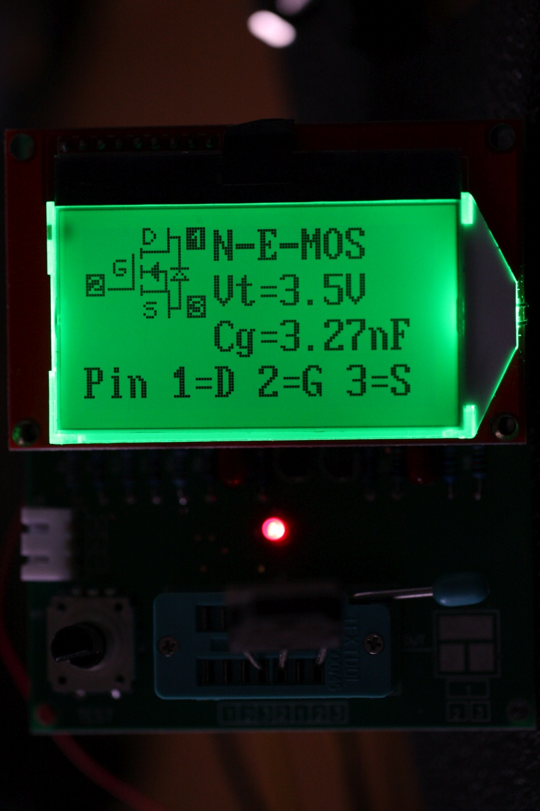

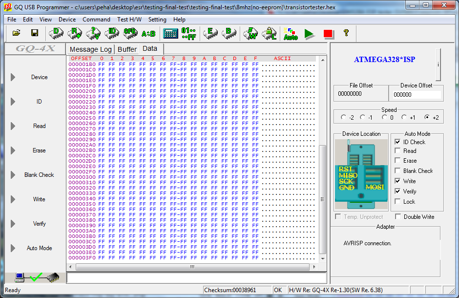

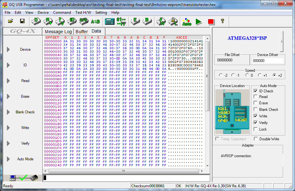

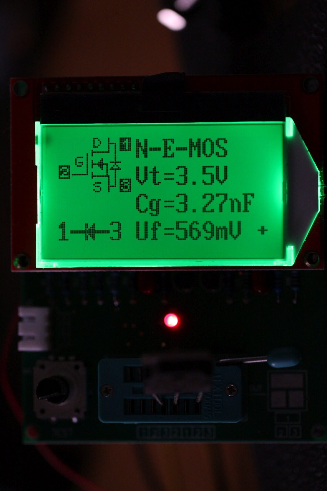

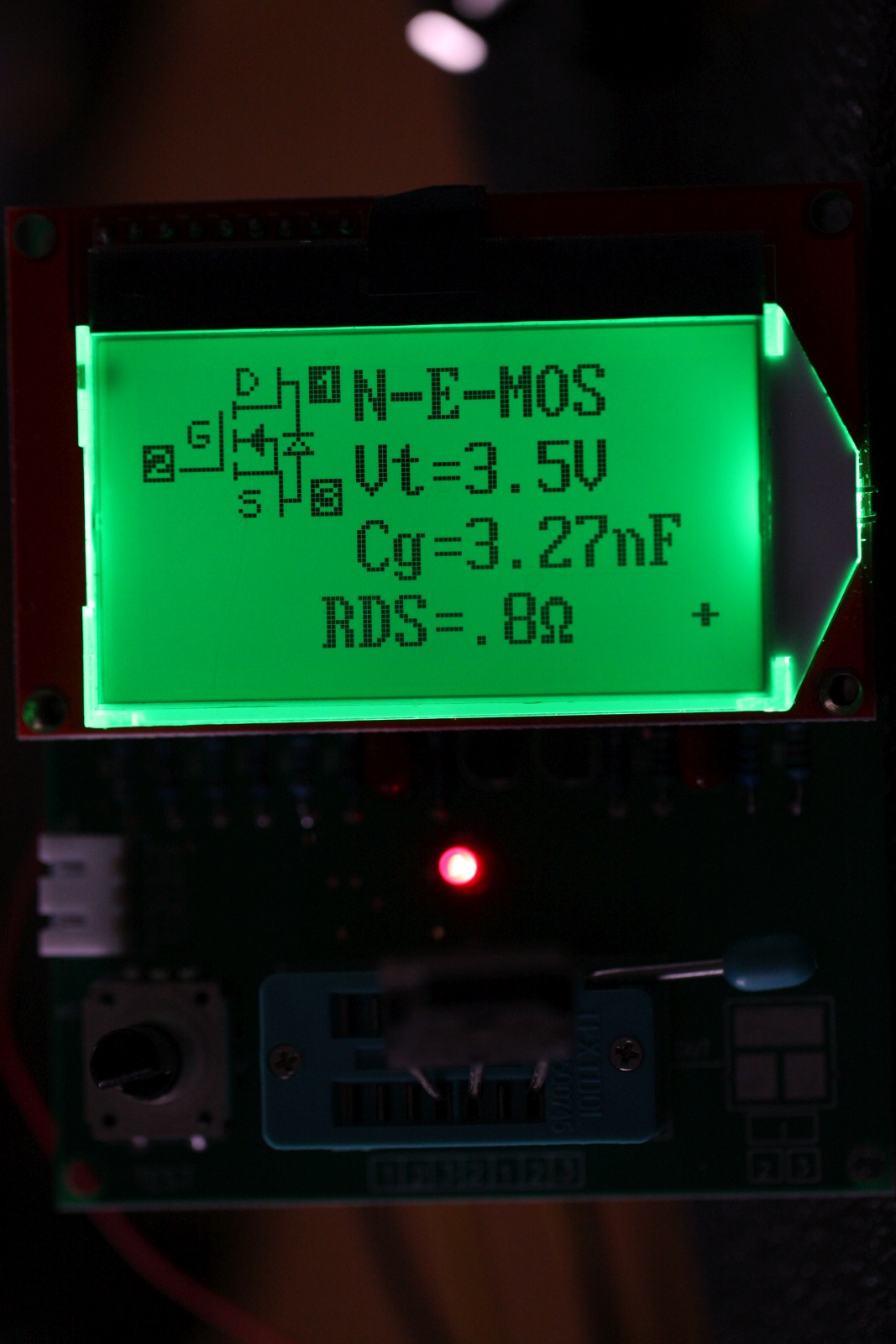

ESR meter upgrades
This is a sticky topic.
    • 31288
    #441
    Re: ESR meter upgrades
    yea, but put a fet or a transistor with reverse-diode in it and see how much text it has to display!
    when you flash it each time, is it forcing you to calibrate it by shorting all 3 lines and then fitting a small film cap?
    because it should.
    if not then your problem may be residual crap in the eeprom because you must erase the chip before you program it.
      • 31288
      #442
      Re: ESR meter upgrades
      about the fonts.
      i see this:
      # If option WITH_LCD_ST7565 is present one of the following fonts should be
      # choosen. With a font width below 8 more than 16 characters can be shown in one display line.
      #CFLAGS += -DFONT_5X8
      #CFLAGS += -DFONT_6X8
      #CFLAGS += -DFONT_8X8
      CFLAGS += -DFONT_7X12
      #CFLAGS += -DFONT_8X12thin
      #CFLAGS += -DFONT_8X14
      #CFLAGS += -DFONT_8x15
      #CFLAGS += -DFONT_8X16
      #CFLAGS += -DFONT_8X16thin
      the one you like is the 8x15 one.
      Last edited by stj; 07-16-2016, 10:18 AM.
      • Per Hansson
        • Jul 2005
        • 5895
        • Sweden
        #443
        Re: ESR meter upgrades
        Originally posted by stj
        when you flash it each time, is it forcing you to calibrate it by shorting all 3 lines and then fitting a small film cap?
        because it should.
        if not then your problem may be residual crap in the eeprom because you must erase the chip before you program it.
        Yes it does, I actually have not calibrated it yet.
        But I need to find the required cap but also RTFM on how to actually do it right
          • 31288
          #444
          Re: ESR meter upgrades
          well that explains your 0.00 error.
          i enabled a new testing mode - far more acurate. (if you calibrated it)
          you need a way to short the 3 lines - i use a 3way pinstrip with the ends soldered together in the test-socket.
          and a cap between 100n and 1uf that is stable.
          i use a 220n film cap
          it will also ask for "cap for L-res" - ignore that till it times out for now - it's related to small inductors.
          Last edited by stj; 07-16-2016, 10:44 AM.
            • 31288
            #445
            Re: ESR meter upgrades
            i was just thinking about where this could be used
            http://www.ebay.co.uk/itm/181969533556
            i can see an order coming on.
            • Per Hansson
              • Jul 2005
              • 5895
              • Sweden
              #446
              Re: ESR meter upgrades
              I tried calibration on "testing-tuning2.zip"
              Not sure I did it right but it saved the data at least and does not ask for calibration on powerup anymore.
              But I might be expecting too much from the ESR test, because before I had the cap on the SMD testlegs.
              Now I put it in the ZIF socket (mine is really poor btw, already complained to the seller).
              But it shows ESR .00 for most LOW ESR caps I have.
              Pretty much like my Bob Parker MKII ESR meter, in it's case it's because the resolution is not high enough.
              Is it the same with this meter?
              Attached pictures showing testing a K2698 Mosfet.
              • vinceroger69
                • Mar 2012
                • 6714
                • uk
                #447
                Re: ESR meter upgrades
                Hi guys just got in and checked this thread a question per hansson when you ran your selftest how long did it take? mines been 5 mins now and just on test 7 also which test version are you running? my tester does seem slow booting up etc at the minute i will let it calibrate and try again.
                i might go back and try the one with the encoder going the wrong way as the capacitor and resistor reading wasnt far off my pre built version this firmware on now is reading a 1500 cap at 200.7uf esr.00 (brand new capacitor) so maybe a firmware issue i will try the one i tested first thing this morning and compare things.
                Last edited by vinceroger69; 07-16-2016, 04:11 PM.
                  • 31288
                  #448
                  Re: ESR meter upgrades
                  slow boot = usually your fusebytes are wrong.
                  this whole situation is bullshit - i am starting to think the atmel's are bad.
                  here is the makefile for the latest test version
                  to break the display output you just need to change
                  # The USE_EEPROM option specify where you wish to locate fix text and tables.
                  # If USE_EEPROM is unset, program memory (flash) is taken for fix text and tables.
                  #CFLAGS += -DUSE_EEPROM
                  that should not happen.
                  using the eeprom is standard - that's why it didnt work for so long!!
                    • 31288
                    #449
                    Re: ESR meter upgrades
                    o.k.
                    final test files - try both the 8MHz ones.
                    for calibration,
                    1: link the 3 lines together
                    2: power on
                    3: when it says "selftest mode..?" press the button within a second or 2.
                    then follow instructions.
                    when it asks for a 10-30nF cap, ignore it till it times out.
                    i have unified the code to work in both the GM328R kit and the GM328A smd version.
                    it may also work in the original GM328 unit.
                    this means i can test it myself too.
                    • vinceroger69
                      • Mar 2012
                      • 6714
                      • uk
                      #450
                      Re: ESR meter upgrades
                      stj i will try these files in a little while do you think its worth trying/ordering a new atmega ic too rule any issues out? also with that file where the encoder turns the wrong way the readings im getting and the esr seems too work ok.
                        • 31288
                        #451
                        Re: ESR meter upgrades
                        firstly, if the 2 8MHz files work differently then you need a new atmel - i tested both and they both work.
                        as for the other bit, the old firmware and latest firmware use different methods to calculate the values.
                        the latest is seriously more accurate, but you *must* calibrate it after flashing.
                        once we get this over with,
                        we can look at trivial stuff like which font and graphics to use and if the pin numbers should be inverted or not.
                        there are lots of options for the visuals
                        if it is a bad atmel, RS sell's them in pairs for a good price.
                        • vinceroger69
                          • Mar 2012
                          • 6714
                          • uk
                          #452
                          Re: ESR meter upgrades
                          i will order a new atmel then always worth having a spare,
                          the file that seems too work are in post 413 with my results in 415 that file reads esr ok
                          and yes i get what you mean regarding old vs new firmware i did try calibrate took ages then still read .00 esr? but on my other esr testers i had a reading of esr
                          i will test your latest files asap thanks again.
                          • Per Hansson
                            • Jul 2005
                            • 5895
                            • Sweden
                            #453
                            Re: ESR meter upgrades
                            vinceroger69; mine does the test much quicker, probably your fuse settings are wrong so the CPU is running at for example 1Mhz instead of 8Mhz.
                            stj: "testing-final-test.zip"
                            "no-eeprom": This one works but capacitance is very wrong, I use a 1uF film capacitor to test and it reads just 740nF. ESR also on this one shows too low.
                            This was the same before & after calibration but this one did not ask for the >100nF capacitor to be tested during the calibration step!
                            I only tested this one and not the "+eeprom" version, bear with me now
                            In my Mcumall GQ-4X programmer I have the buffer tab for the code (the HEX file) and the data tab for the eeprom (the EEP file)
                            I noticed the problem now, the data tab goes up to 3FF which is 1024 bytes.
                            So anything after that gets clipped...
                            Now you might want to blame the programmer and rightly so but I'm not sure what is being done here.
                            Looking at the specs for the Atmega328P it has a 32KB flash area, an EEPROM of 1024 bytes and a SRAM of 2KB.
                            Looking at the EEP files all the ones that did not work are in the range of 2.5KB, so obviously they where clipped by the programmer.
                            But then again it means the SRAM and EEPROM area is being combined so I'm not sure how that is supposed to work...
                            Any idea how avrdude handles it? Because I see it's just specifying the file and to send it to EEPROM: "-U eeprom:w:TransistorTester.eep".
                            But since that's 1024 bytes in the specification does it just fill over into the SRAM or what?
                            And isn't the SRAM itself volatile memory? Or did Atmega simply use flash for it to save on costs?
                            Last edited by Per Hansson; 07-17-2016, 04:47 AM.
                              • 31288
                              #454
                              Re: ESR meter upgrades
                              the files are hex, not binary.
                              the binary size will be less than half of the hex size.
                              just make sure the programmer erases the eeprom before it programs it.
                              if you dont get asked for the 100nF cap, repeat the cal process by shorting the 3 lines before pressing the button to turn it on.
                                • 31288
                                #455
                                Re: ESR meter upgrades
                                i will order a new atmel then always worth having a spare,
                                the file that seems too work are in post 413 with my results in 415 that file reads esr ok
                                and yes i get what you mean regarding old vs new firmware i did try calibrate took ages then still read .00 esr? but on my other esr testers i had a reading of esr
                                i will test your latest files asap thanks again.
                                http://uk.rs-online.com/web/p/microcontrollers/9222142/
                                no stock right now
                                  • 31288
                                  #456
                                  Re: ESR meter upgrades
                                  just looked at the programmer foto's
                                  tick "erase" and "blank-check"
                                  otherwise the eeprom could have crap left in it written by older firmwares.
                                  • vinceroger69
                                    • Mar 2012
                                    • 6714
                                    • uk
                                    #457
                                    Re: ESR meter upgrades
                                    Thats the exact one s ive saved in my list with rs i will try middle of next week see if they have some.
                                    • vinceroger69
                                      • Mar 2012
                                      • 6714
                                      • uk
                                      #458
                                      Re: ESR meter upgrades
                                      Maybe a stupid question but i will ask anyway these chips that came with the tester i couldnt read mine was full of ff s so maybe copy protected so even if i erase the chip will the copy protected data still be on the ic? what happens to this data when we load new firmware onto the ic.
                                        • 31288
                                        #459
                                        Re: ESR meter upgrades
                                        full erase clears the protection register, the program memory and the eeprom.
                                        i dont know if it touches the H,L and E fuses - but that's fine because we program those anyway.
                                        as for your second question - we full-wipe the chip before uploading new firmware.
                                        why? thinking of trying it on the other chip?
                                        • vinceroger69
                                          • Mar 2012
                                          • 6714
                                          • uk
                                          #460
                                          Re: ESR meter upgrades
                                          no lol that testers working fine, when rs have some in i will order two and try to re programme them, the ebay seller needs too be aware these tester kits have there problems i wonder how many they have sold and people cant get them working i doubt they sell pre programmed atmega328p that works just for that particular 2016 ezm tester.
                                          • chth96
                                            Is it possible to test small ceramic disc capacitor with analogue meter?
                                            by chth96
                                            I read EBOOK of Testing Electronic Component and found that
                                            "In order to test the small blue resin coated ceramic disk capacitor which has 104 50v specification,it is possible to test this small ceramic capacitor by making use of analogue meter.
                                            Set to times 10Kohm that has 12v output from the probe to check disorder of ceramic capacitor.
                                            It is not uncommon that testing result of digital capacitance meter is okay,But It show shorted reading when you check it with analogue meter."
                                            Is it really possible to test small ceramic disc capacitor with analogue...
                                            03-09-2024, 10:03 PM
                                            Modification of a Fluke multi meter that uses three AA batteries to use a 14500 lithium ion battery
                                            by sam_sam_sam
                                            I have had with regular AA batteries that leak this meter is expensive new I already replaced the battery battery clips once and the same thing happened again and I am tried of so it is getting modified to accommodate lithium ion batteries that are the same size excluding the positive terminal and removing the battery clips I will have enough room for the BMS protection board
                                            I going to put 3 lithium ion battery in parallel with the BMS protection board and a way to charge the battery externally and heat shrink the battery pack and use a JST connector so I easily remove the battery...
                                            12-31-2023, 06:04 AM
                                          • jorpec
                                            Changing the scale of an analog meter
                                            by jorpec
                                            Hi
                                            I want to change the scale of an analog meter, to monitor the charge of an li-ion single cell, so the needle at the end would point 4.2 volts and the 0 on the meter would point 2.5 volts or so, i tried to add diodes or a zener in series with the meter but the changes of the ambient temperature also changes the voltage value on the meter
                                            I wonder how i can accomplish this so the meter would be precise at any temperature ?
                                            Thnaks
                                            01-23-2023, 10:37 AM
                                            How an incandescent light and a ESR meter ** friend**have a machine blowing fuses
                                            by sam_sam_sam
                                            About a month ago we had a transformer jumper wire that burned in two different places between two transformers caused over $200 thousand dollars worth of damage to VFD drives at least 10 of them and a memory card and quite a few power supply as well
                                            Now we have most of the equipment that got damaged back up and running except a feeder that has issues and we are waiting for some parts for
                                            Now we also have another piece of equipment that was blowing fuses on the 110 volt controller switch circuit with the “E” stops and one switching power (24 volt) supply and a transformer...
                                            12-14-2023, 07:45 PM
                                          • irepair559
                                            ps4 1215 model Changed port and encoder still no video?
                                            by irepair559
                                            hi guys so i have this ps4 fat 1215 i believe ( the one with the ps4 pro/slim newer encoder ic ) so i replaced hdmi and 2 blown filters and still no pic so i replaced encoder and still no pic. i made sure port is solid even checked with a breakout hdmi and tested ground and data lines.. Filters are all good , though 2 of the newer ones are larger then the original ones i dont know if that matters ?
                                            Made sure under the scope encoder pins all look solid went over with fine tip and solder again. Idk but this thing is stressing me out..
                                            ps4 seems to boot fine blue light then solid...
                                            01-01-2023, 12:41 AM
