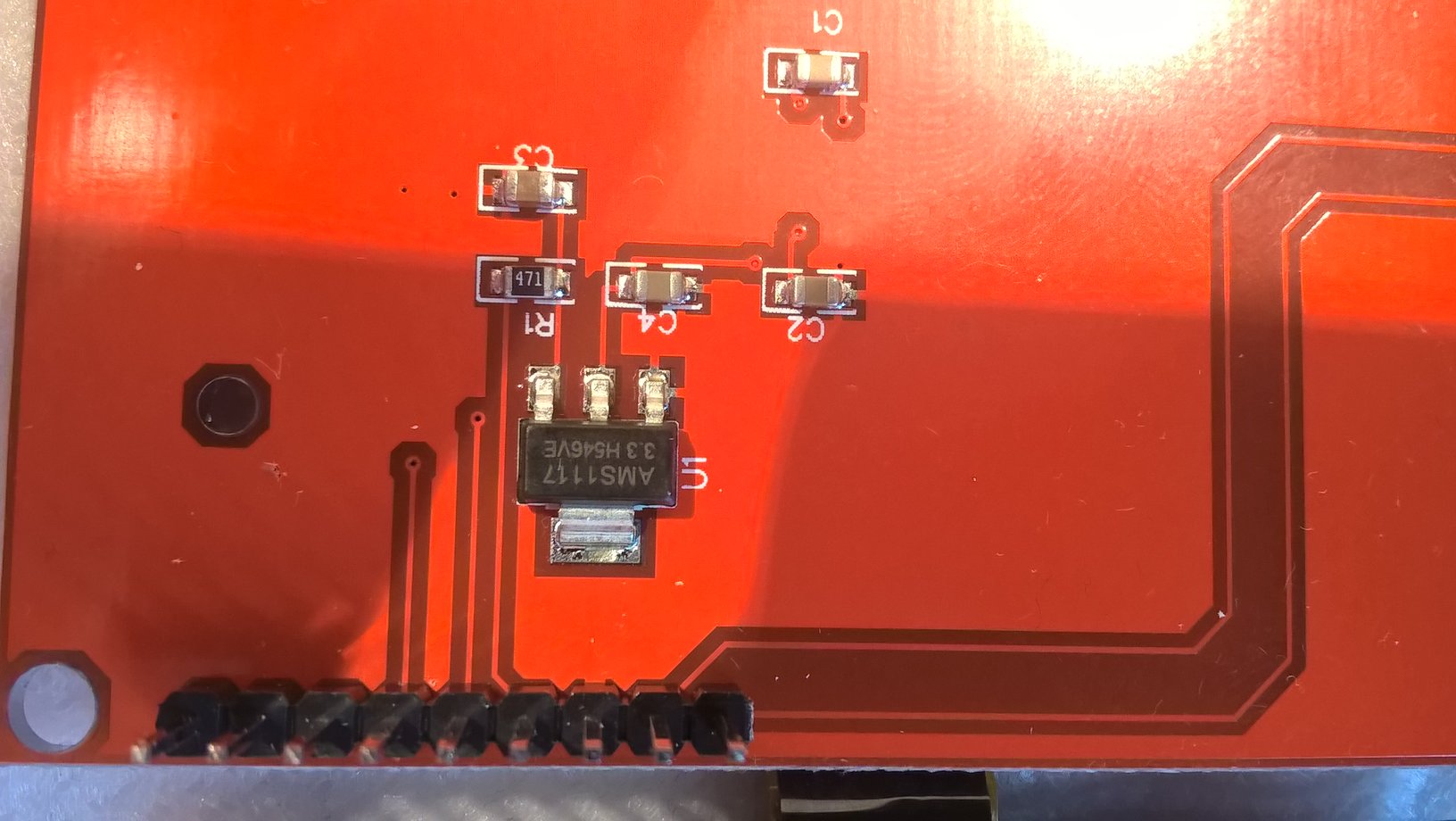

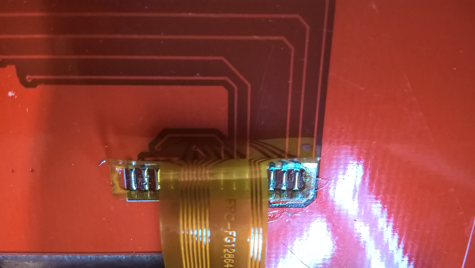

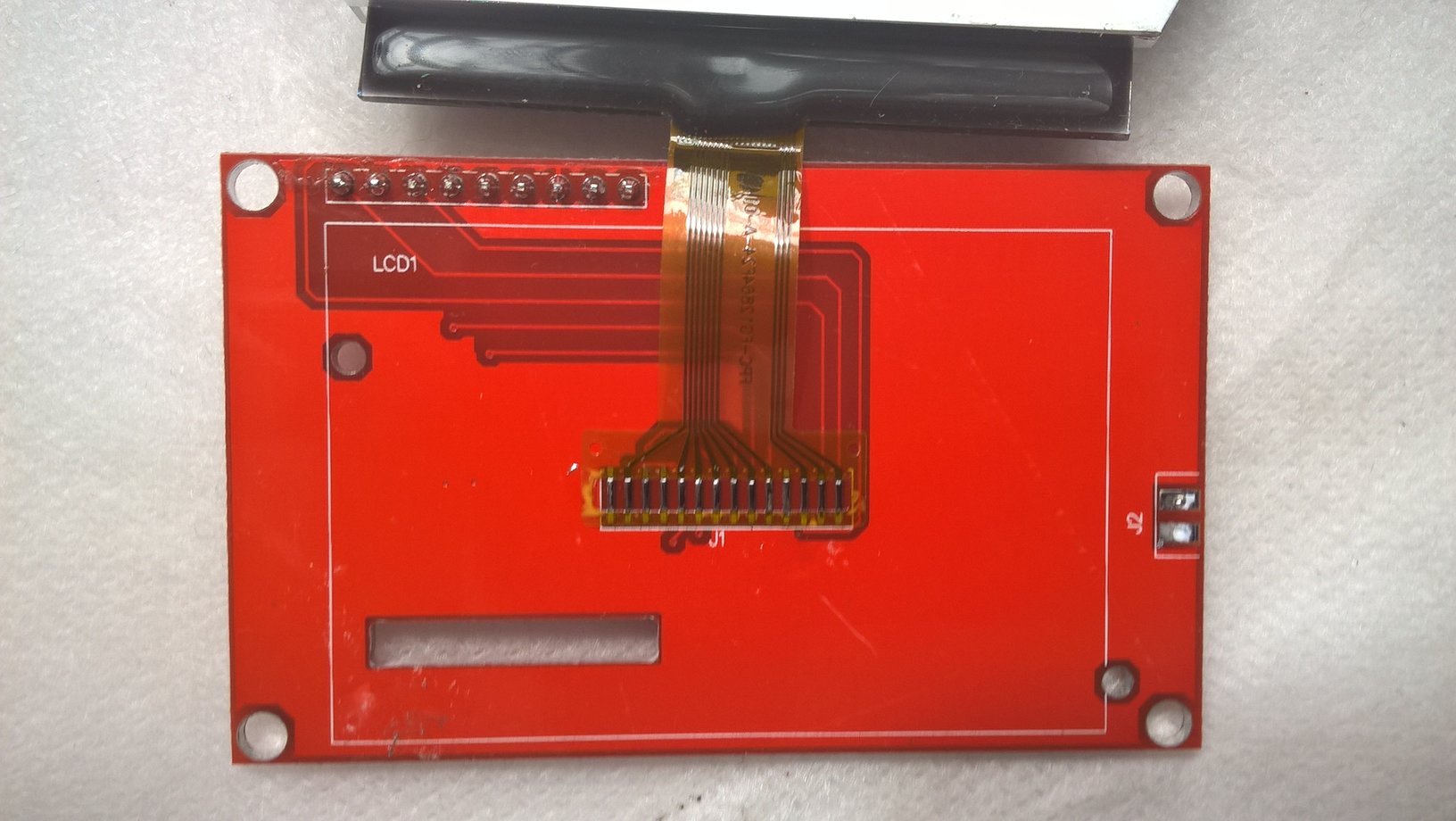

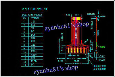

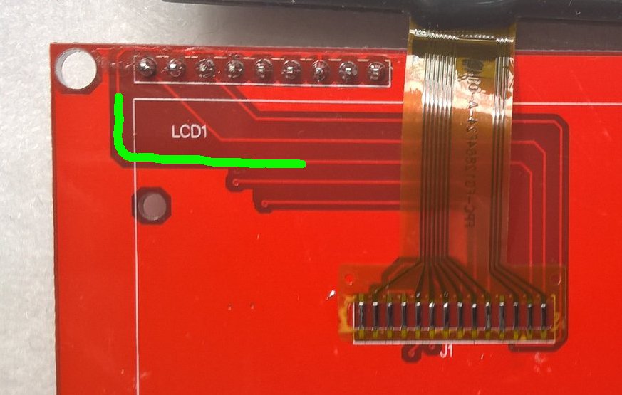

ESR meter upgrades
This is a sticky topic.
  • vinceroger69
    • Mar 2012
    • 6714
    • uk
    #361
    Re: ESR meter upgrades
    Originally posted by stj
    no, i'v seen a few of these panels lifted - they are more like this:
    http://www.ebay.com/itm/182035169094
    the question is how that ribbon maps to the pinstrip on the backing pcb.
    your spot on with your link ive just moved my ribbon cable carefully and it looks identical pin wise on the ribbon cable tracks
      • 31305
      #362
      Re: ESR meter upgrades
      try this one.
      • Per Hansson
        • Jul 2005
        • 5895
        • Sweden
        #363
        Re: ESR meter upgrades
        Tried "testing-swap12.zip" but just like the others there was only backlight.
          • 31305
          #364
          Re: ESR meter upgrades
          shit.
          have to think about this until vince pins out that display to the pinstrip on the backing board.
          and the socketstrip on the mainboard to the cpu for that matter - his underside photo was not good enough to get that part.
          what i have is this:
          1 - gnd
          2 - atmel pin 2?
          3 - atmel pin ?
          4 - atmel pin ?
          5 - atmel pin 5?
          6 - +5v
          7 - gnd
          8 - +v (led)
          9 - gnd (led)
          pin1 on the socketstrip is at the outer edge - can you trace/meter the atmel pins to the display connector?
          i suspect the atmel is using pins 2,3,4 & 5
          • Per Hansson
            • Jul 2005
            • 5895
            • Sweden
            #365
            Re: ESR meter upgrades
            I already did, back in this post I tracked the Atmel CPU to the pinstrip.
            And it was exactly as the schematic I linked on the previous page.
            • vinceroger69
              • Mar 2012
              • 6714
              • uk
              #366
              Re: ESR meter upgrades
              I will meter the pinout now bear with me
              Last edited by vinceroger69; 07-15-2016, 04:36 AM.
              • vinceroger69
                • Mar 2012
                • 6714
                • uk
                #367
                Re: ESR meter upgrades
                right the ribbon cable has 14 pads reading left to right
                pin 1 nc
                pin 2
                pin 3 nc
                pin 4 nc
                pin 5
                pin 6
                pin 7 on ribbon cable to pin 7 on connector
                pin 8
                pin 9 on ribbon cable to pin 5 on connector
                pin 10 on ribbon cable to pin 4 on connector
                pin 11 nc
                pin 12 on ribbon cable to pin 3 on connector
                pin 13 on ribbon cable to pin 2 on connector
                pin 14 on ribbon cable to pin 1 on connector
                pin 8 and 9 on connector go to backlight
                as per my above picture im classing pin one on the left hand side of picture.
                anything else you need whilst my lcds apart just ask.
                Last edited by vinceroger69; 07-15-2016, 05:22 AM.
                  • 31305
                  #368
                  Re: ESR meter upgrades
                  I already did, back in this post I tracked the Atmel CPU to the pinstrip.
                  And it was exactly as the schematic I linked on the previous page.
                  that incomplete schem does not even have the correct cpu pin labels!
                  i started drawing a new one.
                    • 31305
                    #369
                    Re: ESR meter upgrades
                    o.k., i need the track marked in green clarified.
                    where is it going on the pinstrip?
                    there is too much flux to see it clearly.
                    and i need the cpu pins traced - dont point me at a bogus schematic from china.
                    • vinceroger69
                      • Mar 2012
                      • 6714
                      • uk
                      #370
                      Re: ESR meter upgrades
                      Originally posted by stj
                      o.k., i need the track marked in green clarified.
                      where is it going on the pinstrip?
                      there is too much flux to see it clearly.
                      and i need the cpu pins traced - dont point me at a bogus schematic from china.
                      just cleaned board your highlighted track goes to pin 2 on connector pin 13 on ribbon cable
                        • 31305
                        #371
                        Re: ESR meter upgrades
                        o.k., i now have a schem of the display board
                        and i have this pic!!!!!
                        so i need pins 2-5 traced to the cpu to verify which pins they go to.
                        Last edited by stj; 07-15-2016, 06:21 AM.
                          • 31305
                          #372
                          Re: ESR meter upgrades
                          so our display board connector looks like this
                          1 - lcd /CE (gnd)
                          2 - lcd RST
                          3 - lcd A0
                          4 - lcd SCL
                          5 - lcd SDA
                          6 - +5v
                          7 - gnd
                          8 - led anode
                          9 - led cathode
                          • vinceroger69
                            • Mar 2012
                            • 6714
                            • uk
                            #373
                            Re: ESR meter upgrades
                            stj ive used diode/bleep tests these are my results pin 1 on pcb/lcd connector im classing left had side of board
                            pin 9 goes to pins 22 and 8 gnds
                            pin 8 goes nc?
                            pin 7 goes to pins 22 and 8 gnds
                            pin 6 goes to pin 7 vcc and pin 20 avcc
                            pin 5 goes to pin 5 pd3
                            pin 4 goes to pin 4 pd2
                            pin 3 goes to pin 3 pd1
                            pin 2 goes to pin 2 pdo
                            pin 1 goes to pins 8 and 22 gnd
                            stj i hope that makes sence im learing as i going/testing etc
                            Last edited by vinceroger69; 07-15-2016, 06:53 AM.
                              • 31305
                              #374
                              Re: ESR meter upgrades
                              that's great.
                              i'll go throw something together to test.
                              • vinceroger69
                                • Mar 2012
                                • 6714
                                • uk
                                #375
                                Re: ESR meter upgrades
                                Originally posted by stj
                                that's great.
                                i'll go throw something together to test.
                                Thanks stj for taking time to try and sort this ive got to admit i have no idea about the code/hex stuff you have too do to write a working program etc.
                                  • 31305
                                  #376
                                  Re: ESR meter upgrades
                                  try these
                                  • vinceroger69
                                    • Mar 2012
                                    • 6714
                                    • uk
                                    #377
                                    Re: ESR meter upgrades
                                    Originally posted by stj
                                    try these
                                    Thanks stj i will try it as soon as im back home as just need to pop out, maybe per hansson can check this too as im still learning how to use my programmer so i would not want too say your file dosnt work when it does as im messing up my end programming it although i will try when im back home.
                                      • 31305
                                      #378
                                      Re: ESR meter upgrades
                                      maybe now you know why it's good to have a programming header on the board!
                                      • vinceroger69
                                        • Mar 2012
                                        • 6714
                                        • uk
                                        #379
                                        Re: ESR meter upgrades
                                        Originally posted by stj
                                        maybe now you know why it's good to have a programming header on the board!
                                        soldering one on the pcb etc isnt the isuue its the learning of the programming side of things im reading up on and trying too learn, things it seems to take longer as you get older.
                                        • Per Hansson
                                          • Jul 2005
                                          • 5895
                                          • Sweden
                                          #380
                                          Re: ESR meter upgrades
                                          Originally posted by stj
                                          that incomplete schem does not even have the correct cpu pin labels!
                                          i started drawing a new one.
                                          You are correct they mislabeled some of the pins, but the layout seems correct.
                                          As now verified by vinceroger69 as well
                                          I now tried all firmwares in "testing-chips.zip"
                                          The only one which gave scrolling text like with the previous files quoted below was the 7565 display firmware.
                                          All others just had blank display with backlight lit.
                                          testing-ramshift.zip
                                          testing-oc.zip
                                          The above two behaved like it also did with "GM328A ESR tester (SVN663).zip" which was scrolling characters on the screen.
                                          Last edited by Per Hansson; 07-15-2016, 10:58 AM.
                                          • chth96
                                            Is it possible to test small ceramic disc capacitor with analogue meter?
                                            by chth96
                                            I read EBOOK of Testing Electronic Component and found that
                                            "In order to test the small blue resin coated ceramic disk capacitor which has 104 50v specification,it is possible to test this small ceramic capacitor by making use of analogue meter.
                                            Set to times 10Kohm that has 12v output from the probe to check disorder of ceramic capacitor.
                                            It is not uncommon that testing result of digital capacitance meter is okay,But It show shorted reading when you check it with analogue meter."
                                            Is it really possible to test small ceramic disc capacitor with analogue...
                                            03-09-2024, 10:03 PM
                                            Modification of a Fluke multi meter that uses three AA batteries to use a 14500 lithium ion battery
                                            by sam_sam_sam
                                            I have had with regular AA batteries that leak this meter is expensive new I already replaced the battery battery clips once and the same thing happened again and I am tried of so it is getting modified to accommodate lithium ion batteries that are the same size excluding the positive terminal and removing the battery clips I will have enough room for the BMS protection board
                                            I going to put 3 lithium ion battery in parallel with the BMS protection board and a way to charge the battery externally and heat shrink the battery pack and use a JST connector so I easily remove the battery...
                                            12-31-2023, 06:04 AM
                                          • Ryan Wurtz
                                            Lenovo Yoga C740-15IML 5V on usb meter.
                                            by Ryan Wurtz
                                            Hello. So I searched and didn't find any posts on this specific problem.
                                            When plugged in USB power meter reads 5v
                                            Doesn't charge battery. I can charge the battery with power supply. So it seems the battery works fine. Laptop started but didn't post on battery.
                                            Original mobo had a shorted cpu it seems.
                                            So I decided I need a new motherboard.
                                            Put the new one in the computer. Connect the battery, I think it starts, don't quite remember, but when I plug the adapter/charger.
                                            5v on the meter. Still won't charge. Can still charge the battery...
                                            11-24-2025, 01:08 AM
                                          • jorpec
                                            Changing the scale of an analog meter
                                            by jorpec
                                            Hi
                                            I want to change the scale of an analog meter, to monitor the charge of an li-ion single cell, so the needle at the end would point 4.2 volts and the 0 on the meter would point 2.5 volts or so, i tried to add diodes or a zener in series with the meter but the changes of the ambient temperature also changes the voltage value on the meter
                                            I wonder how i can accomplish this so the meter would be precise at any temperature ?
                                            Thnaks
                                            01-23-2023, 10:37 AM
                                            How an incandescent light and a ESR meter ** friend**have a machine blowing fuses
                                            by sam_sam_sam
                                            About a month ago we had a transformer jumper wire that burned in two different places between two transformers caused over $200 thousand dollars worth of damage to VFD drives at least 10 of them and a memory card and quite a few power supply as well
                                            Now we have most of the equipment that got damaged back up and running except a feeder that has issues and we are waiting for some parts for
                                            Now we also have another piece of equipment that was blowing fuses on the 110 volt controller switch circuit with the “E” stops and one switching power (24 volt) supply and a transformer...
                                            12-14-2023, 07:45 PM
