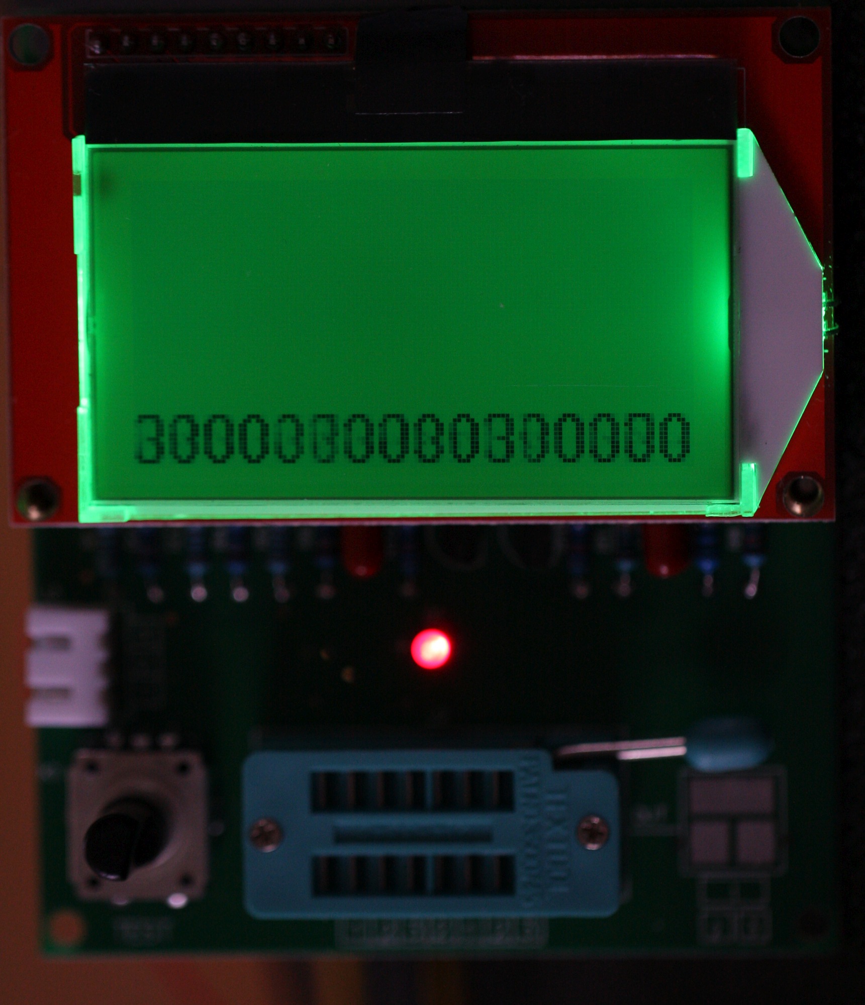

      Re: ESR meter upgrades
      Originally posted by stj
      then try both of these.
      "testing-x2.zip"
      Both the "old" and "new" firmware in the archive had the display upside down and inverted like I had with the first firmware in this post by tom666

          #404
          The encoder works, it does not in the firmware I posted by tom666.
          One strange thing is on first power on contrast is alright, but on the second it gets very dim.
          Contrast is then around 40 something, I increase it to 48 and it's good.
          Around 110 > 115 also gives good contrast btw.
          I tested a capacitor and it seemed to give the same reading as with the firmware by tom666, so it seems alright...
          Didn't test more because it's a brainfuck to invert the picture in your brain

              #406
              Yea vinceroger69 said that worked the best on his per the quote below.
              Maybe I put some component for the LCD in the wrong position, want to take a look at my build and tell me if all resistors are right?
              In particular is there 0.1% vs 1% resistors in the kit?
              Because I just measured them and put them in the circuit, was impossible for me to see the color bands in the evening...
              Thinking that could account for the difference in contrast...
              40 shows the best imaage on the panel
              With "testing-almost.zip" I just got the scrolling line of text again

                        #411
                        Thanks vinceroger69, I had checked it before too but it's nice to have it double checked
                        Stj, "testing-bg-kit.zip" gives the scrolling line of text.
                        It's not the same as in my previous post above though.
                        But it's exactly the same as in the quoted post below.
                        I took a new picture and attached it.
                        Because I realize this one is also probably upside down and inverted unlike the others.
                        It showed one scrolling line of text like your others, this time it was a bit better contrast and maybe thicker fonts, or just slower, difficult to say...
                          • 31185
                          #412
                          god damn it - give me a while.
