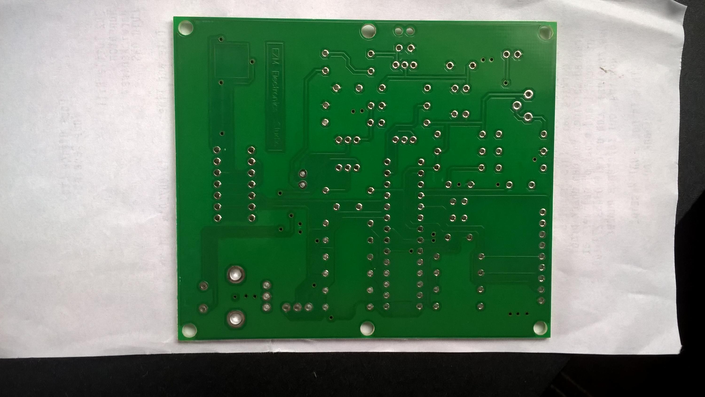

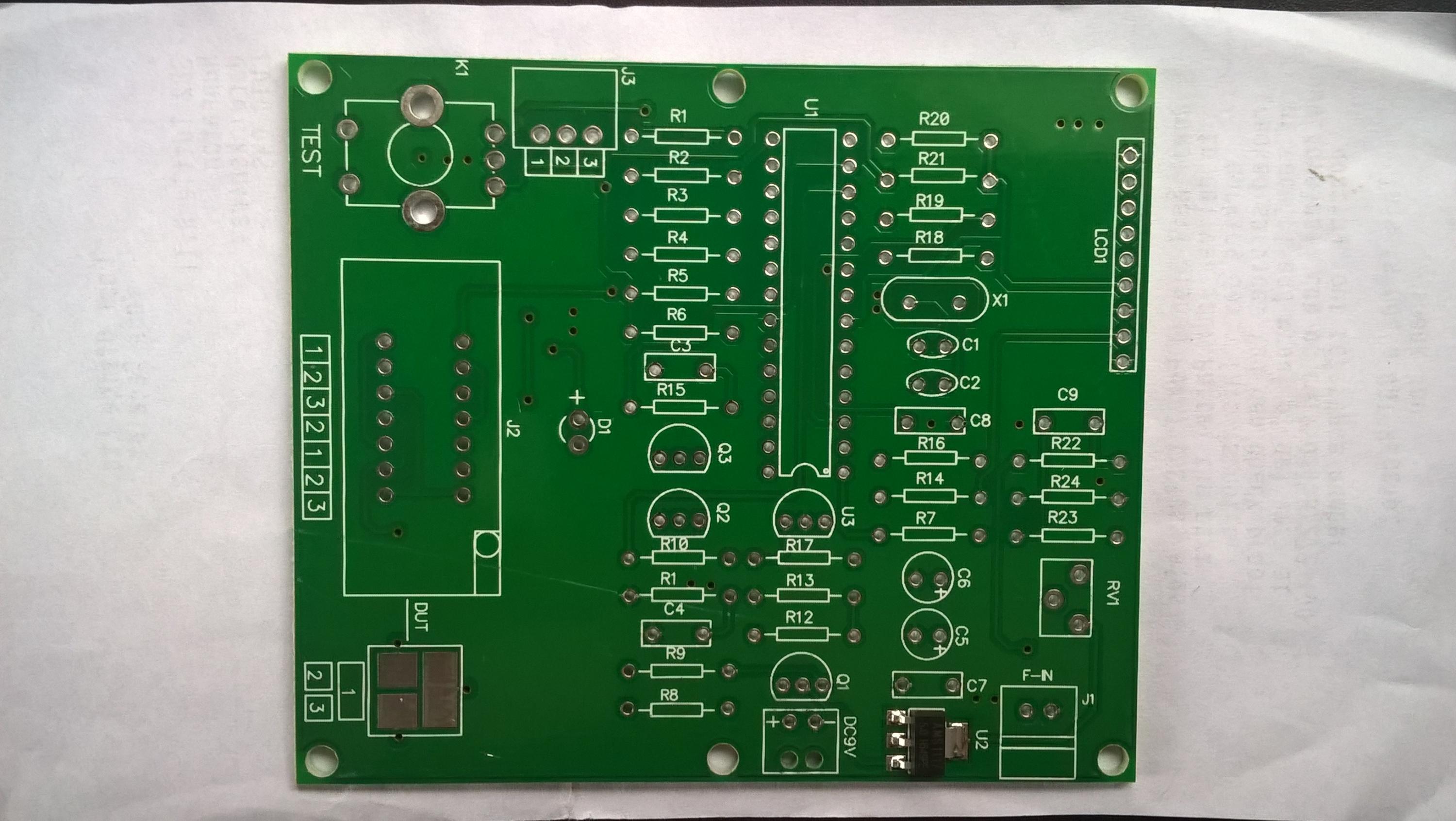

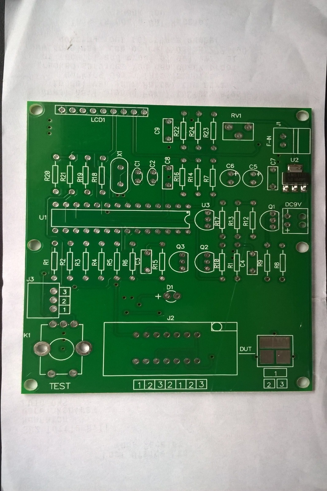

            Well the kit has just arrived the bad news is the pcb has none of the parts identified on it bacically its marked r1 r2 c1 c2 etc no instructions either in the package and the seller hasnt got any either i will try to upload a picture later but without knowing what value resitor/capacitor etc goes where im a bit stuck.

                sure is heres the pictures of course some of it its easy to figure out but resitors value location im stuck on also theres three diffrent transistors types so stuck on locations for those too.

                  #188
                  Re: ESR meter upgrades
                  grab this
                  https://cdn.badcaps-static.com/pdfs/...e5d681501a.pdf

                    cheers stj someone else also posted this new manual for me on eevblog im just having a read of it now and also going too measure the resistors in the kit and see what matches up etc.
                    Im just measuring all the resistor values in the kit and also seeing what the four transistor part numbers are the rest i have already figured out.
                    its a 8 mhz crystal
                    transistors are 2x c945 p331 1x 4673 4c gf 2 1x ws tl431 928
                    resistors x6 10k x2 110 ohm x2 27k x3 470k x1 470 ohm 1x 33k x3 680 ohm x1 100k x1 5.6k x2 3.3k x1 2.2 there is also x1 brown looking type resistor but it only has 1 black band dead centre of it but there are 23 resistors in this kit plus the odd brown one but only 21 fitted resistors in the kit.
                    Now the main issue what resistor transistor goes where.

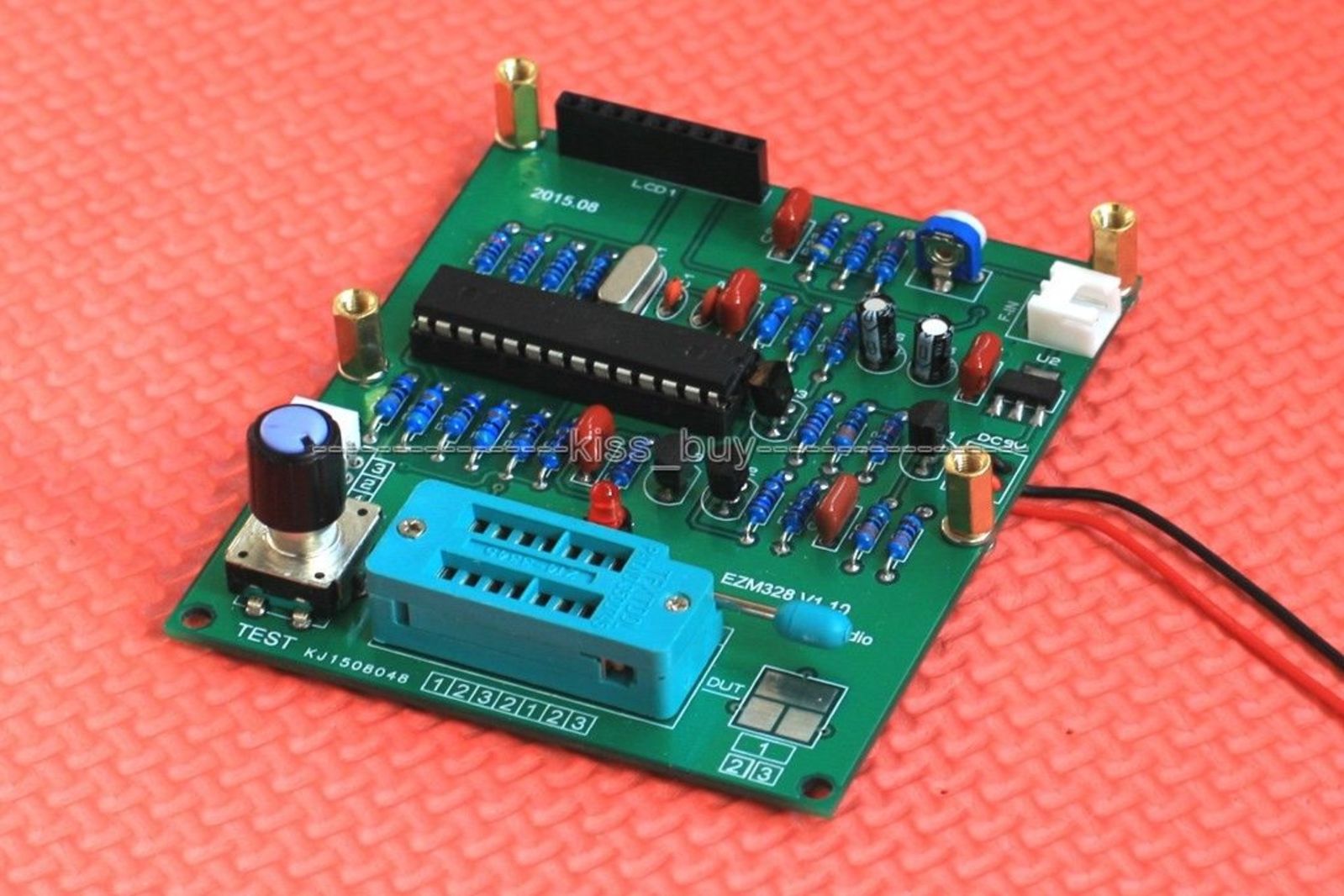

                                    • 31316
                                    #197
                                    it's unlikely they will ask for it.
                                    they may post a big foto of a built one if they have it - because it effects all the customers.
