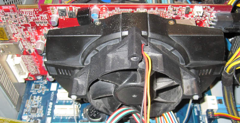

      Dammit. Shattered my GPU's fan when cleaning it today. Don't stop the moving train.
      Ended up using zip ties to attach a standard 80mm fan to the shroud. I suspect I still needed to use the shroud (it's one of those dual slot Radeons). The zip tie's ratcheting head wouldn't go through the fan screws or the thin slots I was abusing on the shroud so I didn't need to stick the end into the ratchet head, nor was it long enough anyway.
      Sorry no pictures ... yet... question is whether I can find a half height 12mm thick replacement 80mm fan with screw holes 90mm diagonally apart, instead of the typical 100mm diagonal 25mm thick fan that's currently ghetto-attached for now...
      GPU is at 60°C ...
        Bwah. Where's the "this thread is worthless without pictures" smiley when you need it?
        I guess I will use this instead:
        Probably eBay... though the replacement GPU fans are a bit over-priced IMO.
        If height is not an issue, I don't see why not keep the 25 mm -thick replacement fan. I guess the only reason to replace it if it's a higher airflow and lower pressure fan... which most 25 mm thick fans are. If the fins on the heatsink are really close together, then you should find a thin 80 mm fan, as those typically generate higher pressure (due to more "narrow" fin pitch)... or perhaps just use a 70 mm fan??
        If noise is not a concern, a 70 mm fan from a socket 754 / 939 / AM2 heatsink screaming on 9-12V should cool things pretty well.
        GPU is at 60°C ...
        Not good, especially for ATI/AMD cards.

              You know, other than the fact it probably doesn't cool as well, and the fact it's wasting 3 PCI slots... might need a double take.
                master hoarder
                • May 2008
                • 12175
                • Bulgaria
                #547
                Re: The ghetto mod thread
                Ah well, if you're not using the PCI/PCI-E 1x slots, then it's not really a waste.
                Fan looks like it's from a cheapo PSU, though... and if so, I'm guessing it's rated for 0.14-0.16 Amps. Thus, it's probably not the most powerful or efficient thing in the world, and probably the reason for the high temps too. Though on that note... I can't quite figure out what AMD/ATI HD series this card is. It has a 6-pin PCI-E power conn, so it has to be HD x770 series or higher (so maybe 6770 or 7770?) Doesn't look like an AMD/ATI OEM either. If it's an HD6850/7850, then that stock cooler would be at least partially responsible for the high temps too, as it looks a bit inadequate (for the 120W TDP of those cards.)

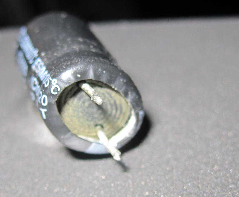

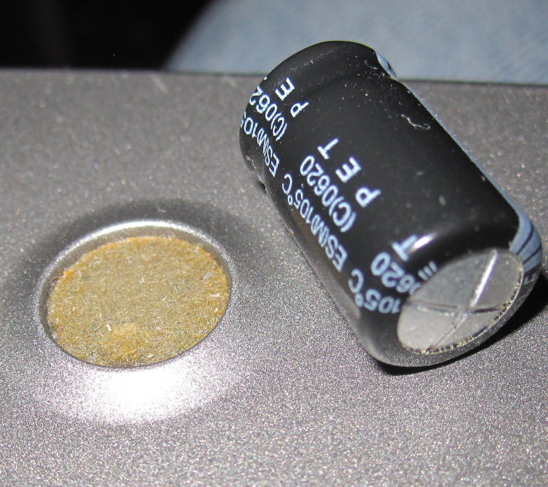

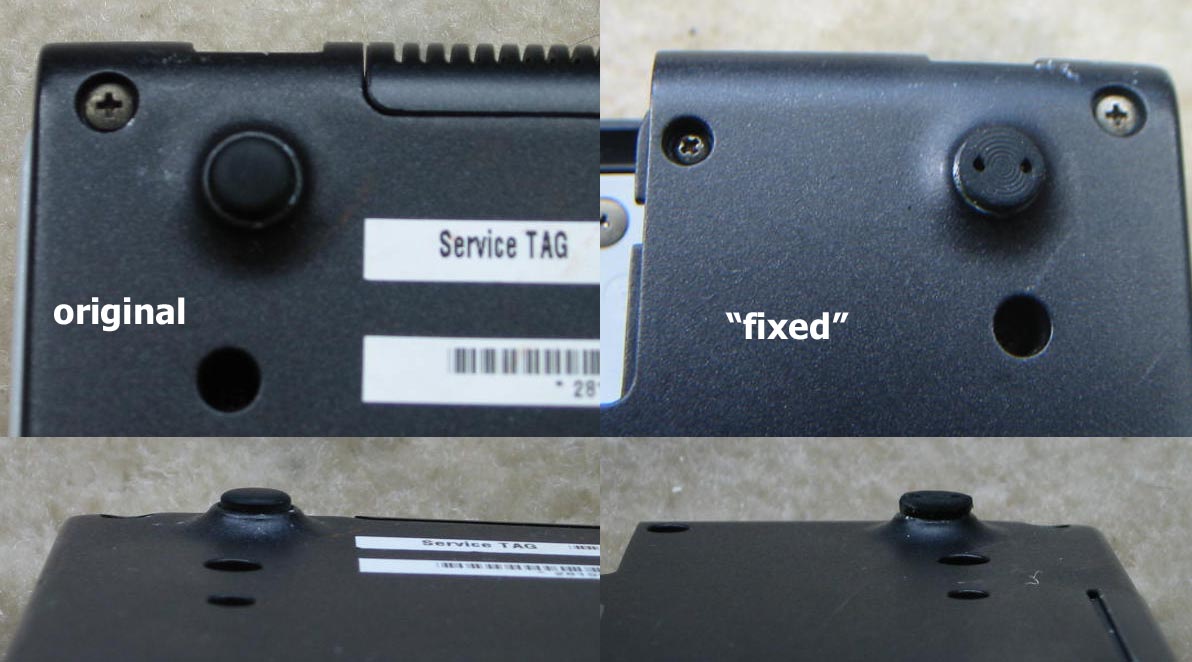

                  Since this thread has been awakened, here is something I did recently (actually, yesterday.)
                  I've been piecing together / playing around with a few junker laptops this week. One of them was missing a rubber foot on the bottom, which made the laptop very wobbly on a hard, flat surface (and kind of annoying even, when typing on it.)
                  So, I had an idea!
                  Let's take a busted Sacon FZ apart:
                  Do you see where this is going?
                  A few drops of contact cement later, and this was the result:
                  ^ Yes, that's the rubber bung from the busted cap. Fortunately for me, that vented Sacon FZ cap was so dry in there, that I didn't really need to clean the rubber bung with anything too harsh or "exotic" (e.g. acetone, toluene, and etc.) Nope, just sanded it down a bit (it was about 0.8-1 mm too wide for the plastic hole on the laptop's body), wiped both surfaces with IPA, put contact cement on both, and glued it all together. Simple as that!
                  The best part is, now the laptop doesn't wobble anymore at all. It's like that rubber bung was meant to be there.
                  Also, it's a good (re)use for busted/vented caps. I've actually though of using the rubber bungs of capacitors as rubber feet for a long time... but just never found a convenient time to try it. Well, now I have.

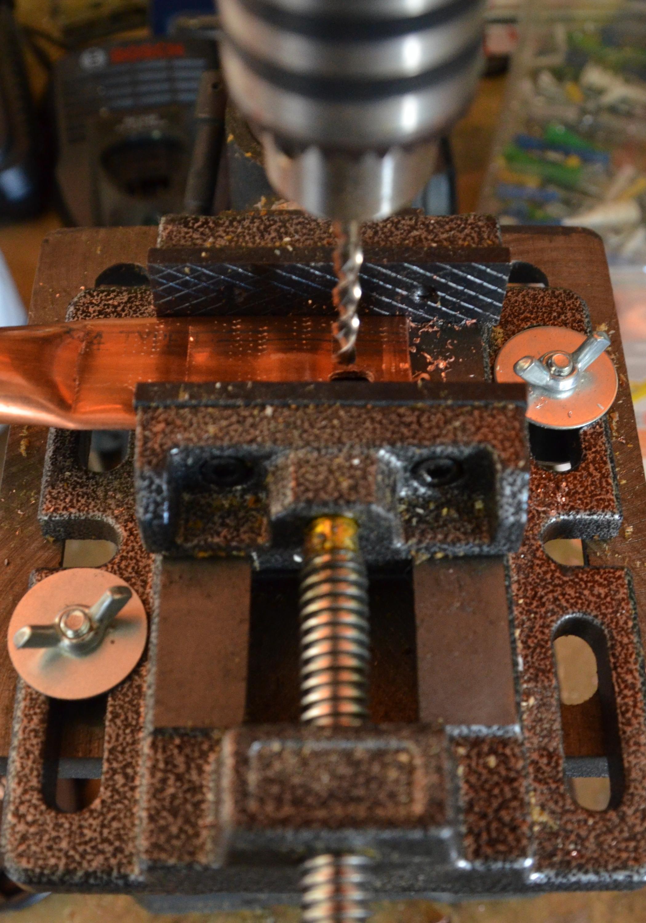

                            I ordered a GPS mount for my motorcycle, but it is shipping from Belgium and thus will show up "eventually", so I came up with a temporary solution until it arrives with a piece of 3/4" copper pipe and some spray paint.
                            First I mashed the ends flat with a vise:
                            Then drilled some holes with a Harbor-Freight drill press:
                            Test Fitting (it bolts up to 2 existing screws for the "dash" trim):
                            Final product after a coat of black spray paint (the included Garmin mount with the u-bolt mounted RAM ball is attached to the pipe):

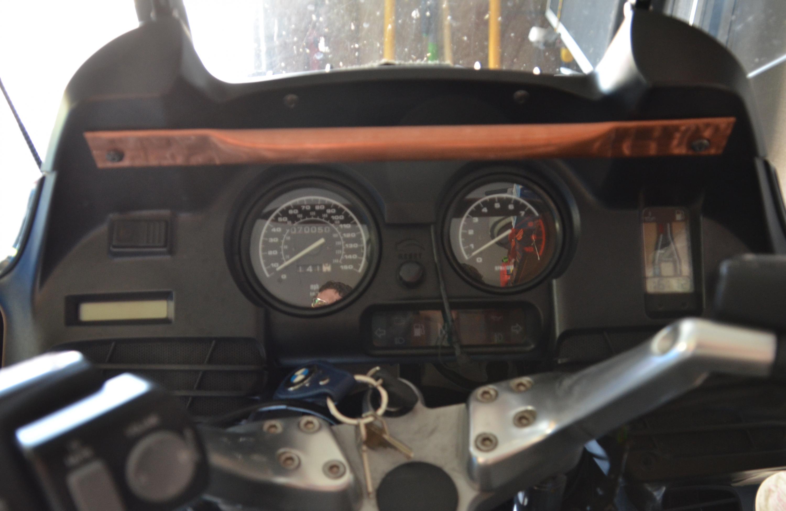

                                      It doesn't looks too bad, but the "ghetto" mount does kind of block the top of the speedo (of course right between 60 and 80 mph, about the most common highway speeds) and tach a little from the riding position (not too big of a deal since the GPS shows speed which is more accurate anyhow, the speedo on the bike reads a little high as is pretty much standard for BMW). I already ordered the "official" mount and it already shipped so returning it at this point (once it shows up) would require paying return shipping that would be nearly 1/3 of the purchase price, otherwise I may have skipped it if I thought of (or rather stumbled across I found an article for a similar mount made from a cut-up weed-eater, I didn't have a junk weed eater to cut up, but I figured I could do something similar with copper pipe) the "ghetto" solution earlier.
                                      How the "ghetto" mount looks from the eye-level of the rider:

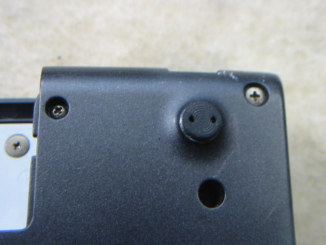

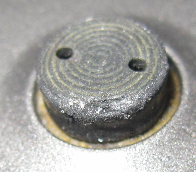

                                        Alright folks, as I said, I'd take a few more shots of that laptop to show the original vs. fixed rubber foot. So here is that:
                                        The Sacon FZ bung is ever so slightly taller than the original rubber foot... but not by much, and the laptop doesn't seem to wobble. So as long as no one turns the laptop around to look at it, they probably won't know the difference. That said, this is a "junker" Sony VAIO laptop with Centrino 1.7 GHz and 512 MB of RAM, so not like I will be selling it to anyone. If I can get the few non-working keys on the KB fixed (namely, Backspace, Enter, and Delete - all of which are hard to go without) or just replace the KB and increase the RAM a bit to 1 GB, it might do OK as a general purpose Windows XP laptop for me to use. FWIW, it's fairly light and I like its design.
                                        Perfect!
                                        Now you have a valid excuse when a cop pulls you over for speeding (or driving too slow?) Either way, most people always travel around 70 MPH on the highways (at least around here), so +/- 10 MPH should be within the realm of acceptable.
                                        I guess that's BMW's built-in "feature" perhaps to make motorcycle riders drive slower, huh?

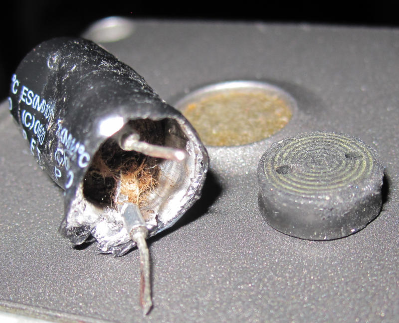

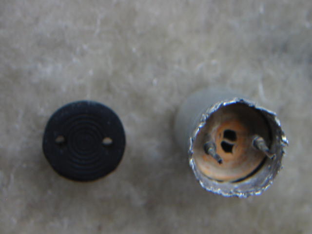

                                          And here's our patient... a Centrino 1.6GHz laptop with 1.5GB of RAM. Its Ethernet is shot as far as I can tell, which is unfortunate, it's an old Gbit Ethernet. But anyway our victim^H^H^H^H^H^H^H guest of honor is a 470uF 25V capacitor.
                                          It's a part of the Elite. That blew its top.
                                          Seems to have a nice bung like the Sacon FX...
                                          So the first attempt is to massage it to make it drop its bung. The cap of course is crimped so rolling it along to massage and make the aluminum can a bit flatter so the bung would slide out.
                                          Well at this point the bung still wouldn't come out.
                                          So I ended up squeezing the can like a tube of toothpaste and pried the thing out.
                                          It sure did not want to drop the bung! But finally with a bit of encouragement with a screwdriver, and the laptop as a new leg to stand on.
                                          I just need to figure out some good adhesive so it won't come out again... or why bother, still have an army of Elites and CapXons to follow suit...
