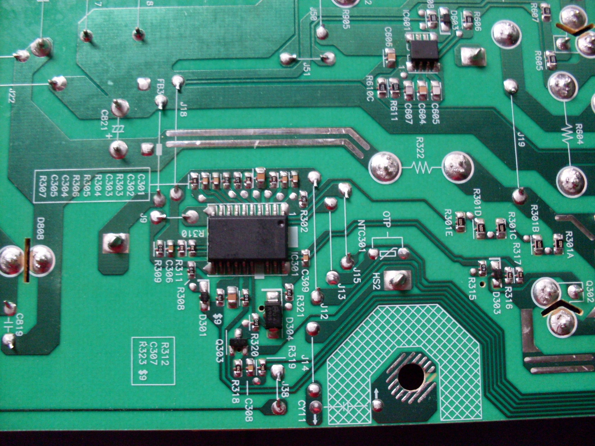

                        OK, so, next step is to get part number for this chip.
                          Re: Sanyo DP42849 - No Power At All
                          1606b
                          penv
                            https://cdn.badcaps-static.com/pdfs/...a4df8cb40c.pdf
                            See if you can trace pin 8, Vcc, to a capacitor on the board, or to somewhere else, then test voltage across said device.
                            Or, you can try soldering a wire to pin 8, and check voltage directly on there, using the negative of the 450V capacitor as ground for your black probe. (You are testing primary side, which is isolated from the secondary, grounded side.)

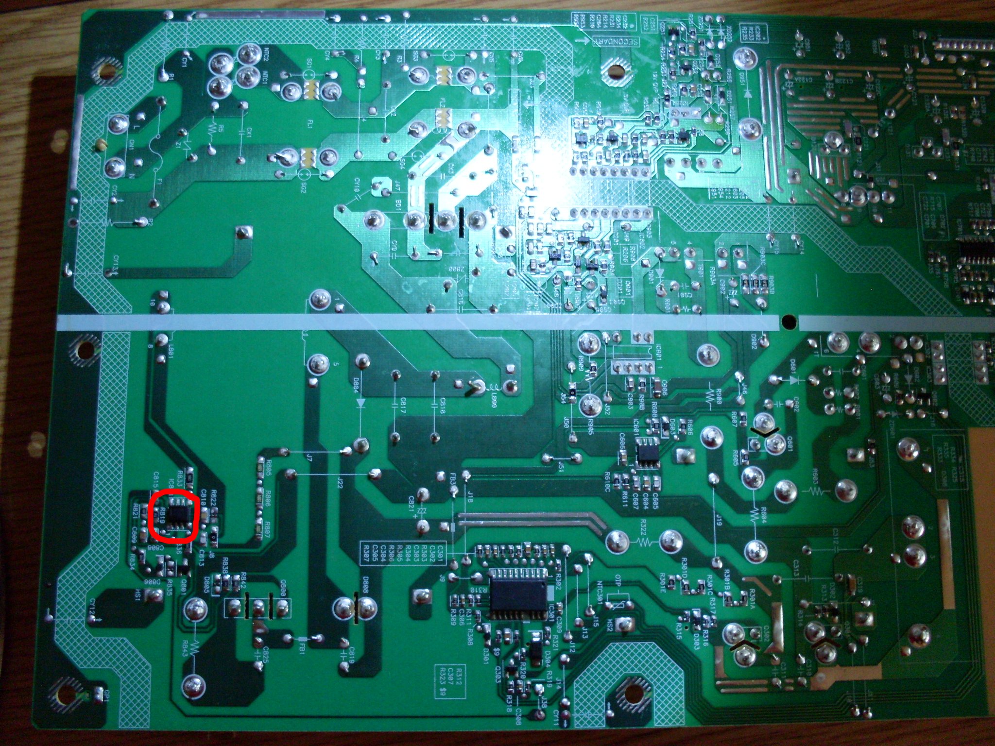

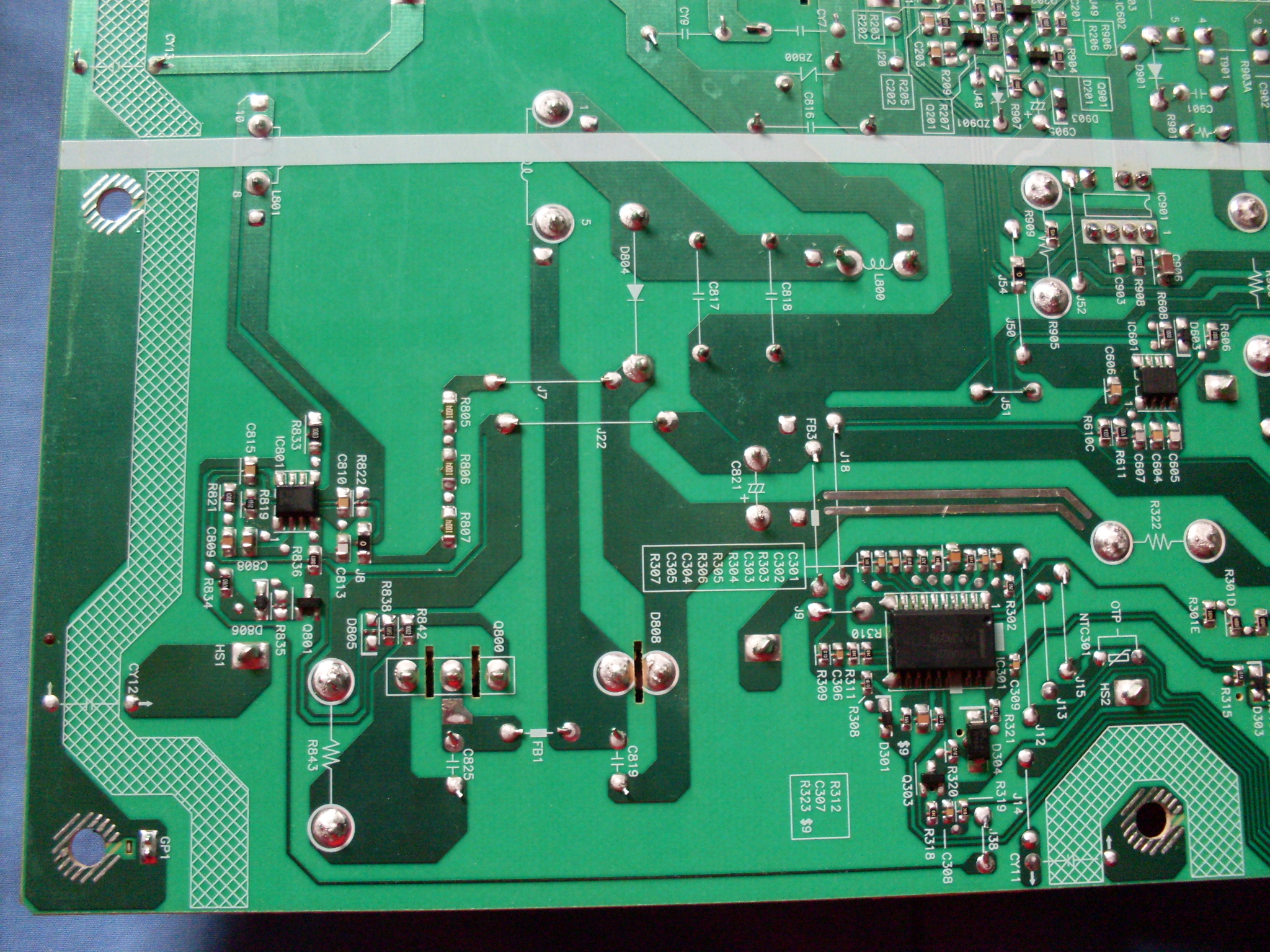

                              So I'm seeing pin 8 as the one with IC801 next to it. It looks like it goes across J38, and from there I can't quite tell which way it goes.
                              Here are some pictures.
                                You could try testing voltage at J38 as positive point, and big cap negative as negative point, as before.
                                  So I would put my black probe on the negative pin of the large cap, and then touch the J38 wire on the front of the board with my red probe?
                                    Yes.
                                      And this is checking to see if current is getting this far into the circuit?
                                      I'll try it now.
                                        This is checking if PFC controller and main IC have good Vcc. If they do, then they are both defective. From repair progress so far, it is looking like a power surge damaged something, though it's also possible damage was caused by the standby IC failing. I've had a set which blew the main power controller (similar in function to the standby controller); the resulting surge which was imposed on the Vcc line killed a few other parts along the line. Luckily, I had full schematics, so repair wasn't too hard, just tracing where voltages were disappearing, etc.
