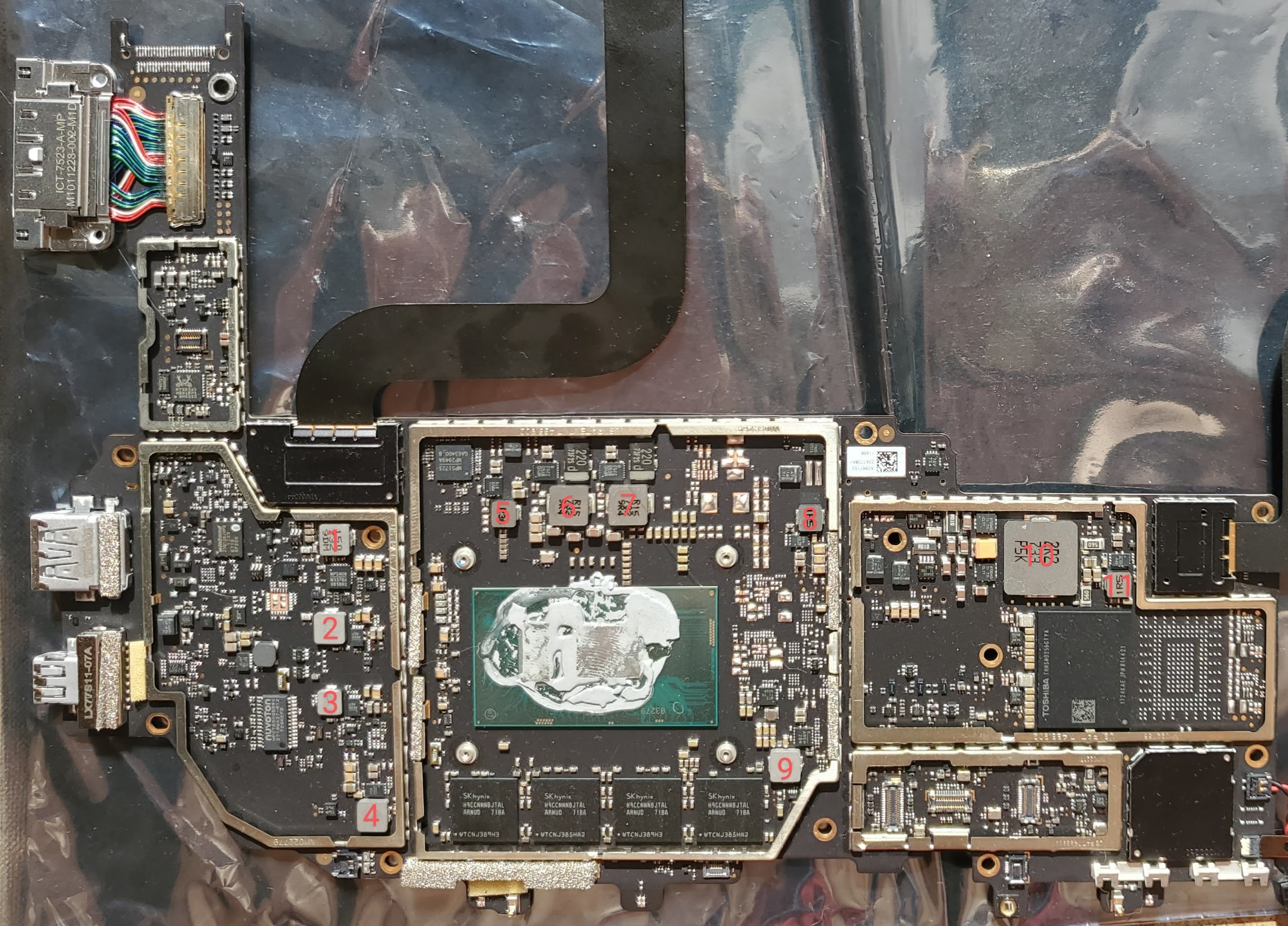

    I have the motherboard removed, with only power adapter and power button board connected. The power adapter supplies 15V. The battery is unconnected. I tested voltages with the black lead to ground and red to various components, using test pads where possible.
    Power on sequence step 1 says “Convert any raw power to +3P3VAS” The diagram says this is at “Switch (Diode). I found two sizable diodes near each other. I'll call the one nearer the power adapter diode 1, which I believe receives the power from said adapter.

    I also disconnected the power supply and documented resistance readings from the inductors to ground. I'm using an old Micronta 22-191 digital multimeter, holding a pin against the positive lead to extend it into tight spaces. I had a little trouble getting consistent readings, but here's what I measured. I numbered them in the image below for reference.
    #1 1.9 M ohm
    #2 160 ohm
    #3 100 ohm
    #4 43 K ohm
    #5 10 ohm
    #6 5 ohm
    #7 5 ohm
    #8 32 K ohm
    #9 350 ohm
    #10 1.2 M ohm
    #11 40k ohm
    At this point I'm a bit lost, so any help to point me in the right direction would be much appreciated!

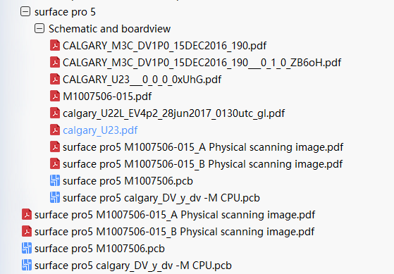

    Do you have the schematics?
    • PantherDave
      • May 2024
      • 7
      Nope, do you know where I could get them?
